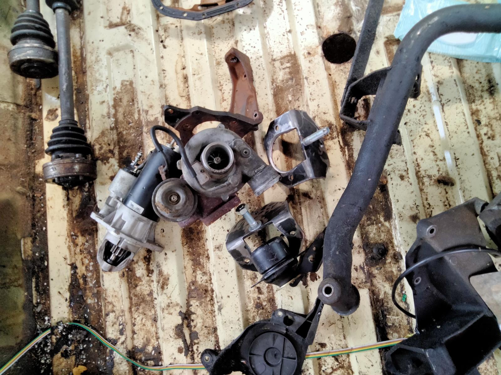

Later today I'll try to take a couple pics of that Vega 4 speed counterweight. I know where it is... which is not true of a lot of my stuff.
I think DAMPING would be the easiest thing. Somehow attach some mass to the resounding part to absorb the energy. Like sandbags encased in heavy vinyl or something.
Something in there is ringing, lower frequency that a normal dinner bell, but sorta the same idea.
This is a situation common to almost every automotive drive train installation. Pretty sure some are adapting SAAB motor mounts.
(I actually just picked up a project 1982 Diesel Vanagon and it had some of these parts there. I guess I'll have to get up to speed on this myself.)
Here's the picture of this plunder showing the left 1982 spec engine carrier, two adapter brackets and one SAAB (I think) mount.

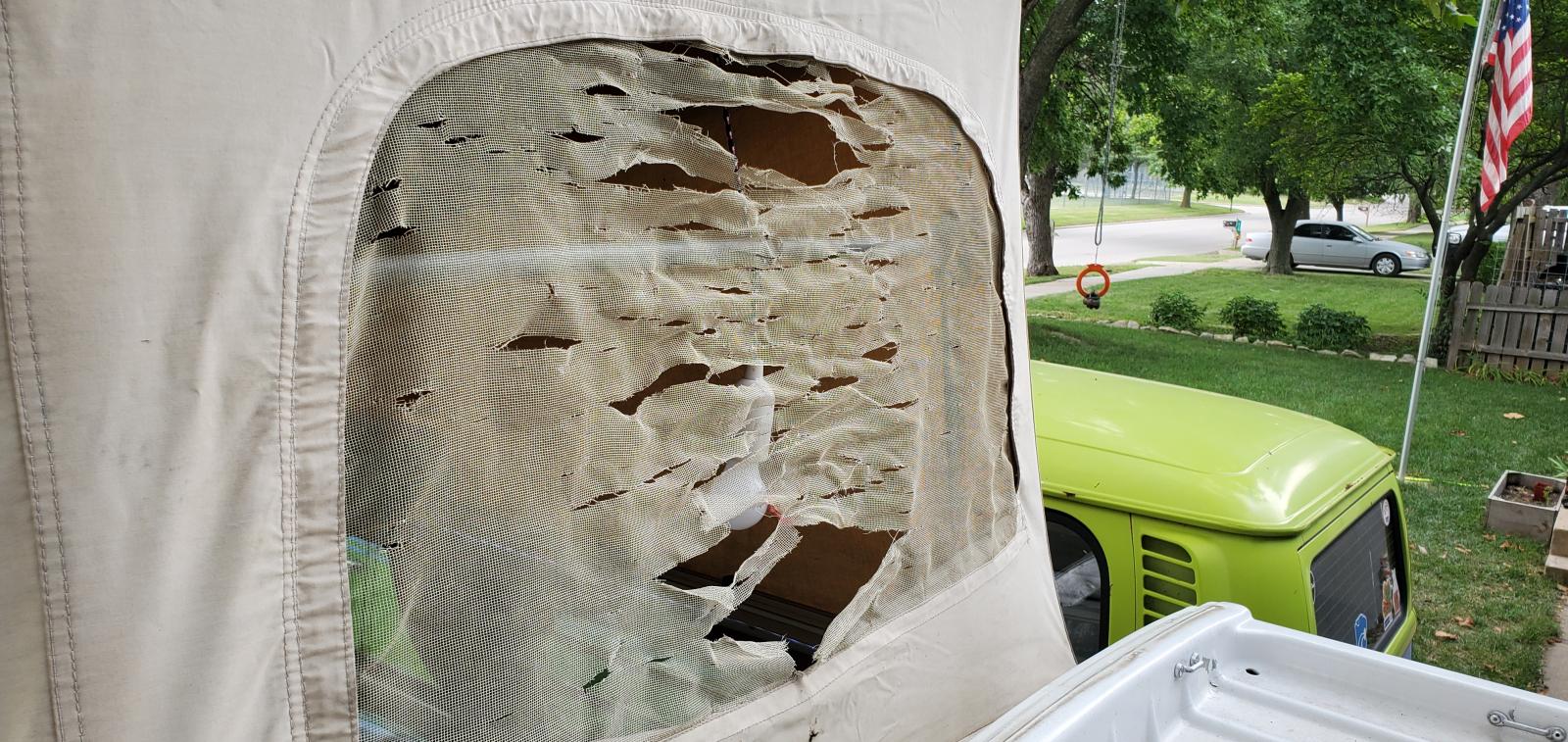

Took a break from mechanical stuff (I replaced a ball joint and then adjusted the steering box today) to improve something else in the bus.
Decided it was time to replace the torn up screen in the pop top before I head to mosquito-laden Wisconsin in a couple weeks.
I followed the directions here:
https://campwestfalia.com/replacing-the-westfalia-tent-window-screen/
Though I differed a little bit from the instructions there-For the arch, I started stitching on the driver side, same as the start of the zipper. I had already pinned the screen to the old zipper strip from the outside, so I was able to work my way up and around the arch and stitch the new screen in that way, unzipping it as I went. I found it helpful to trim the screen close before getting too far so it wasn't in the way.
I'm happy with how it turned out. The canvas is getting a bit fragile, so I imagine a whole new tent will be in my future in a couple years, but this new screen makes it a bit nicer in the mean time.
Here you can see it was already starting to work!
Done
