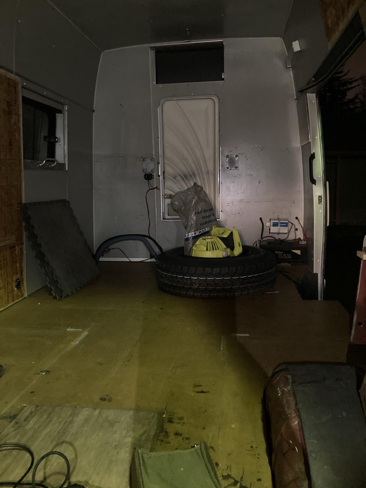

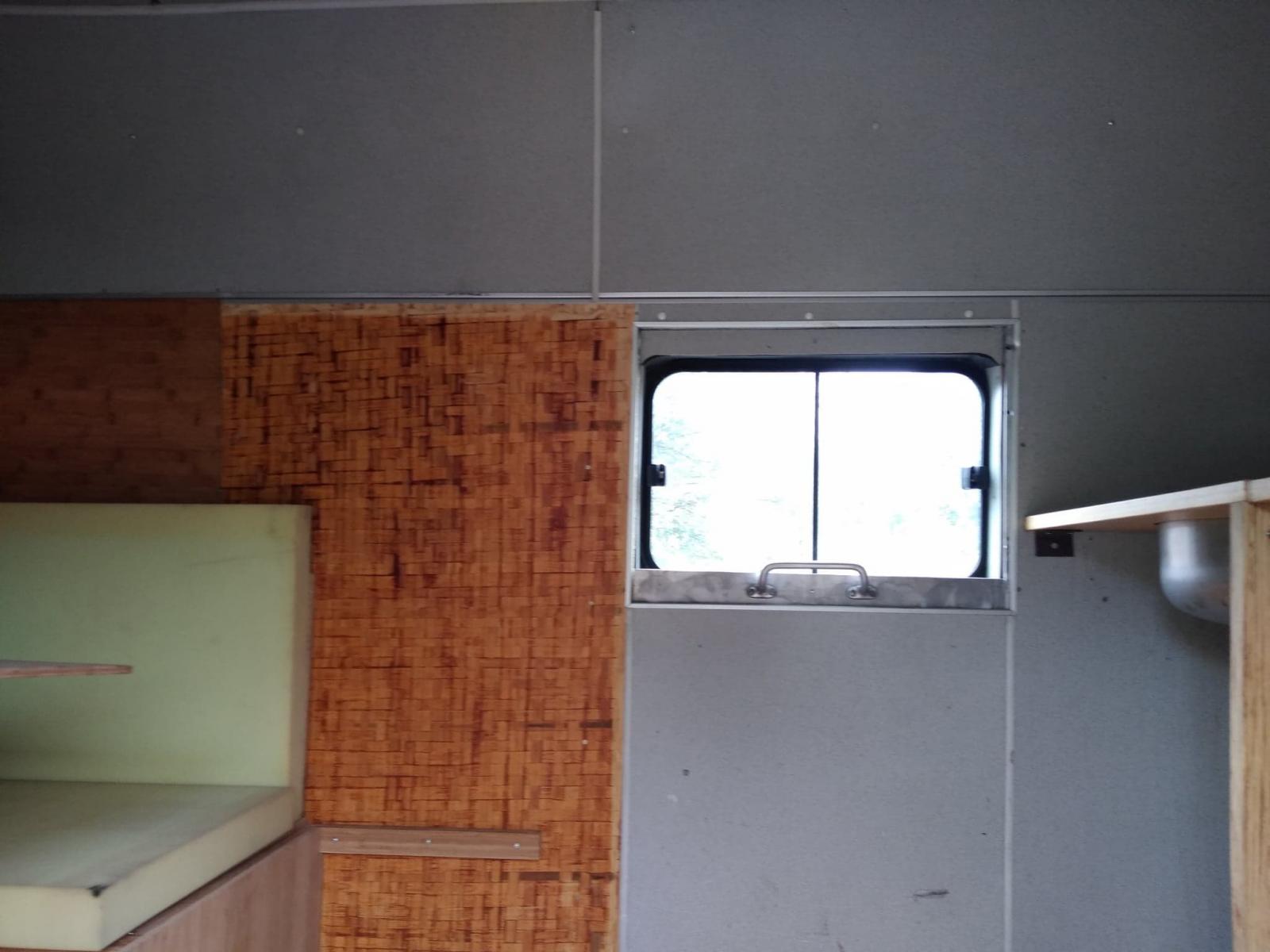

In the meantime. Here are some photos before deconstructing. Maybe of interest to folks?
Here are the dimensions. Kind of the size of a 144 wheelbase sprinter but 72” wide.
Filled with imported contraband.
Tired Volvo/VW variant D2.4l diesel intercooled turbo motor.
The rear camper table and bed. This saved me 22.5% import tax as these bits made it a camper and not a truck.
Front camper bits. And note the over cab storage area?
Rear double doors. A lot of space to store stuff.
A rare bumper made it’s way from a Sulzer (1 of 156) build to mine. Someone in the EU is looking at a naked van and scratching their head.
The cab.
When seated in the driver suspension seat I cannot physically touch the person in the passenger seat. Which may be a good thing.
Original rubber flooring was in great condition. Metal under? Not so much.
Possible COVID source.
Nice door cards.
Pass thru door and minor security bar.
Questionable aux tanks. Since removed. One was rubbing on the rear tire.
I’m grateful for the extra fill spout though.
These left VW line as dually rear wheels. When converted by third party conversion companies (like Sulzer) to 4wd they lost a rim. Mine was converted by VW but still has the dually wheel well. It will get removed in a few weeks.
