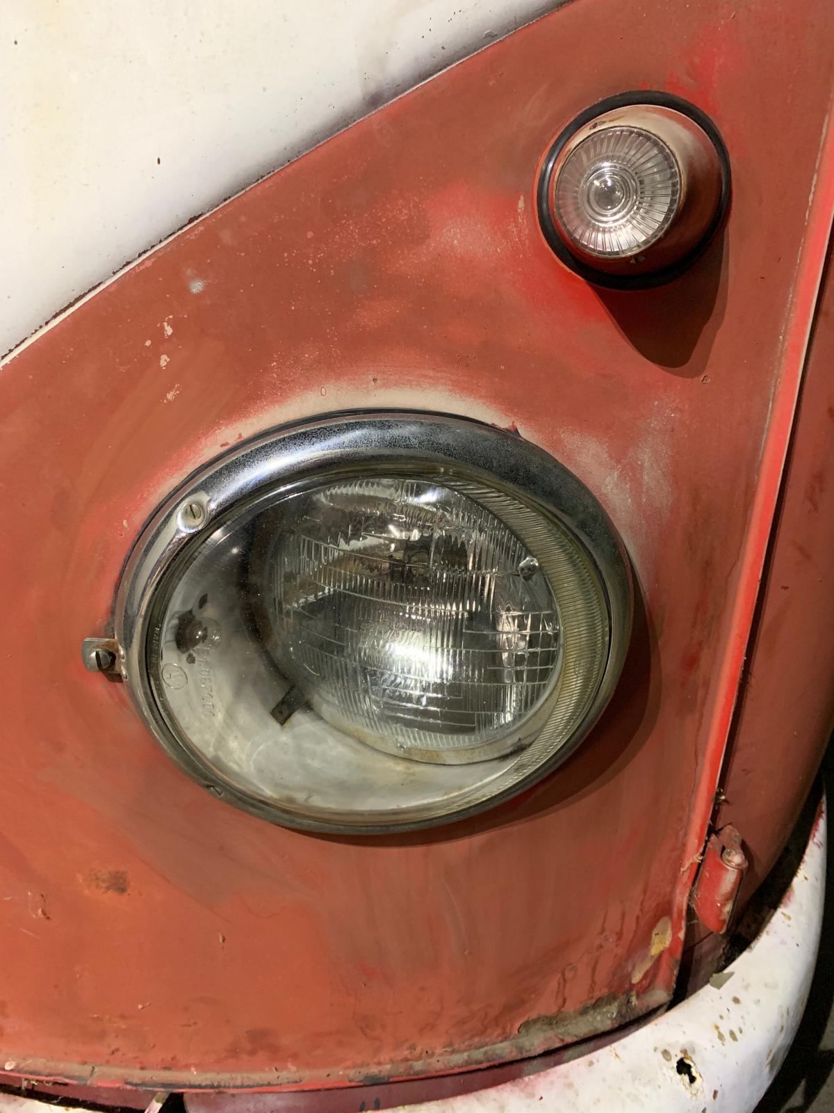

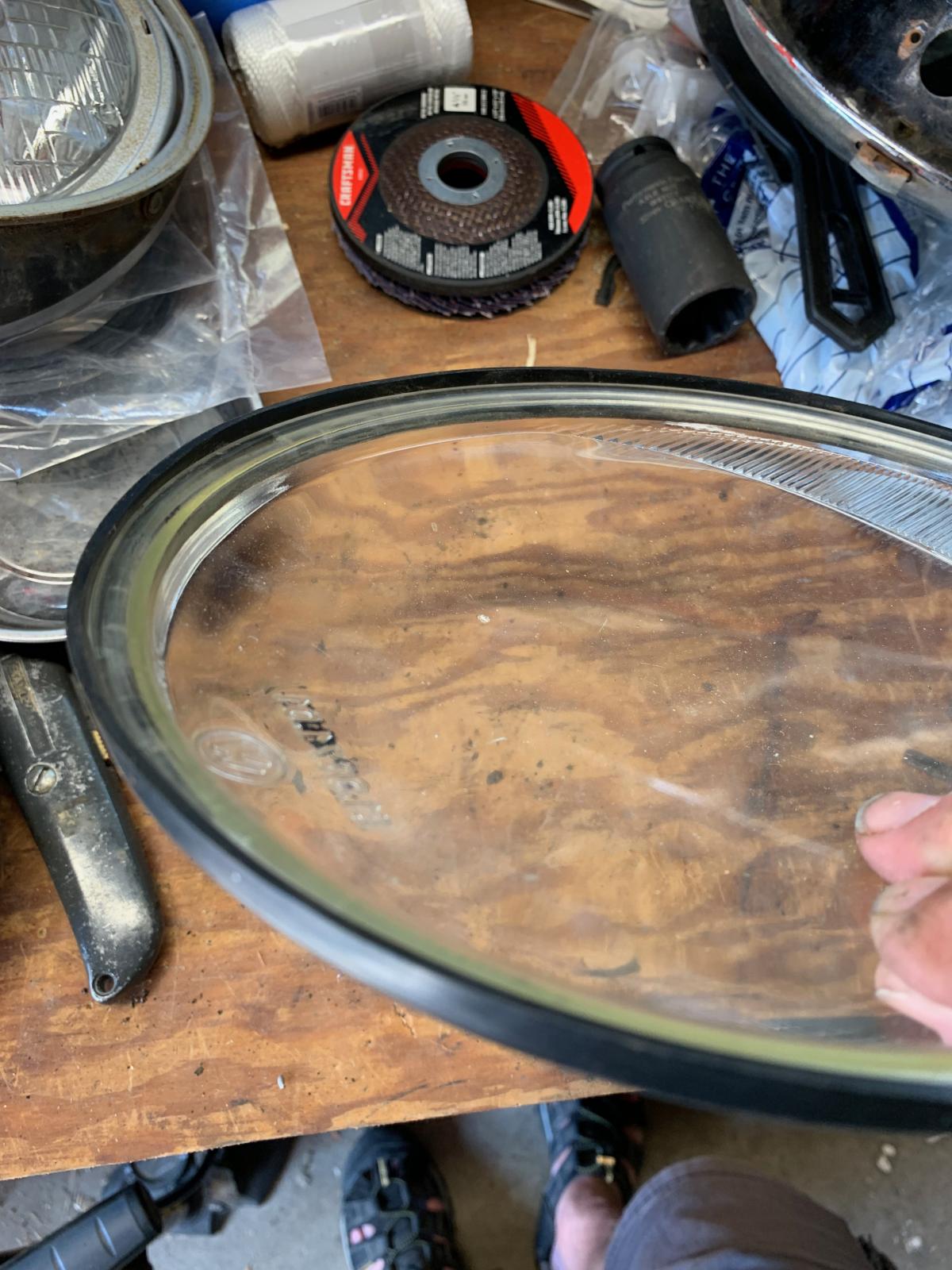

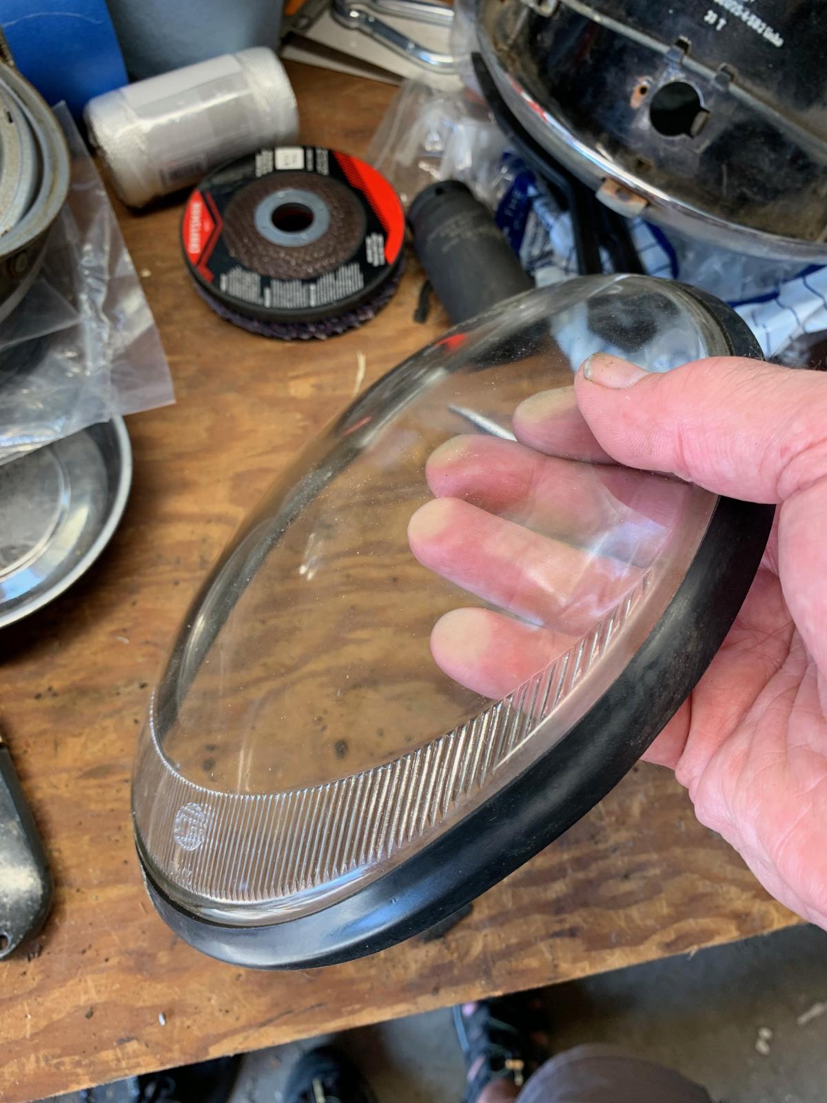

Replaced rubber on bullet turn signals...

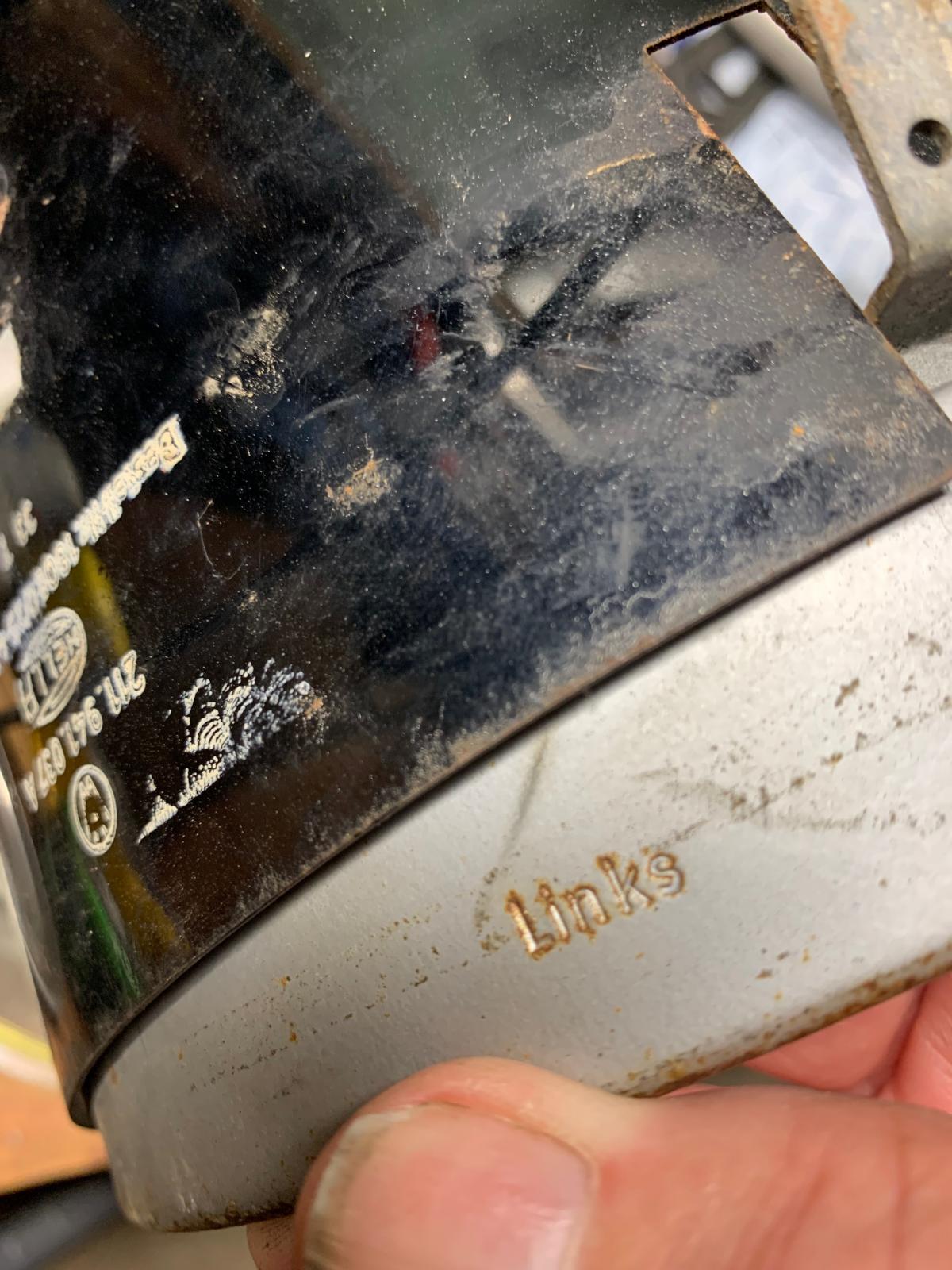

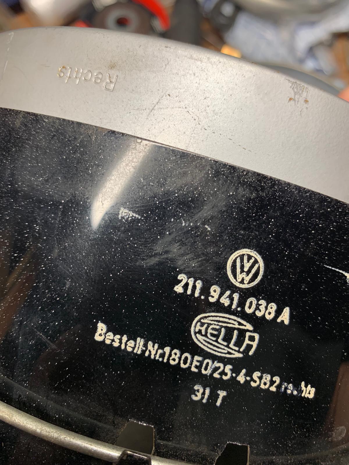

Replaced inner and outer seals on the headlights...
Love all the original parts on this truck.

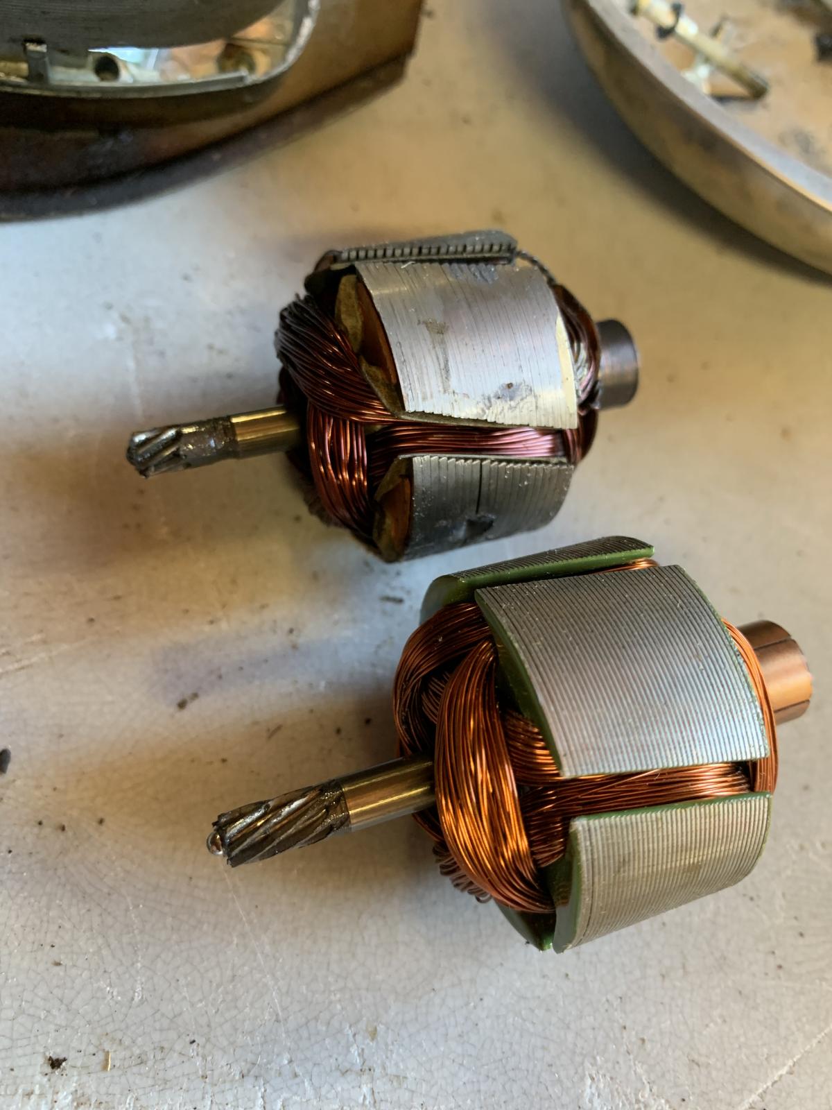

Another silly job today. I converted the armature of the wiper motor from 6V to 12V. The hardest part was getting the motor out of the dash.
More windings?
Love the old school motor parts
In it goes
Checked it with my battery charger and it worked fine!
