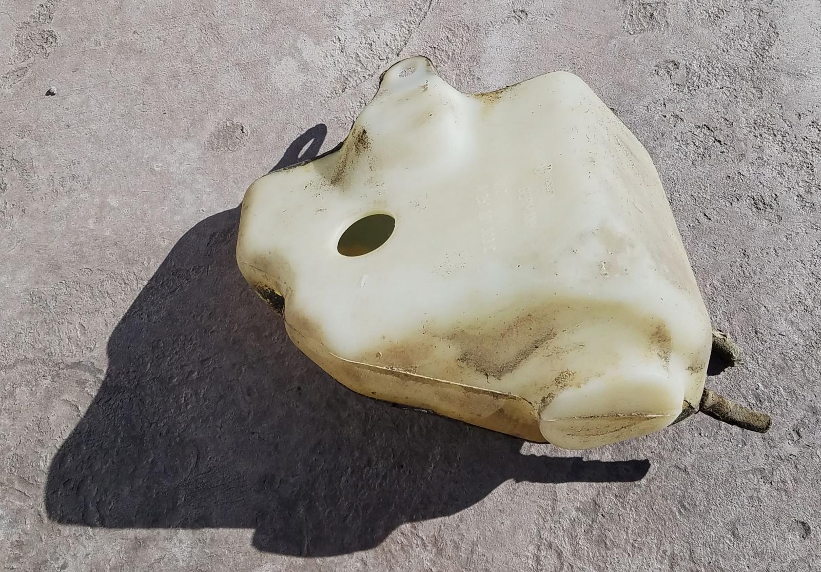

Earlier this week, the replacement gasoline evap/vapor tank that Carl/mtnhome so kindly gave to me arrived.
Thanks, Carl!
In short order the cracked tank was out and Carl's was in.
I took the opportunity to wrap it in a couple layers of aluminum tape to give it a bit more protection from tire-flung debris.
Looking at that nice out-of-stock aluminum tank, the frugal part of me wondered why one couldn't plumb both sides of the gas tank into a single evap/vapor tank located on the side opposite where you fill the gasoline.

These tanks provide room for the cold gas coming out of the ground to expand. 55º underground and 104º on a hot summer day. 16 gallons of gas will expand over a gallon. Don't know the volume of a single one. Maybe a gallon, so to be safe, they have two. But in reality, you don't put 16 cold gallons in. Maybe 14. And then you leave the station and go some where. In 20 miles, you now only have 15 gallons to heat up and a single tank should be fine.
Better to think of them as expansion tanks, not vapor tanks although they do collect vapor and send it to the charcoal canister. The Syncro solves the problem by having the fill pipe below the top of the tank so there is air space left at the top when the nozzle clicks off.
Duncan
What? AFAIK Neither tank operates this way. Take a careful look at them.
And Gasoline's volume changes approximately 1 percent for every 15-degree temperature change, according to the U.S. Government Accounting Office.Feb 1, 2019. That equates to an expansion of 3% from 55 to 100 degrees. 3% of 16 gallons is 1/2 gallon.

OK--once again my prediction that the Dow would go to 10k after covid and that this: https://bringatrailer.com/listing/1964-volkswagen-bus-27/ would not top 125 show a pattern of not getting things right. I made my comments after spending quite a bit of time investigating adding an aux 15 gallon fuel tank over the tranny of my 1WD tintop. Did the research and came up with.............apparently the wrong info.
Bottom line, one expansion/vapor/evap tank should do fine.

It is true that Syncro tanks have their expansion space inside the top of the tank, essentially 2 expansion "tanks" built in.
All vans have a filler vent hose to let air escape as the tank fills with gas.
2wd has that vent hose connected at the highest point of the tank and thus the 2wd tank can be filled completely. That is why the external expansion tanks in 2wd, so a completely full tank has a contained place for expanding fuel to go.
In Syncro the filler vent hose attaches slightly down from the highest point of the tank and thus the tank can't be filled completely before the pump shuts off. The remaining space is the expansion space. There is a slight valley down the middle of the tank top and this divides the expansion space into two sections. There is a rollover valve in each section to let air out as the fuel slowly expands.

And thanks, Mark for bailing me out. My calculation of gas expanding a gallon was based on the stock tank of 16 gallons plus my aux of 15. Sorry I forgot that was how I came up with a gallon.
