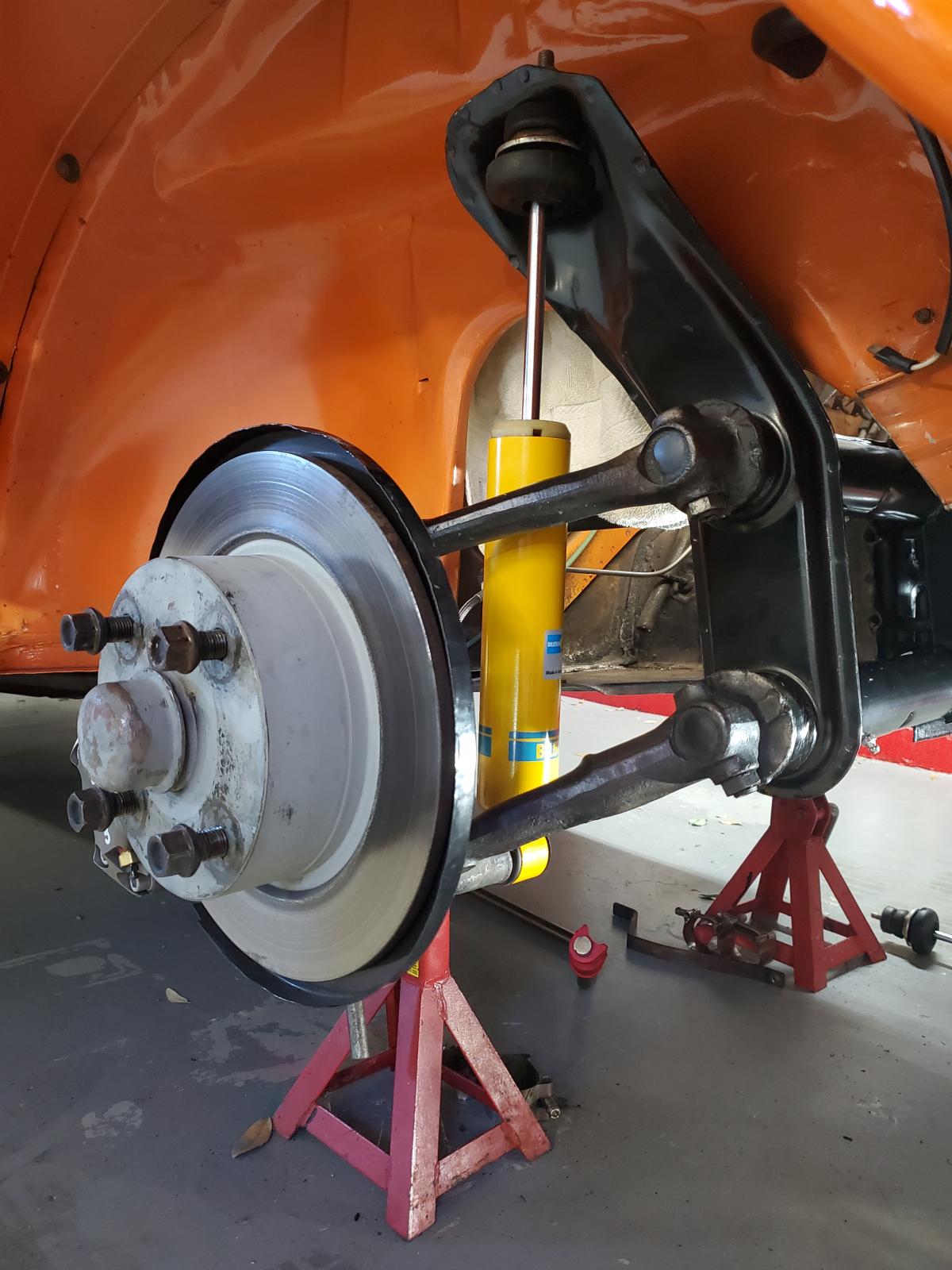

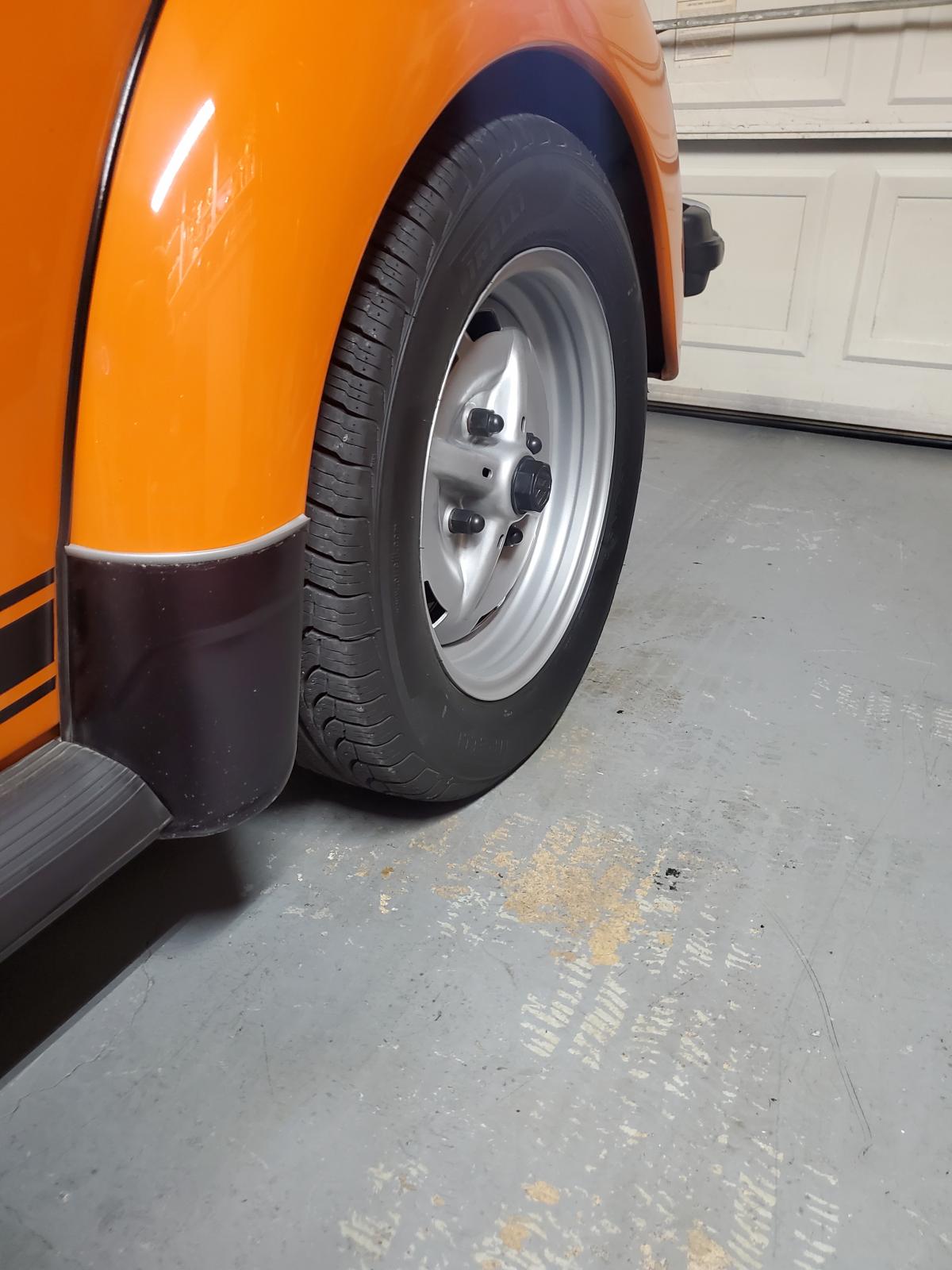

Been working on the Bug "Chester", last week was huge.
I installed a Puma Adjustable front beam w/ caster shims, an NOS SWF Turn Signal switch/ arm, wired up the Mexi-Bug OEM electric windshield washer, installed new 185 60 15 front and 195 65 15 rear Pirelli tires, and installed my external oil cooler/ AN8 fittings/ Lines. The cooler and external filter are connected to a full flow oil pump. I had to clearance the pulley tin, but otherwise all looks same, this modification should prove out later this year when our temperatures here reach 90-100.
As for the front end, it's now 2" dropped from where it was before, front height is at 24 1/2" (floor to fender lip), the rear torsion is unmolested, sits at approx 26 1/4". I plan to lower the rear 1 to 1.5" sometime in the near future. I also modified those front shock bump-stops (trimmed half of it off), reinstalled the Bilsteins, took off the Saches oil shocks (soft ride). Enjoy!
I also noticed that my car did not have any locking tabs on the bolts for the original front beam, I can only assume that those were not installed for YOM 1974. As my car is (was) unmolested and original, original beam with tow loop on passenger side.

Your Bug looks fantastic!!!
Can I ask you a couple of questions; what are you using for wax for that shine?
Is Armor Shine any good? Also, I noticed that your I-beam shims are installed on the outside, mine are installed on the inside. Is that bad?? Lastly what shocks did u install on the front when u dropped it down??
Thanks for all the help, she is beautiful!!

Hi, what shims are tou referrimg too? the front beam caster shims? Kamei Spoiler shims?
The front shocks are Bilstein HDs with a modified bump stop. I had Saches oil filled when the car was stock height.
