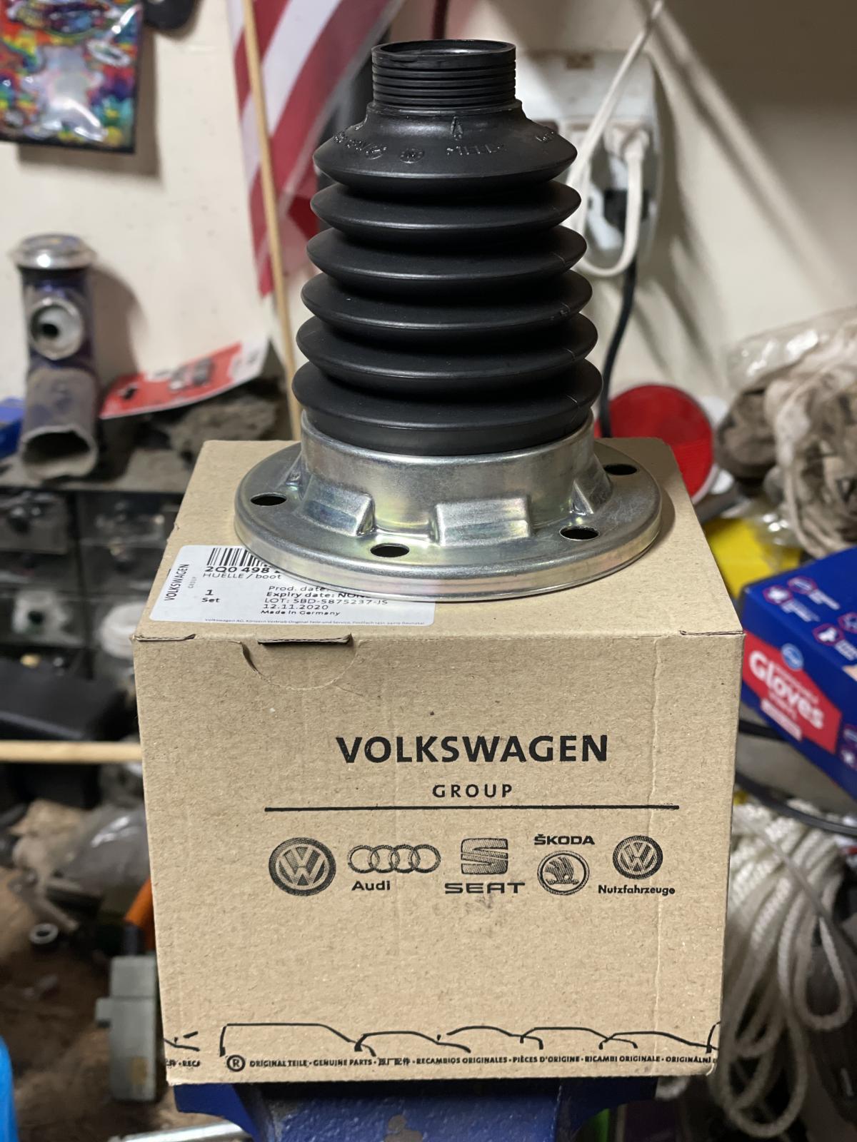

PostPosted: Thu Oct 07, 2021 12:09 pm    Post subject: Re: CV Boot Best Brand and Supplier FAQ Reply with quote
markd89
Joined: November 04, 2005
Posts: 677
Location: Los Angeles
markd89 is offline
PostPosted: Thu Oct 07, 2021 12:20 pm    Post subject: Re: CV Boot Best Brand and Supplier FAQ Reply with quote
That's a different boot than German Supply's Rockford. There's another pleat or two.
I ordered 4 but have yet to put them into service.

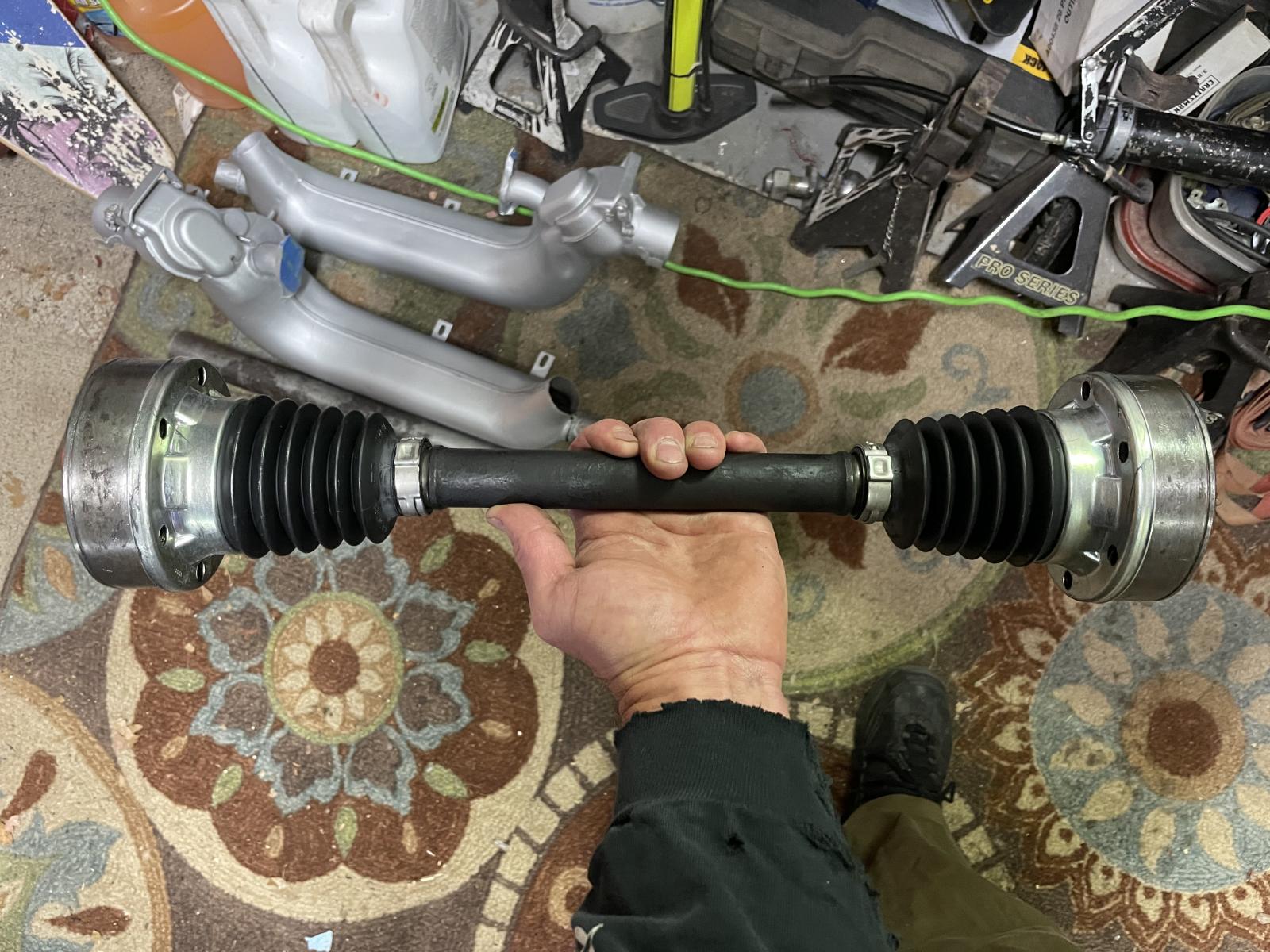

I ordered the 1K0498201 boots from FCP Euro. I was able to buy four OEM VW/Audi boots from them for $35.99/ea. They came with the clamp, C-Clip, the spacer and I bought CV grease from NAPA. I have the axles all broke down, I cleaned and rebuilt the CV joints and I painted the axles. Hoping to reassemble and install them this weekend. I will post pics of the completed axle installed.
Thanks to the person who discovered that these boots fit and thanks to all the people who have installed them and posted their results. 🙌

I borrowed a crip tool from a buddy and finished up the axle rebuilt and installed them. They fit perfect and look pretty good. I will update in the future with their durability.
