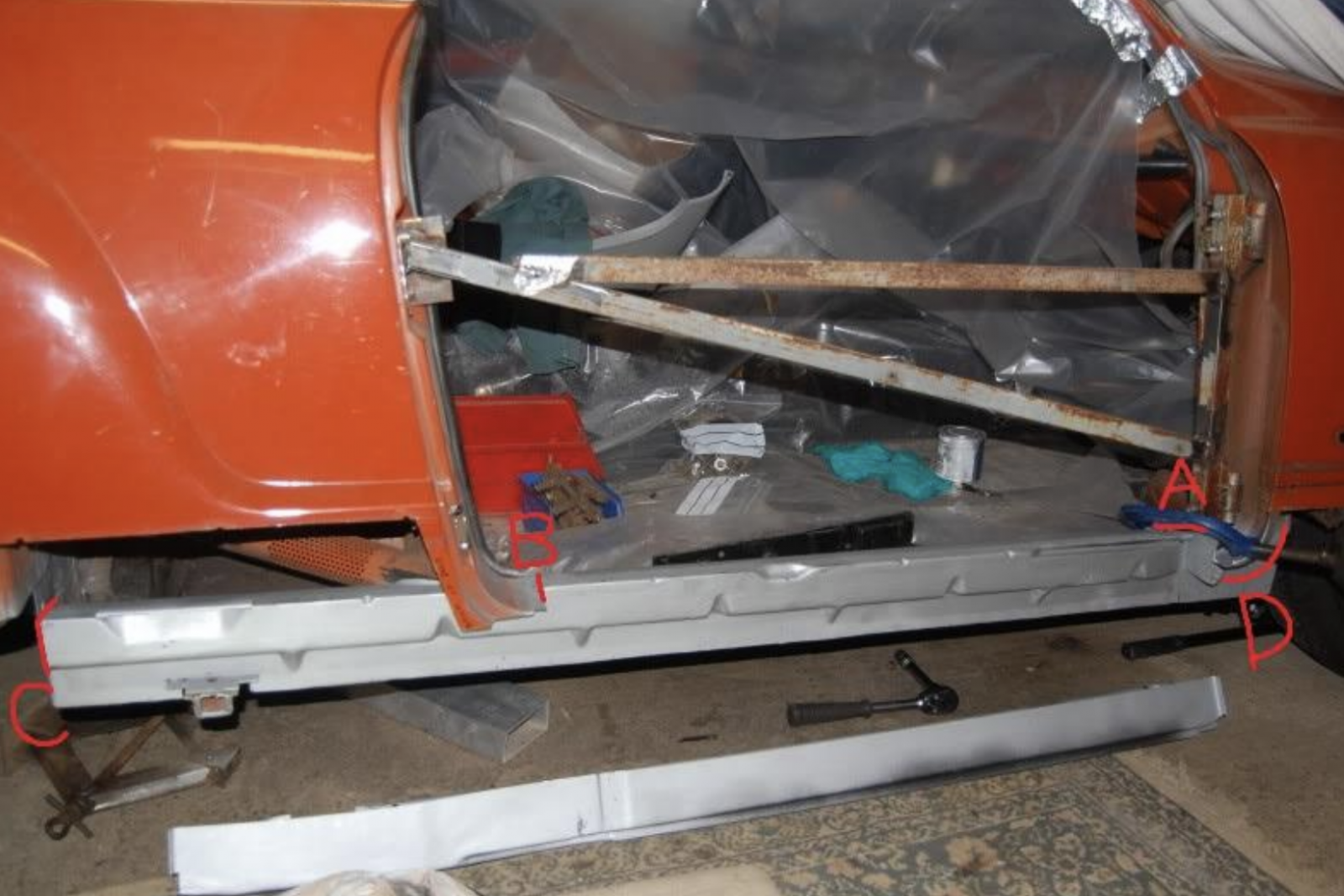

Hi Guys, hit a snag?
I was try to dry fit the rocker panel and found I could not get it around the door post to put it in place
I found this photo of somebody elses car that shows the problem
It's the area (B)
I;m kinda thinking I might have to put out the bottom of the door post to make space to fit the rocker panel, It will be a shame as then i'll be messing with the original door frame and fit of the door.
If you have an ideas i'd love to hear 'em
Cheers
RT

Not a lot more you have to remove on that piece. You'll see the lap 30mm up from where you made the cut. I ground down the lap weld then used a hacksaw to get through the rocker. There should be ~1mm gap between the post and HC allowing the rocker to slip in. As your HC is in place not a lot should move. It was also the last weld to be done once verifying the doors fit.

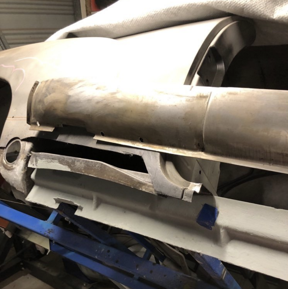

One of the many times testing the rocker fit.

Thanks Gobur, so if I trim like yours I should be able to pull out the last piece of Rocker .. and then slide in the replacement rocker!
Any last welds or things to look out for when getting the last bit out, it is sitting pretty tight at moment!

I see yours is a spot welded to the rocker. If i recall correctly mine was a lap weld. Either way you should end up with a gap (~1mm) to the HC. Getting the rocker in is a matter of angling it up. Fortunately it can twist enough to get it by the low part of the lip. No hammering just a few solid hits with the hand. If its too tight no reason you couldn't cut the horizontal section (only) back a little more.
No other snags I know of for a coupe. Cabriolets have a brace further back that is a bit troublesome in getting the rocker under.
Once in place check the curve against the front and rear quarters. I had to alter the arc slightly.
