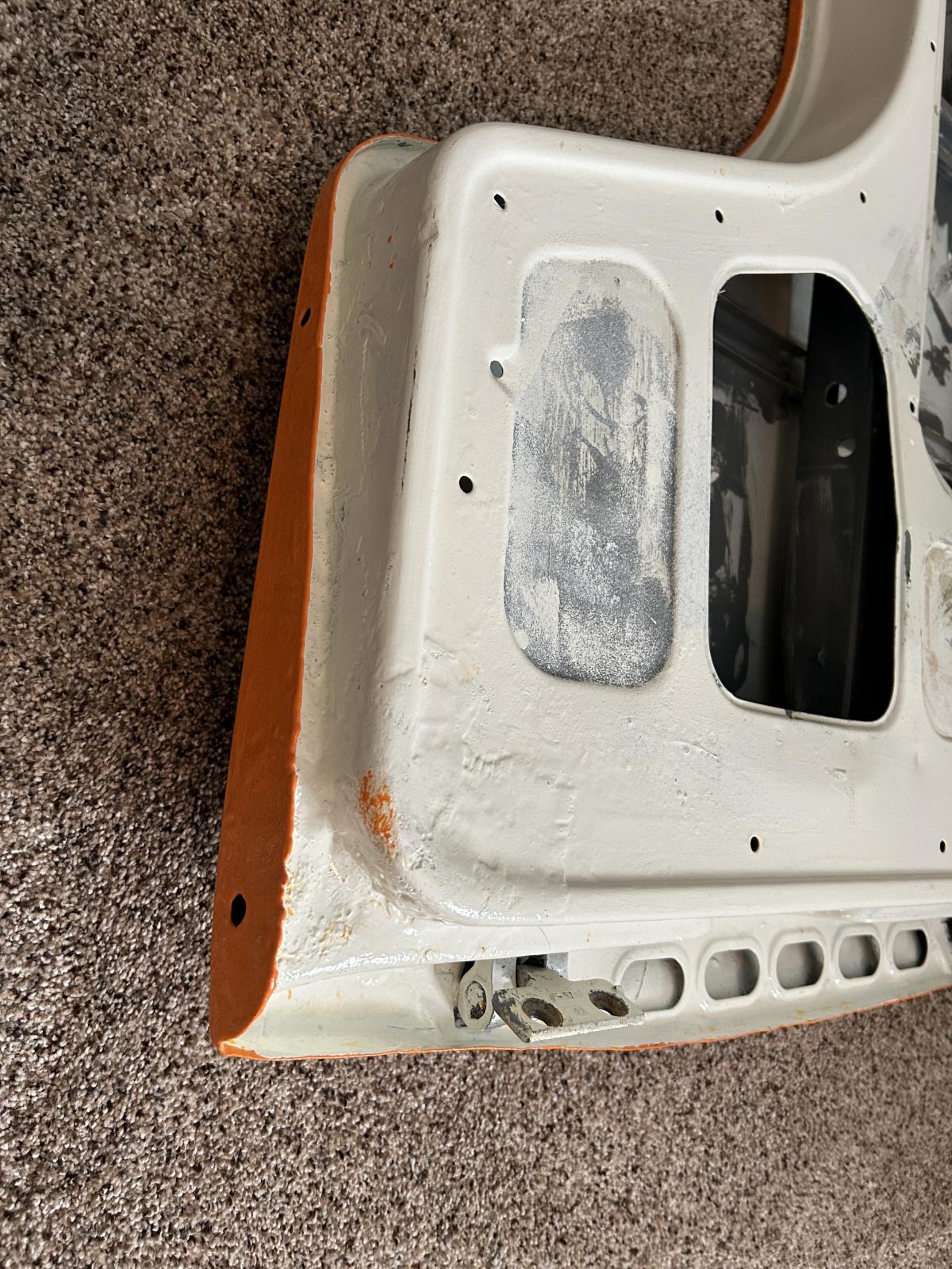

PostPosted: Mon Dec 19, 2022 11:30 am    Post subject: Re: Let the process of saving 2222069996 begin Reply with quote
malcolm2 wrote:
A permanent temporary fix for the drivers door. As I mentioned, I cleaned the rust and used the POR-15 marine clean and metal ready prep. Then 1 coat of POR-15, a bit of ruffing up and a 2nd coat of POR-15 and a couple layers of tight mesh fiberglass. I call it a hippie fix.
I will own and drive this bus, so I will monitor the fix, see how long it lasts. The last step will be to ruff it up and smooth out the fiberglass, then go with a high quality top coat. More pix on that soon.
It has been a while, and this door is still not installed, but here is the finished paint job, etc...
