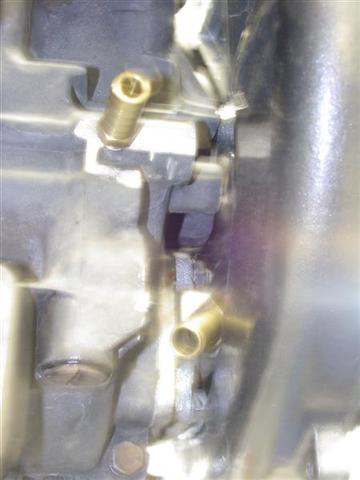

It can be done without grinding the case, or spacing it out. Those pictures are of Jim Adney's installation.

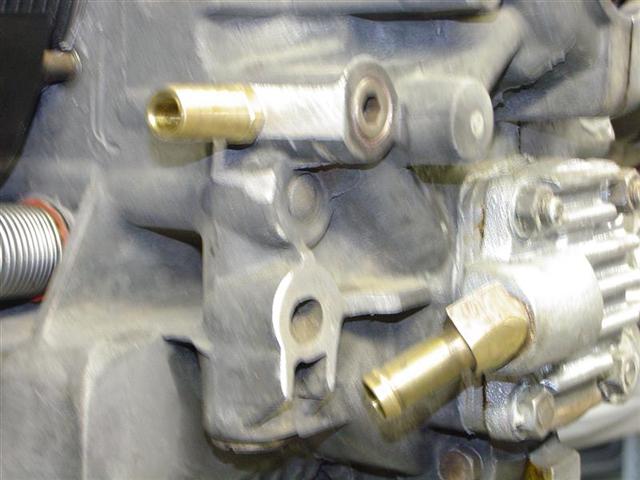

PostPosted: Wed Apr 11, 2007 4:13 pm    Post subject: Reply with quote
the secret is the Gene Berg type 3 full flow pump cover

PostPosted: Wed Apr 11, 2007 5:16 pm    Post subject: Reply with quote
The Gene Berg kit does a good job but it's still a very tight fit back there. My fan housing still required very minor clearancing.

PostPosted: Wed Apr 11, 2007 5:32 pm    Post subject: Reply with quote
FASTBACKDON wrote:
Really? Ok thanks for the warning I need a berg fullflow for my 2 liter. what clearancing is involved send or post pictures.
Thanks Mark
Don
Really minor though, Don. Mainly one of the raised "fins" on the rear molded into the housing for strengthening. I'll see if I can find a pic of it. If not I have to raise it up and crawl under there for some pics for Brian so I'll try to get some as best as possible.

PostPosted: Wed Apr 11, 2007 6:57 pm    Post subject: Reply with quote
I really like my engine builders plan. No angles... No adjusting anything...
If you look closely, there is a brass block off between the holes.

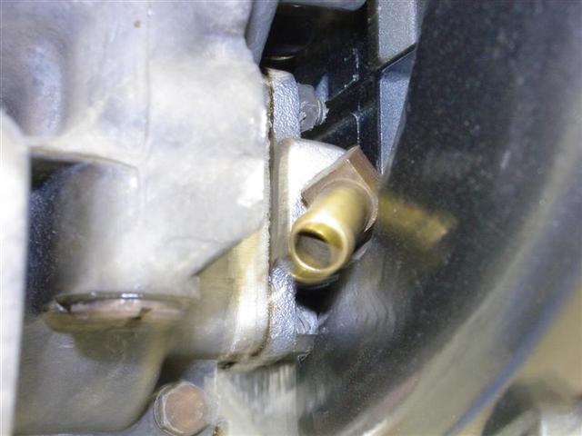

PostPosted: Wed Apr 11, 2007 7:01 pm    Post subject: Reply with quote
Max Welton wrote:
Unless I am mistaken, the only difference between the Berg type-1 and type-3 kits are the fittings. I just changed the fittings on mine.
Max
Yeah it's got a different brass fitting that's slightly clearanced on one side to clear the fan housing.

PostPosted: Thu Apr 12, 2007 11:17 pm    Post subject: Reply with quote
You guys were right. Very Happy
The fan did touch the shroud with those spacers. And I did have to take some material off one of the ribs to clear the right side of the pump cover.

PostPosted: Thu Apr 12, 2007 11:37 pm    Post subject: Reply with quote
True...but the Berg pressure regulating unit is the better choice. Keeps your oil filter from exploding Wink
P.S. I like Phillip's solution the best!

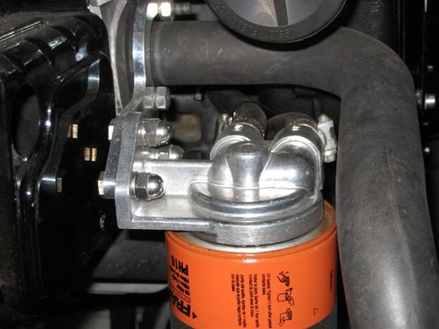

PostPosted: Tue May 01, 2007 9:18 pm    Post subject: Reply with quote
Now we're cookin. Cool
I will make a bracket to place the filter farther forward and a little higher. But there it is.

Critter1
Joined: August 04, 2004
Posts: 1579
Location: Sacramento
Critter1 is offline
PostPosted: Wed May 02, 2007 6:00 pm    Post subject: Reply with quote
Here are some pics of how mine was done. Had to shave some material off the back of the shroud as well as shave some meat off the brass fitting.
This filter mount worked for me since I have merged headers and no heater boxes.
Justin
Russ Wolfe
Joined: October 08, 2004
Posts: 25187
Location: Central Iowa
Russ Wolfe is offline
PostPosted: Wed May 02, 2007 8:00 pm    Post subject: Reply with quote
Don't know if I like the filter that close to the headers. It will add heat to the oil.
And, it looks like you are not an IRS engine with the cross member.
Gary: OK. Ima poop.
localboy
Samba Longboarder
Joined: December 06, 2003
Posts: 5153
Location: "Mainland", PNW
localboy is offline
PostPosted: Wed May 02, 2007 8:19 pm    Post subject: Reply with quote
Agree, Russ. I fab'd a simple bracket to use the bumper mounting location with just longer bolts. My oil filter sits above the driver's side bumper bracket and the steel braided hoses clear the headers by a few inches. Now if I could only get the breather box hoses to run so cleanly. Evil or Very Mad
