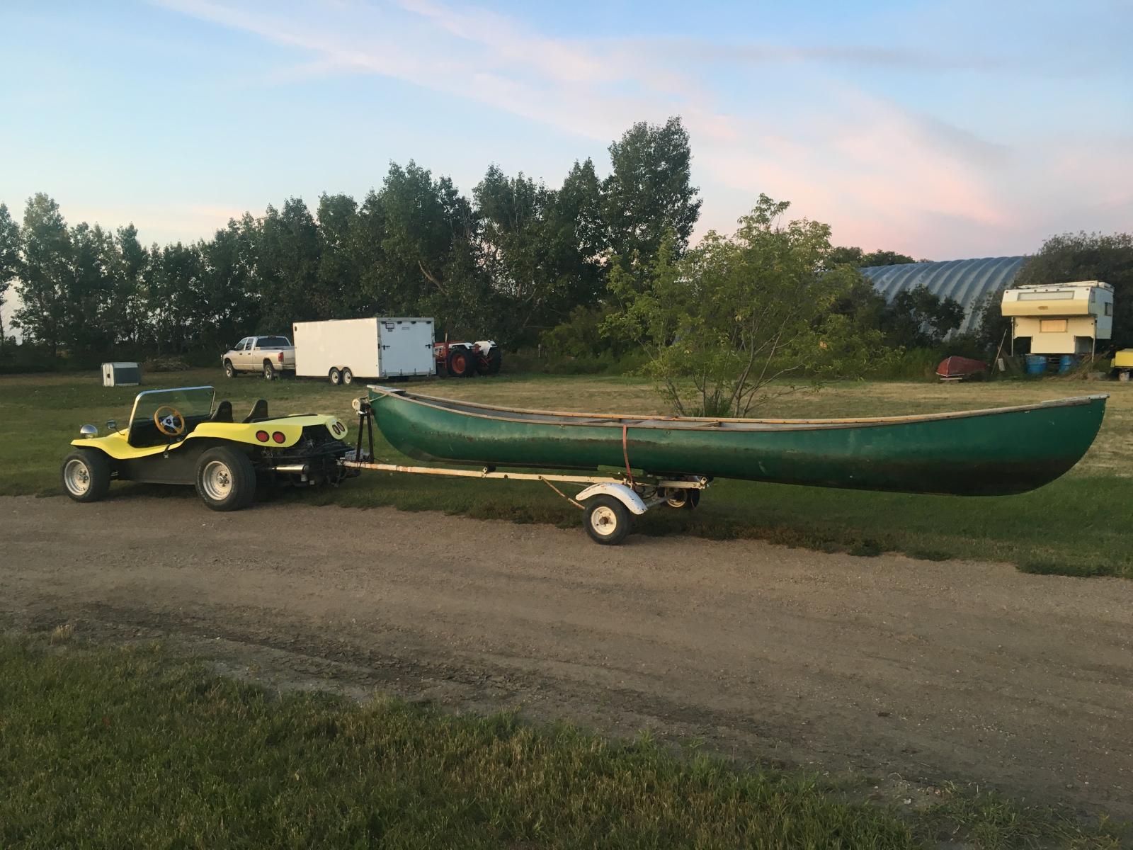

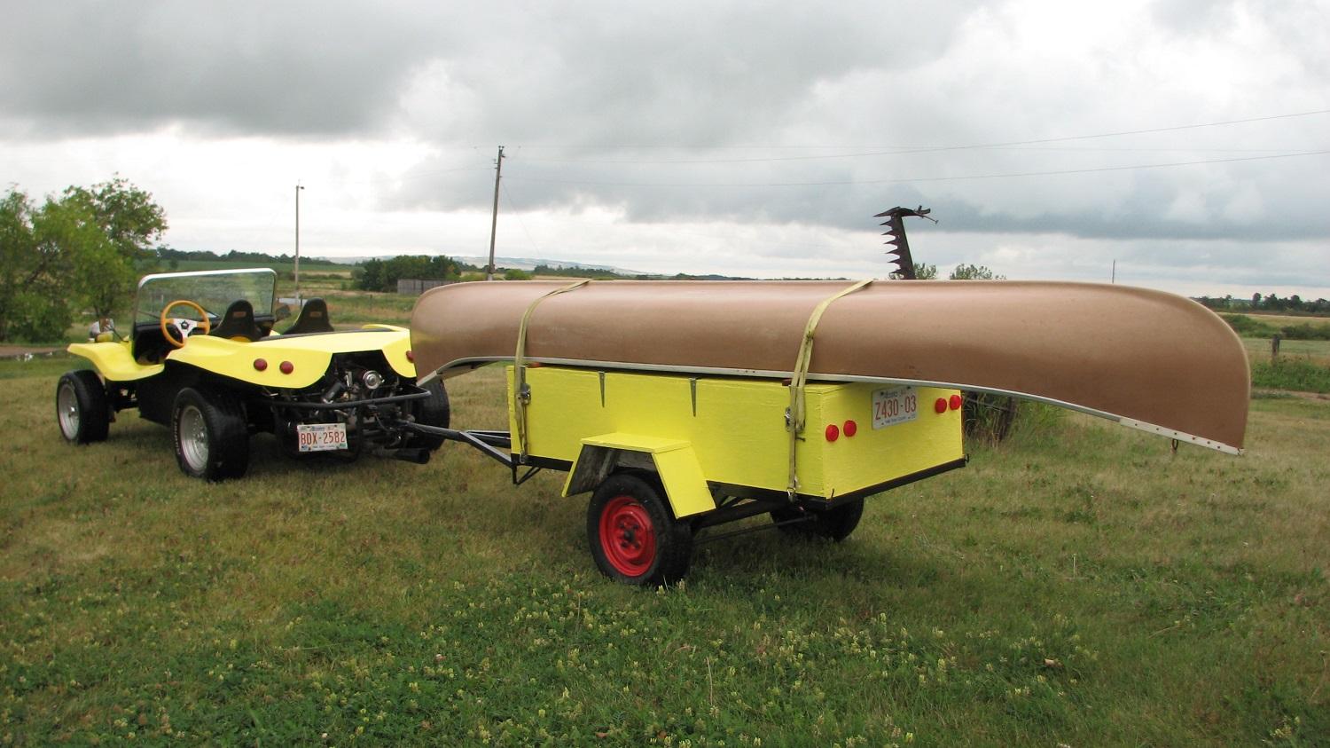

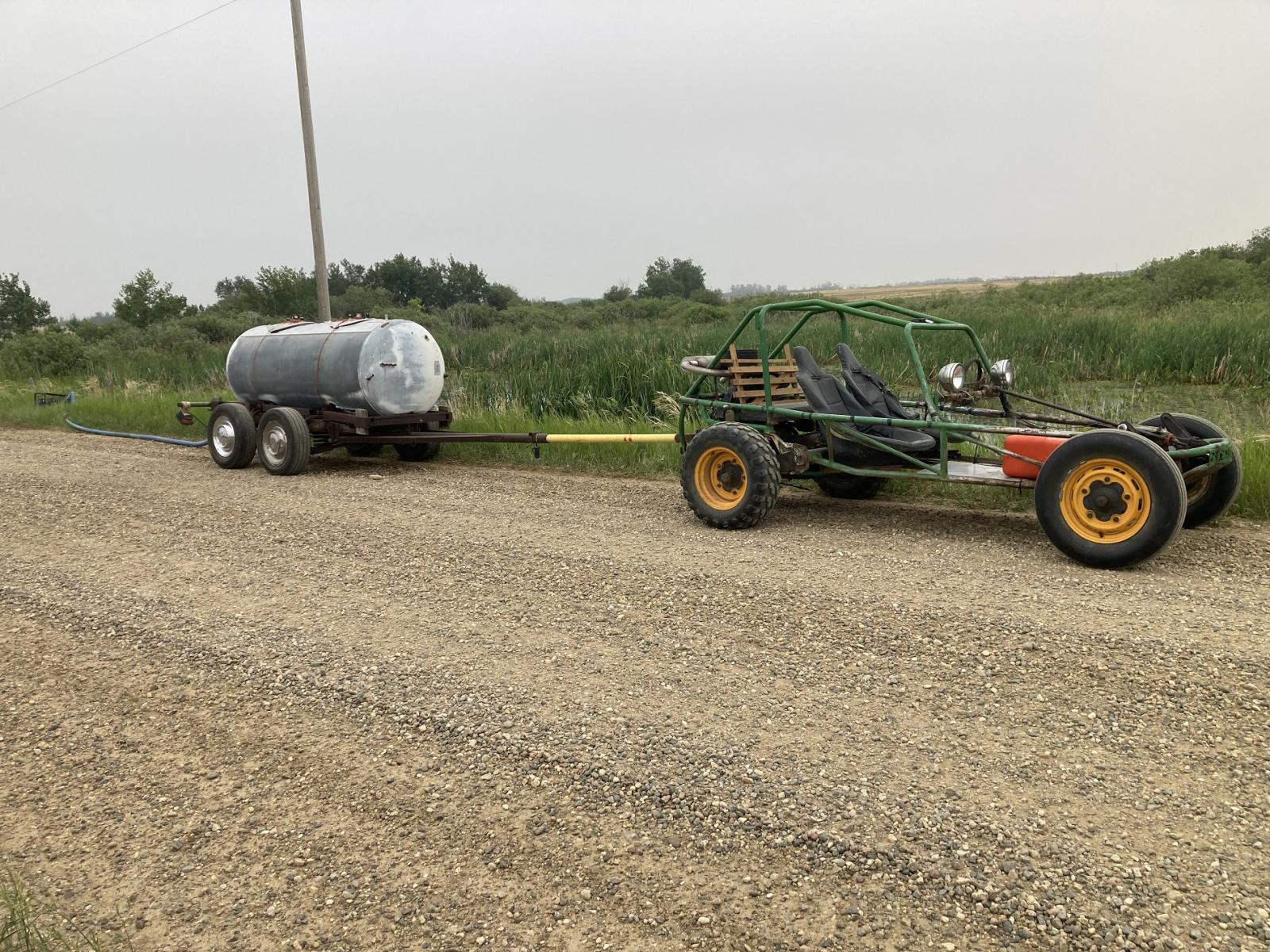

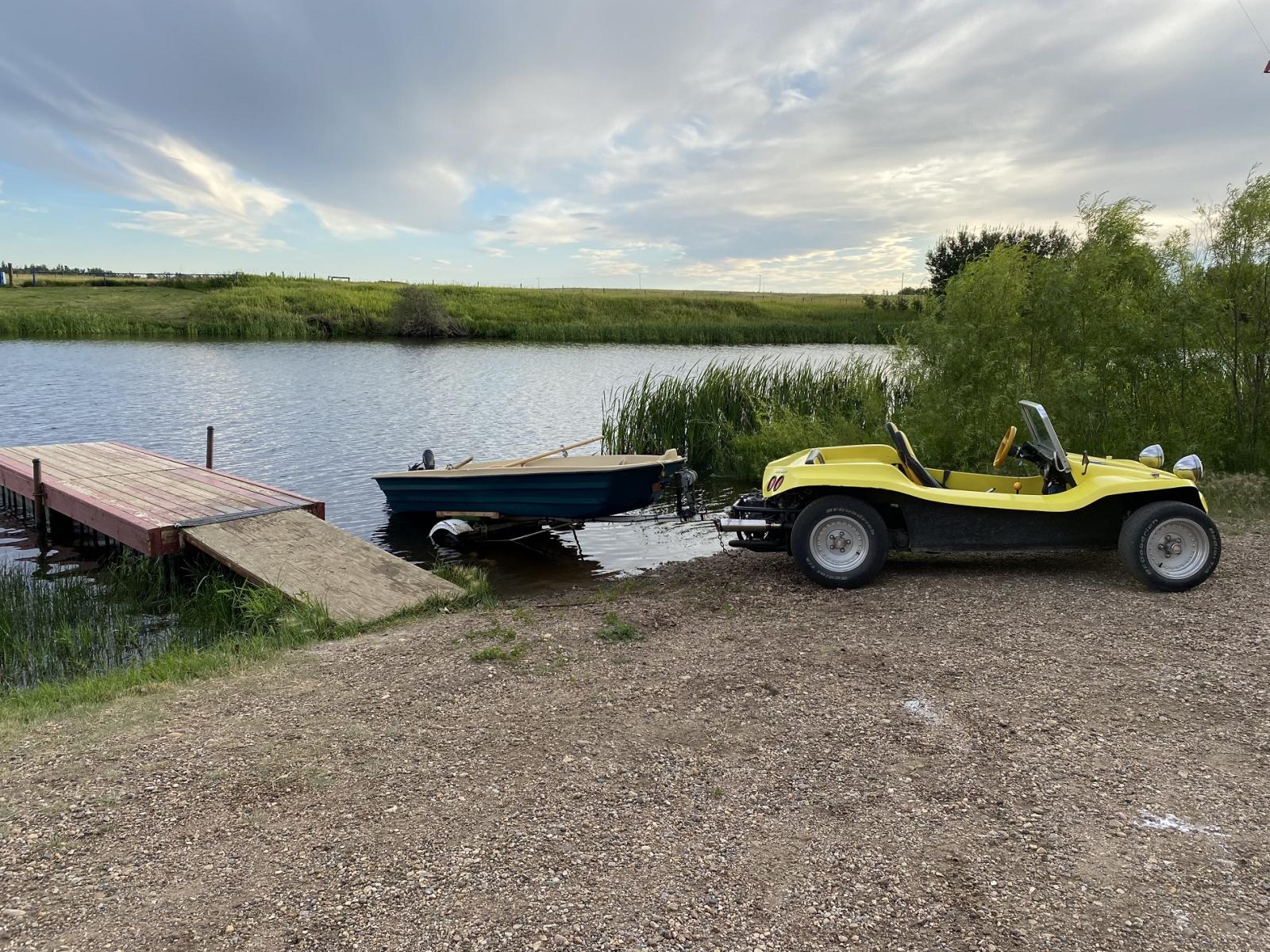

Here ya go! Discuss away to your heart's content. My usual practice is to put a trailer hitch on everything I own. I can tow the rail behind the Manx copy or the other way around if it suits me. I can tow either Buggy with the Jetta or the truck too as well as any trailer or implement in the yard. I can tow either Buggy out to the field with the tractor.
The 18' car trailer and the 20' cargo trailer in picture #4 however only go behind the truck if they leave the yard.

Can I just say, I love those pics and how you use your buggies.

PostPosted: Mon May 12, 2025 4:53 am    Post subject: Re: towing a light trailer w/sand rail Reply with quote
Thanks! All I will say is that I use them!
