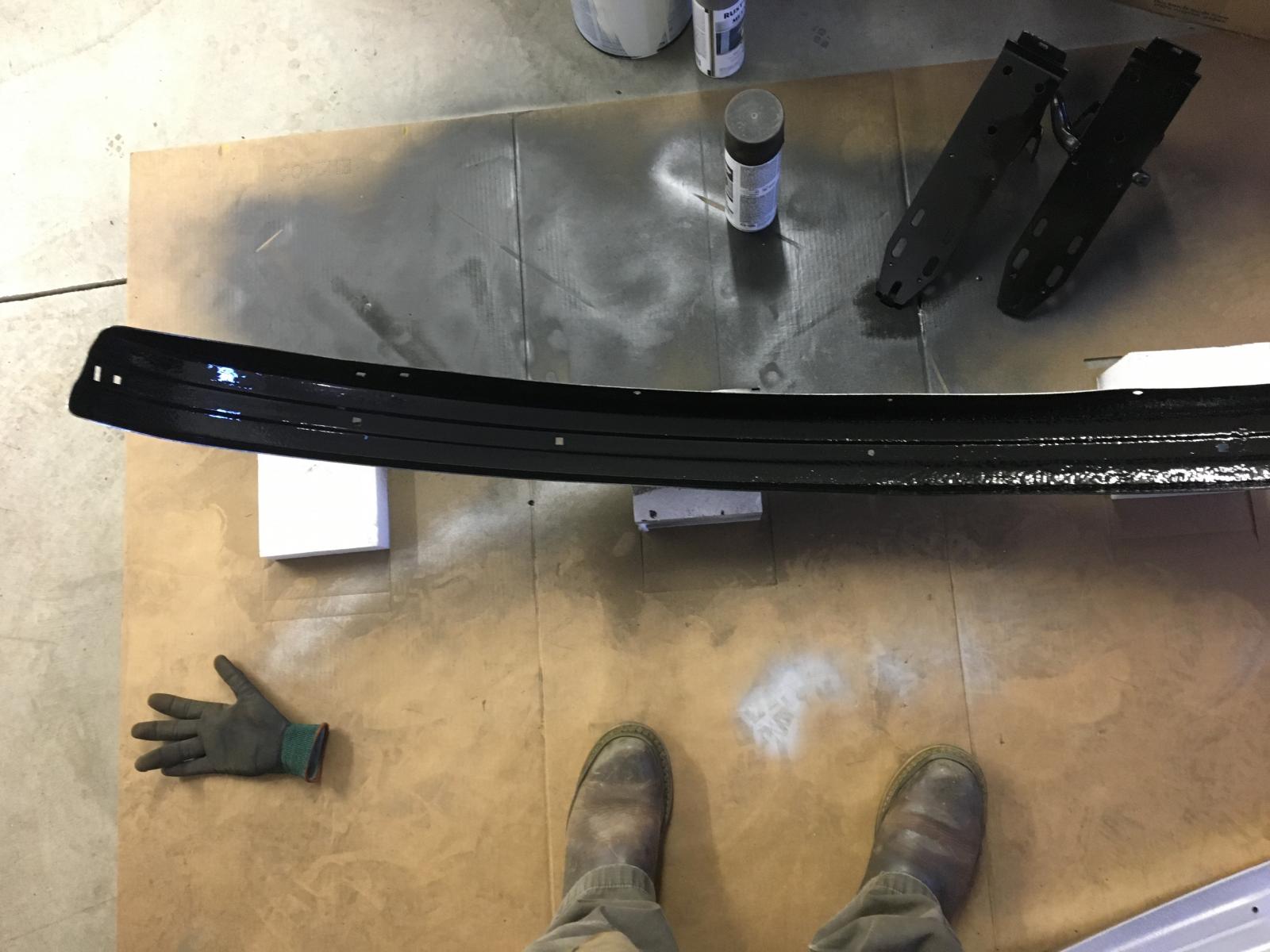

Finally got the bumpers finished. Ended up polishing the fronts with Mother's Mag & Aluminum. I may end up getting a Flitz ball later on and chrome polish for that extra touch, but I am happy with the progress on them so far.

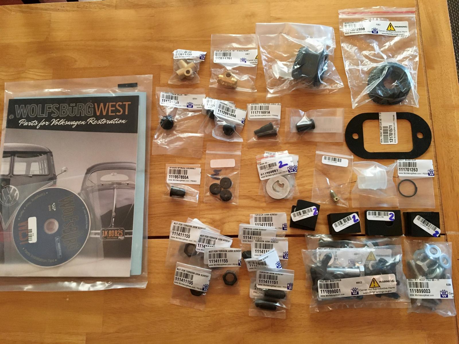

Got my haul in from Wolfsburg West. Very fast shipping and good customer service, I am impressed! Will do business with them again for sure!
Received all the seals and gaskets for the chassis, except for the body to chassis gasket, I will order that later so it doesn't get damage during all the restoration. I also ordered some VW specific brake parts like adapter fittings, shift rod bushing and clip, and other parts that are difficult to find someplace other than a VW parts house.
On a side note, make sure you order a catalog from them! I have never seen such a nice catalog and will be a very nice resource going forward. The blow up drawings are very nice and clear and it's easy to navigate (same thing can't be said about their website).
