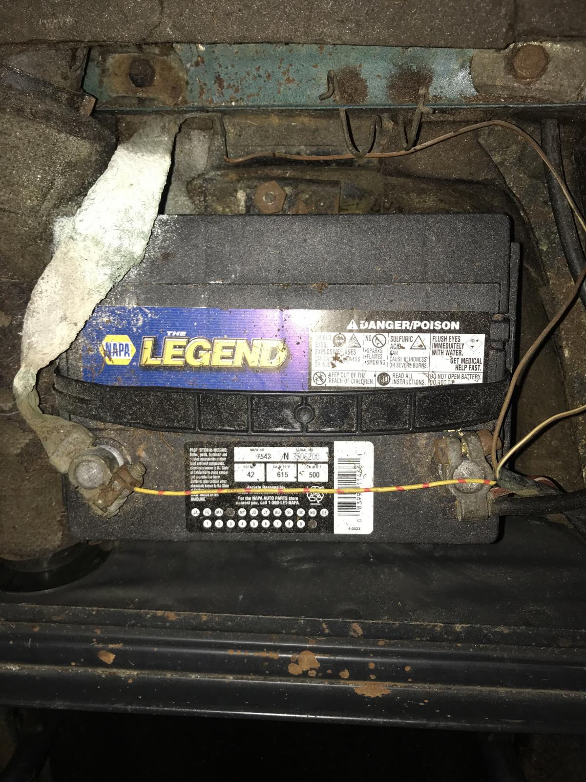

The original group 42 battery not only has recessed terminals, it is also one of the shortest automotive starter batteries available.

From the photos it looks like it may be an incorrect battery for a Beetle. I would have thought it should have a battery with recessed terminals with insulation over the positive. If it were mine I would also re route or lengthen the yellow/red trace earth wire so it doesn't stretch across the positive terminal as well.

Thank you.
I bought some terminal covers (and a fire extinguisher!) and I've got a rubber mat I'm going to put down, too.
Also, you're right-- that strap is toast. Thanks so much for the tip.

MichaelRecycle wrote:
Hi, all.
I'm new-- I hope I'm posting in the right place.
I recently bought a '74 Super Beetle. While out riding around with my son in the back, he noticed the metal bar that spans the base of the back seat was getting hot on the battery side. Is this normal? Is the heat coming from the battery?
I've included photos here of the battery's current state; I'm hoping someone here can offer some advice.
Thank you!
I'll take an educated guess at what happened. The stock battery group for a VW comes with a plastic shield over the positive terminal to prevent the spring in the bottom seat from coming into contact with it. That can easily happen with additional weight in the back seat and our now tired saggy seat springs . So people without that shield or even with it for extra protection will put a rubber mat/ piece of wood/etc over the battery to prevent the seat spring from coming into contact with the battery terminal.
I can't tell if it's just the light in the pic but that negative/ground strap looks pretty wasted. I would replace it.

Hi, all.
Thank you!
