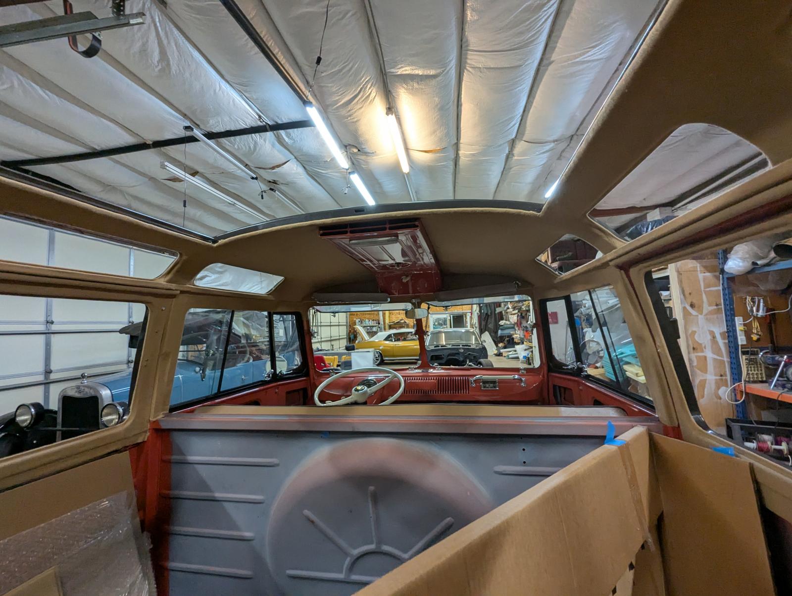

PostPosted: Today 8:35 am    Post subject: Re: What did you do for your Bus today? Reply with quote
EasyNow wrote:
Still gorgeous Thom! What is the fabric used for the interior headliner?
It's been called several things, like "mohair" or "nap cloth"
https://www.thesamba.com/vw/classifieds/detail.php?id=2733689

PostPosted: Today 6:24 am    Post subject: Re: What did you do for your Bus today? Reply with quote

PostPosted: Today 5:54 am    Post subject: Re: What did you do for your Bus today? Reply with quote
Sometimes it's not what you do for your bus, but what you have to pay someone else to do for it. I dropped in to check on the interior work, and they're almost done with the headliner. There's a couple of small issues that will need to be rectified (like the B pillar dent), but at this point I just want to get this thing done. 99% of the general populace wouldn't know better, and 80% of the bus people probably wouldn't either. There's probably mistakes in it that I don't know about.

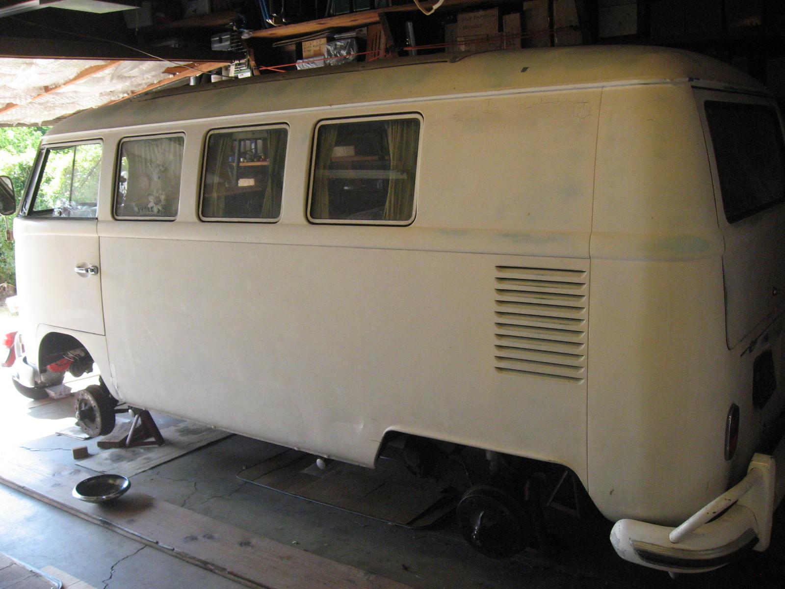

PostPosted: Mon Jul 21, 2025 4:22 pm    Post subject: Re: What did you do for your Bus today? Reply with quote
I made my apron less red. I thought light grey was hiding under the red but it was just another coat of paint. Turkis is hiding under that…
