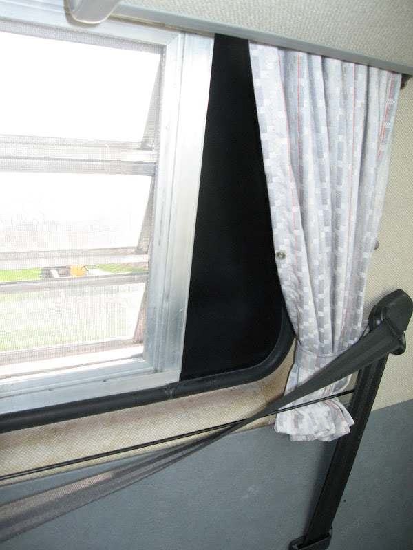

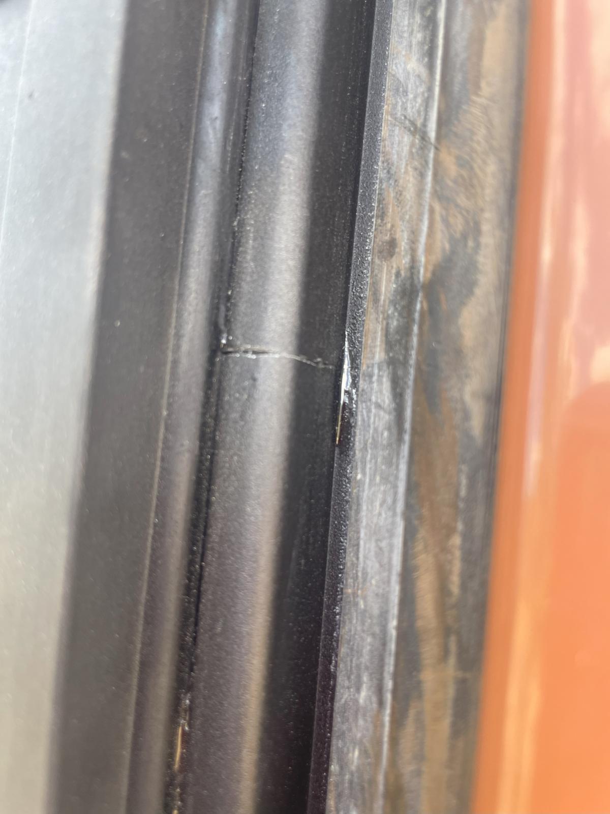

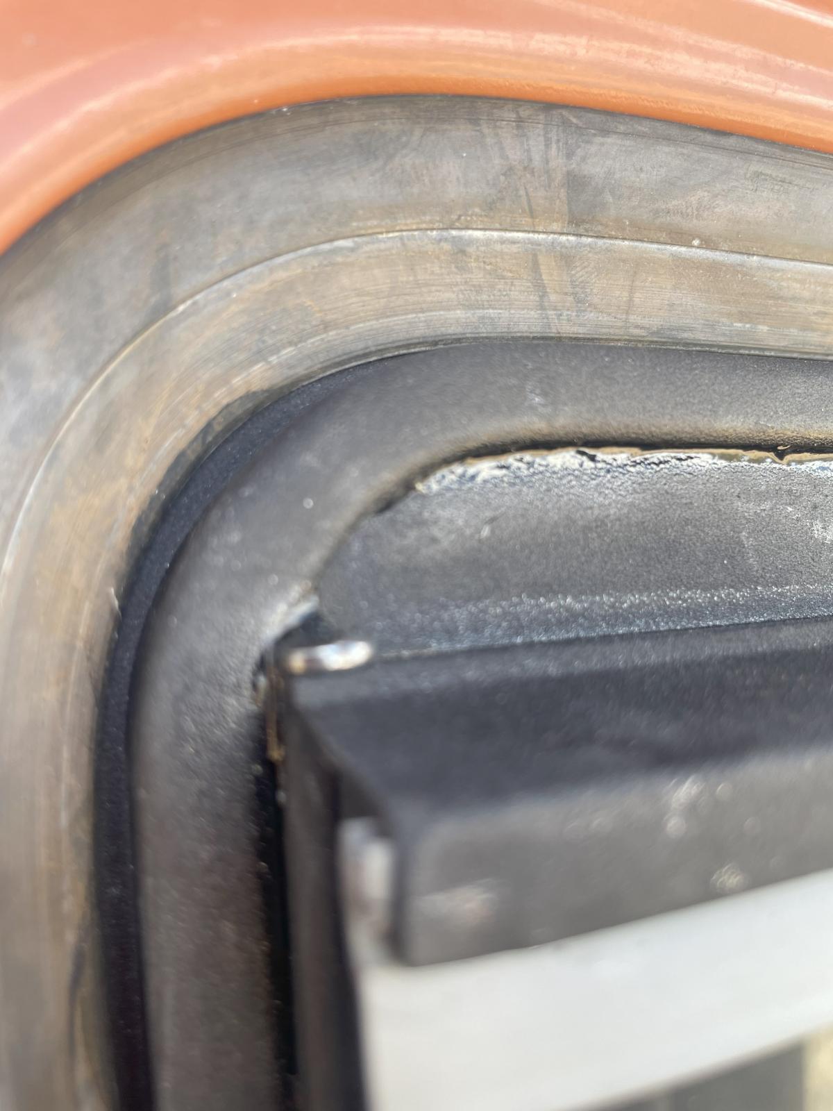

Here's mine.
This first pic was taken before installing the Westfalia style gasket.
It came out looking exactly like a factory Westfalia T2 Bus (both inside & outside) once it was finished, direct fit...
I should be able to take some better pics once it's all back together and finally cleaned up....

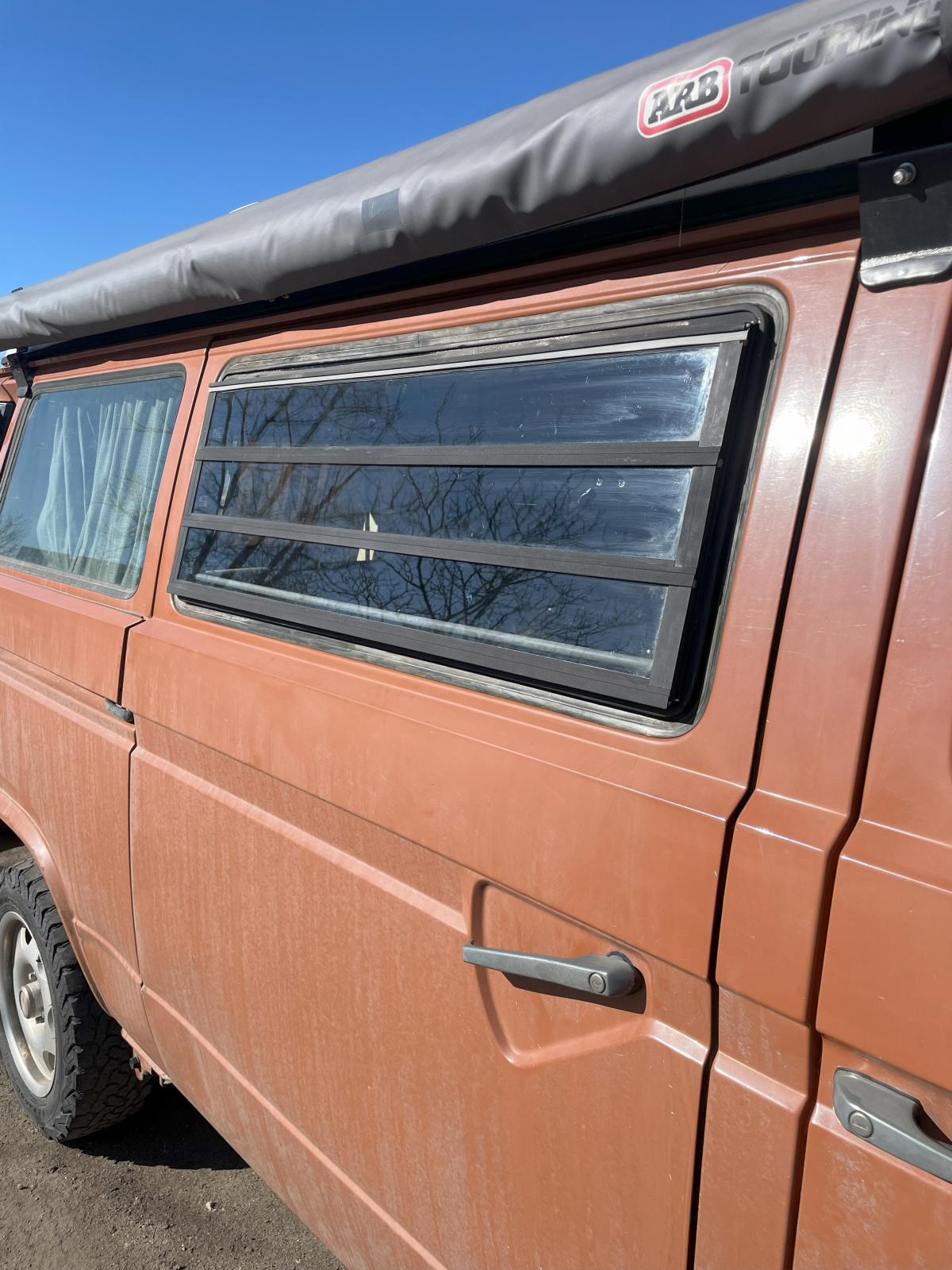

Butyl tape and button head screws/nylock nuts. On the slider you have to drill through the original sheetmetal flange and do a slight amount of trimming so the window will fit. The butyl is kinda nasty to clean up, but so far so good. Don't have a link, it's pretty easy to find. We finished it last summer and it's been great. I can have some of the plates made if there's any interest.

So instead of glue you used butyl tape? Any other details?
Got a link to the tape?

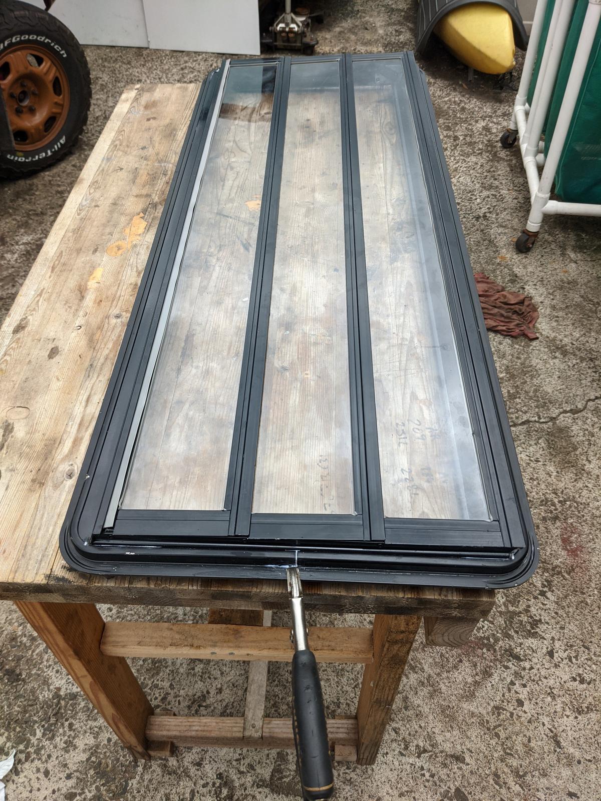

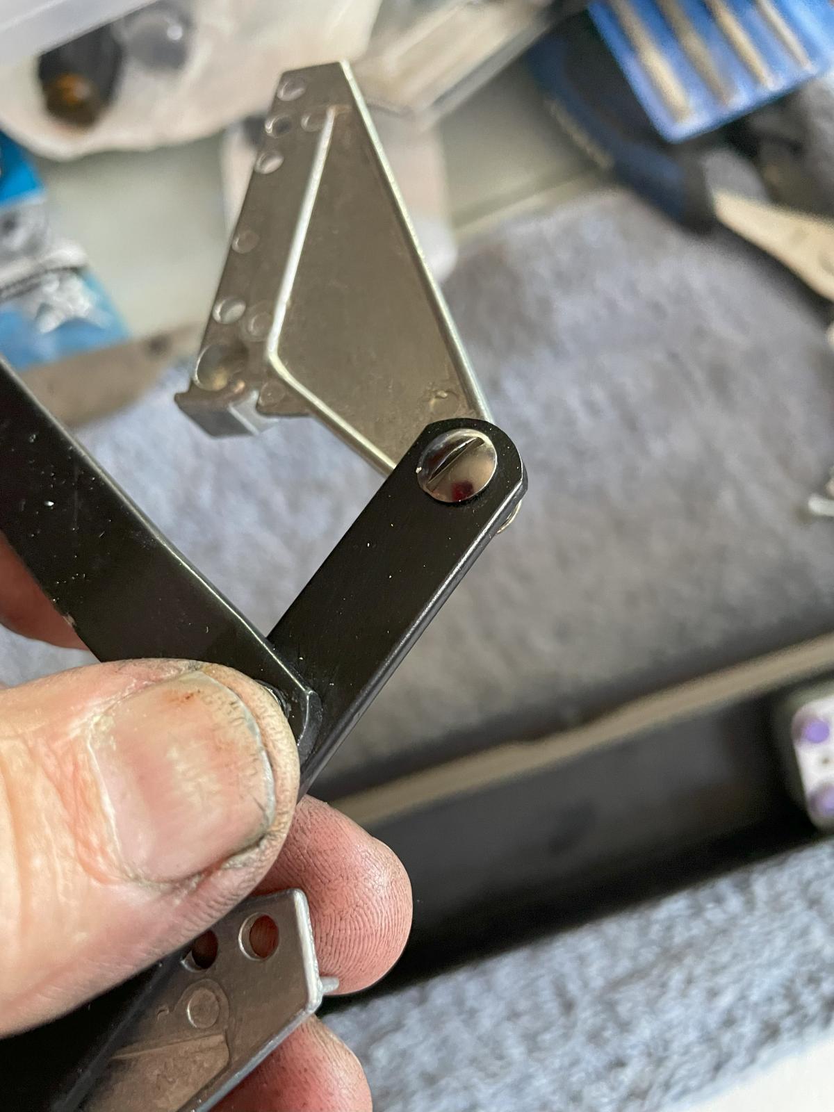

Hey all, giving this thread a little jump start with our Jalousie window retrofit. We managed to fit full size T2 Jalousie in both sides utilizing a sandwich method and some butyl tape. Works great!
Finished Product
Process Shot

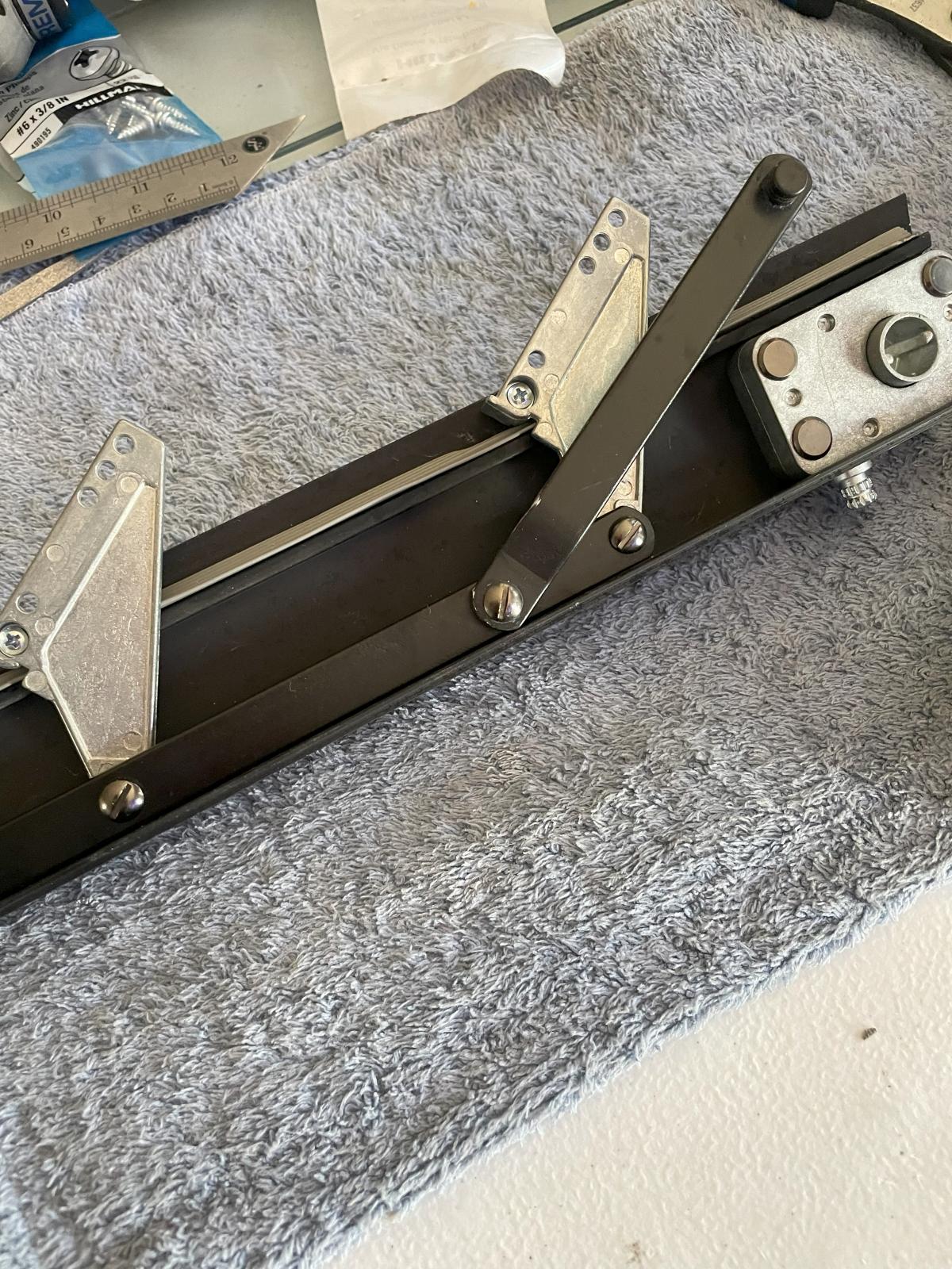

I used the Ryan Keating method and used the slider frame to mount the windw. Since I have an "84, both middle windows are the same size.
I did do a couple of things a little differently.
Instead of using rivits for the operators and crank mechanism, I bought some Chicago Screws and used Loctite when assembling. This allowed me to tighten them just right, then let the Loctite set.
https://www.amazon.com/gp/product/B076J9SKC3/ref=ppx_yo_dt_b_search_asin_title?ie=UTF8&psc=1
https://www.amazon.com/gp/product/B07DNM7KXG/ref=ppx_yo_dt_b_search_asin_title?ie=UTF8&psc=1
When I was looking at fitting the assembled window into the slider frame, I decided it was a hassle to get it around the window on each attempt, so I just cut the frame in two opposite the original joint. Now it was easy to slide the top and bottom part on and off to check fit. I had to file a bit in the corners to clear the window frame and corner screws. I assembled the frame and window with fast curing urethane auto window adhesive/sealant. I used a bit of epoxy on the joints.
Super happy with how this turned out. Apprecitae all the inspiration and info shared on the Samba.

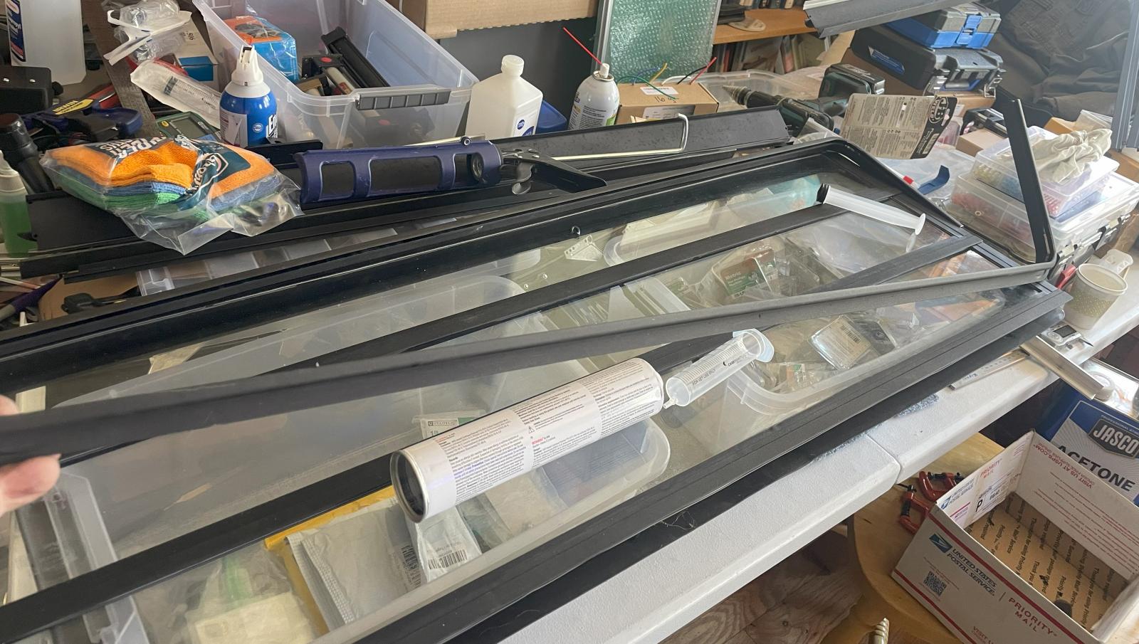

I finally got around to trying to assemble the two jalousie windows I have. Over time, I completely disassembled them since they were in pretty rough shape, bead blasted all the parts and had them anodized black.
So far I have been unable to get anywhere installing the glass into the frame parts. I've tried silicone grease, rubbing alcohol, and petroleum jelly to lubricate both the seal and the frame. Nothing has worked. Makes me wonder how the factory assembled these. It almost seems the seals are just a bit too thick. The seals are West Coast Metric.
I've read every thread/article and watched every video I can find.
Has anyone had extreme difficulty assembling these and found a solution?
On top of this, I never unwrapped all of the neatly wrapped parts when I picked them up from the anodizing outfit and now discover I'm missing one of the long top frame parts for the glass frames. So if anyone has a trashed or parts jalousie window, I'd love to get this piece from you.
