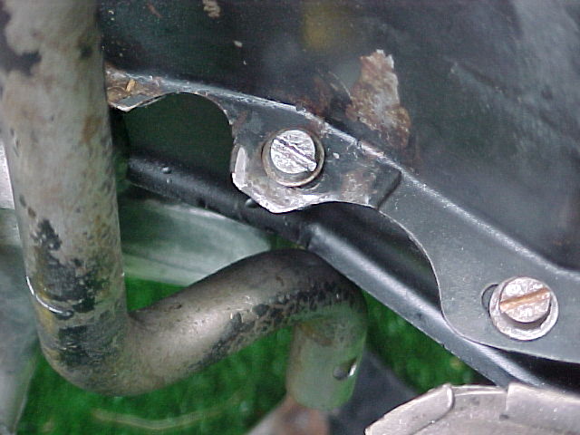

thank you...it seems the PO was "stuck" in 68...the engine is a 67 for sure though...I've got all the correct tins now so I guess I'll find a correct oil filler...
I was pulling my hair out trying to find an oil leak and the "elbowed" road draft tube was dripping oil on the bottom head tin and dripping it out toward the front (front is front) of the engine... Rolling Eyes
Is that a rubber seal where the tube goes through the tin?
1967 Lotus White Beetle
aircooled
Joined: December 02, 2003
Posts: 1316
Location: Heartland, Neb
aircooled is offline
PostPosted: Wed Jun 04, 2008 7:34 am    Post subject: Reply with quote
These pictures will give you and idea of the breather pipe arrangement to the tin. The correct pipe will go straight down and not have the bend on the lower portion of the pipe.

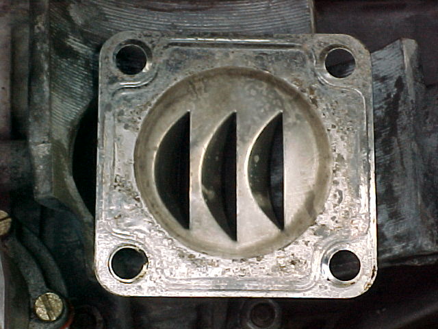

Seems like the only problem (Other than it being clogged) is the crack along the back...Nothing else seems seperated - no welds broken that i can see...

bill may
Joined: August 27, 2003
Posts: 14160
Location: san diego,ca
bill may is offline
PostPosted: Wed Jun 04, 2008 6:43 am    Post subject: Reply with quote
mailman wrote:
As long as it's already apart, I guess if it was mine I'd be looking for a better manifold. I don't like the looks of the crack, and I'd want the heat riser tubes clearer....
did the welds break joining the metal tubes? the aluminum is to hold heat in heat risers journey of heated air. you can heat and re-fuse the crack if careful. but sometimes the welds crack.

This means you have the wrong oil breather/filler setup to use with those small lower tin pieces.
And the hits just keep on coming...Need to update my entry in the "Previous Owner" thread Crying or Very sad ...Thanks for the info...

Help! the road draft tube is hitting the lower tin and wont go where it belongs...I put the 2 screws in just to hold the lower tin while I put the gen stand back on...Also is the gen stand gasket oriented correctly?
