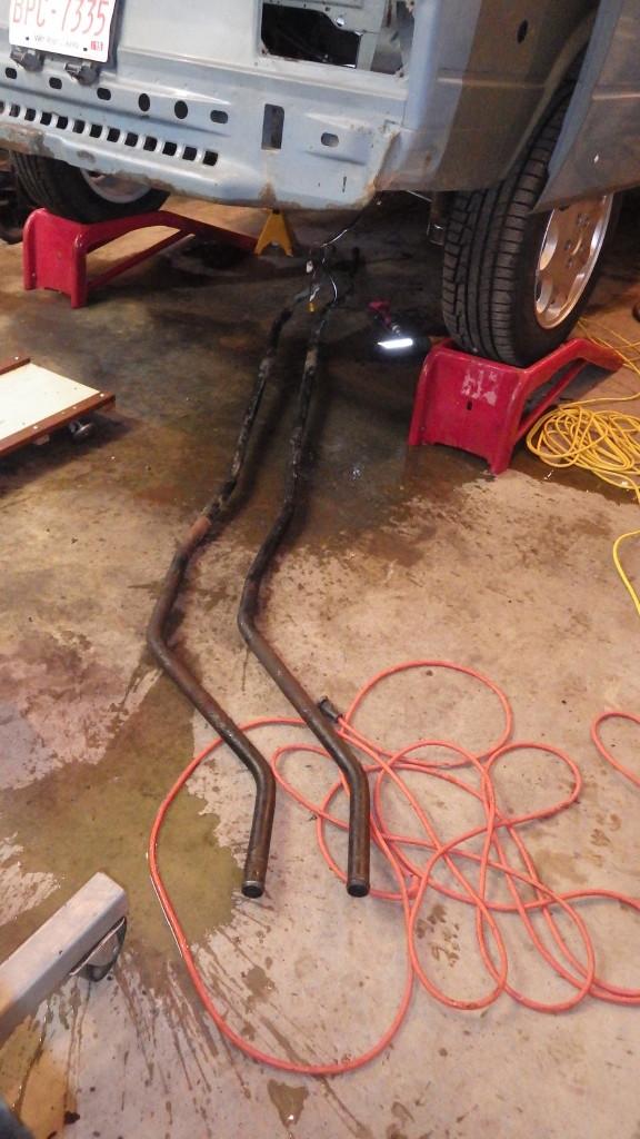

I recently started a rebuild of an '84 Camper and removed my old steel pipes last week.
They were in great shape on the inside, but rusty on the outside from where they entered the engine bay to about 1/3 the total length of the pipes:
If I had known how good the steel ones were I might have reconsidered the stainless purchase. However I ordered the SS pipes months ago with the Subaru conversion kit from RMW. They fit very well and will be a good compliment to the new engine. I have to fabricate a couple of hangars but that's easy stuff.
I'm not concerned about interaction between dissimilar metals. I understand the concept, but the effect of adding these pipes has not been proven to cause adverse effects in the Vanagon. Poor grounding is more likely to cause corrosion and premature head gasket failure than the composition of the coolant pipes.
