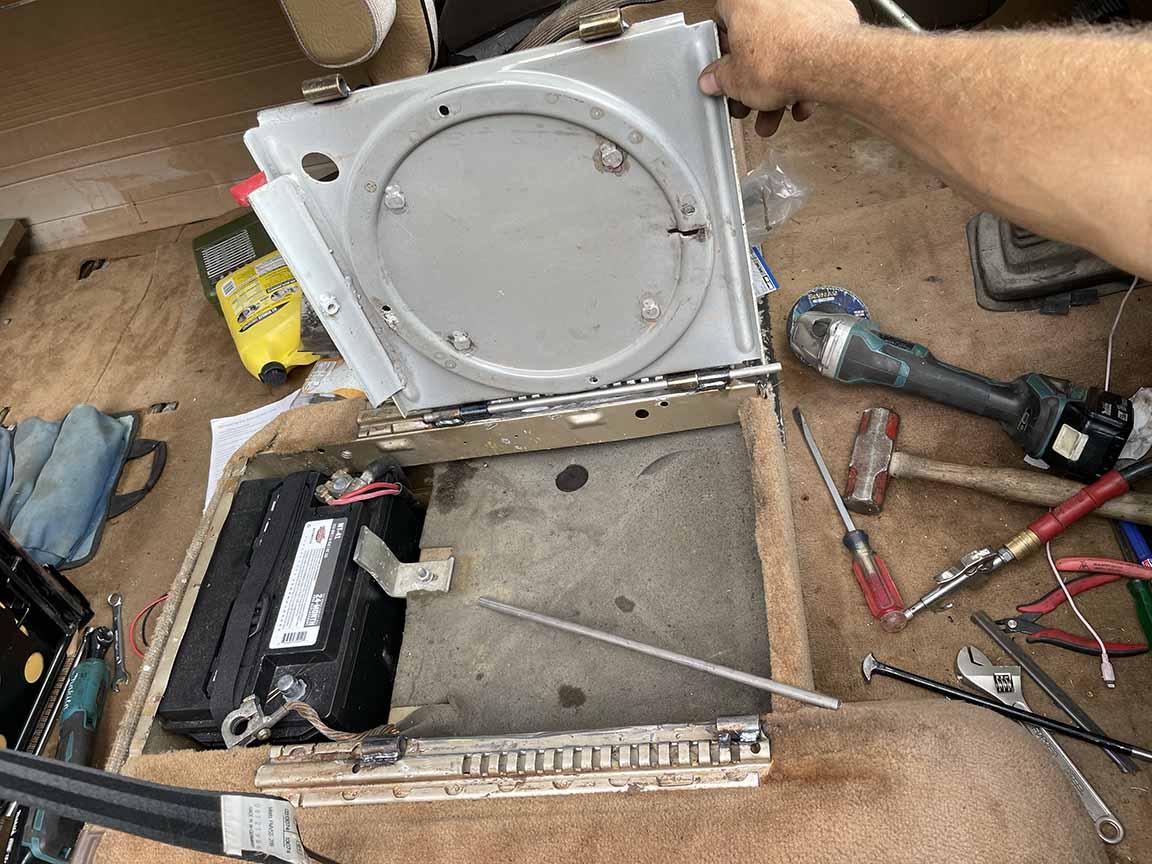

mikemtnbike wrote:
While I like syncrodoka's mod, its only 6 bolts to take the swivel base off for the rare occasions when you need to pull the battery. Not bad at all and don't risk fubaring a 200 dollar part.
Removing battery cables prior to working on an electrical system or anything that you are concerned about shorting means removing the entire swivel assembly, in an emergency if you need to disconect the battery it would be the same.
Battery removal is rare but jumpstarting someone or having them jumpstart you becomes a disassembly dance with different sized allens needed rather than flop open the lid and just get it done.
The factory weld in version didn't fit my needs either so i sold off the ones i had gotten ahold of and modified this to do what i want. Wink
I know nothing about storage loss, that has remained unchanged. There is a company that sells slide out drawers for under the seat area if one really wanted more storage access.

No this is a really good idea. I also got rid of my swivel because of the extra height. If a fella reworked the upper part of the swivels and welded it directly to the seat base, the unused seat rails could be employed on the bottom part of the swivel.
A couple of caveats. 1. because the factory pedestal rails are below the outboard part of the wheel housing, it may take an inch to clear it anyway. I don't have one so can't examine the heights and do any engineering on it. 2. i messing with my seats to get a better recline action, I initially reworked the seat slide parts. I found the tolerance between them to be extremely tight. +- .35mm. If this is something you might do, i strongly advise you tack the rails together before removing them from the seat base to preserve the track width. 3. The recline mechanism attaches to the seat rails and so if you do this, you will need to cut them off where the attachment for the torsion rod and pivot holes are located and generate something so they can then go on the swivel upper part which will now be part of the seat base.
Not impossible, but shouldn't be any hill for a climber. The question is, can you save the inch height problem?
This solves both the storage loss and and battery access.

syncrodoka wrote:
syncrodoka wrote:
I shortened the plate and welded reinforcement on it to make battery access and removable possible.
I lopped off the back and reinforced it with 1/8" angle. The battery comes straight up and out if needed. I don't have factory seat tracks on the swivel base any longer so that may be a consideration, I don't remember how far back those went on the platform.
Thanks this is what I was looking for. Do you have any other pictures of your swivel?
The tracks come all the way back per bus depot's picture, but since the tracks are on either side of the battery box (battery box fits in between the tracks) - would just be looking to cut the metal between the tracks.

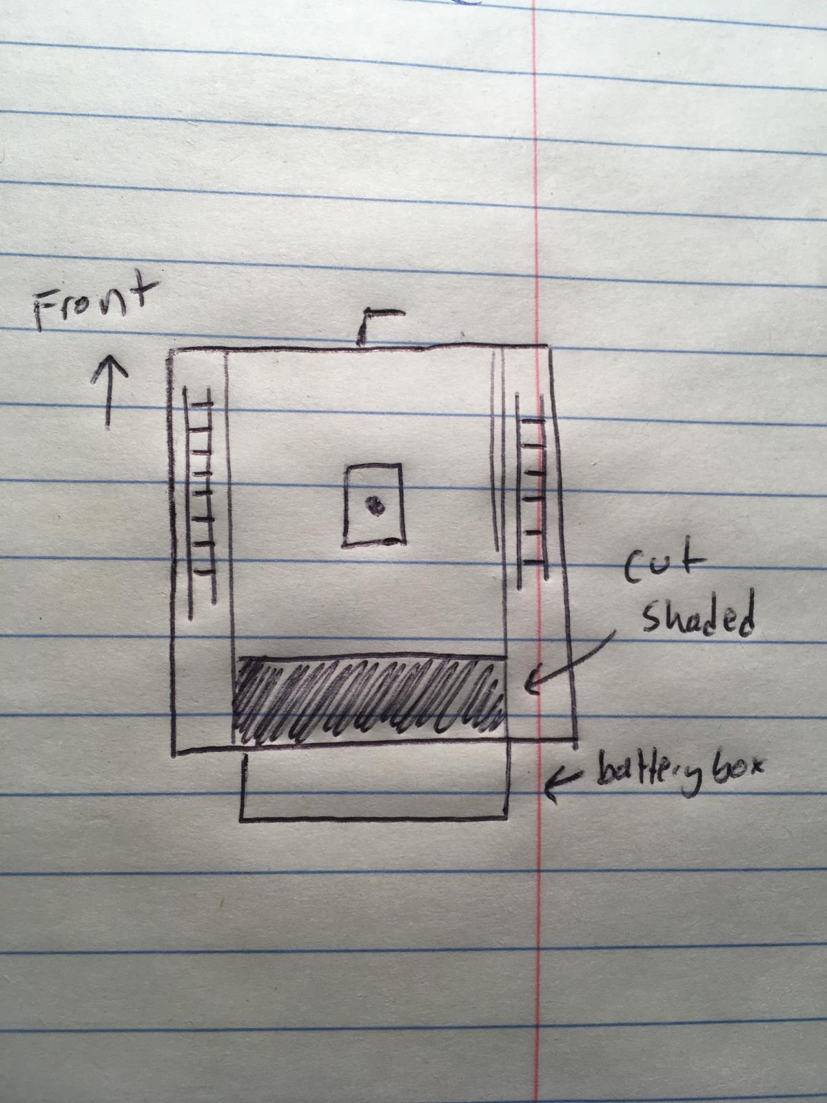

crazyvwvanman wrote:
You asked about cutting the swivel base plate so the full cover door can open. Cutting the battery cover door is preferable in my book. That is what I do when I install a front seat swivel assembly. The door hinge is held to the van by a few pop rivets. Drill the heads off the rivets, cut the door to fit, pop rivet it back where it was. Cut slightly more than what you think, so the carpet flap has room to flip too.
Mark
floodwood wrote:
.....Would it be possible/advisable to simply cut out the portion of the swivel that gets in the way - cutting in-between the rail portion?....
Thanks - my above post was in reference to the actual swivel seat base rather than the battery box.
My concern is more for battery access, whether the cover is removed so it slides off versus cutting the cover, it seems access to the actual battery will still be impeded if the swivel base is on.
This is why I am looking to see if it is feasible to cut into the actual swivel base itself. Is this possible without destroying the function of the swivel base?
