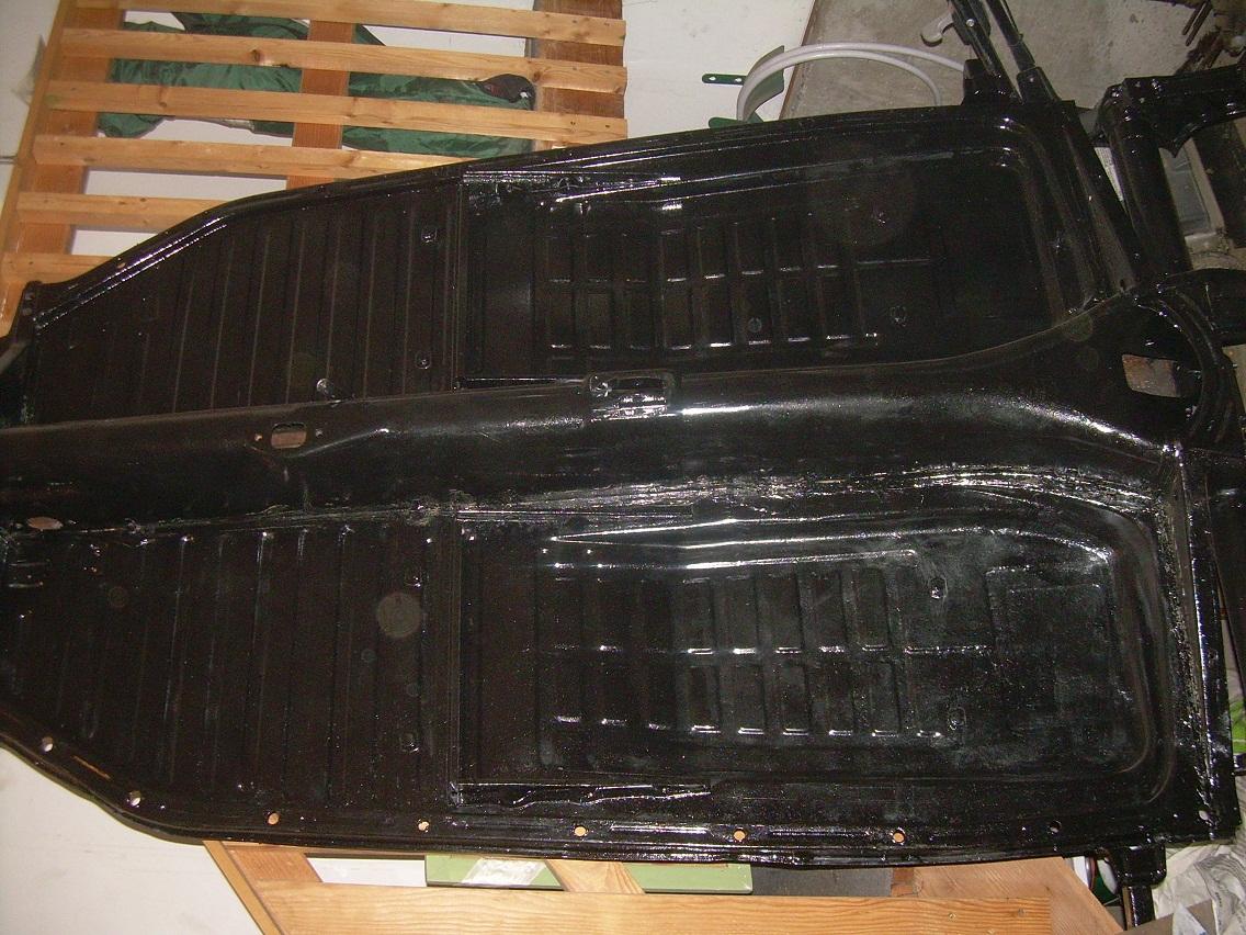

Update the HUGE step of this project.... Painting the pan at last. The weather was pretty warm lately so i had to do it now. Welding is done, cleaning, sanding is done. Finally the hard part is over.
Hoping to finish up this week with black coat and finish painting small parts so i can just simply install parts for the winter. By spring i should get this car done.

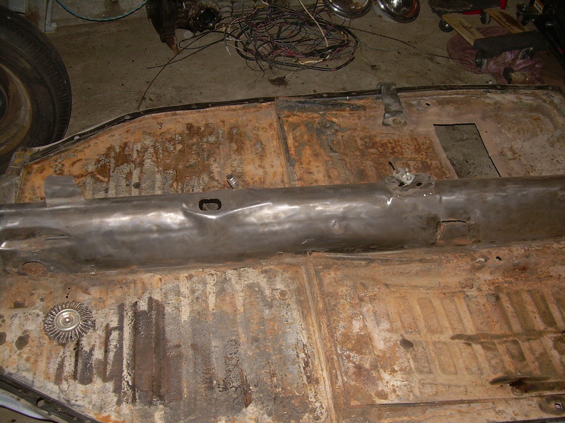

PostPosted: Wed Oct 03, 2012 5:57 pm    Post subject: Reply with quote

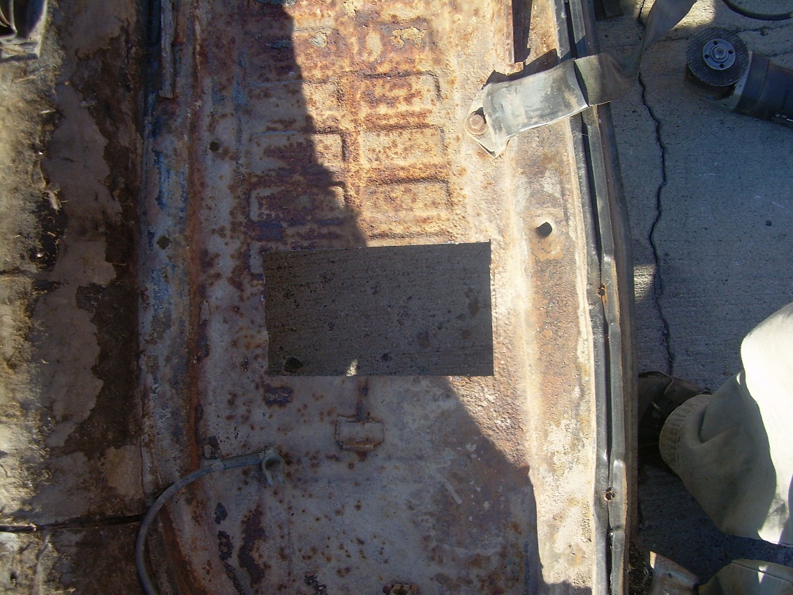

I used wire wheel and putty knife.

PostPosted: Wed Oct 03, 2012 2:09 pm    Post subject: Reply with quote
Curious... what method/tools did you use to scrape the tar mats off the tunnel?
Br58 wrote:
Well i did alot today. Thanks to holiday Smile. First i worked on the pan and scraped off the tar mat on the tunnel.
Yet another person with a '66 project: http://www.thesamba.com/vw/forum/viewtopic.php?t=526418

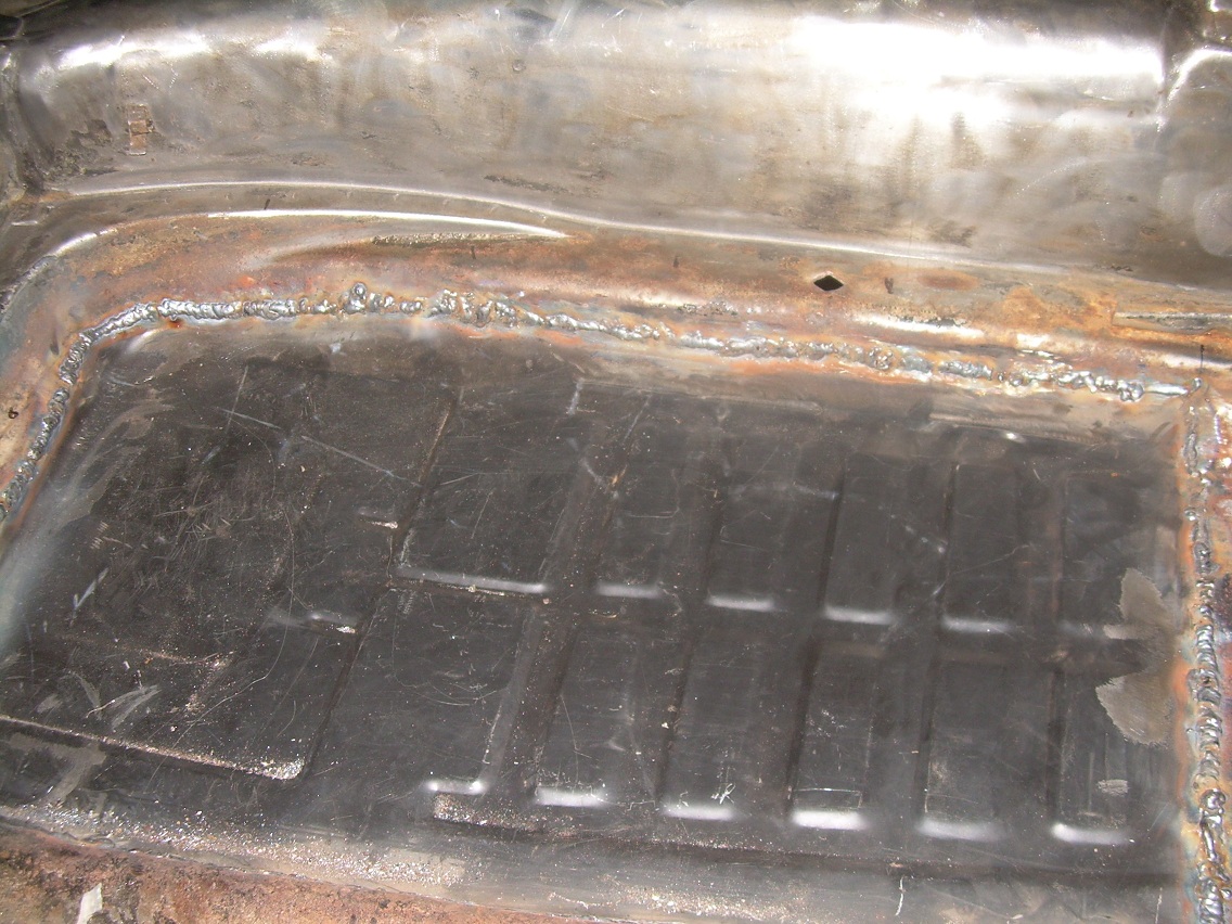

PostPosted: Fri Sep 28, 2012 5:57 pm    Post subject: Reply with quote

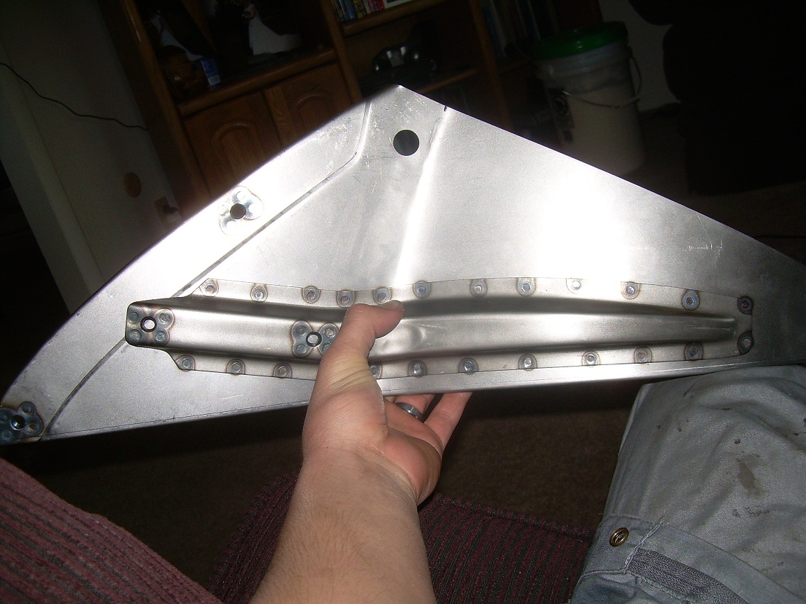

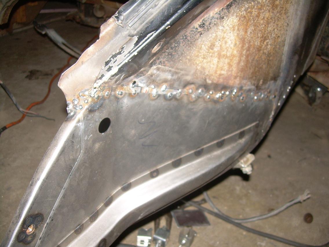

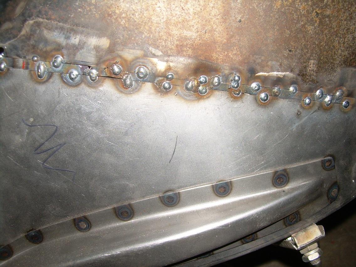

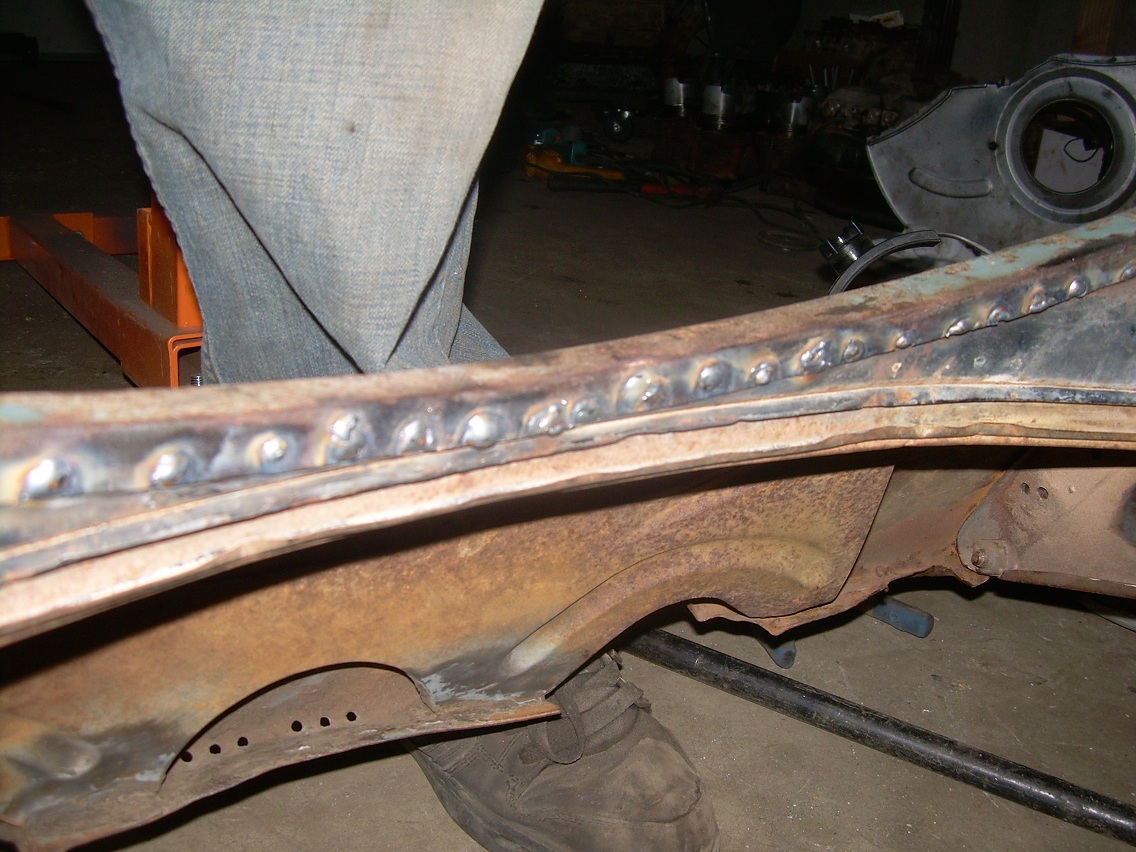

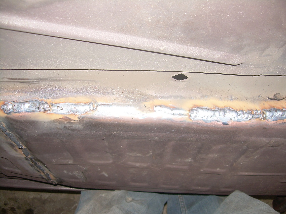

More update.
Welding is done but ill need to bump the metal a little because it caved in because of the welds.
Pics
Cleaned, grind the welds

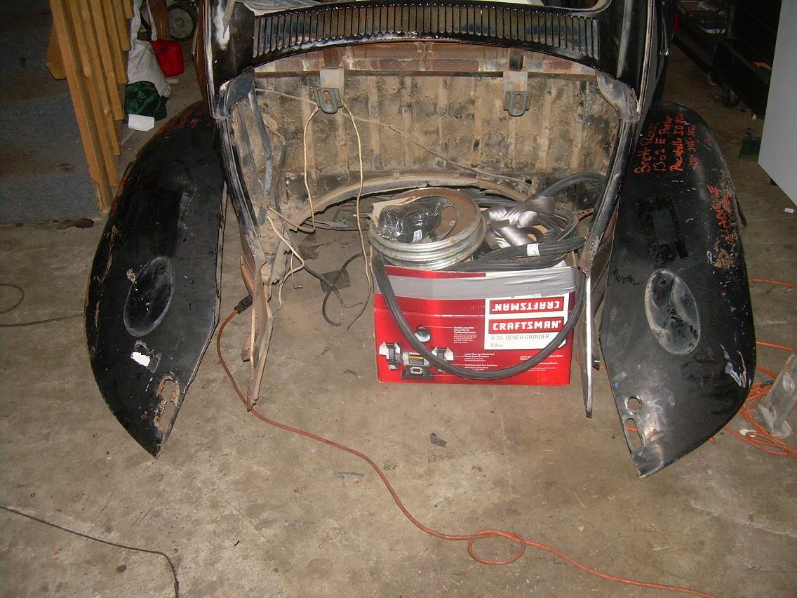

My new rear fenders Cool Now my car body parts are all color matching. Yes they are original ribbed fenders.
Thats all i have. This project is really progressing now.

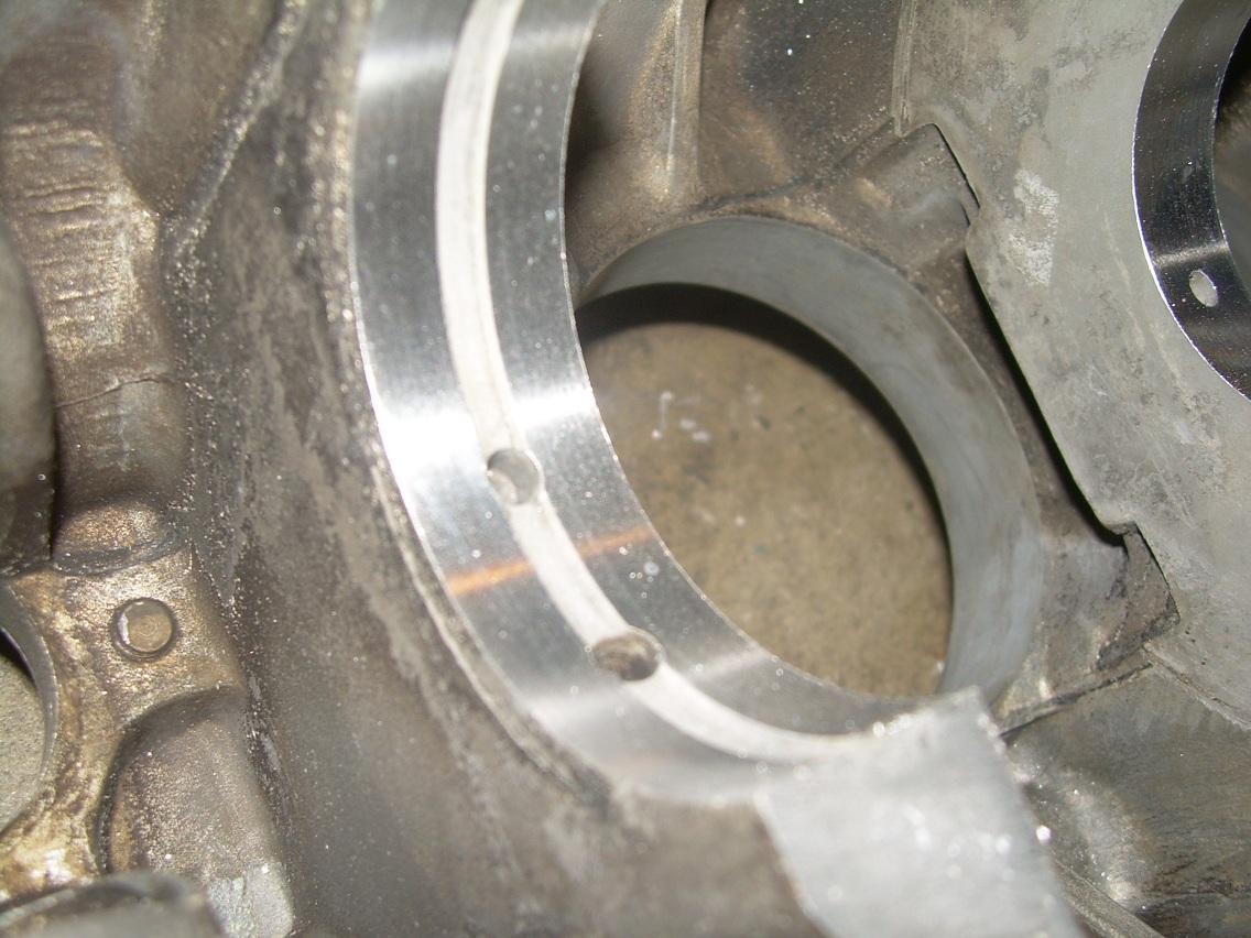

PostPosted: Sat Sep 15, 2012 7:31 am    Post subject: Reply with quote
Thanks Sventinker

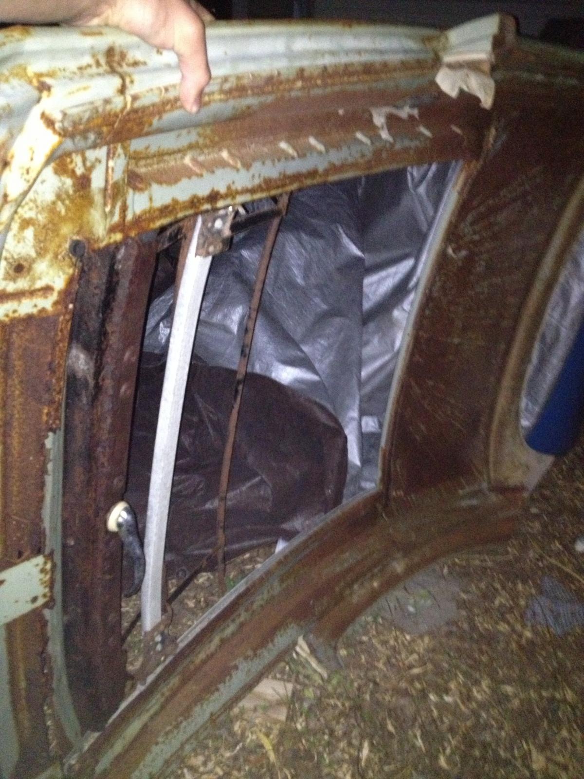

More updates. Too long since the last update.
The panel is cut off
Next i had to trim and get the panel to fit but however i messed up with the gap. It was too big so before i go ahead and do something about it i fit it with the fender in place to make sure its where its supposed to be at. Now panel is welded in place and gaps are filled with metal strips
Some other parts i worked on.
36hp case cleaned up by ACE from Utah. Thanks ACE

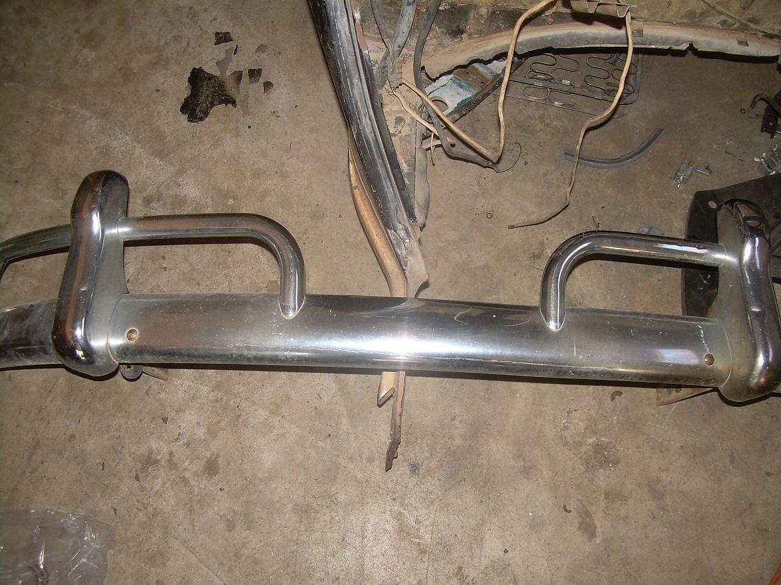

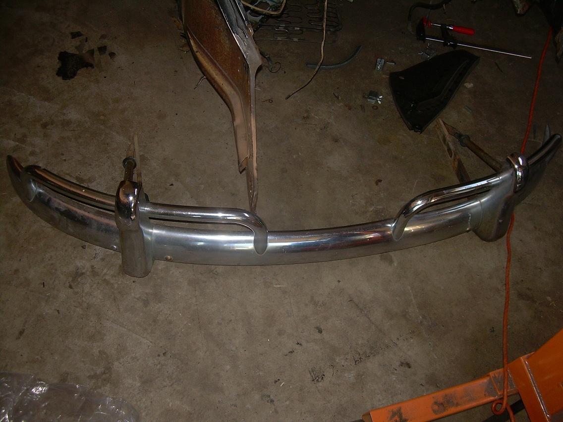

Finally i found a good rear bumper for my 58 from local. I am excited and it took me a while to find a good looking bumper.

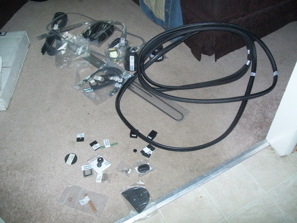

PostPosted: Sat Jun 16, 2012 10:04 am    Post subject: Reply with quote

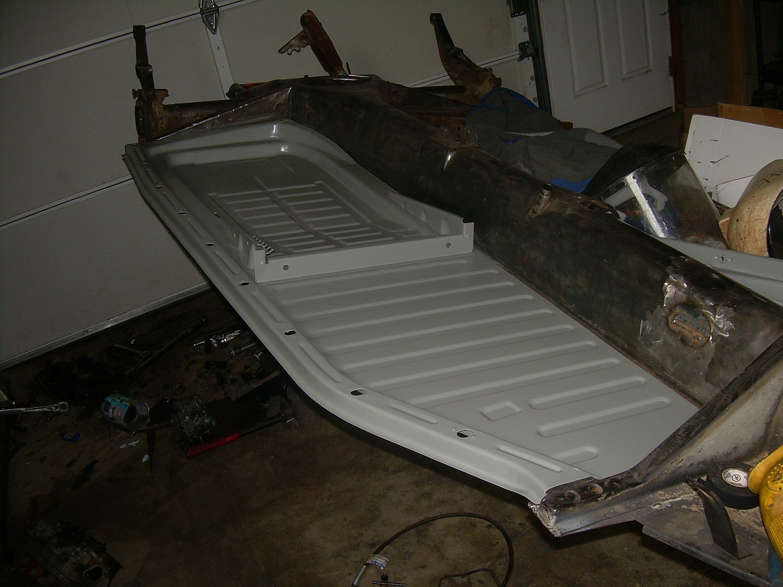

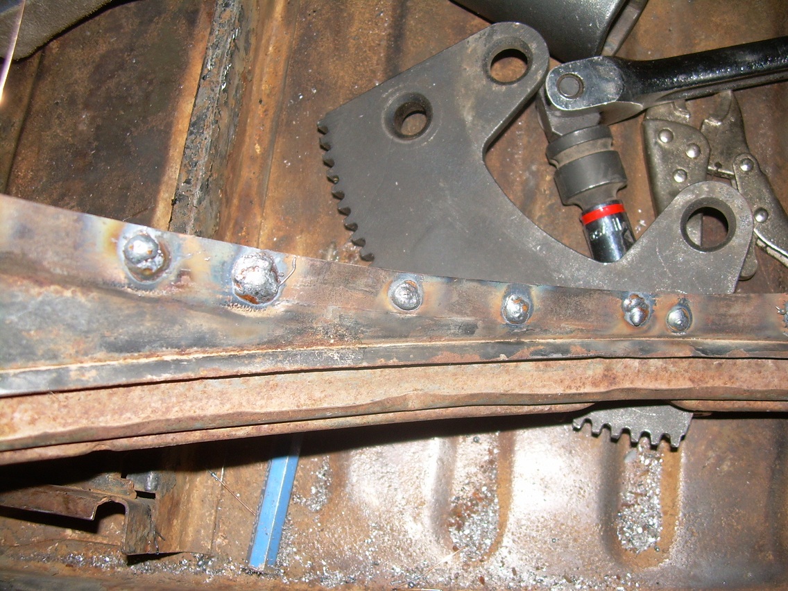

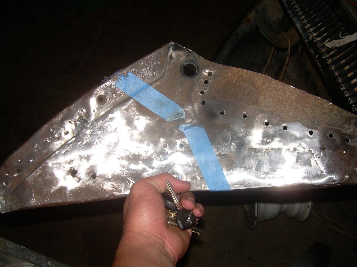

pic of the right side pan off. I drilled the spot welds off to save the pan for later.
Got the WW pan for the right side. I must say i am super pleased with it even though it has some minor details that are different from OG pans but however i am satisfied with it. It fits right on like a glove.
got the pan welded in. Had a little mistake at the start because the pan wasnt sitting on the tunnel fully so i had to drill out the spot welds then push the pan down. Better now and i am not yet done with welding the pan, need to weld the carpet pegs and battery hold down clamp and bolt for the battery hold down, jack point.
Also look what came in the mail...
very impressed with the quality and it is THICK. its from wolfparts. i will buy from them again.
Thats all i have for now.

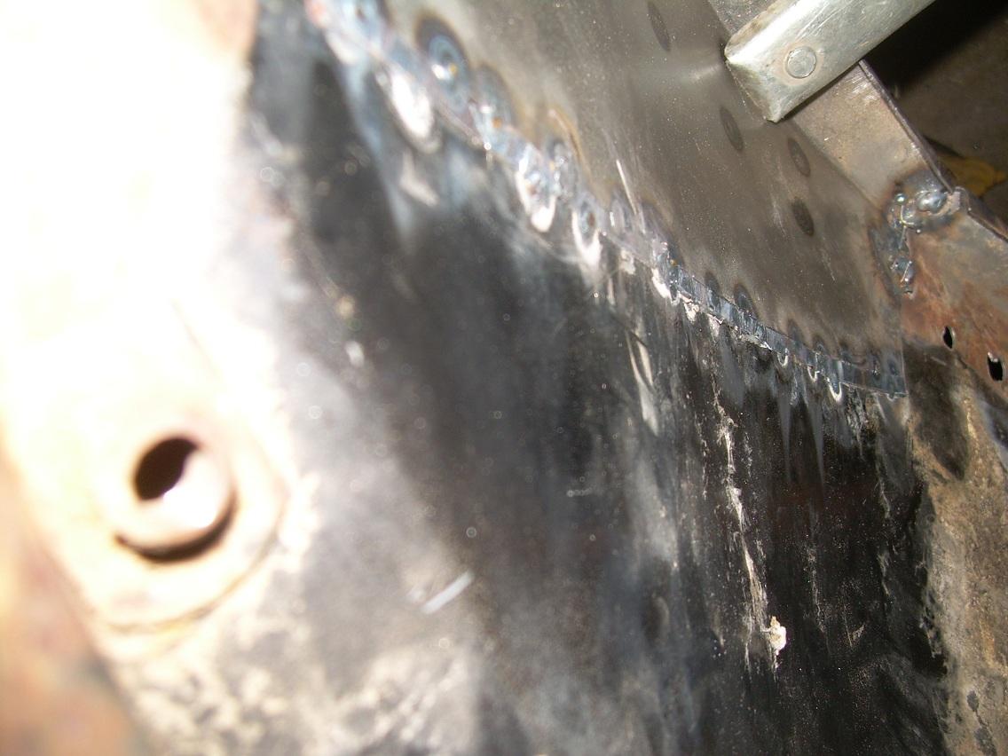

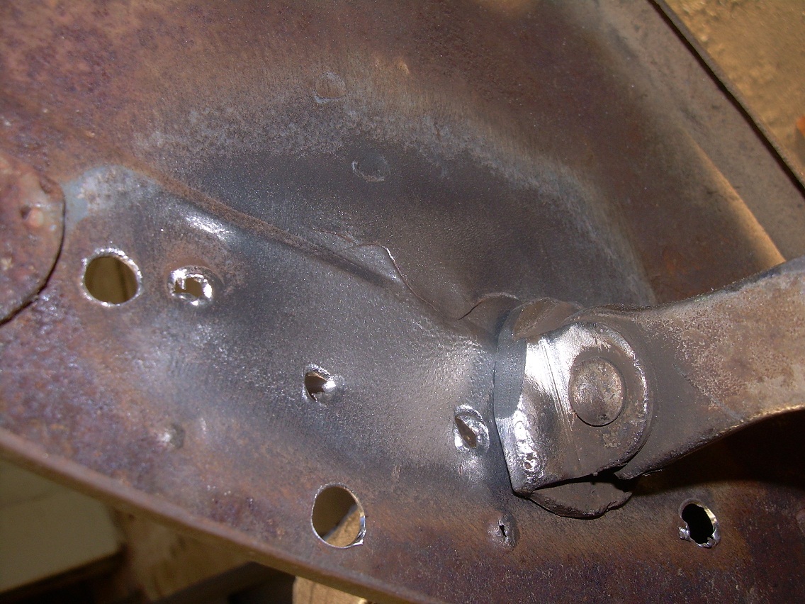

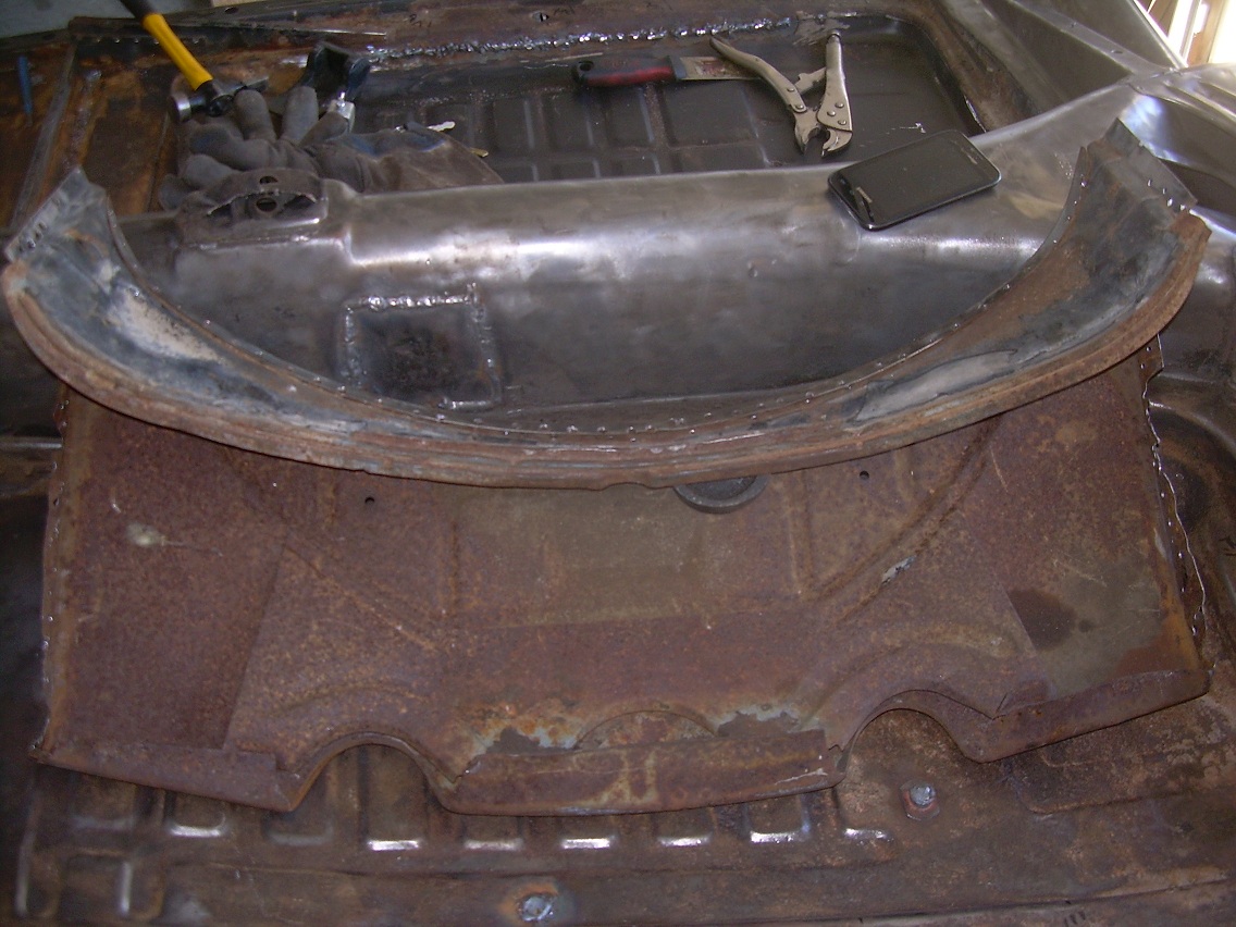

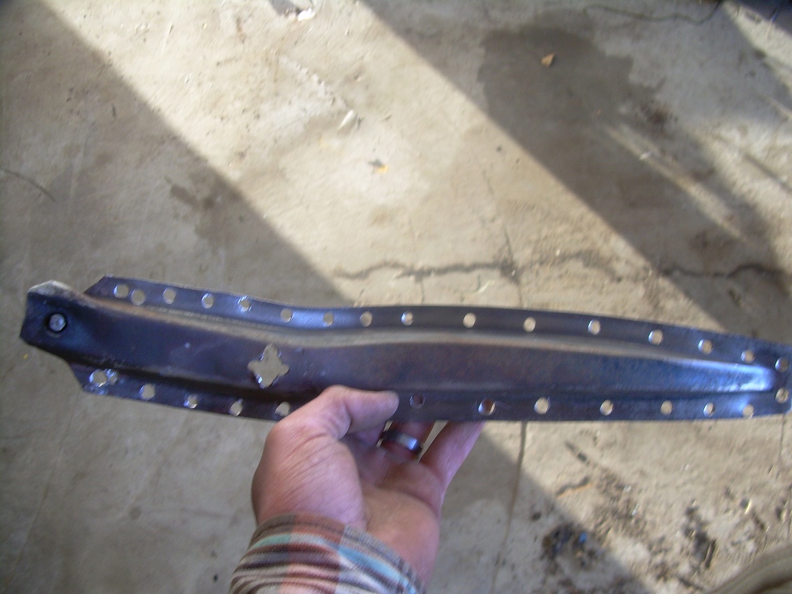

Alot more welding
see this tab? I am modifying the 66 tab to this but i am not done yet
I just need measurement on the tab so i can copy it as exact original.
Welding the pan is finished.
Rear apron is almost finished!
test fitted the apron and it fits great and exactly where i wanted it to be.

finished welding up the pan however i will grind the bottom because of missed welds on the gaps and weld again til all the gaps are filled up.
welds look good, middle of the pan, it is popped up so i will need to get a torch to heat up the metal then cool it with water to make the metal tighten up more to get rid of the popped up areas.
my welds

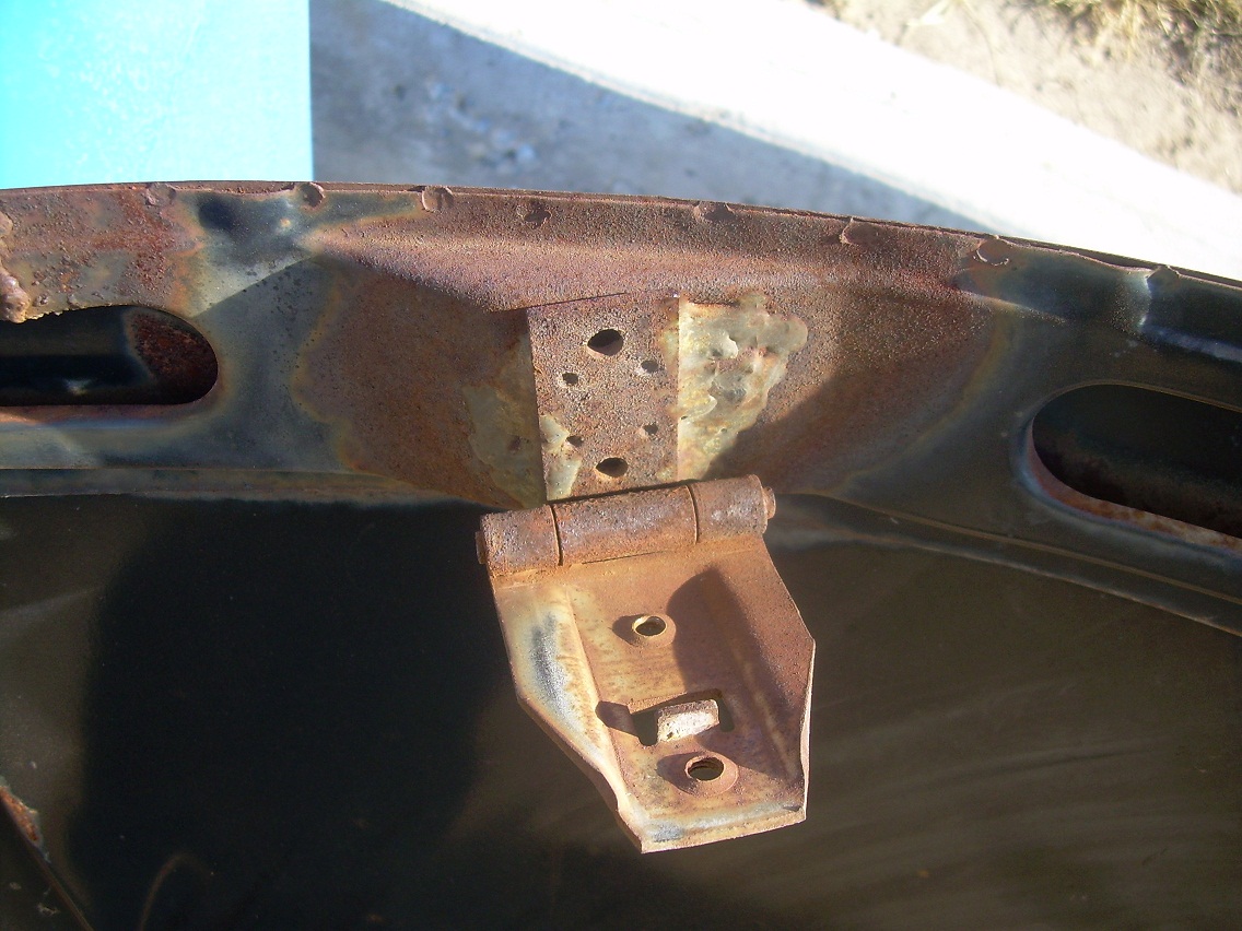

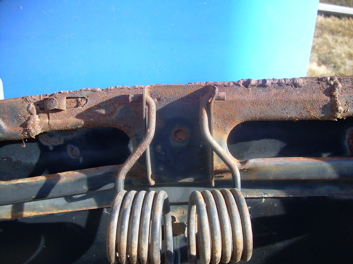

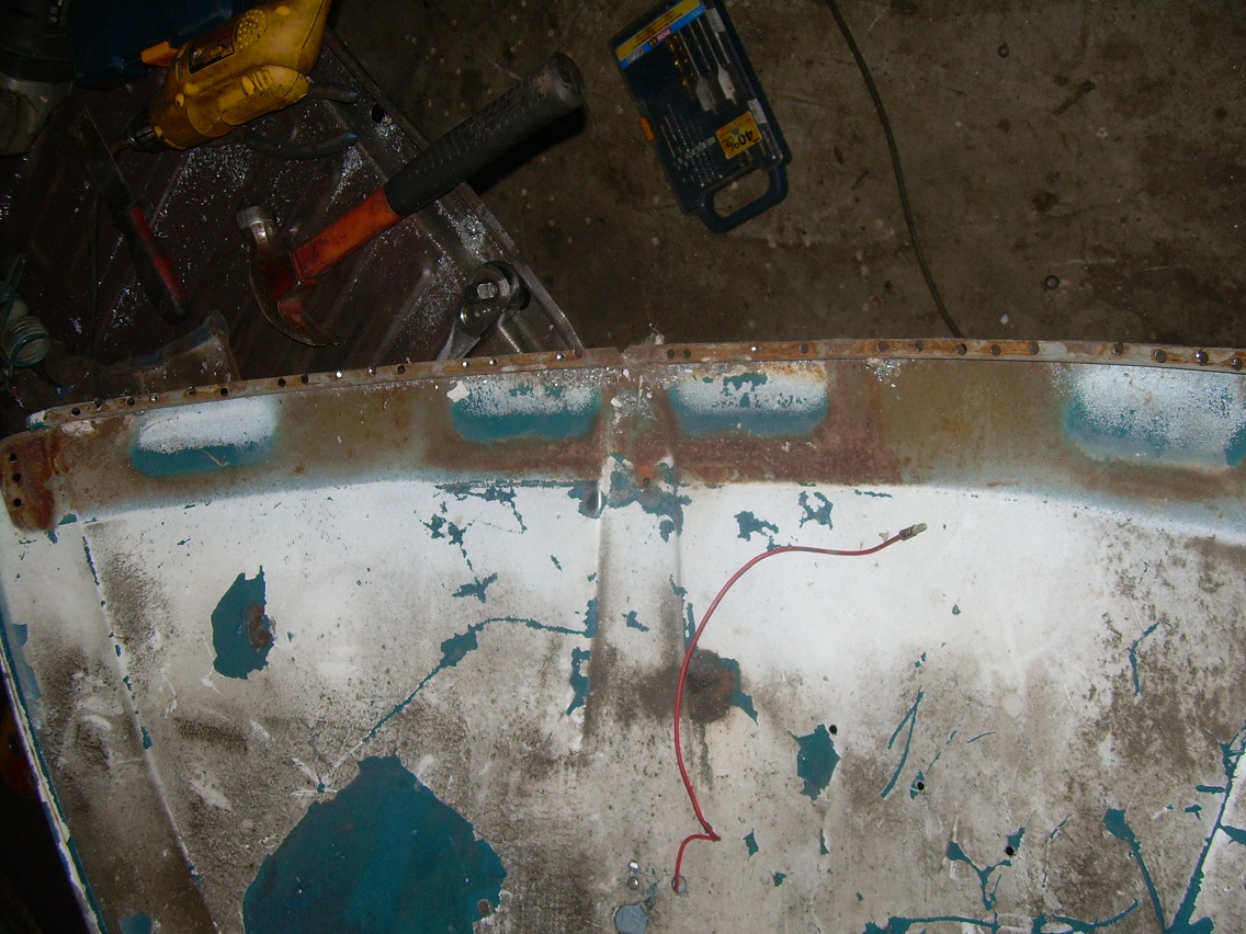

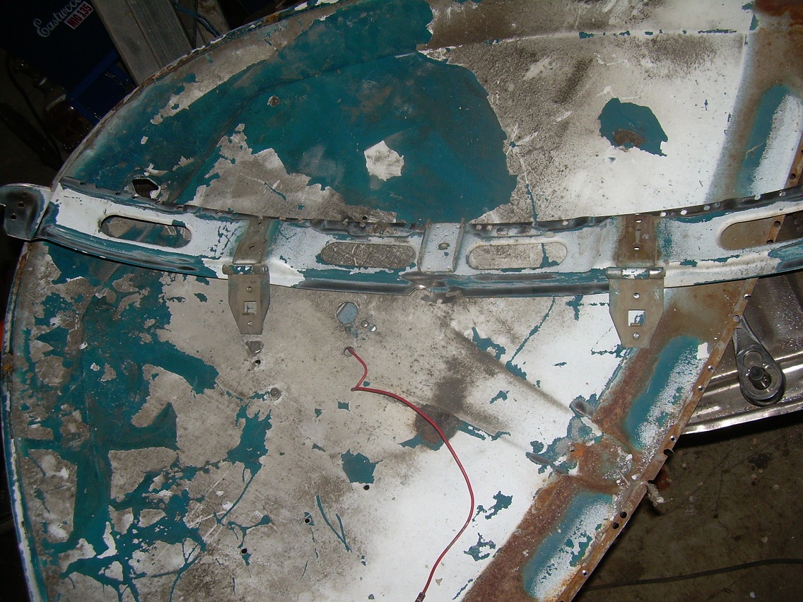

A little update to the decklid.
hinge section is off
I will be doing a little modifications to the hinge to make it look like 58 type hinge section.

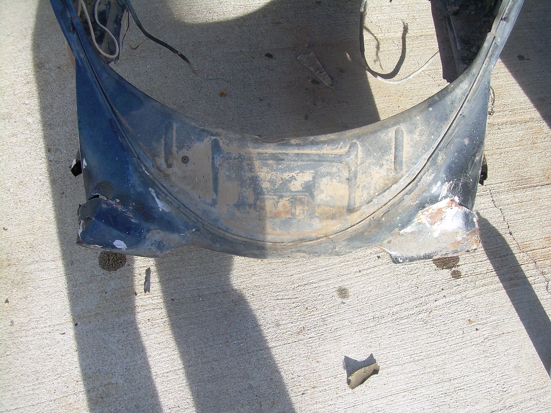

PostPosted: Sat May 12, 2012 4:35 pm    Post subject: Reply with quote

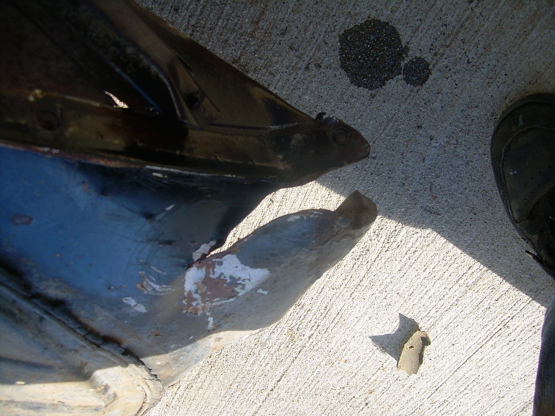

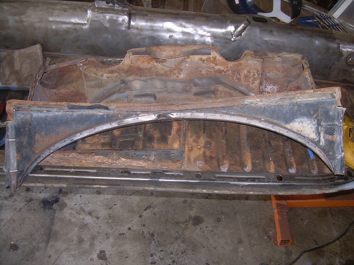

drilled off the part of the apron
my other apron off the black beauty. That section on the blue apron is rusty so i decided to swap the black piece to the blue apron.
I just need to weld it on

alright it has been a while since an update. I have been cleaning up the chassis and got new quarter pan for the passenger side. Worked on the rear apron as well so pretty much working slowly. Here are some pics of what i have done.
cut the pan to match the old pan since i am doing butt weld. It will be tricky and i have it welded on but i am not done yet.
old pan
a little peek at my welds on the pan

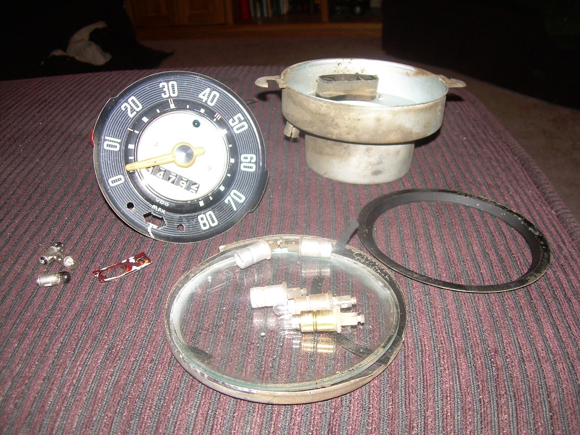

Got alot of parts from WW. Mostly seals and parts that needs replaced.
My gas tank out of the 58 surely did make a great birdhouse in the farm.... Pain in the butt to clean up but the inside was just solid and dry. I will seal it anyways since its over 50 years old.
it will needs to be cut up because the metal is wrinkled up. Too many holes and im just wasting my time trying to preserve it. I will wait til i get the new rear panel then i can go ahead and cut it up.
My 36 hp case. Cleaned up really good
