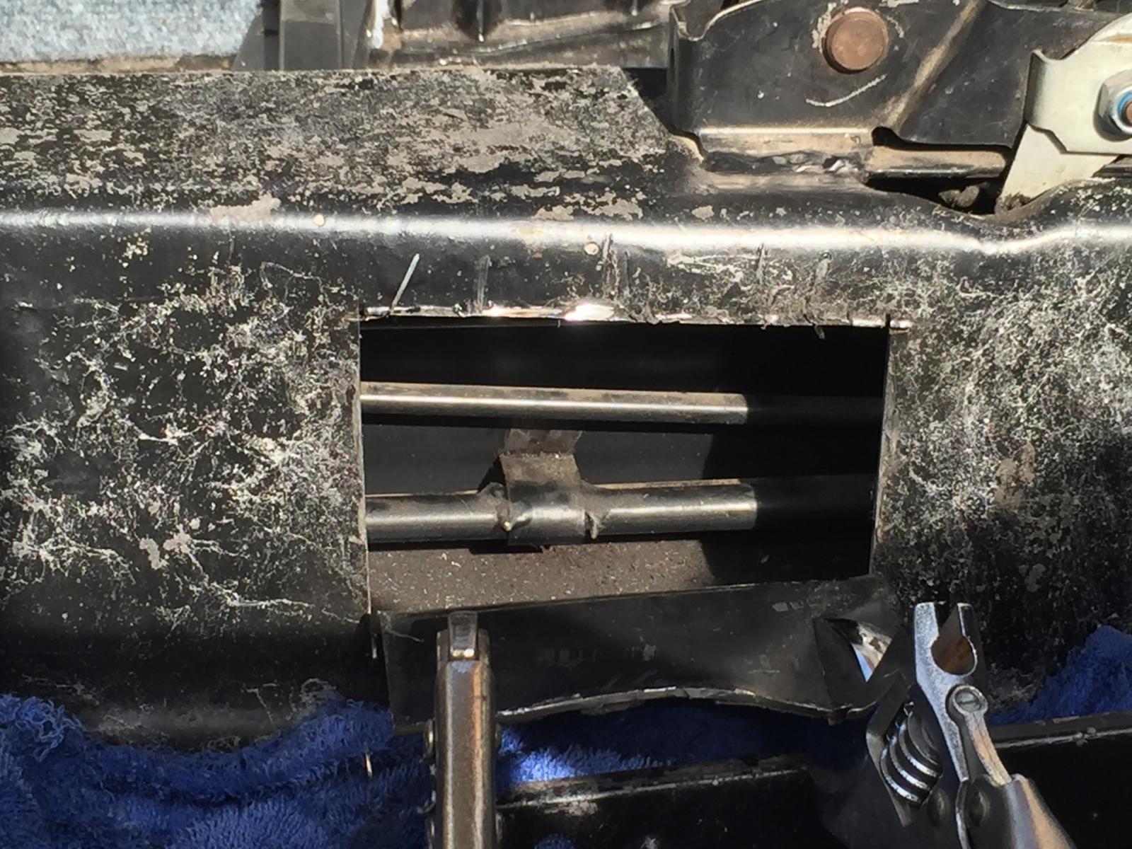

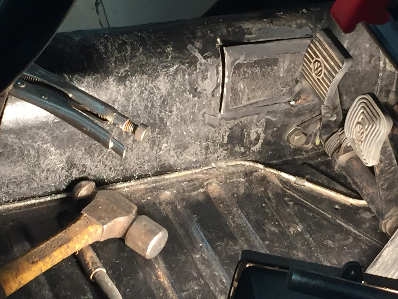

Mellow Yellow 74 wrote:
Did you butt weld those windows in the tunnel closed again? If not you have taken a fair bit of strength out of the chassis in the event of a serious crash.
Yes they've both been welded up again !
1969 UK Karmann Ghia build http://www.thesamba.com/vw/forum/viewtopic.php?t=518789&highlight=
Mellow Yellow 74
Joined: October 14, 2014
Posts: 1615
Location: Sydney, Australia
Mellow Yellow 74 is offline
PostPosted: Thu May 19, 2016 5:15 am    Post subject: Re: 1969 Karman Ghia Build (UK) Reply with quote
