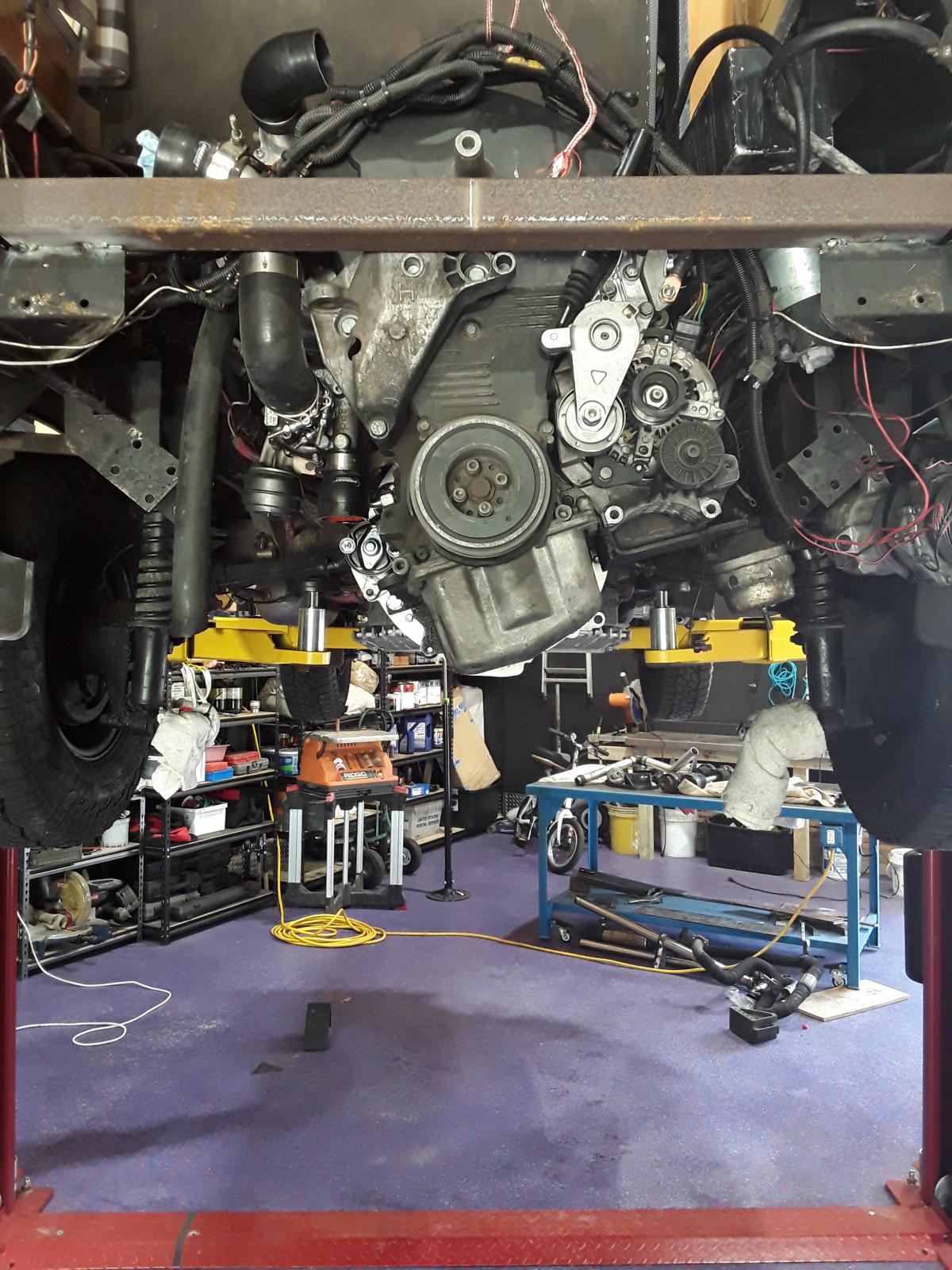

Made a lot of progress this weekend; been plugging away each of the past few nights.
Sorted out a bunch of little things, remoutned the carrier bar, changed the timing belt among other things.
Mounted the engine up in the Bus to check on how a few new arrangements will work out, but I realized I needed to order new flywheel bolts so I'll have to pop it back out to properly install that. No big deal really as I was able to lay eyes on some things I wanted to check on.

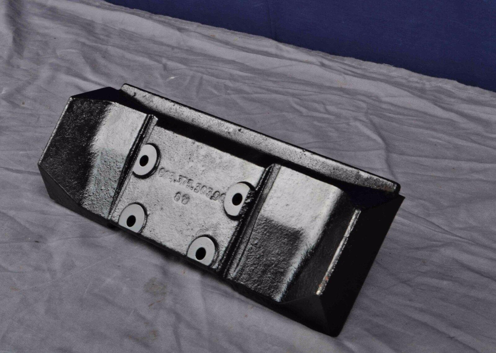

This came in the mail today!
Oreos from a thoughtful (and well-remembered) Samba to help console from the disaster.
The other stuff is aluminum coolant flanges- the thermostat housing (cast one) and a flange on from the head to the radiator hose (billet one).
I was always a little nervous about the pressure my stiff coolant hoses put on the stock plastic flanges. Shouldn't have to worry about that now!
I was surprised that I couldn't find a cast one for the head as there are plenty of kits for other VW motors, and other cars in general.
So I had to spend a bunch on this billet flange. But, it will be the most beautiful part on the whole engine!

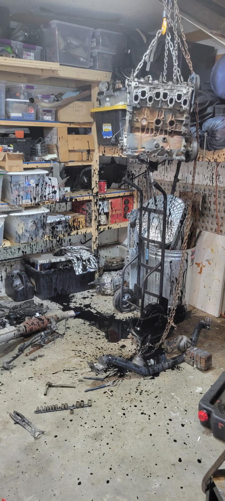

I did finally get some engine carnage pics too.
Was surprised at how relatively unscathed the head was!

PostPosted: Mon Oct 02, 2023 3:53 pm    Post subject: Re: TDI into '78 Bus Build Thread Reply with quote
skills@eurocarsplus wrote:
you know what I like about you? you don't fuck around...you lick your wounds and own it....your determination to kick the hell out of it is amazing...most folks would have walked away by now.
This quote is at the top of page 23 of this thread, from 2016. I keep that as my bookmark to the thread, so when I'm posting about some disaster I see that little bit of encouragement.
That said, I've finally been working on this thing again. With everything going on in my life, I have had a difficult time finding time to work on it, but I did have some time on Saturday.
I did my best to be very meticulous in taking things apart off the dead engine, so that I could transfer them to the new one.
One of those things is the oil pan. I was sure I'd drained it when I pulled the engine out a year ago. (I guess I hadn't.)
I had recently set up a pulley system for this sort of work, and figured I might as well not be crouching down to remove all 20ish bolts.
I got the last bolt out and it was stuck. No big deal, that happens. I'll just go get a mallet and give it a whack.
Well... As I was across the garage getting the mallet, the pan let go!
Oh well, shit happens I guess.

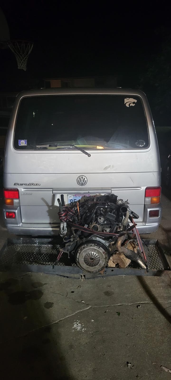

This picture is getting to be too familiar... (Though the transport vehicle has gotten larger!)

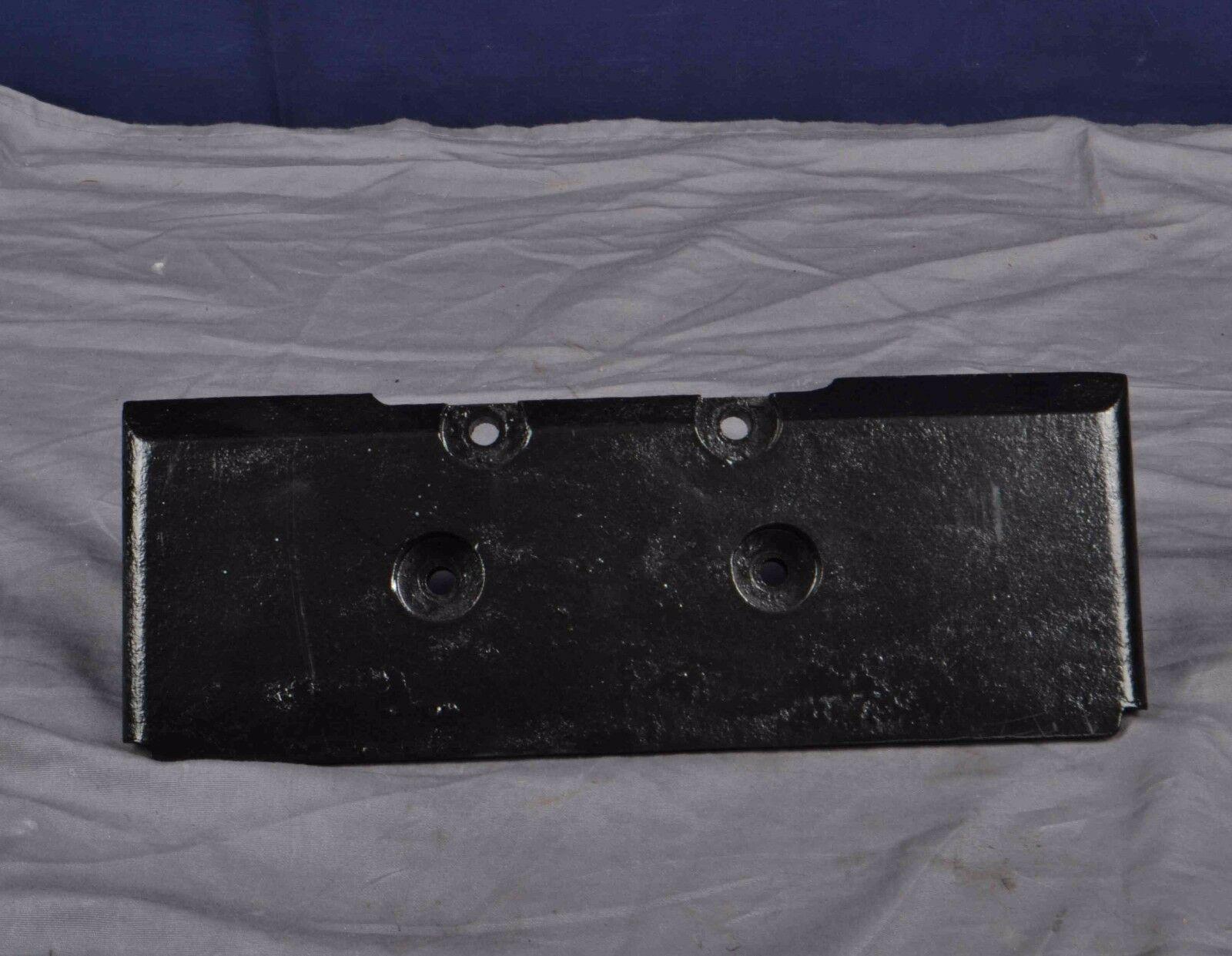

WRT the resonance suppressor counter weight:
I just realized Porsche added this exact thing on the 912E. Built a lousy 2088 total. (missed opportunity, in retrospect).
The counter with appears to mount with the same four bolts at the front of the trans.
