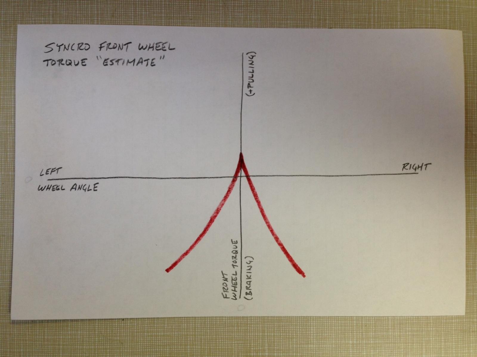

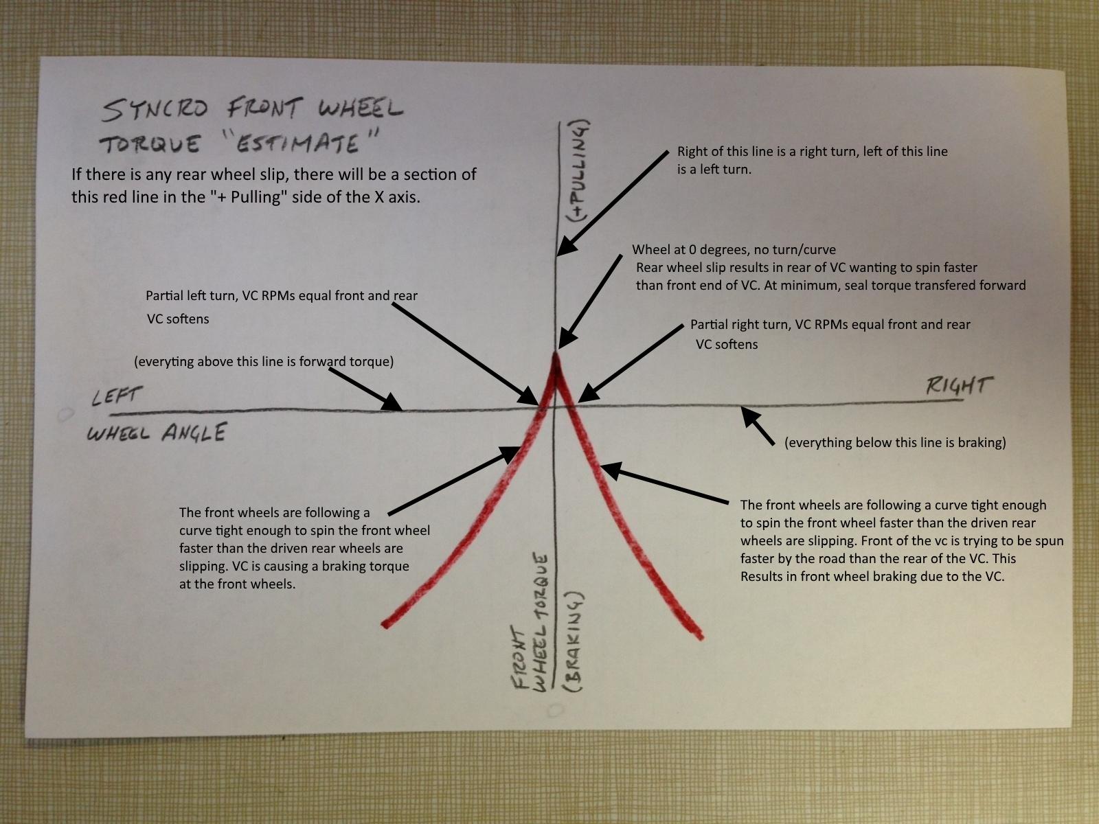

PostPosted: Thu Jan 25, 2018 12:11 pm    Post subject: Re: Syncro Chat: VC's, solid shafts, decouplers, AWD/4WD, etc. Reply with quote
Sodo,
I'd say that this diagram describes highway speeds.
Parking lot driving would result in a similar graph but the lack of rear wheel slip would just shift the red curve down to where the tip is at x=0 and y=0 (in other words, no forward torque).
(I put an edit above to clarify highway speeds.)
-d

PostPosted: Thu Jan 25, 2018 9:27 am    Post subject: Re: Syncro Chat: VC's, solid shafts, decouplers, AWD/4WD, etc. Reply with quote
Raoul, your diagram is good to describe the relationship when the "geared" drivetrain puts the "rubber to the road". The horizontal line is important to understanding. Syncro fellers have been wanting for this explanation for 10, 20 years.
EDIT I have understood this diagram correctly in the past but today read it wrong.... I'm trying to get Jon to add slip between tire and roadway into his understanding - fwd(drive) & backward (skid). You cannot have the steady state condition of tire speed = roadway speed when there is 80hp being expended.
    Lower speed maneuvering (parking etc) is below the horizontal.
    Highway driving is above the horizontal.
Jon's explanations are all very good for describing the relationships "below the horizontal". Most vans don't get a lot of miles below the horizontal. Most of any vans miles are ticked away above the horizontal, where slippage cancels the binding.
Kinda like where your underwear gets tight sitting in the driver's seat for hours, but feels a lot better after you stop to get out & fix something on the van. Wait a minute....

PostPosted: Wed Jan 24, 2018 3:08 pm    Post subject: Re: Syncro Chat: VC's, solid shafts, decouplers, AWD/4WD, etc. Reply with quote
Jon_slider wrote:
Facts:
1. The motor of a Syncro w VC or solid shaft, can never power the front diff faster than the rear diff.
2. In a dry curve, front wheels travel a longer distance than rear wheels.
3. To power the front diff faster than the rear diff, requires a center differential.
4. A syncro does not have a center differential.
5. The front wheels don't need to travel faster than the rears to provide forward torque.
Jon's #2 is technically correct but what matters is the RPM difference front vs rear, not how far they are traveling. This is a more complete description:
EDIT: This is at highway speeds, not a parking lot.

raoul mitgong
Joined: July 05, 2009
Posts: 1340
Location: Denver, CO
raoul mitgong is offline
PostPosted: Mon Jan 22, 2018 10:17 am    Post subject: Re: Syncro Chat: VC's, solid shafts, decouplers, AWD/4WD, etc. Reply with quote
Waldi wrote:
The slip depends on weight, tires, pressure, speed, street/pavement conditions, uphill-downhill, coupled-decoupled.
A lot of variables.
The only for sure, there is slip.
Totally agree. I uploaded this graph a year ago and posted it to the crosswind thread. I am thinking that the curve should look more like a parabola than a tent now (I'll need some quiet time to contemplate).
Anyway, there are purposely no numbers on the chart because we don't even have a baseline for rear tire slip. More slip would shift the curve upward. Less slip would move the curve down.
The top/tip/center of the curve (at x=0 location) is where the steering wheel is centered and driving perfectly straight. Turn left and the forward torque drops down and to the left. Turn far enough to cross the horizontal x axis (y=0) and you are into braking territory. Turn right and the forward torque drops to the right.
All the variables Waldi listed are going to affect the shape and position of this curve.
-d

raoul mitgong wrote:
Good data Mark. Any chance you want to repeat it, but at 65 mph? Ha.
I don’t think we will resolve how much the fronts do pull until we get some reliable tire slip data. Looking at you crazyvwvanman.
Jon,
Imagine straight line dry decoupled at 65mph. Rear tires under torque and experiencing 0.5% slip. Rpm difference at the VC would be 18 rpm.
Now pull the knob and couple it. VC rpm difference can’t stay at 18 so it drops (0-5rpm?) and the rear slip is decreased while slip on front tires increases as the front pulls and removes some of the load at the rear. Perhaps .2 slip front and .3 slip rear?
And yes, the front torque will drop when entering a turn and cross over to negative if the curve is sharp enough.
-d
