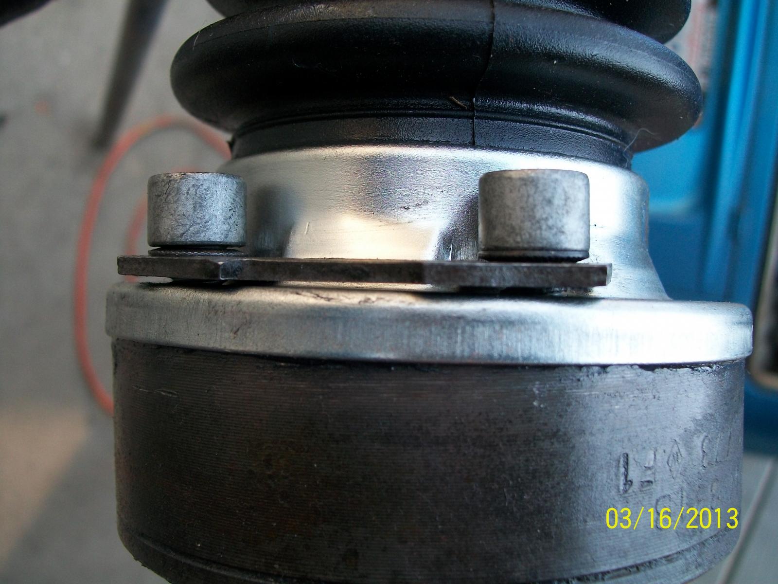

-Cvs and axles (inspect, may go all new)
http://www2.cip1.com/ProductDetails.asp?ProductCode=C13-16-2232
http://www.rockfordcv.com/Bootkit_list_prices.htm#BK814-21
http://www.thesamba.com/vw/forum/posting.php?mode=quote&p=6929453
How to Remove Stripped CV Bolt Head
https://www.thesamba.com/vw/gallery/pix/1037757.jpg
http://www.pmbperformance.com/catalog/item/4055868/5749889.htm
https://www.youtube.com/watch?v=mgwmuZuJ02I
https://www.fastenal.com/web/products/details/0162...ngMachine=

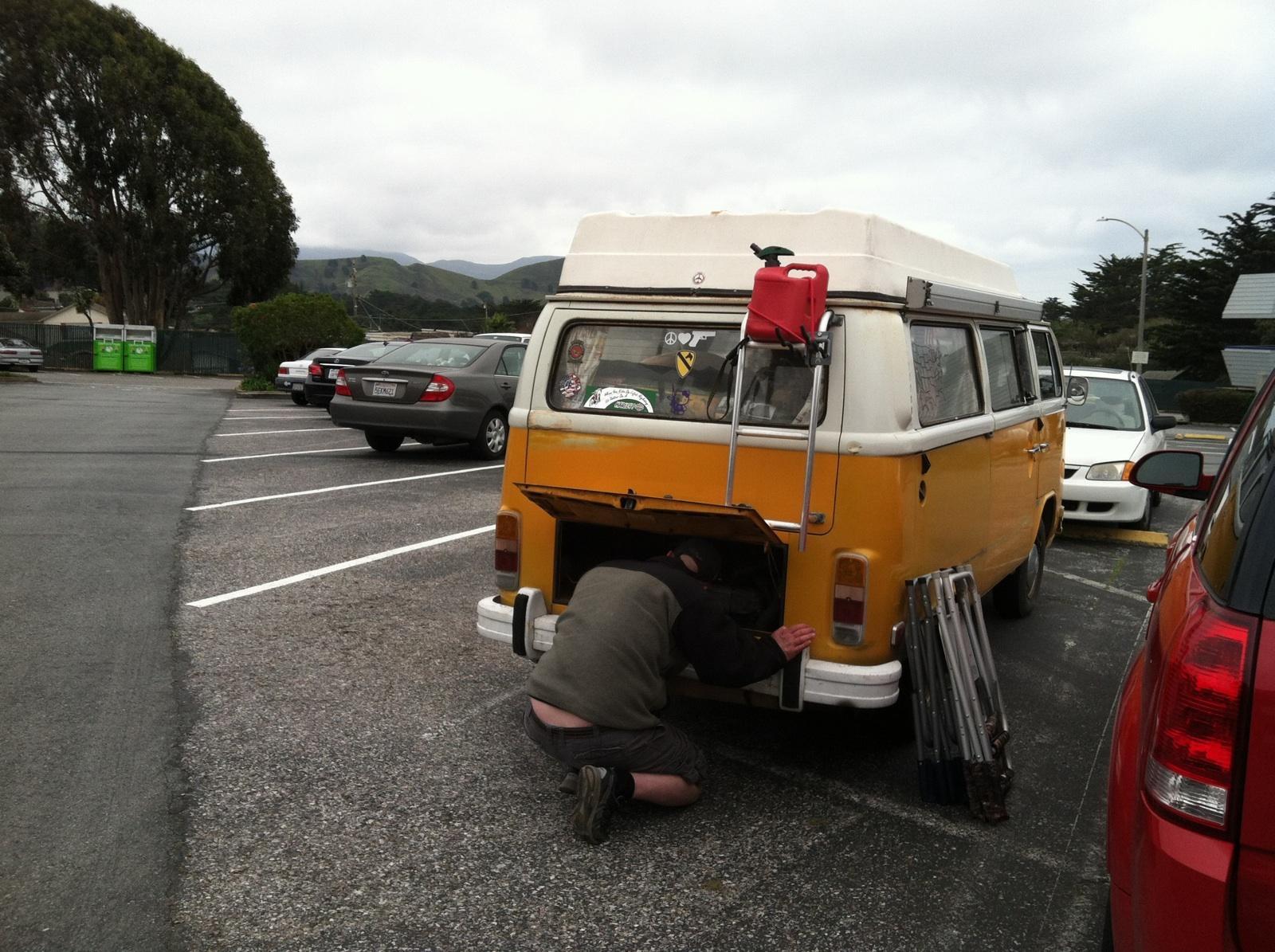

PostPosted: Tue Feb 17, 2015 11:20 pm    Post subject: Reply with quote
Finally hit the road.
Less than a stellar start.
We rolled out and started down from the Sierra Nevada's on I-80 into the bay area. Got to cross the new bay bridge and head onto highway 1 heading south. Crashing the first night just south of Santa Cruz.
The goods:
-finally got to get away
-Laughed our A$$es off at nearly a dozen people chasing a chicken that got loose from someones car at a gas station. (No pic as i was laughing too hard)
-had a fantastic lunch sitting on a quiet beach
The bads:
-averaged 17 mpg, a drop from our previous trips.
-had another hard, cold start this morning. Looks like the tts and cold start valve are not the only things holding her back.
-about to lose the starter - we stopped for lunch and she wouldnt turn. A quick tap on the starter with the ol' mag lite and she fired up. Did a couple of jump starts the rest of the day as she fired again on her own but then not another time.
- a bunch of state campgrounds are 'closed for the season' and locked up. Public land, my A$$.... No ocean view to wake up to tomorrow.
Dumb starter....
My other co-pilot ready to go
More to come, assuming we dont get stranded. Heading to Monterrey tomorrow hoping to pick up a new starter. Then a few nights down below big sur before heading to Cayucous this weekend.
