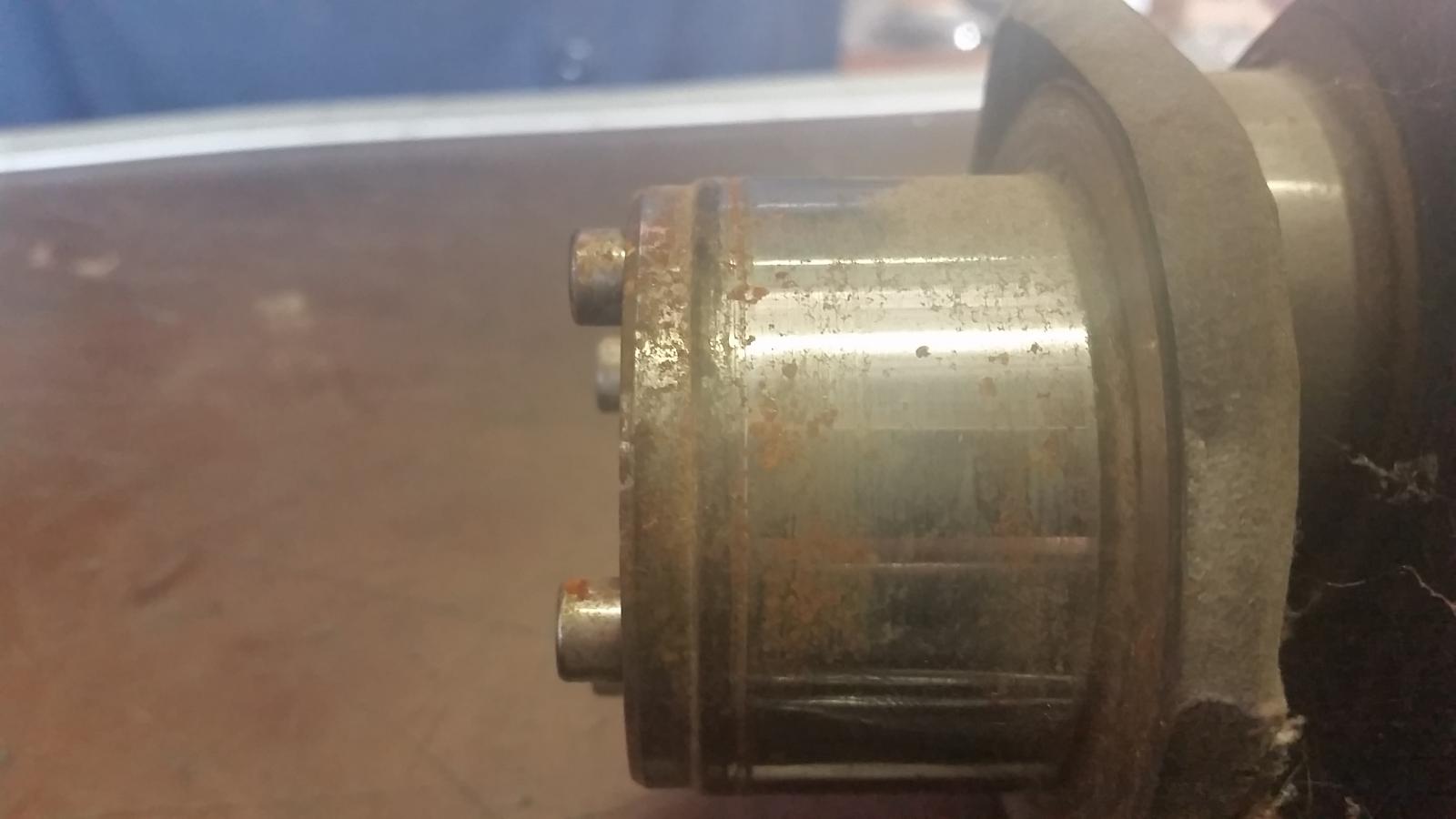

Also learned something new today. I have always heard conflicting stories about 12V and 6V flywheel / crank compatibility. Today I got, what I believe to be, a definitive answer to the puzzle from someone with 30+ years of VW mechanic experience.
Here are pictures of the two cranks in question:
6V Crank
12V Crank (My Crank)
Because of the extra machining on a 12V crankshaft, you can use either a 6V flywheel or a 12V flywheel on a 12V Crank. Because of the lack of machining on a 6V crank, you can only use a 6V flywheel on a 6V crank. This subject seems to be cloudy for many and it was for me until today. With pictures it all make sense.
If you put a 12V flywheel on a 6V crank, the flywheel does not seat on the crank surface. I have heard this causes excess stress on the end of the crank, turns it into an egg shape and ruins the trust area of the case. Enough with school....How about some scenery from the road?

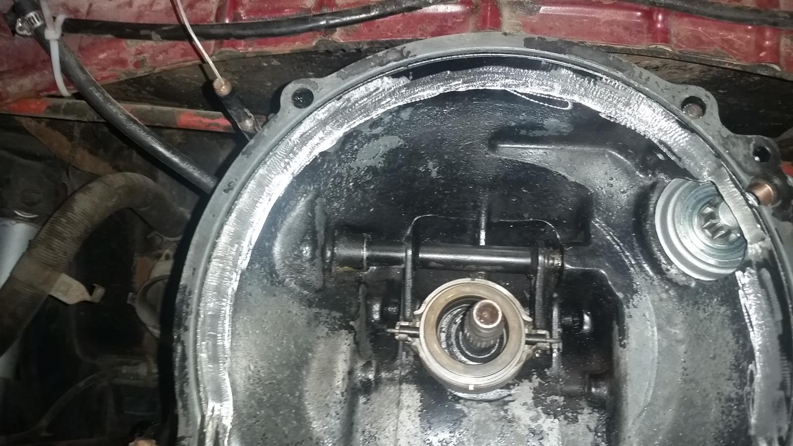

One of the things I had to consider for my build is the fact that I have a 6 volt transmission in this car. The engine i took out was 6 volt flywheel and 6 volt starter. The rebuild longblock I purchased is 12 volt. Here is an obstacle.
There are a couple of things you have to consider when putting a 12 volt flywheel in a 6 volt transmission. The first being that you need to run a 12 volt starter. The 6 volt flywheel is 1/8" smaller and has fewer teeth. That gives you two options: 12 volt VW starter with a conversion bushing put into the transmission or an auto-stick starter that does not require the use of the bushing area. Here is a picture of the auto-stick starter in place, and the bushing that would need to be replaced if you were to go with a standard 12V starter.
On a normal starter, there is a shaft that is supported by the bushing. These shafts are different sizes between the 12V and 6V starters. The auto-stick starter is self-supporting. The part number for Oreilly's and Autozone are 16300. Or Bosch SR-17X. The Oreilly's option was only $40 with a lifetime warranty.
The other thing you have to consider is making room in the bell housing for the larger flywheel. Is just takes the right tools and some patience. We had the engine in and out 3 times to get it right. Next time I would not be so conservative with my grinding. Here are some pictures.
In my case, you pretty much had to make room the whole 360 degrees. Going into it I thought that there would have to be certain areas to clear. Now I know you just need to grind that shit out.
Here are the after pictures. In my case, we needed to clear a 1/16" all the way around going 1.5" deep. This gave us about .050" clearance inboard and enough room around for the flywheel to spin freely.

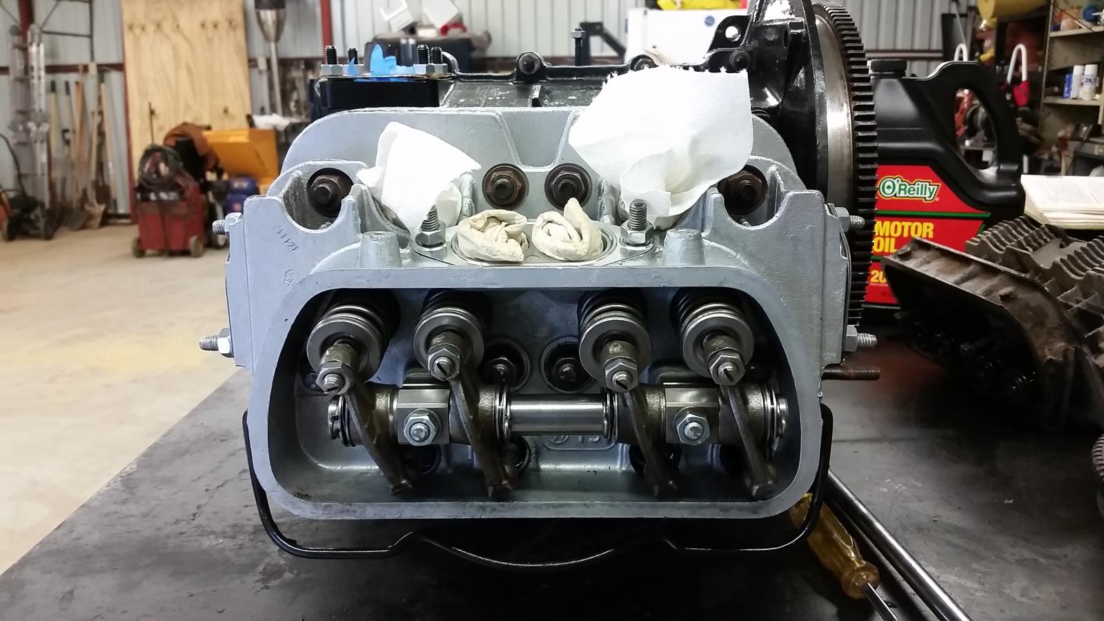

Come to find out I had reused the pushrod tubes out of the old build without changing the rubber seals. What a horrible mistake. I had to take the whole thing apart to change out the pushrod tubes. I was not a happy camper, but I learned an important lesson. Live and learn.
I woke up early yesterday. I was pretty sure we had all of the bug worked out. I was out in the shop by 6 am. The car was running by 4 pm. I was wanting it done far earlier in the day, but you can't rush an engine install. I missed a VW only VW show about 60 miles from my house. I guess I 'll have to go next year.

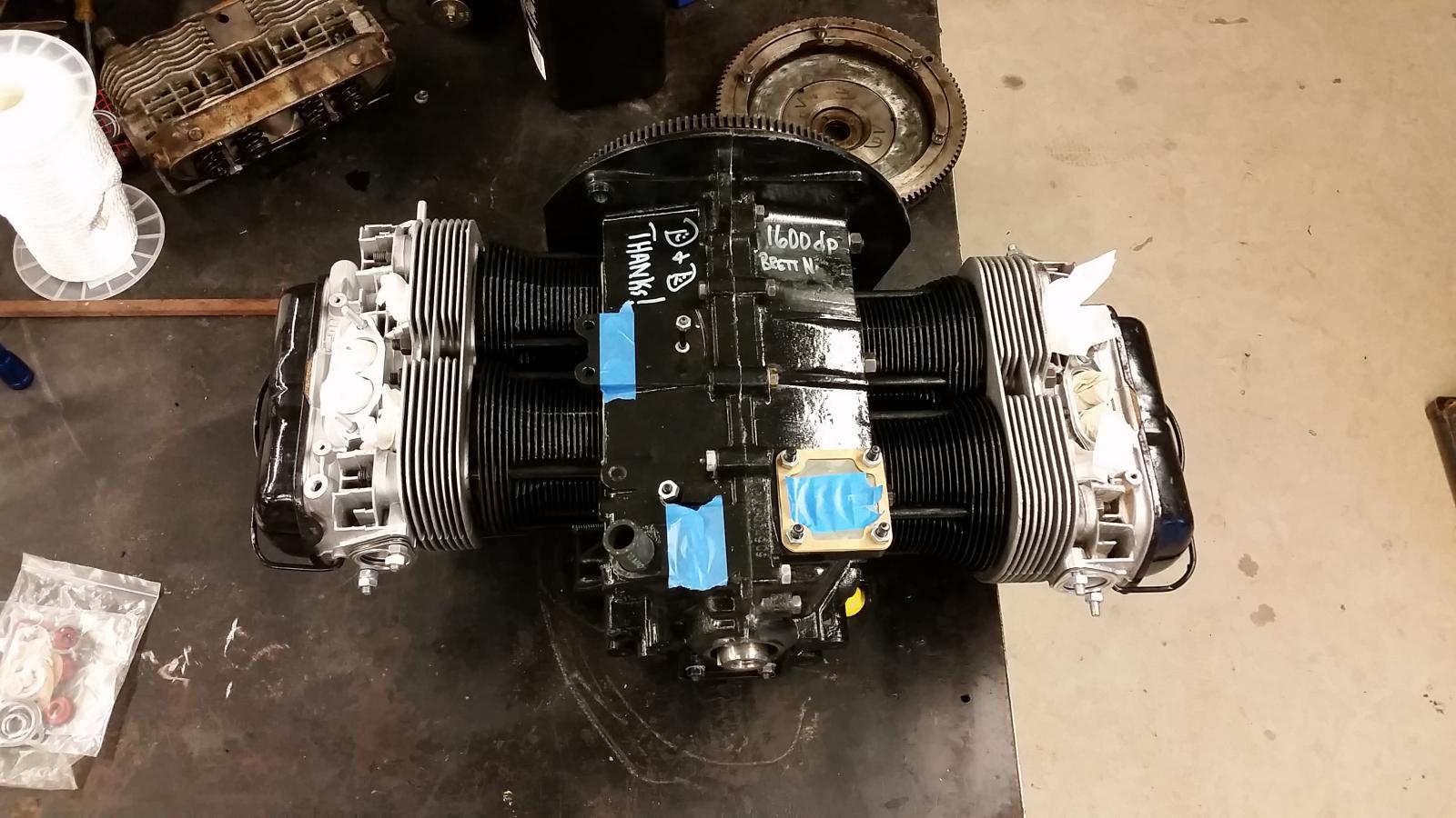

I'm going to put it back together with new rings and a different pair of used jugs for the 3 & 4 side. The rebuild dual port heads will go on it. If anyone needs a rebuilt long block in the near future....
I'd be hanging on to the old motor for a while.
Unlike the one you have in it now, you know what is inside..

Definitely knew what I wss getting into. With a rebuilt long block, new clutch and new starter, I should be good for many miles to come.
At least I can tell the transmission was actually rebuilt as promised. The fluid in it looked brand new, the bell housing is ground for 12v flywheel and it wouldn't cruise the speeds that it cruises without being a freeway flyer.
EDIT: Mechanic just called. The case and crank check out believe it or not. He said the case is still standard and looks good. The crank needs a minimal amount of work with some Emery cloth, but checked out fine. He is going to throw in a new set of main, rod and cam bearings for me and call it good.

Bobnotch wrote:
Adam, did you get your trans axle issue figured out yet? Basically where you want to grind, is at the 4 engine bolt thrus. You only need to take a little off each (mainly at the highest points of each), IF the transaxle is still a 6 volt unit. However, you might get lucky and have a 12 volt swing axle trans in the car already, that someone installed a 6 volt conversion bushing into (yes they make them to go that way too). That part doesn't really matter since you've already got the AT starter (self supporting).
The engine looks good. Sorry to hear about your exhaust stud though. That sucks, but it's also not to be unexpected.
Bob,I checked the trans and it had already been cleared. You can tell it was ground.
I can't wait to get it in. Hopefully I get the head back today. If not, tomorrow.

As far as this weekend goes, working on old cars can wear your ass out sometimes. Friday was my mom's surprise birthday party. Saturday I woke up way early and went from Sadler to DFW to austin to DFW and back to Sadler. What a long day of driving.
Today was spent troubleshooting and trying to get the engine back into my Squareback. Had it not been for a rouge exhaust stud both losing its threads and breaking off in the head, I would be driving it right now. Nothing like getting everything almost ready to put back in the car to figure out you have to tear it all down and take parts to the machine shop.
Looks like my first drive with the new engine will be delayed for a bit. I have a good relationship with a local machine shop. I'm hoping they will have some time this week to get the head back in order. I have never seen a head stud so seized in a head.
We tried double nuts, heat, lube, more heat and all that just to get it to where it broke flush. Then we drilled it out and worked for an hour with an easy out before the tip of the easy out broke off in the hole. Like I said, thank god we love these old cars or I might have turned mine into a BBQ tonight. Smile
Now I hope to have her back on the road Wednesday. I need a day off after this weekend. Smile
At least the rebuilt engine looked great. Here are some pictures.
As I bought it. Many thanks to Bsnean for offering this one up for sale.
Testbud build showing signs of care and quality. (Thank you Darrell)
I am swapping out heads because my tin is single port and the heads are in great shape.....except for that one exhaust stud Wink
Rebuilt dual port heads.
This is how far I got when the head stud decided to derail things. All I had were heater boxes, exhaust, distributor and carbs. I was about a hour or two away. Now I am a day or two away. Till the next battle.
After everything is back together I will have a rebuilt engine, new clutch, new starter and great weather. It is about time to drive for hours each night in weather that doesn't make you sweat.

With the high of a successful trip, I am now in the low of a crappy rebuild. The engine in the Square has some assembly issues that have cause the main bearings to go out. We can back up first.
After a 1000 trip to the Austin area, the car started sounding a little loud. It seemed to have a lot of crank case noise that was not there before the trip. When looking for a cause, I thought it might have been a noisy clutch or throw-out bearing. After driving it a couple more days, I decided that it was time to pull the engine and tear it down just-in-case.
It is good that I took the time to trailer it to my parents' shop and tear into it. What we found were a few different issues.
1) Oil blow by on #3 and #4 cylinders. I was told that the engine was rebuilt with new pistons and cylinders. This was not the case. #3 and #4 both show scaring and pitting from water damage. It looks like these cylinders were reused from another engine, or these were with the engine for a long time.
2) Silicone used for assembly where it should not be used. It looks like the oil pump cover plate was smeared with silicone before being put in place. The oil pump gears were also not set right and grinding into the cover. This caused silicone to get inside the engine. The case halves were also put together with silicone. Another big no-no. If a piece of silicone gets into an oil galley, that could cause major issues.
3) Main bearings installed incorrectly. #4 bearing was locked to the crank. It could not be spun by hand, and the crank was not able to be turned over when sitting in only 1/2 of the case. We finally got the bearing to turn with a pair of pliers. Looks like it was about to seize to the crank. We also found that #1 (thrust) bearing had not been indexed on the case pin. The case halves were put together with the bearing spun about a 1/4" out. This caused a high spot on the bearing, excessive wear and scaring. This was more than likely the cause for the excess metal savings on the oil drain plate.
I am going to take the engine case and parts to a reputable VW shop in Grand Prairie to see if the case is usable, make sure the crank is still usable. It breaks my heart that the engine is hurt because it ran so good, but this time I am going to fix it right.
Because of how much i liked it before, I am going to keep it 1600. The heads are fine.
Pictures are worth 1000 words. Here is some of the carnage.
This was the final factor that made me decide to pull the engine. Metal shavings in the oil are never good.
This is #1 main that was missed. Looks like the index pin may have been pushed into the case. You can also see some of the silicone that was holding the case haves together.
This is the bearing that was missed when assembled. This would have caused the rotating assembly not to spin when the case haves were being torqued.
This is the #4 bearing that was almost seized onto the crank. Looks like it may have been spinning in the bearing saddle. That was more than likely the noise I heard when the engine was at idle.
Here is one of the jugs from the 3/4 side that had scaring and water damage.
When we started and the best mechanic I know. Stan the Man.
Heads look good.
All in all, I am lucky I caught it before it seized. Let's hope the case and crank are not ruined so that I can rebuild this one and resale it.
