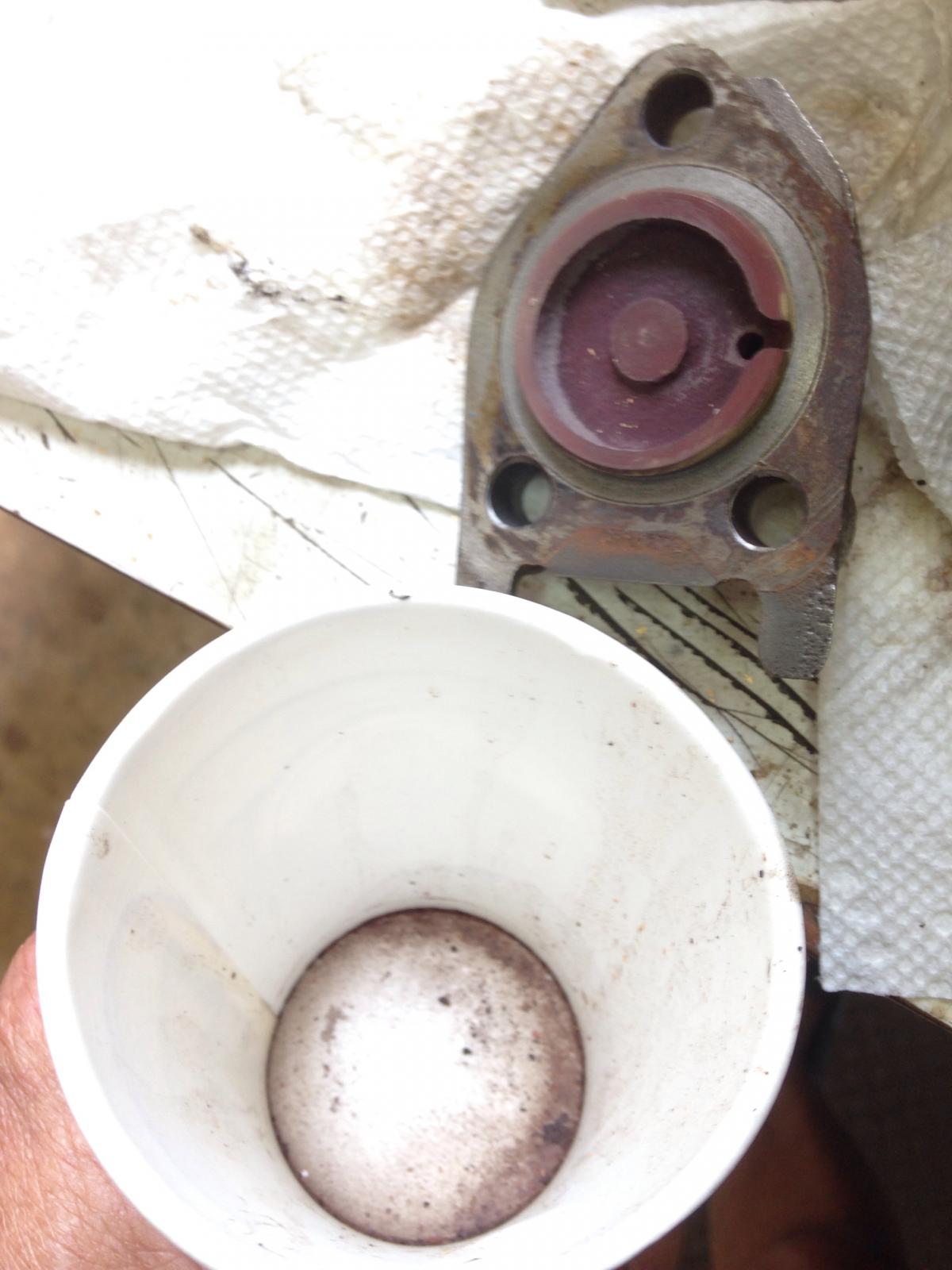

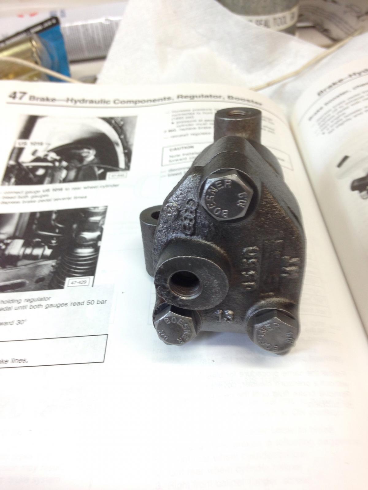

Flushing out the rear Brake Lines produced a never ending supply of "Pink" brake cleaner.
Knowing this isn't right and also knowing that the brake pressure regulator is in the line I figured it was worth a look. Unhooking it would also remove the flow obstruction to effective brake line flushing.
Once removed I finished flushing the brake line to the master cylinder and back to the Tee with minimal effort, crystal clear brake cleaner.
The brake regulator itself was half undercoated and half rusty mass.
Plugged up the brake line ports and used gasoline to remove the under coating and then wire brushed the unit.
Still was getting pink when flushing it, this is the source of the pink!
Did some reading...... Big ball bearing inside.... Pishaw! No biggie!
Removed the three bolts but that only gained access to the discharge chamber. Anything under that had no obvious way to get at it and I Wasn't about to destroy the unit!
Inside was coated in pink!
The amount of crud I flushed out was staggering as well!
Cleaned it up, the rubber seal was soft and pliable, a quick coat of clear and ready to install!
This only convinces me more that these old systems are full of crap and are probably the cause of good new cylinder failures.

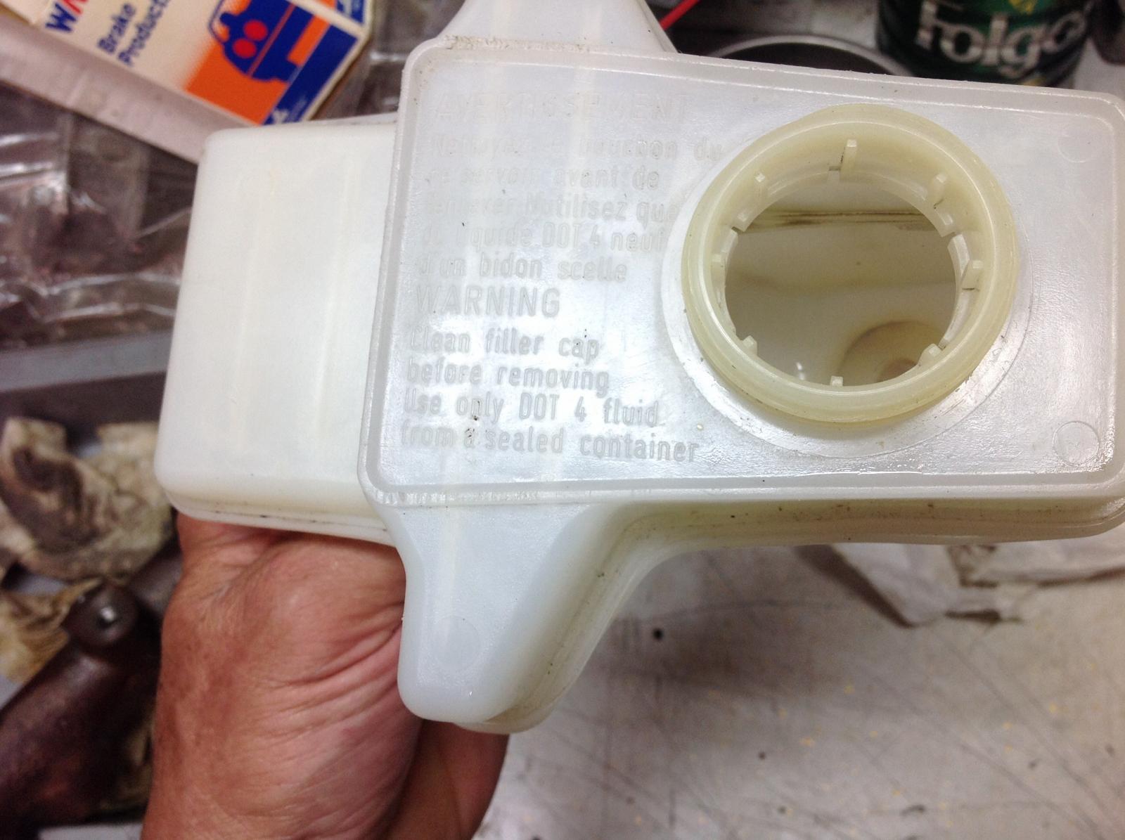

djkeev wrote:
I plan on Using DOT 4 as indicated on the Reservoir.
Anyway......
I figured........
"What's the harm?"
Three cups.....
Cup 1
After gravity draining the RF Wheel, I shot a gentle blast of compressed air through. This is Brake Fluid only...... No solvent.
Cup 2
Using aerosol Brake Cleaner I shot a long blast of cleaner into the pipe followed by a gentle puff of compressed air.
Cup 3
Again using Brake Cleaner followed by a puff of air
Is that rust in the cup or dirty brake fluid residue?
I'll let it evaporate, wrap a magnet in a piece of plastic wrap.... See if it is ferrous or not.
Common sense says......Had I not flushed the metal lines, my new brake fluid would immediately look like cup 2
Dave
the fluid don't need to evaporate, just runt eh magnet under the paper cup.
that don't look like a lot of rust to me. (if it is rust) See if more comes out,
