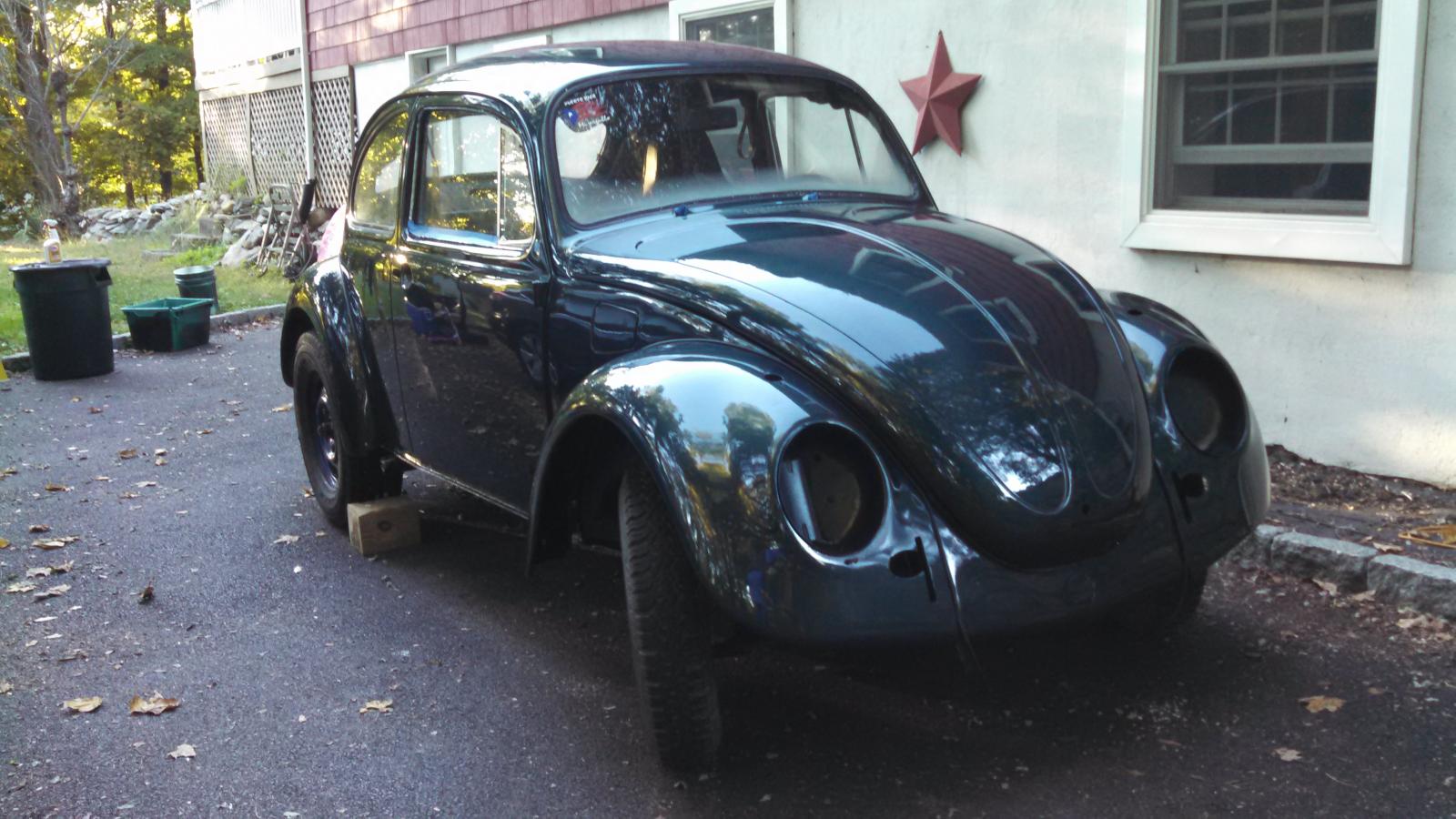

Here's what your fenders and lights should look like.

PostPosted: Sun Oct 11, 2015 8:30 pm    Post subject: Reply with quote
johndl58 wrote:
Its where the 1970 bumpers slide through. Doesn't everyone do it like this??
Those are not 1970 fenders. They look early 60's. Someone slotted them to fit the 68 and later front bumper brackets.

PostPosted: Sun Oct 11, 2015 8:09 pm    Post subject: Reply with quote

PostPosted: Sun Oct 11, 2015 7:47 pm    Post subject: Reply with quote
Looks good. But yeah...whats up with the fenders? What are the big slits on the horn grill holes about?
johndl58
Joined: October 01, 2013
Posts: 422
Location: westchester ny
johndl58 is offline
PostPosted: Sun Oct 11, 2015 7:46 pm    Post subject: Reply with quote
Yeah. Sometime before I got it, someone thought it a good idea to fit some early model fenders on it and franken the surrounding area to make it work. Unless you "know" its not that brutal. But we "know". Haha. I just didn't have the energy to open that can of worms to fix it 100%. I figured if it looked bad enough I would chop the nose and Baja it. I'm gonna roll it like this for a while. See how it feels.
kielbasa
Joined: November 28, 2007
Posts: 1443
Location: Garbage Grove, CA
kielbasa is offline
PostPosted: Sun Oct 11, 2015 7:14 pm    Post subject: Reply with quote
You got something odd going on with front fenders. Buff job looks good though

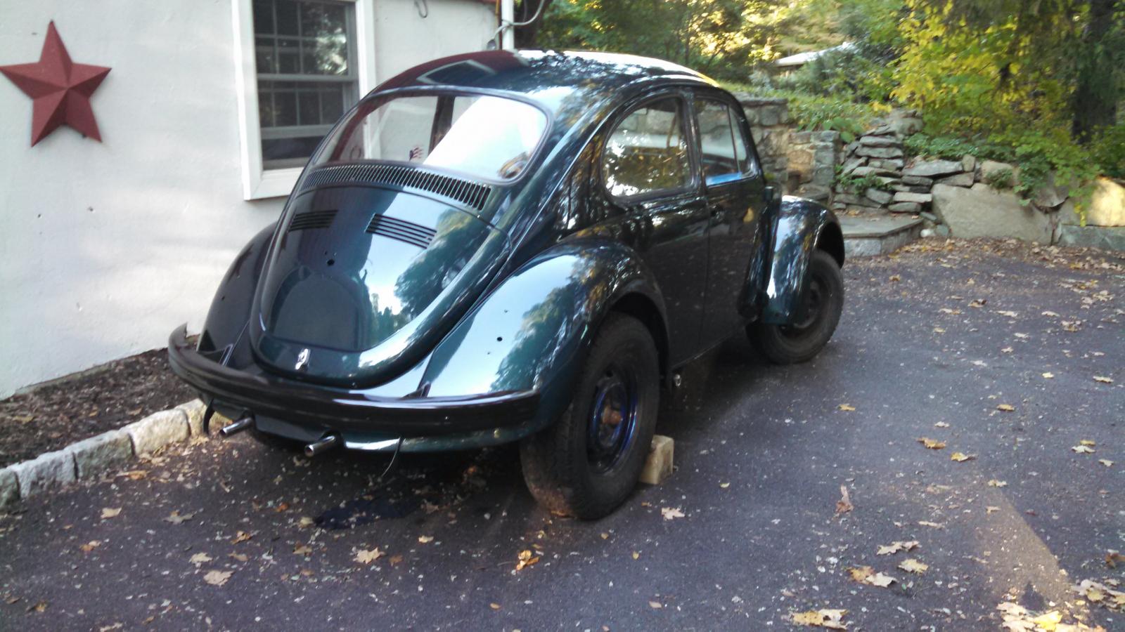

PostPosted: Sun Oct 11, 2015 6:06 pm    Post subject: Reply with quote
So it ended up being about 30 hours of wet sanding, 1000, 1500 by hand, and 3000 with the da. Then probably maybe 8 hours of compound, polish. It was a total pia but worth it. And I probably could've spent even more time on it.
Few more progress shots. Trying to figure out what to do about the front marker lights. Since it has old style fenders the marker lights that fit are single bulb. But since its a '70, it is wired for dual bulb. Any suggestions? I now have 2 pairs of single bulb marker lights ( ordered new ones not thinking it through).

Posts: 4915
Location: Port Orange, FL
buguy is offline
PostPosted: Sat Oct 10, 2015 4:13 pm    Post subject: Reply with quote
Thats right. You can stand back and look at it and say...."hey I did that with my own two hands!"
And now you will be less scared to tackle repairs and maybe even be foolish enough to do another car!
Turning out nice. Once you hit it with polish it will really look nice! Work that polish it well, you will get a nice deep gloss!
