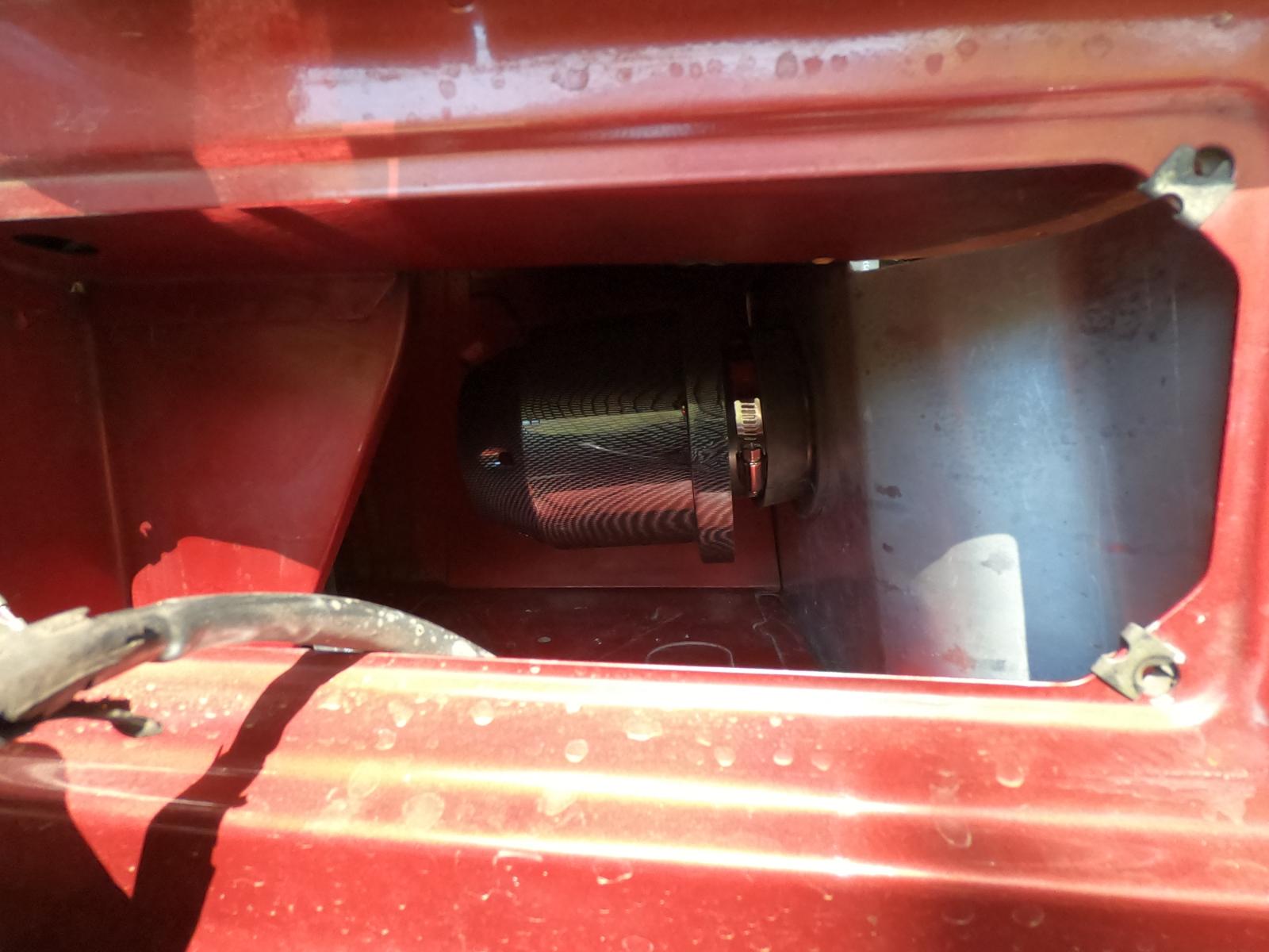

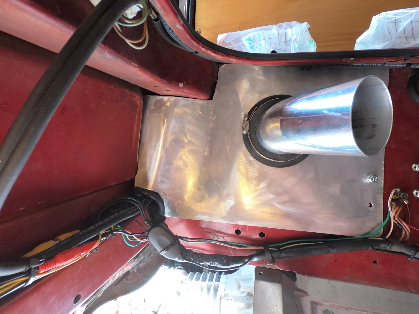

Built a cold air intake block off plate for driver side rear box. Aluminum plate $5.00, rubber gromit $6.00, aluminum 45% $20.00, RMW intake $85.00? Total $116.00, RT$27531.67

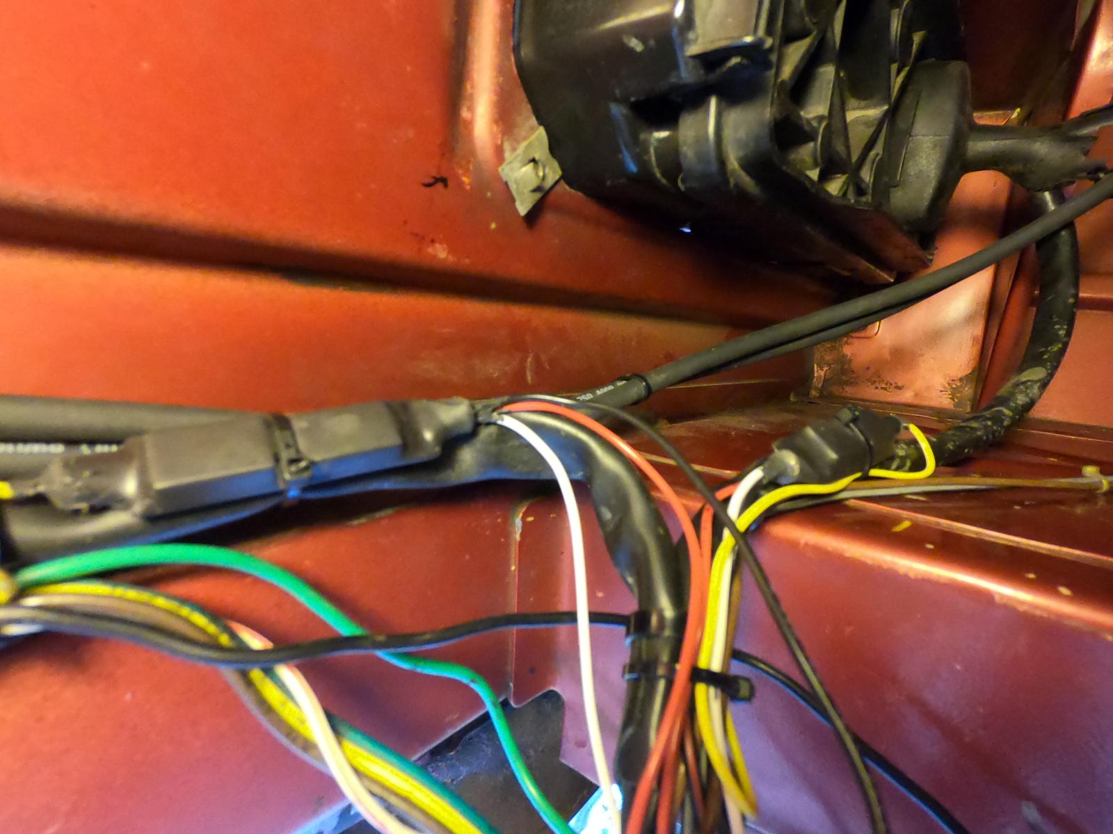

I did a couple wiring mods installing a flat 4 trailer plug and the blinker genie.
These are sweet, turns the side markers to double duty, normal on and blink with turn signal. blinking is opposite of tail light and really catches the eye. I tied them all in at the wire split in the drivers side rear corner. Blinker genie $35.00, Trailer plug $15.00, Total $50.00 RT $27055.67

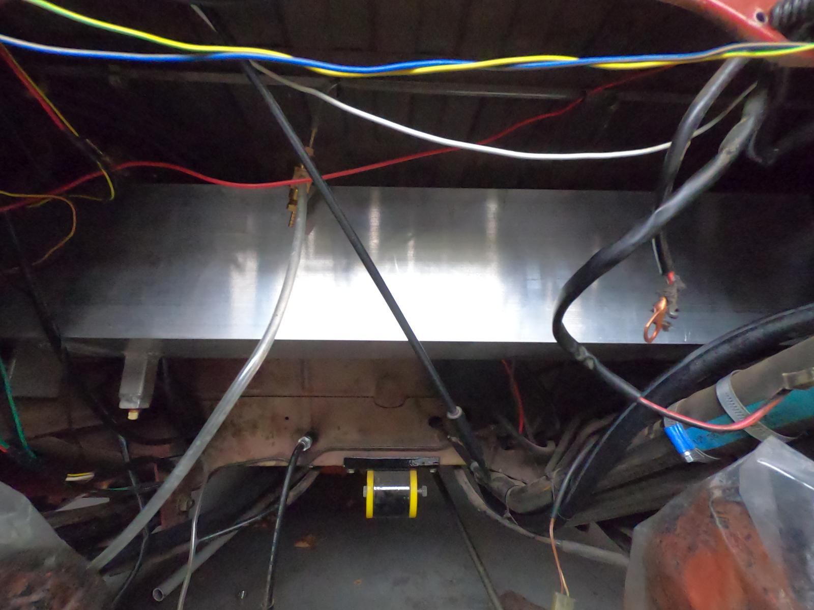

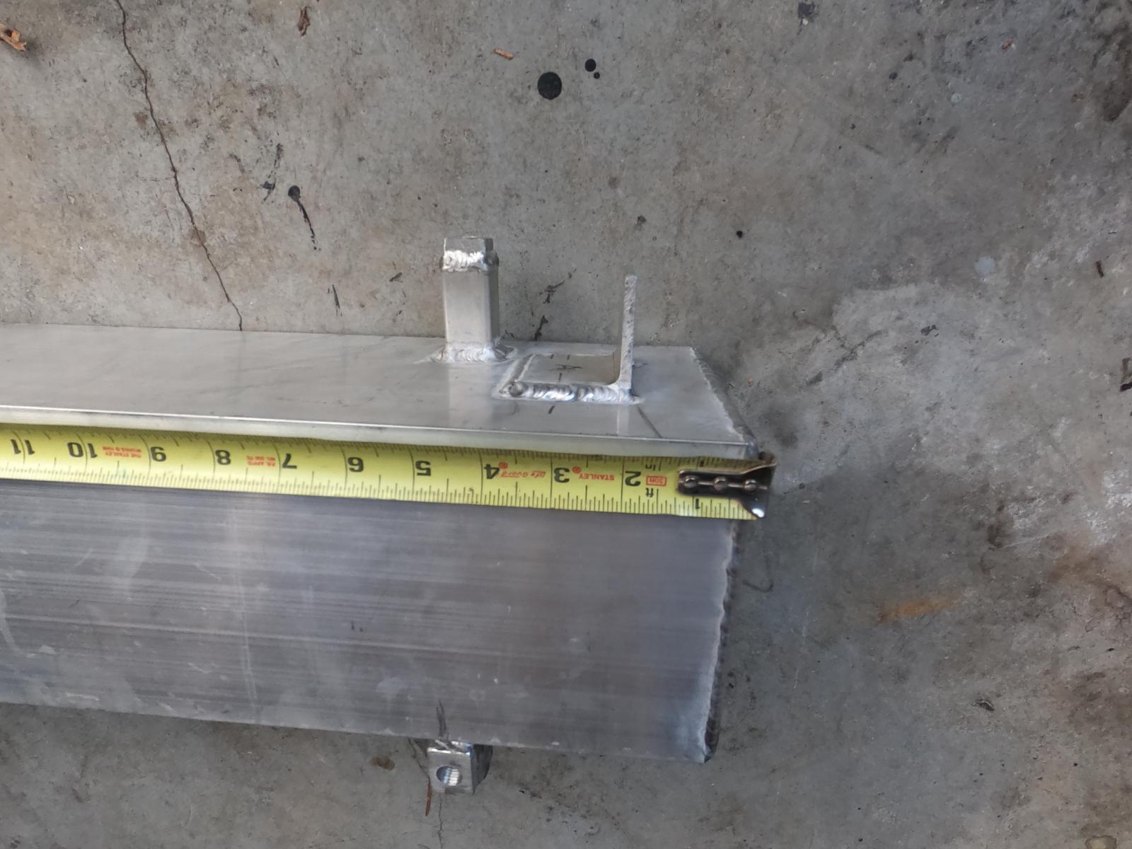

There is one other improvement I made while the engine and trans where out. A spare 4 gallon gas tank that sits on the frame rails over the trans. 6x6 extruded aluminum, fill and overflow on top, Manual valve on bottom. Fed from gas tank fuel return line. Parts and materials $200.00, Welding shop time $300.00 Total $500.00 RT 27005.67
mock up

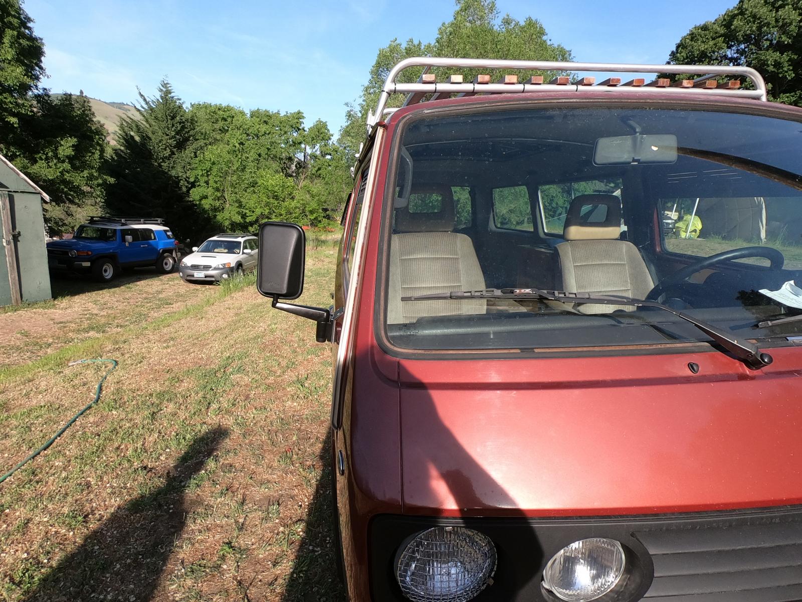

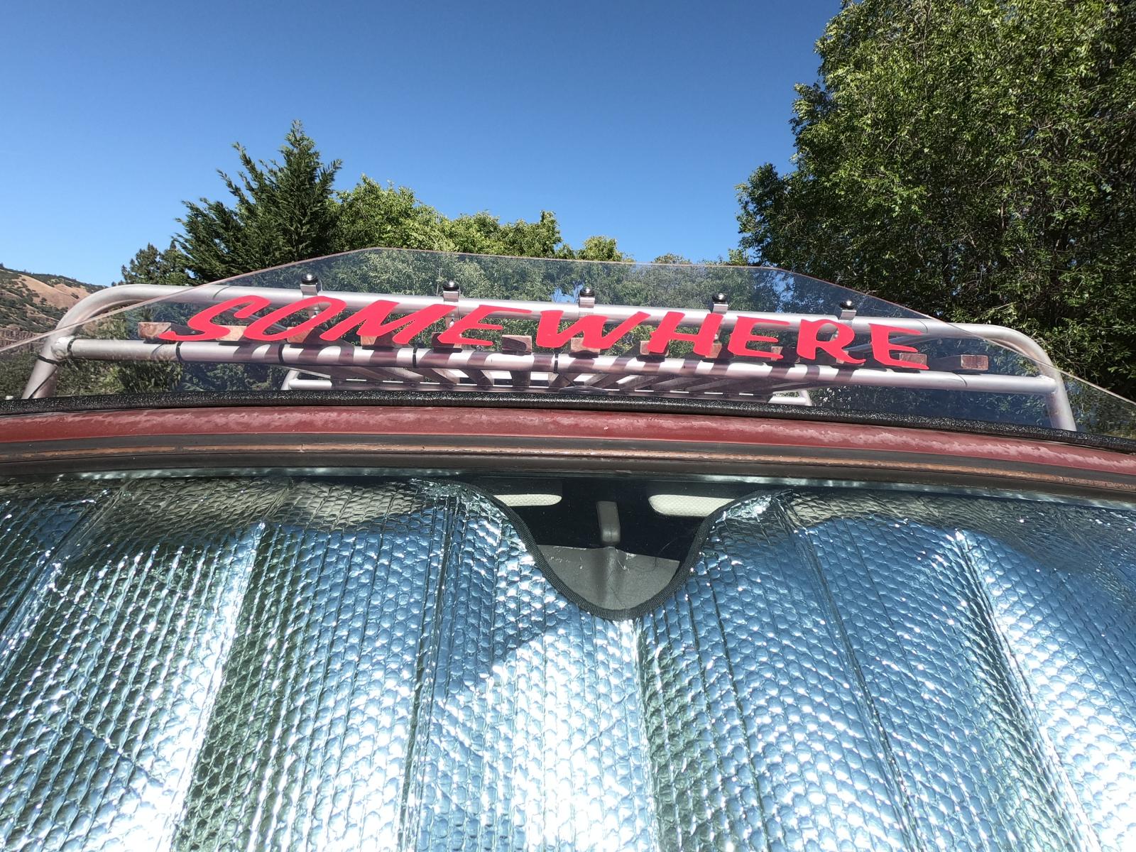

I mounted a roof rack ahead of my sunroof and figured a wind dieflecter would be a good idea. Rack $150 or so, wind deflecter $60.00, RT $26490.67
what a long strange trip it's been

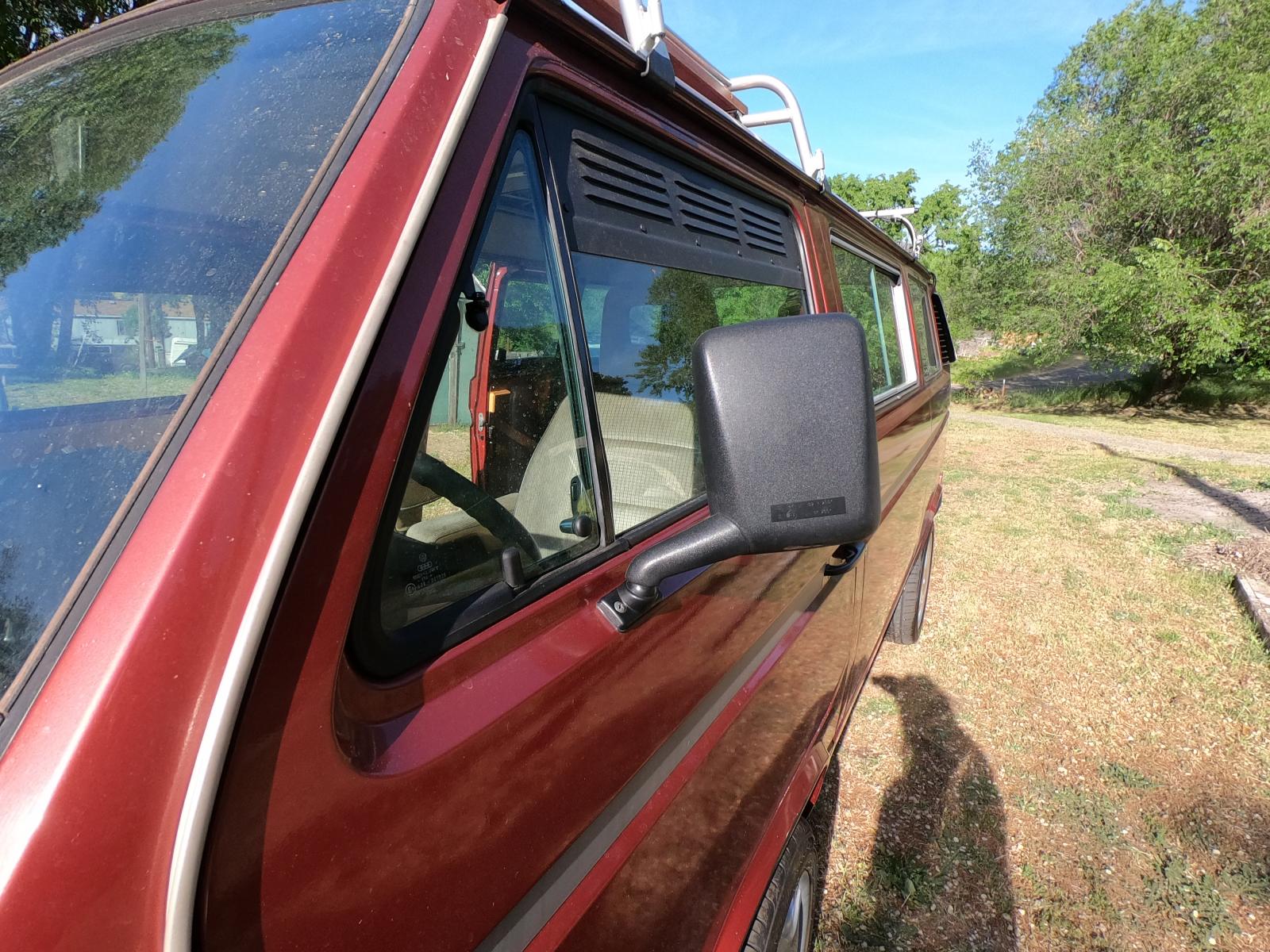

I made the change to Land Rover mirrors. Brackets work nice, mirrors are as steady as they can get. Far better than my windshield mirror. Brackets and mirrors $125.00 RT $26280.67
