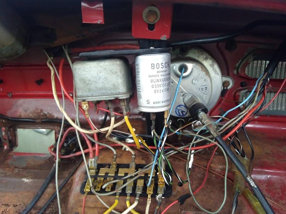

KTPhil wrote:
It looks like you swapped the high and low beam wires at the fusebox. White-to-yellow is wrong. Swap the short wires from the relay to the fusebox and you'll be set.
White is high beam, yellow is low. And the dash light should go to the white.

vwfreek61 wrote:
I added a dimmer switch from a '66 to the turn signal, since I can't operate the foot switch.

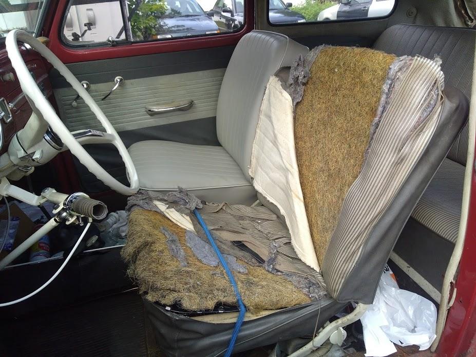

Looks like it's been awhile since I've updated this thread. I haven't done much work in the last year, just mostly driving it.

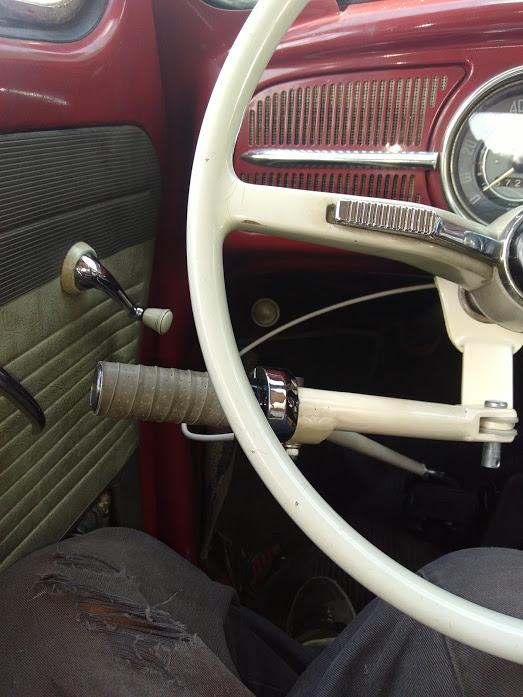

I fabricated a set of hand controls that look a little more period correct.
I really wanted to save the '64 only seat upholstery, but it was getting pretty bad from regular use. I recovered them with TMI covers and pads.
A roof rack popped up for sale on craigslist, so I picked that up along with a bunch of VW tools (the guy used to be a VW mechanic back in the day).
That brings everything up to date. I've been gathering parts for a big bore 40hp, so hopefully I can put that together this winter.

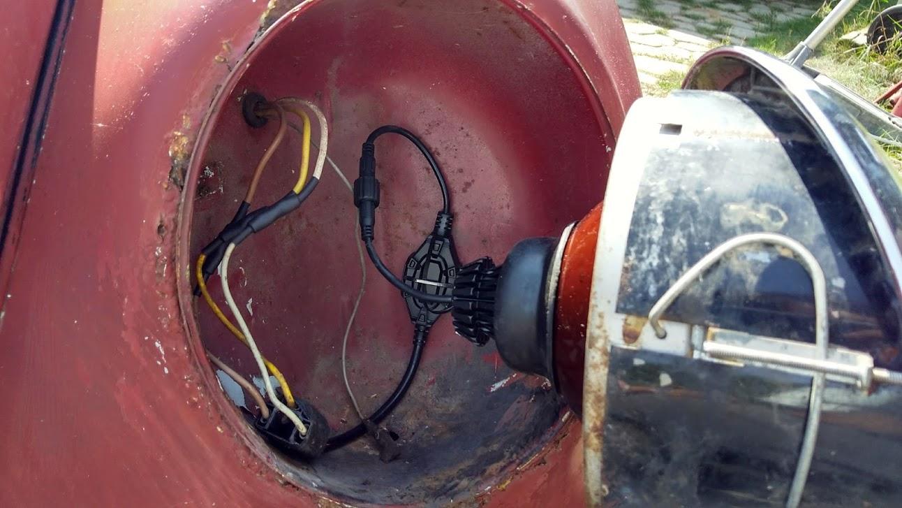

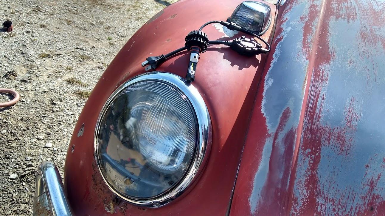

PostPosted: Tue Oct 03, 2017 5:49 pm    Post subject: Re: 1964 "Barn Find" now with Saxomat Reply with quote
Since I drive the car after dark on occasion, I decided to upgrade the headlights. I went with Autopal Cibie z-beam knock-offs, because I wanted the OEM look curved glass, and after searching a bit found some LED h4 replacements that work on 6 volts. Now I can see at night.

Never seen hand controls on a ACVW. Is that something you require or something it came with and you wanted to use? Just make sure any modifications are secure. I had a old bronco turned mail truck you could drive from the passenger side, but it was kinda janky and scared me a few times when the links moved/flexed.
Anyway cool car. I just picked up a metal sunroof '64 myself and look forward to getting it on the road!

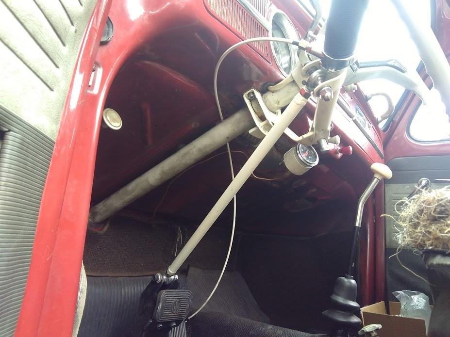

I had to install the hand controls. You've probably never seen a '64 with 2 pedals either. Very Happy

I think I've finally got the clutch and shifter adjusted properly. I've put over 100 miles on it so far.
Pedal to the metal.
Off-the-shelf hand controls don't work well with pedals hinged at the floor, so I had to make a couple modifications.

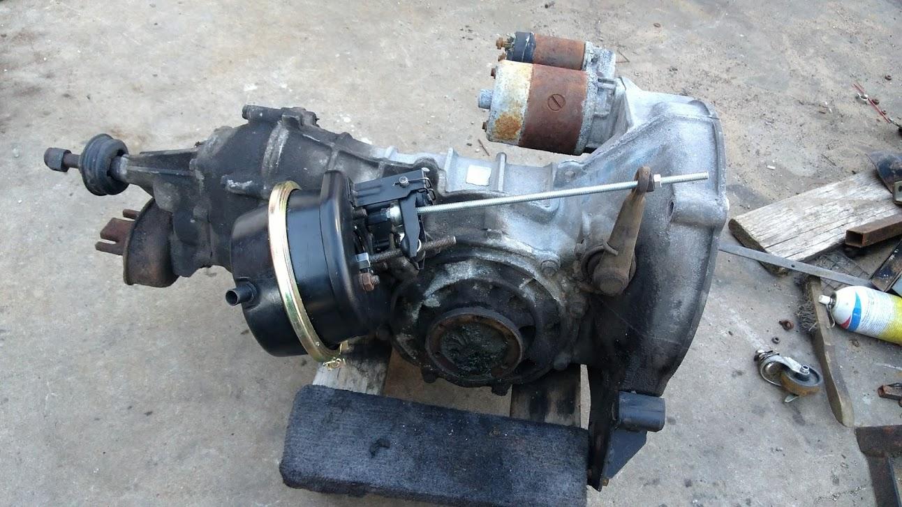

Making a little more progress. Swapped out the hacked up radio delete plate for a nicer one.
Started mocking up the Saxomat parts on a spare transmission. All I had was the brackets, the rest is autostick and misc. hardware.
