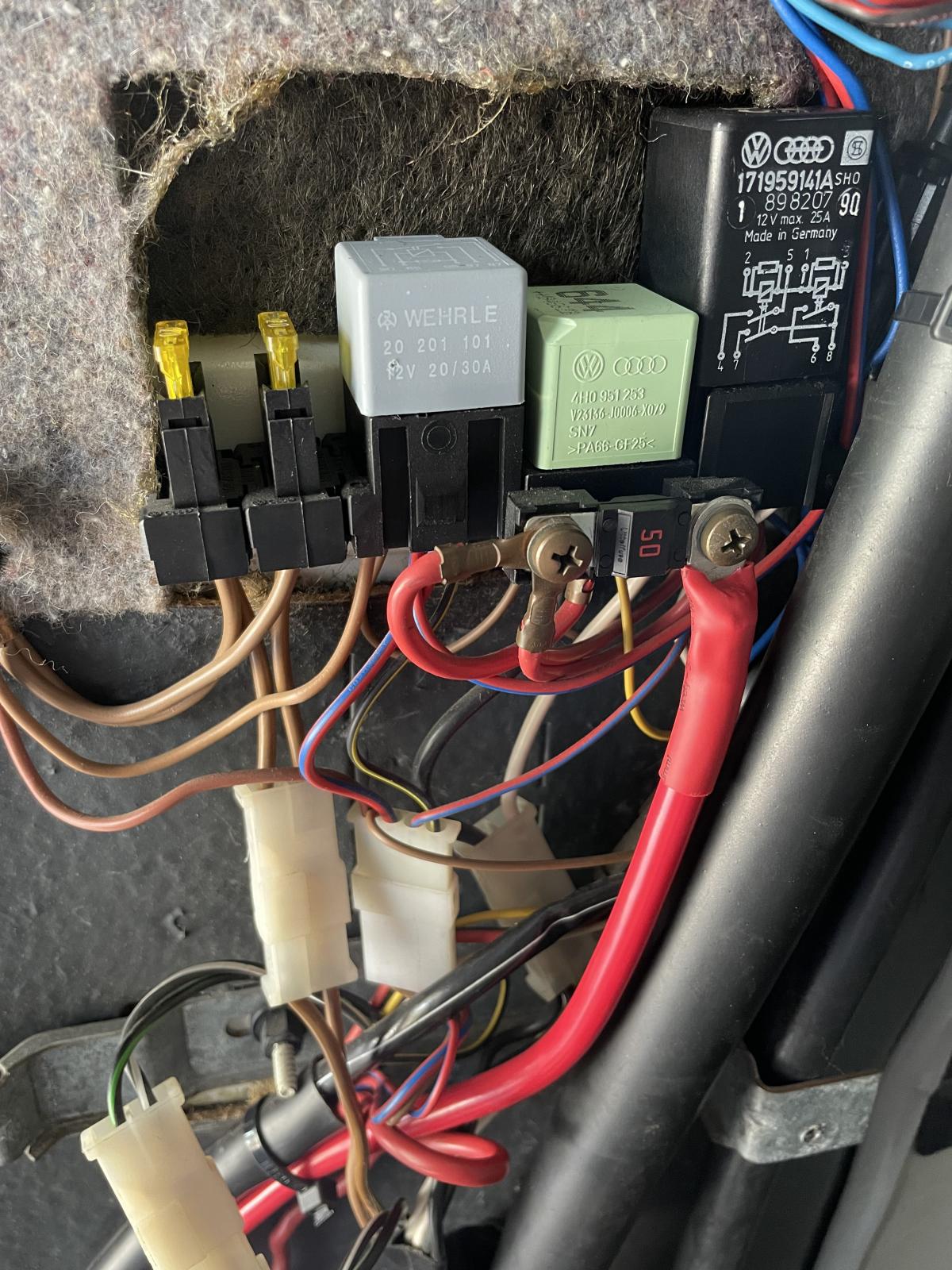

Update 5 years later....
The A/C was no longer blowing cold. The new Sanden compressor pulley was leaking Freon. Had that fixed along with a new receiver/drier, system flushed and filled.
I also decided to go ahead and upgrade the power supply since so many have had issues with the system melting at the fuses.
+ Ran a 6 gauge wire from the alternator
+ Switched to a commonly available 50 amp MIDI Fuse (which I was very surprised fit perfectly)
+ New 30 amp compressor clutch relay
+ New 70 amp blower fan relay
Hopefully good for at least another 5 years....
