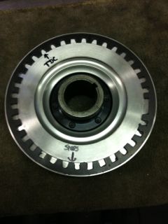

Dub Shop goodies, wasted spark.

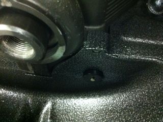

I used a BMW VR sensor. It is mounted at an angle behind.

I got mine off ebay.....was advertised as for an escort.
I made the custom pulley and hub.

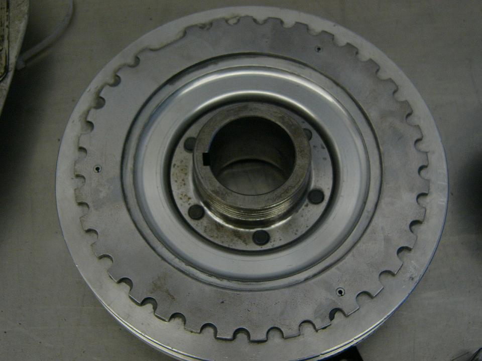

Here’s a wheel off a 4.6 Ford I think. I was going to use it to replace the generic one I had but never got around to it. The one I did use I just scribed a x pattern, measured as best I could, then drilled. Then mounted an indicator and tapped it around until it was centered, before tightening down. Then fabbed up a mount for the sensor. Sorry no pic.’s of finished assembly. Kinda hillbilly but it ran great.

Chickensoup wrote:
Out of curiosity, what technique did you use to get the trigger wheel perfectly centered?
This was before I had a DRO; I used a rotary table on my mill to drill the pulley and trigger wheel. Once the two were mated, I then cleaned it up on the lathe.
With the DRO, the only thing I'd do differently is just indicate the pulley (and, separately, the trigger wheel), punch in the PCD and # holes into the DRO and drill away. (and clean it up on the lathe, once the two are mated together)
