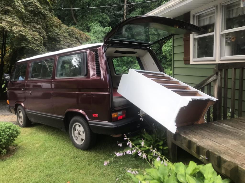

My Van was last used in early June, last time I filled it was June 6th.
Happily it kicked right off with no hesitation what so ever.
I little bit of blue smoke from sitting but that burned off quickly.
I topped it off today with ethanol free gas.
Then we went to work moving some furniture.
I love how this box swallows up stuff with room to spare!

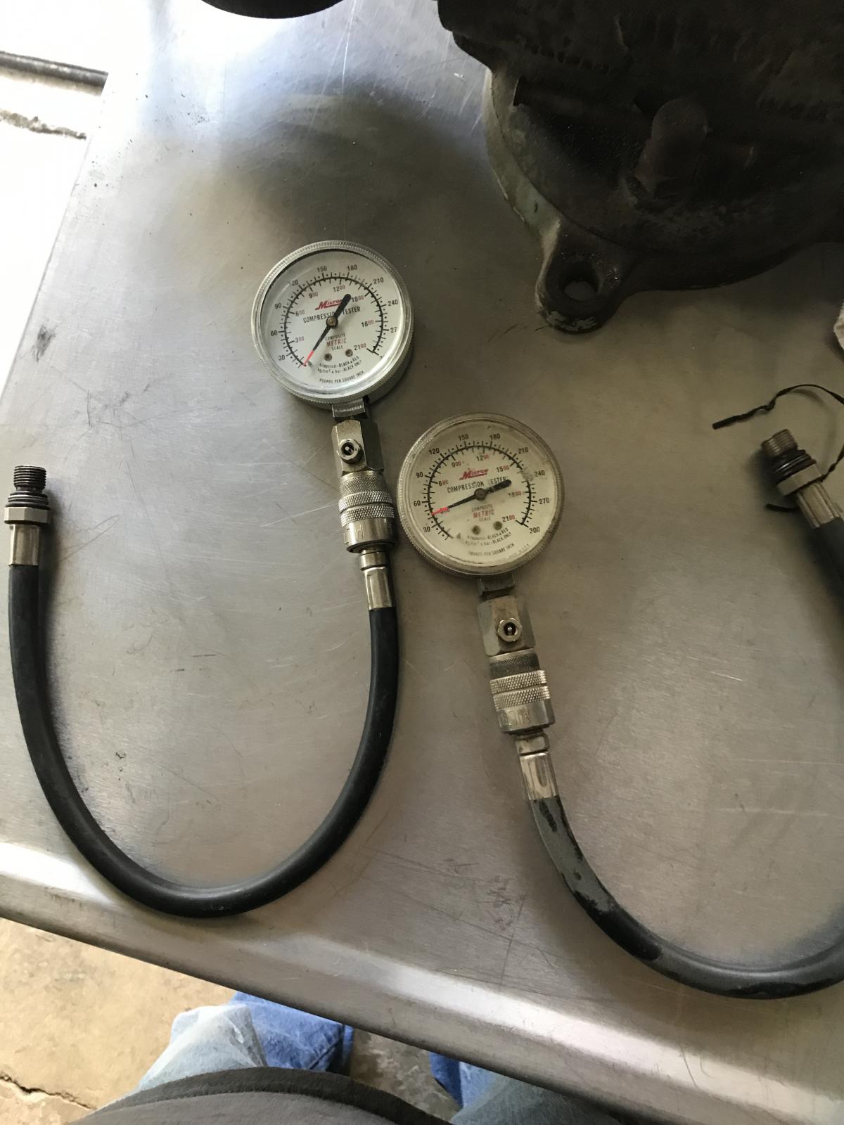

After my trip to New Hampshire
https://www.thesamba.com/vw/forum/viewtopic.php?t=790088
I’m putting together a proper travel kit of tools and parts.
If I had a compression gauge with me I could have avoided so much stress and worry.
Used on eBay $10
Next to The one I’ve had for 40 years.
