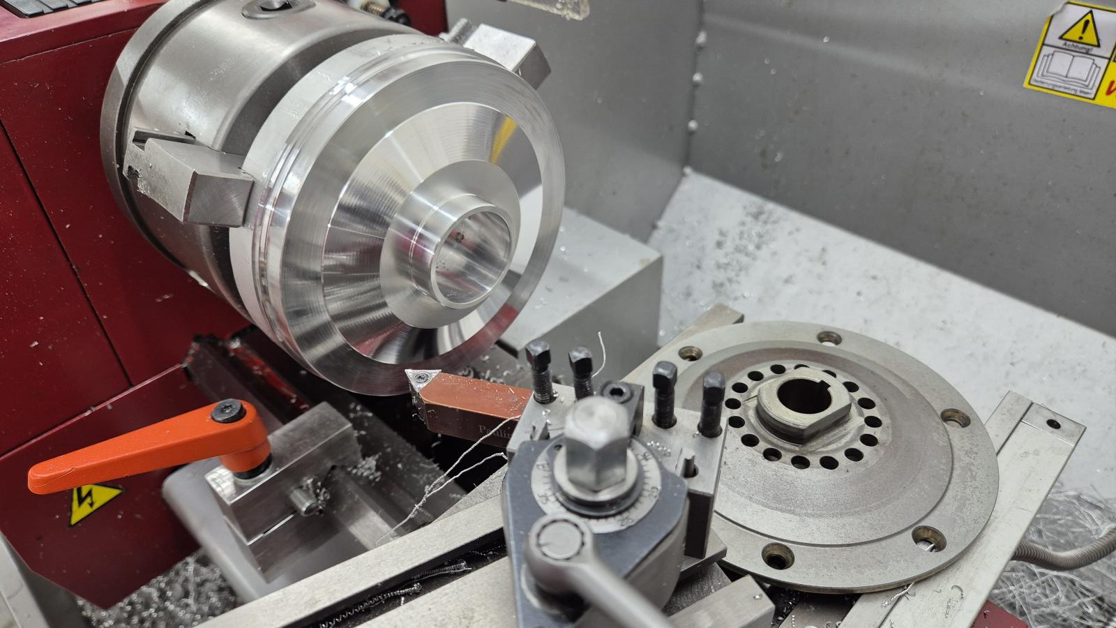

How to fit an old Porsche 911 5-blade fan into a modern aftermarket housing:
To the right the original Porsche steel hub. On the lathe, the new hub in the making. I choose 7075 aluminum.
After drilling all the holes on the mill, I reamed the last 1/10th mm with both parts together, for a perfect fit
The original is rivited, I choose to use titanium shoulder bolts instead. I cut the head to fit proportionally like the original rivits
Everything assembled
Backside, bolts need to be shortened
I made a corresponding pulley plate to fit the new look
Plan is to hard anodize the two new aluminum parts to make them fit the crank pulley and to powdercoat the fan.
