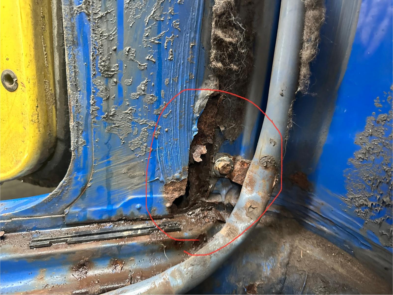

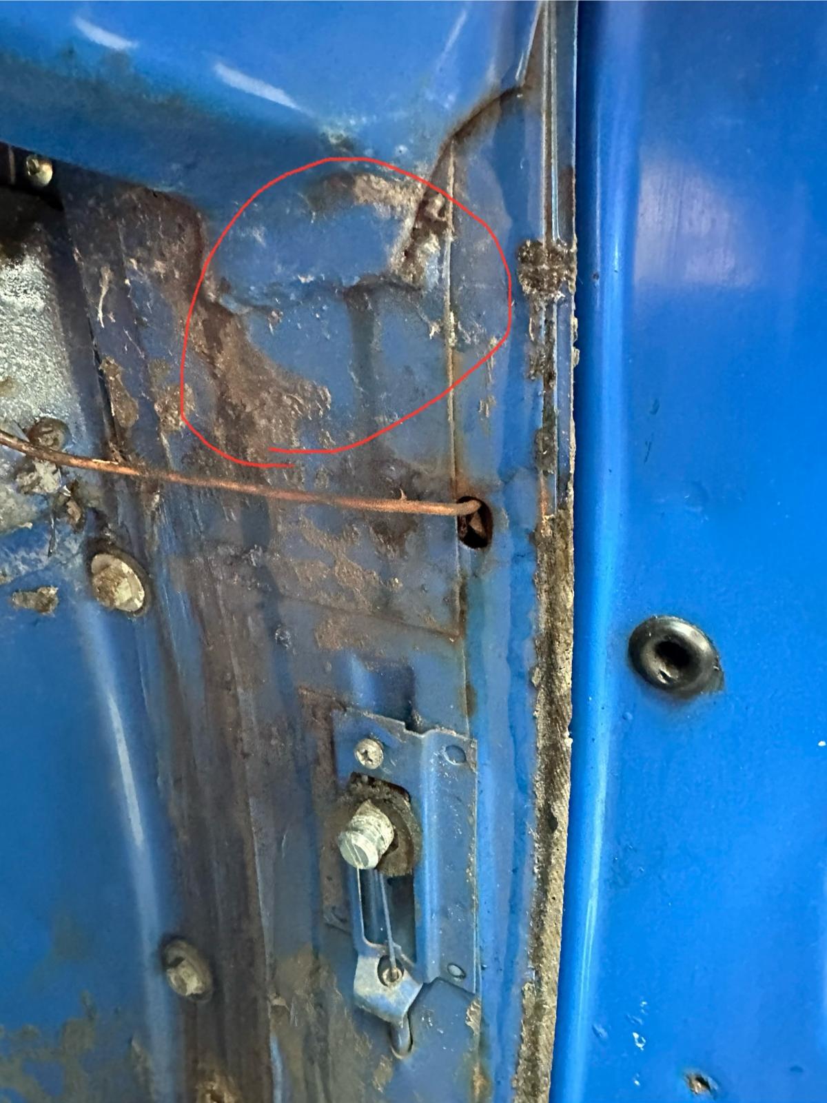

So it's been raining the last couple of days, and I've used this opportunity to find where the water leaks are.
There is water dripping in from a couple of areas that I'm not sure where it would be originating from.
This is the right side just forward of the door just under the dash:
I could see water dripping from here. If any one can tell me what the source of this leak be I'd appreciate it.
On the drivers side I have a rust hole and I'm thinking its from a similar leak.
There is also water in the heater channel. I'm pretty sure it's not coming from the back of the car or dripping down from the doors.
It's probably coming in from the windshield seal. Either between the outer seal and the glass, or the seal and the body into the corner. There should be a piece of tape covering a paint drain hole in the corners of the windshield opening. The right side almost drips on the glove box, while the left one drains on the fuse box, if the tape is missing. Most times these two spots will eventually drain into the heater outlets, then onto the floor.

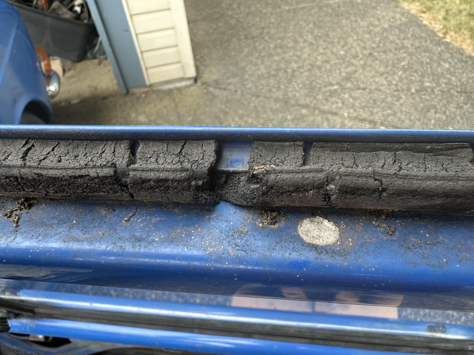

Some more progress to report. I've been working on getting the car more weather proof.
That is the typical condition of the rubber seals on this car.
So far I've installed one door and the rear hatch seal. The rear seal was pretty easy to do. The door was a bit tricky. and I probably didn't do the best job.
When I first bought the car I bought a bunch of seals without dong any research and for the doors I got the Brazil seals. It was a choice of the Brazil or German, the German were like $300 a door vs $40 for the Brazil. They had this grey mould release stuff on them that was difficult to wash off. To get it to fit, I cut a slit in the seal in areas where there is a flange on the door that the seal fits in to. This worked well and we will see how long they last. So far it's been better with the new seal than it was before.
