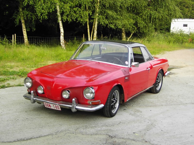

Hello,
Finally after 4 years I have a suitable test car for my own fabricated dropped spindles.
Bought a '66 T34 some time ago and decided to test run a pair of my spindles on the car.
Took me some hours to put them on.
Took advantage of the car being on axle stands to renew the entire front brake system and upgrading to a dual circuit master cylinder with new calipers, hoses etc...
Removed the bottom bumpstop in case I want to go lower.
For the moment it's just sock height with the spindles on.
I like the stance with the stock size rims and new oem spec. tires.
Next week I gonna have the front train aligned.
I have enough cores to make some other sets. I will have 2 sets available to overseas customers.
For details check www.BerT3.be - accept downloading the .doc to read the pages.
https://www.thesamba.com/vw/gallery/pix/156982.jpg
https://www.thesamba.com/vw/gallery/pix/156983.jpg
https://www.thesamba.com/vw/gallery/pix/278328.jpg

PostPosted: Tue Jun 20, 2006 11:09 am    Post subject: Reply with quote
https://www.thesamba.com/vw/gallery/pix/284032.jpg
Finally a photo
Front:
145/65 tires on a 4.5" lemmertz rim with ET 25 and an extra 10mm added wide of the 42mm dropped spindles.
Added an extra 1 outer spline drop at the front trailing arms.
Makes it possible to use new standard height shocks due to almost it's entire stock travel.
Rear:
165/65 tires on a 4.5" lemmertz rim with ET 25
I found this the perfect stance with lots of room and comfort
Note these are both expensive tires !
BerT3
