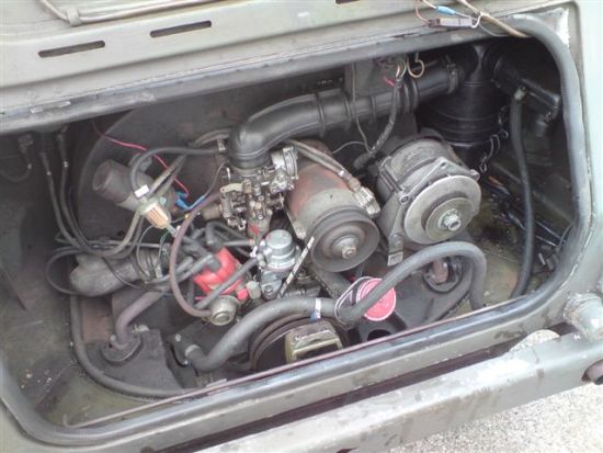

I was at work the other day, and I had a thought. Has anybody ever run a second alternator?
I was thinking about the alternator upgrades that are out there for the stock vw style, and what it would take to do a (expensive) upgrade to be able to occasionally run the off road lights as well as a sound system and not risk killing the car.
At work, and I imagine other places as well, we sell the GM style 1 wire alternator that is pretty much a universal alt. They come in 65 and 80 amp flavors, at a fraction of the cost of a conversion. I already have a second pulley on the crank that ran an ac system. Seems to me it would be easy to fab up a mount, and have one of the GM alternators. Either have it feed to the primary bug system, or have it run a second battery as it's own system power the sound system.
Thoughts?

I've seen GM style alternators installed on off road VWs. Usually the VW generator / alternator is not wired up and is there only for the fan.
Seems like a good idea to me and would make removal and replacement much easier.

I have thought of doing a setup like that also only I thought I would gut the Vw generator/ alt.. to lesson the rotational weight.

We just stuck a 90 amp Nissan alternator on ours, can't remember the exact model but with a little filing it went straight on.

Why not just upgrade to a 90 amp alternator? They are available.

by the time you buy a second battery, the second alt. belt, wiring, fab up a mount, and then put your time into it. Itll be cheaper to just upgrade.

For comparison, 90 amp alt is $160. I've already got a spare battery, and the alt and wiring would only run me about $60-70
-Jameson
So then just do that if you don't mind dicking around with the fabrication. Its been done before. I have seen additional pics posted on here at one time or another.
I did the dual battery on the current project, but wanted it to also look "factory", so I opted for the VW 90A alternator.

I am not a fan of adding additional alternators to these engines. Adding a second one reduces the wrap angle on the fan pulley. On a stock set up, the belt starts really slipping on the pulley somewhere between 4500-6000 rpm. That is fine for a stock engine since that 4500 is redline. Reducing the wrap angle on it by adding a third pulley will knock that number down proportionally.
It would be best to keep the stock position and replace the old generator/alternator a larger capacity unit.

That's assuming the fabricator doesn't take belt wrap into account. I've got a few ideas for adding a second alternator that would provide as much or more belt wrap as the stock setup.

Belt wrap will stay the same on the stock alt. I've got a second pulley on the crank.
If you did that, it would be best to switch over to a flat belt, such as a serpentine. A short v-belt like on a VW can't be bent back on itself far before the belt life is dramatically reduced, and there is no way to get a larger wrap angle without using a backside pulley...not to mention a backside pulley on a v-belt can't transfer nearly as much power as an inside pulley for a given belt tension.
By the time you rig up a serpentine belt (or similar), your extra alternator, and potentially an idler pulley or two, you may as well just have gotten a larger stock style alternator.
You've lost me. There wouldn't be any back belts or funky angles. There would be two separate belts. Both would be roughly the same angle and wrap as the stock alt belt.
If it goes to the pass side of the carb above the alt, than angles will be almost identical. Granted, I might get some underdrive issues, being that the pulley is small.

Sorry, I didn't see your post between mine and the one I was responding too. I added the quote for ya to avoid confusion Wink
As for your double pulley idea, sounds like a good plan to me. Much better than piggybacking off of the other pulley like others have done.
Is that a Mexican bug pulley for air conditioning, or a custom job?
Ohhh ok that makes more sense.
It's a mexi bug engine. Dunno when it got put in the car. I wasn't sure it was at first, but then I saw the "Hencho en Mexico" on the engine

Nice! I thought that looked familiar.
Where would you mount your second alternator?
