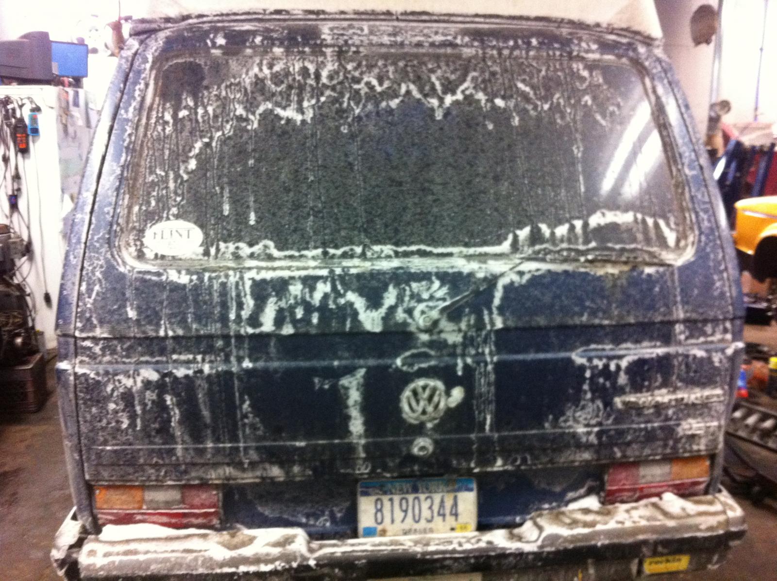

we've applied it as a test to a raw shiney metal patch on my buddies ford ranger thru a NYS salt induced winter.. was still wet and unrusted in the spring..
I'd say in protected areas it's quite tenacious and will remain for some time.

NYS salt induced winter?
that is all salt built up just from driving on our salty roads.
