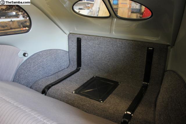

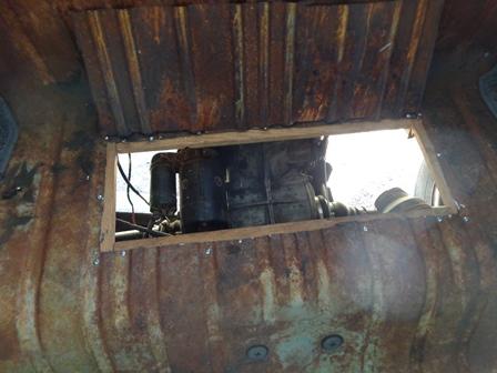

I found it best to always check and fill, the trans, with all 4 tires, on the ground - is very easy on a type 2 - cut a-hidden access for my bugs - making it super accurate and easy...
As you know, up to 6/52 VW had a rear access and with the Zwitter, eliminated it - problem (for me) was I was very accustomed to it and just continued, cutting my own - Z
split bug - stock access >
