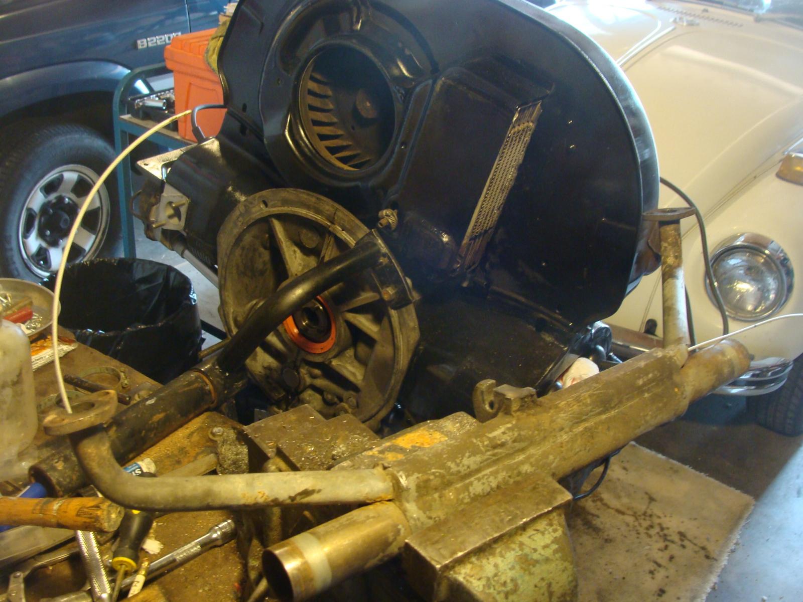

if your using the bench with a engine adapter, make sure the bench is stable and secure. unlike this...

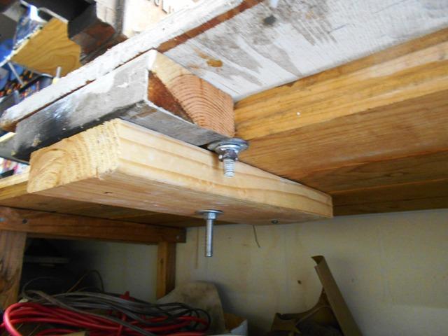

I would try to mount the vice to the top before securing the top to the legs. Use carriage bolts from the bottom and countersink them slightly so they don't foul up the legs.

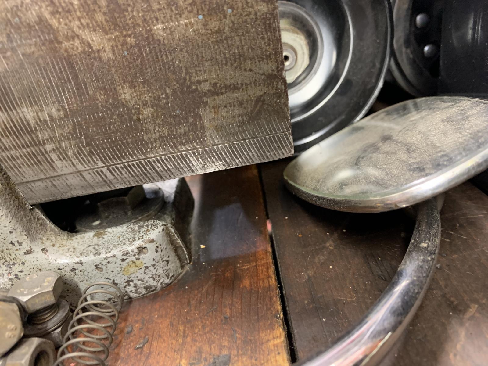

When I mounted my Columbia on the bench I used heavy stove bolts. The fixed portion of the jaw is parrallel with bench top. This allow a square or plumb area for stuff hang down.

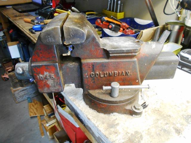

Took the time to show off mine....Columbian D 45. Was out scouting VW parts and the fellow had this sitting on the ground...asked if it was for sale, yes, picked it and a small anvil for thirty five bucks. Quite the deal.
It is mounted with the fixed jaw in parallel with the front of the bench. The bench is 2x6 sub top with 3/4 plywood on top.
