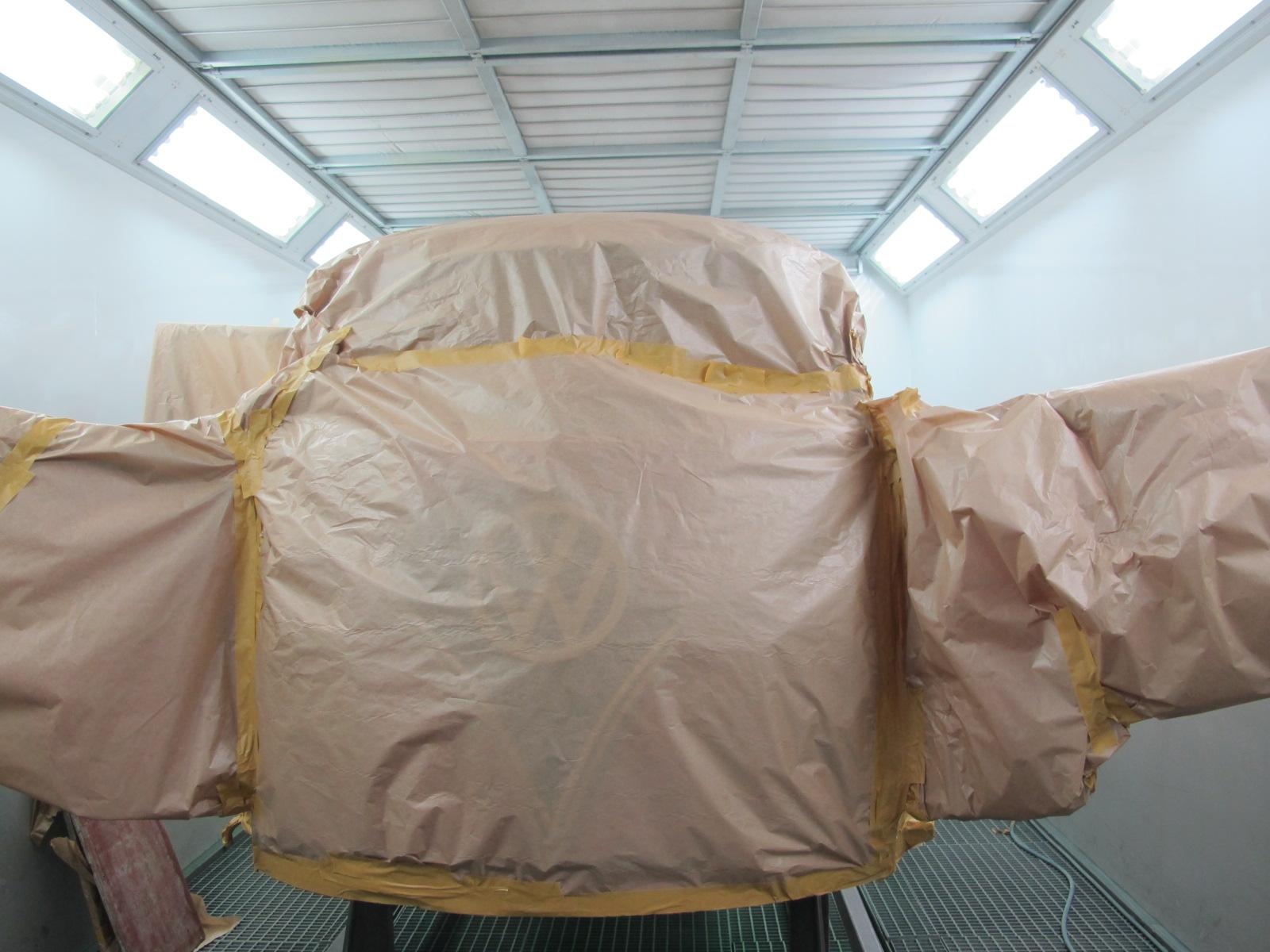

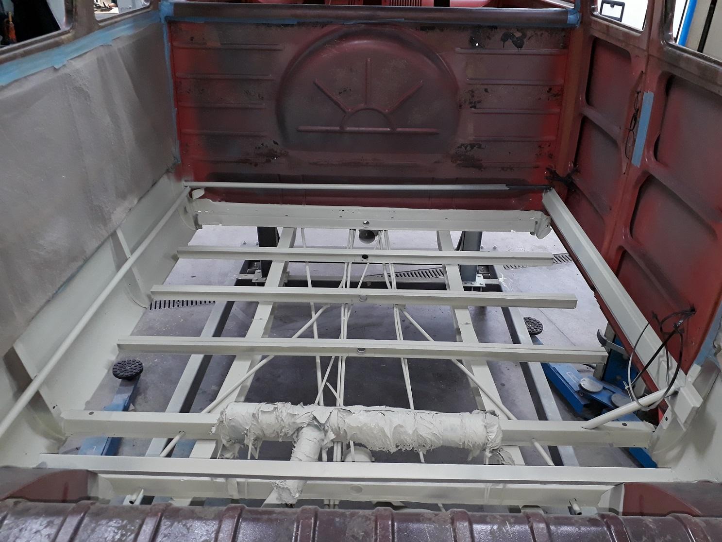

So now it’s time for good news Smile
After all the empty promises of the sandblaster, his unreliability and poor work, it was time to leave the bad thoughts behind (even if it was difficult).
The painter did a very reliable primer-paint-job which was done during one week.
He did a lot of efforts to protect the original paint ….
I was very satisfied with the result.
He found some additional non-sandblasted spots which he removed.
He controlled the thickness of the original paint at different areas and told me that the bus was obviously not re-painted in the past.
In addition, he gave me an article of a painter-magazine that deals with the neglected cavities and their poor condition.
That was the ignition to be focused later on to the cavities of my bus.
So the bus-body was transported back to the coach-builder-workshop.
The painter was so kind and borrowed me his bus including trailer. What an unique gesture! Smile
This reliable transaction and the perfect result were one of the ‘ups’ during the project-progress.

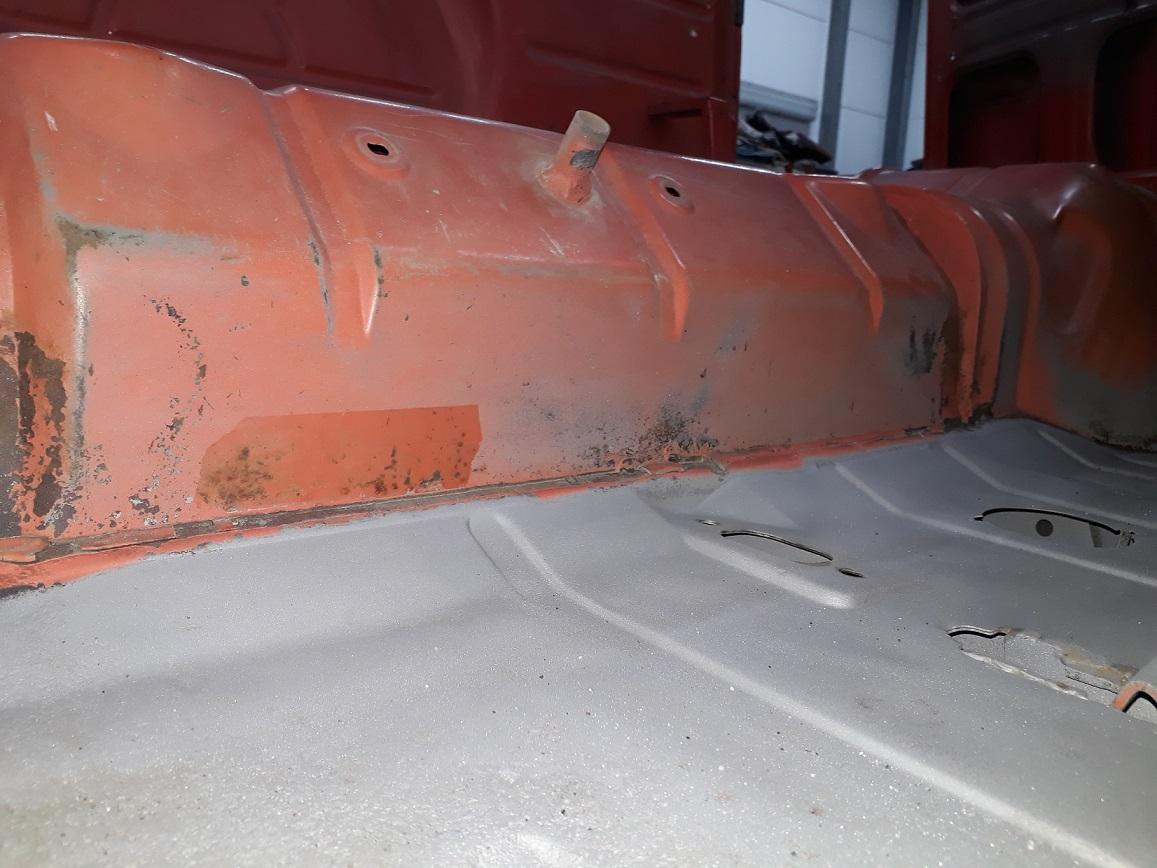

i may blast the surface rust underneath or done some owatrol on it...
your splitwindow looks perfect clean now!
What is your plan to the little rusty areas outside? owatrol? sandblast with a small blaster?
-Christian
Hello Christian,
sorry for my delayed answer. I have to confess, that your question ‘What is the plan to the little rusty areas outside?’ is in my head since the project-start.
The last pre-owner put just rust-converter-fluid onto the rust-spots and they became all black.
For me this is just a temporary solution. I’m always (very) worried about rust and I admire all the Splitbus-owner who don’t have a problem with rust and stay completely relaxed 😊
I will try to handle – for example – the rusty spots at the front-nose: Removing the rust with a Dremel and dab the primer and final-paint with a little model brush.
But if the result of the first spot looks unsightly, a new solution has to be found.
Using Owatrol was also thought but different users told me that the fluid has to be applied 1 … 2 times per year.
Maybe this is too time-consuming in future?
After all the issues I don’t want to repeat the sandblasting-process 😊
But you are in the perfect position to do the sandblasting on your own and realize your demands (in front of an amazing view to the mountains 😊).
Sure a matching solution will be found. Please let me know your experience.
Many thanks for your interest and good luck for your project!

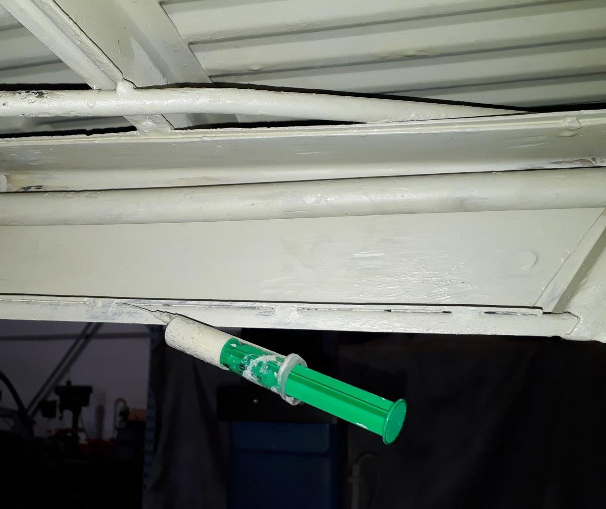

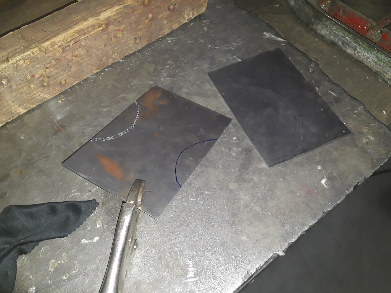

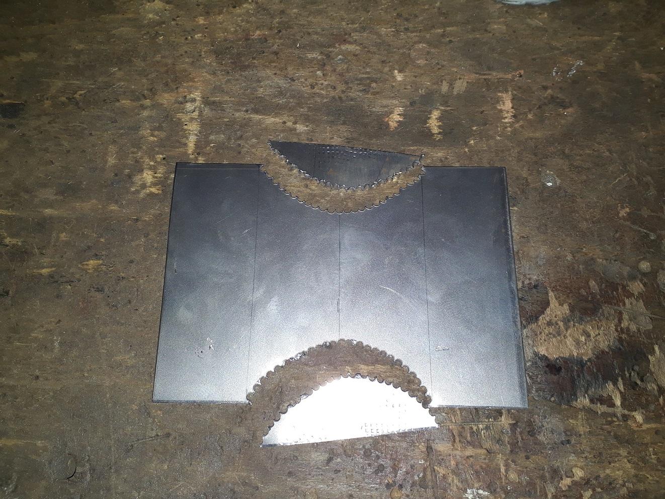

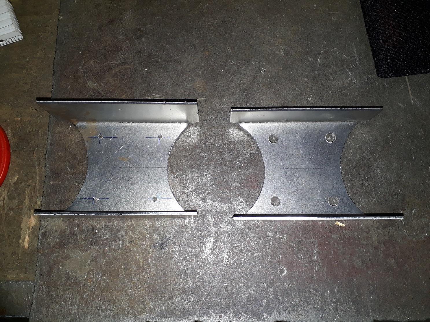

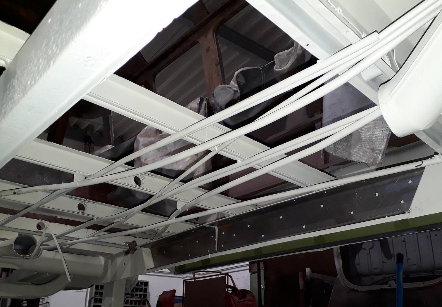

Now the bus was back at the coach-builder-workshop.
Fortunately the coach-builder offered me to be present during his work and support him.
I made numerous times use of this offer, to see how an expert works and to learn from his experiences (and to be sure that everything will be done as requested 😊 )
First of all, the 2 longitudinal-beams were in the focus.
Because of the padding-material which gathered in the past a lot of water in the double-floor and caused corrosion, the right main-frame had lost a minimal bit of his thickness in a few areas after the sandblasting.
Nothing serious. The painter and the coachbuilder told me: ‘This has no effect on the stability of the bus. Just leave it as it is.’
But I wanted to be on the safe side.
It was out of the question replacing the affected frame-section.
Such an intervention would be too excessive.
So the 2 longitudinal-beam-sections were reinforced with additional C-profiles…
And to make sure that there won’t be corrosion between these 2 layers of sheet-metal, a lot of primer was injected with a syringe …

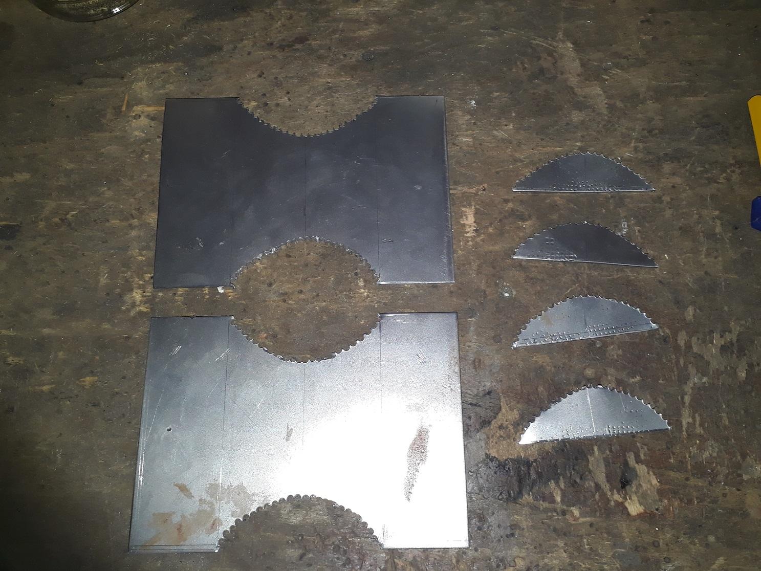

Butt-welded seams on main-frames are normally not a perfect solution.
A small improvement was welded in …
