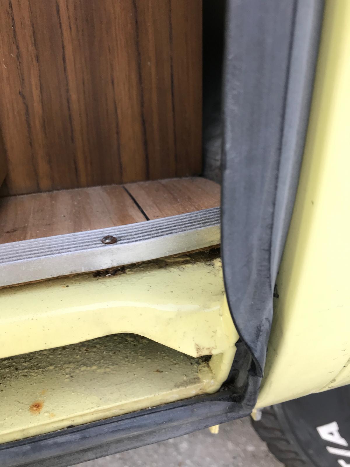

I have a 1973 Campmobile, and my problem is that the door needs extra oomph at the very end of closing, by pushing "in" with your left hand placed on the left side of the door, while sliding the door it forward with your right hand at the handle.
It opens easily, and rides on the track effortlessly. If I use the left hand method, it closes ok most of the time. If I don't, it closes but it is not flush, which is best seen on the left side.
I think it may be this piece of weatherstripping at the bottom, that gets caught in the seam.
The test would be to cut it out (?) or someway reposition it (it is glued in very well). And if I am wrong, then I have messed up that seal, although it is not right anyway.
Any suggestions?
steve
SBL74
Joined: November 25, 2013
Posts: 125
Location: Treasure Island, FL
SBL74 is offline
PostPosted: Sun Jan 21, 2018 6:35 pm    Post subject: Re: Sliding Door Hinge Assy Refresh FAQ - closing Reply with quote
Well, I taped that weatherstripping back, and it is well interior now, and the door still behaves as described. Basically the front of the door goes in, but about 1/2 inch of the back (left as you look at it) does not unless you use the technique and more muscle that I think should be necessary. Is this an alignment issue?
busdaddy
Joined: February 12, 2004
Posts: 52811
busdaddy is offline
PostPosted: Sun Jan 21, 2018 6:41 pm    Post subject: Re: Sliding Door Hinge Assy Refresh FAQ Reply with quote
That seal definitely has some issues and likely isn't helping with the final latching of the rear striker. But in case you aren't aware a 73 slider requires you to turn the handle fully upwards (back on the inside) until it clicks to draw in and latch the rear of the door, even if it has the correct seal.
Sometimes on a summer day when the seals are really soft and all the windows are open you can get the rear to latch with just a good slam, but in most cases it needs a handle turn to finish the job.

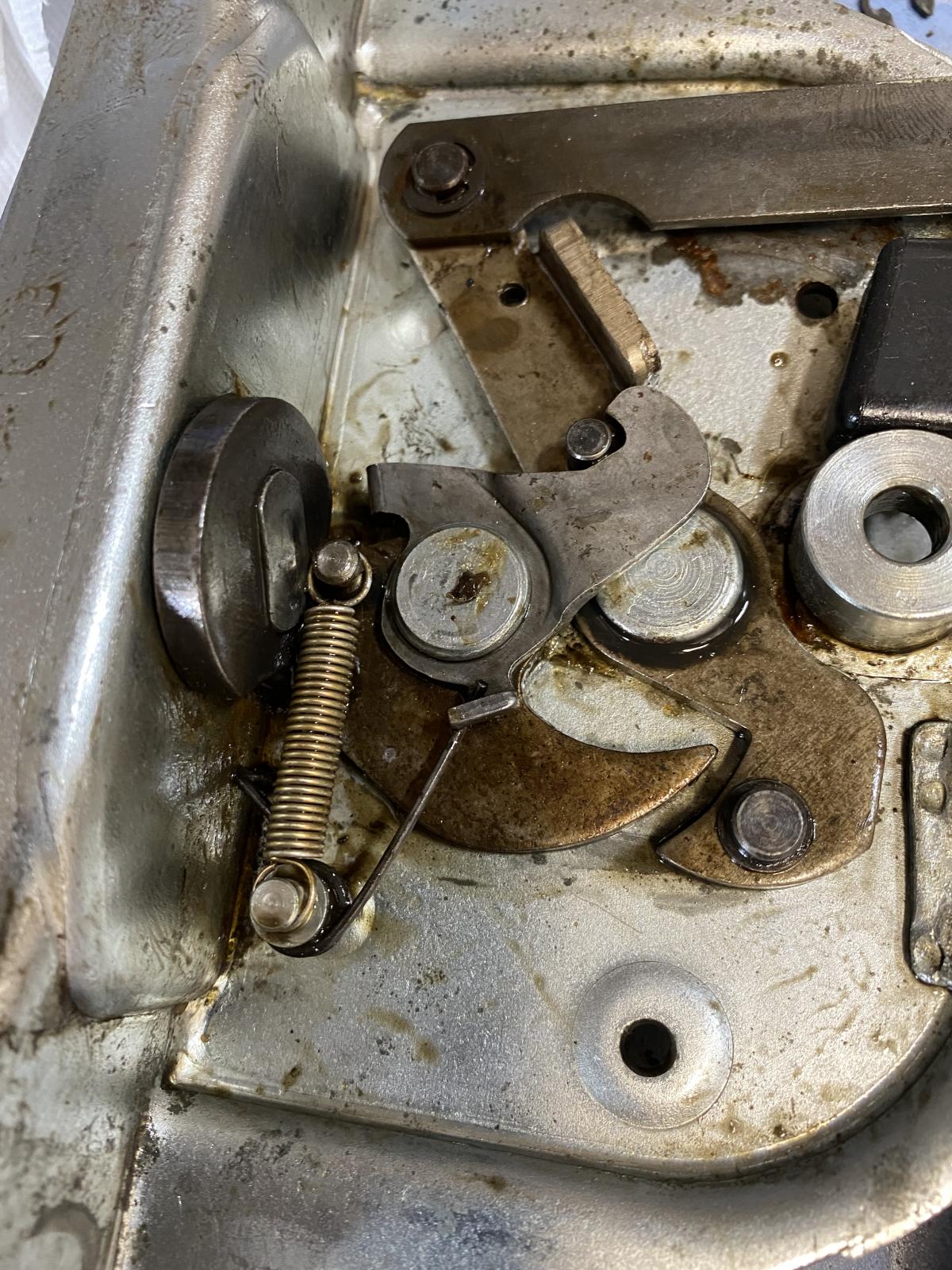

I have recently serviced the whole of my sliding door assembly, thanks to this amazing thread, along with Colin’s roller assembly thread:
Roller refresh thread
I was nervous taking the project on, but it turned out to be fairly straightforward. I’ll post up a few pictures of the component assemblies you end up dealing with as it might help people orientate themselves.
First off, the rear latch mechanism and the forward door lock. The springs on the latch can be released to help with cleaning, but the lock doesn’t come apart:

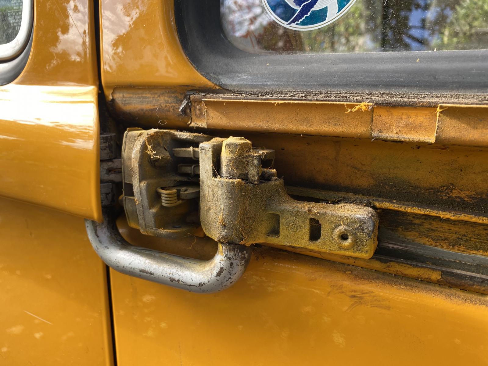

This is the latch from the outside, and the hinge assembly from the outside, before removal:
