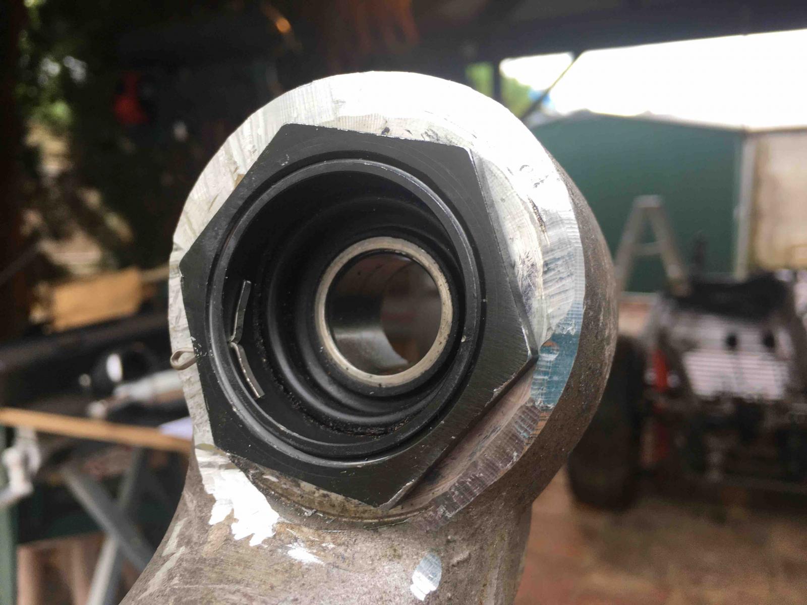

Dorigtt, those are weather sealed monoballs from Elephant racing:
https://www.elephantracing.com/944/weather-sealed-monoballs-for-944/trailing-arm-monoball-cartridge/
the bit that is red in the picture slides out and I took about 8mm off that so the arm would offset the max towards the centre of the car.
here's pic of the uniball without the red sleeves:
I also had to turn down the VW pivot bolt to fit:
normally the washers are on the inside on a VW trailing arm, both are now smaller and on the outside

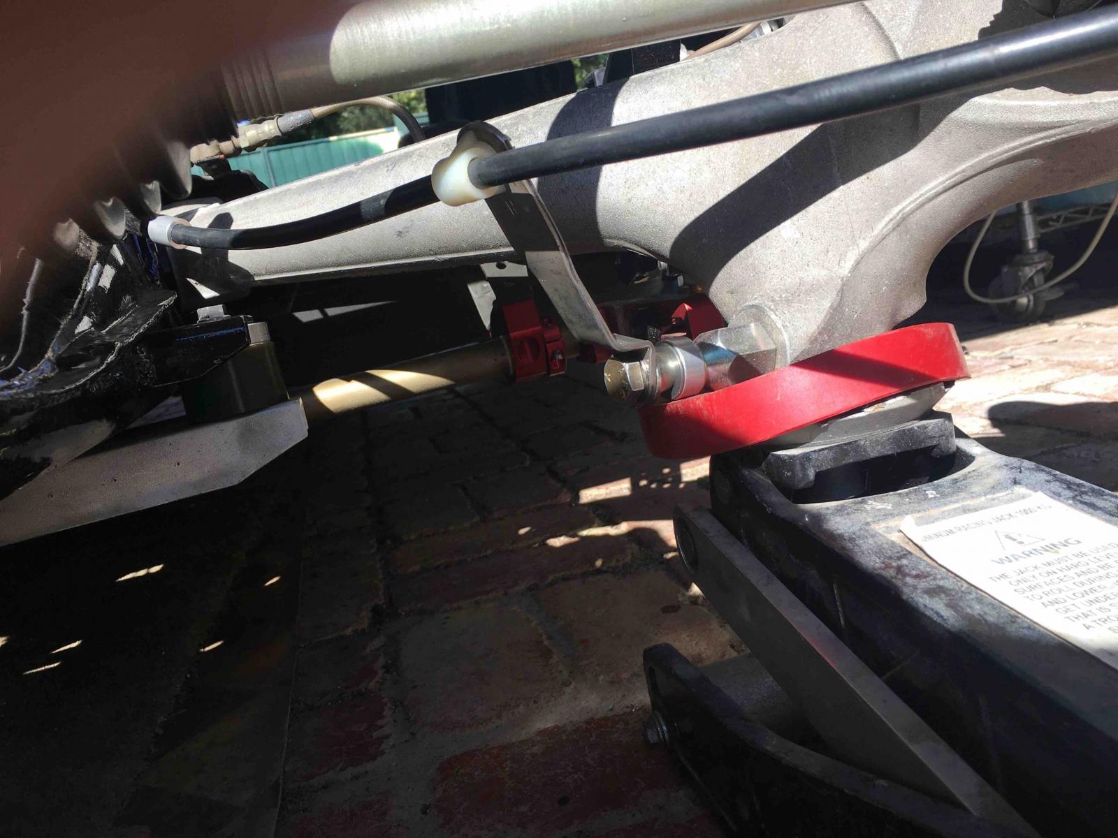

the next little step, I finished the hand brake.
to recap, the calipers and cables are from Rally Design in the UK
http://www.rallydesign.co.uk/product_info.php?products_id=11370
then I got some swage ends in 6mm, same as VW, and some cheap press dies off Ebay and swaged them on.
finished cables
and made up some brackets that attach to the lower shock mount to hold them at a suitable angle
and it all works....

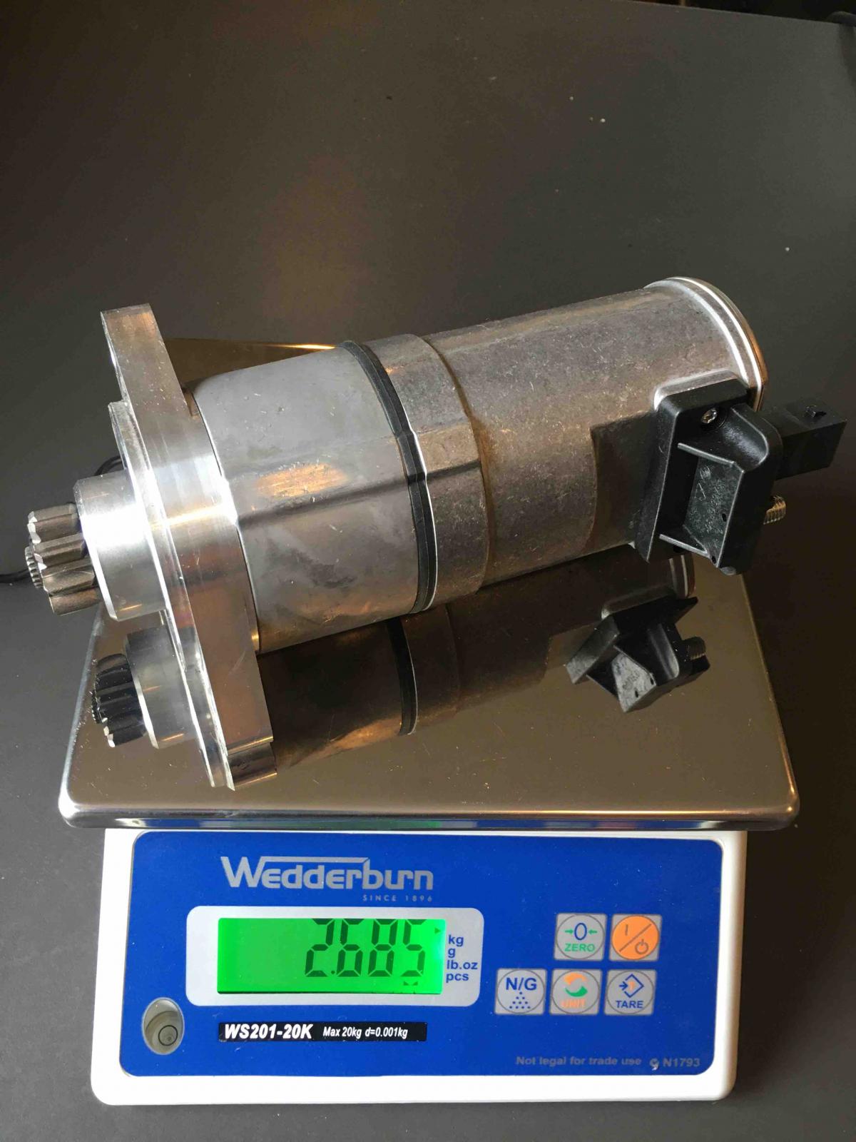

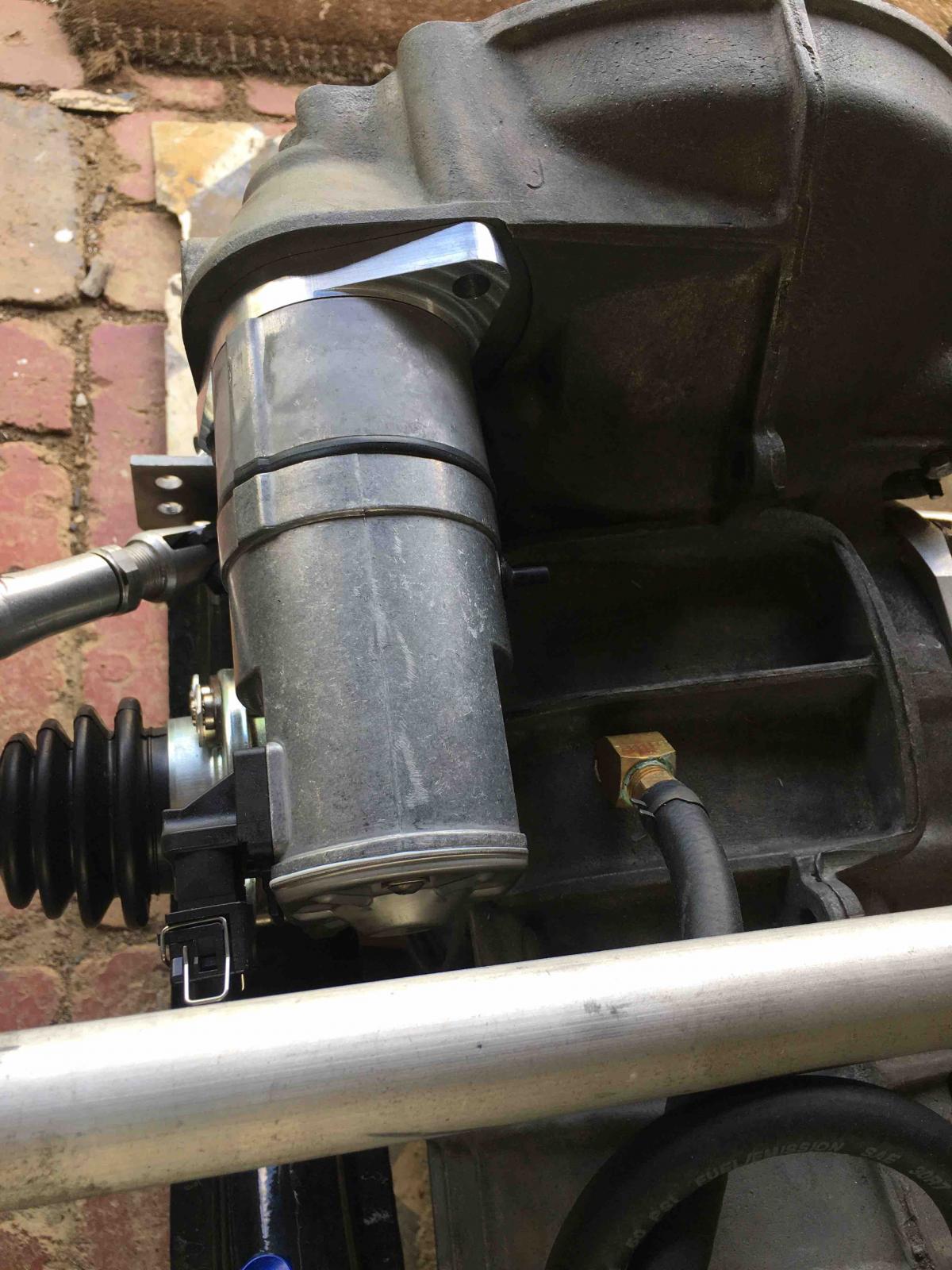

not much visible progress recently, I've been pulling down my motor and measuring a lot for the rebuild. I did do some more work on the carbies and made a bracket for the Throttle Position Sensor from a kit made for 50DCO's
I also got my new starter from Brise, less than 1/2 the weight of a SR17 or 15

Ian, the mass difference of the starters is amazing. Are those starters having any disadvantages for street use?
What is this second gear on the starter for???
Do you have a correct part number for the Type1 handy?

Lars, thanks for the comments, the 'second gear' is the reflection in the top of the scales Laughing
no down side that i can see other than cost Crying or Very sad
I'll check the part number for you.

PostPosted: Sun Oct 31, 2021 5:12 pm    Post subject: Re: 69 road race Ghia rebuild Reply with quote
the Brise starter is part number:
763509AXGAC
it also fits some early porsche 911
