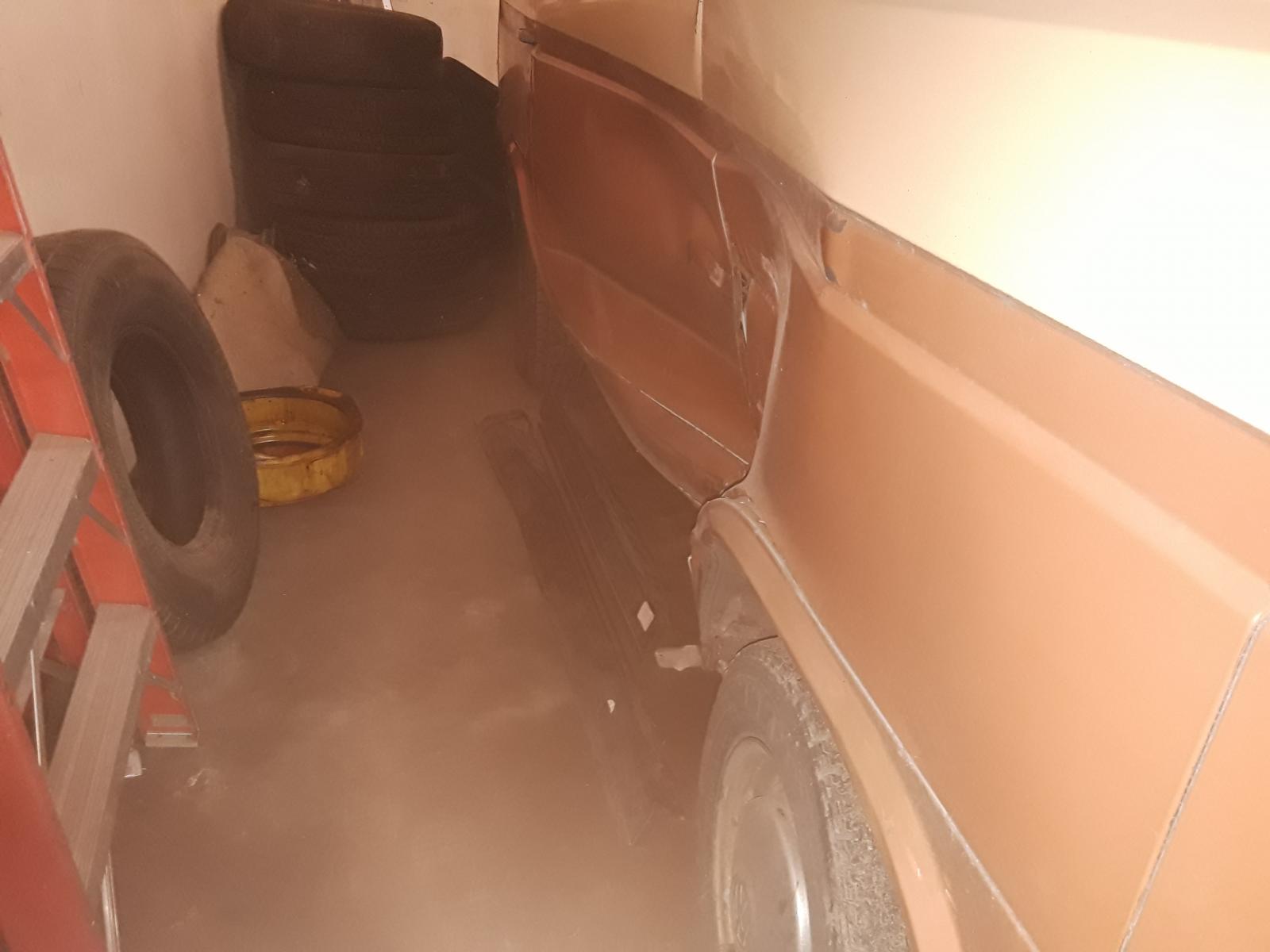

Would not be all that hard to make that side straight again. I'd use a Spitznagel Dentfix. It just spot welds the end on, then a slide hammer to pull back the dent a little. Just gotta work it out- last in, first out. Kinda like an old time slide hammer puller, but no holes to fill.
Badly inked areas like the panel flanges you'll have to get behind them with a sharp tool and reform the factory bends.
I've got a 1983 Vanagon 50k mile original paint car that some young woman tried to drive thru me while I was stopped on the road.
I'll try to save some of the original paint.
I've got some experience pulling collision damage, but right now I'll have to make do with improvised equipment.
That's a brand new genuine VW inner and outer rocker laying on the floor, if I need them. I hope I don't.
