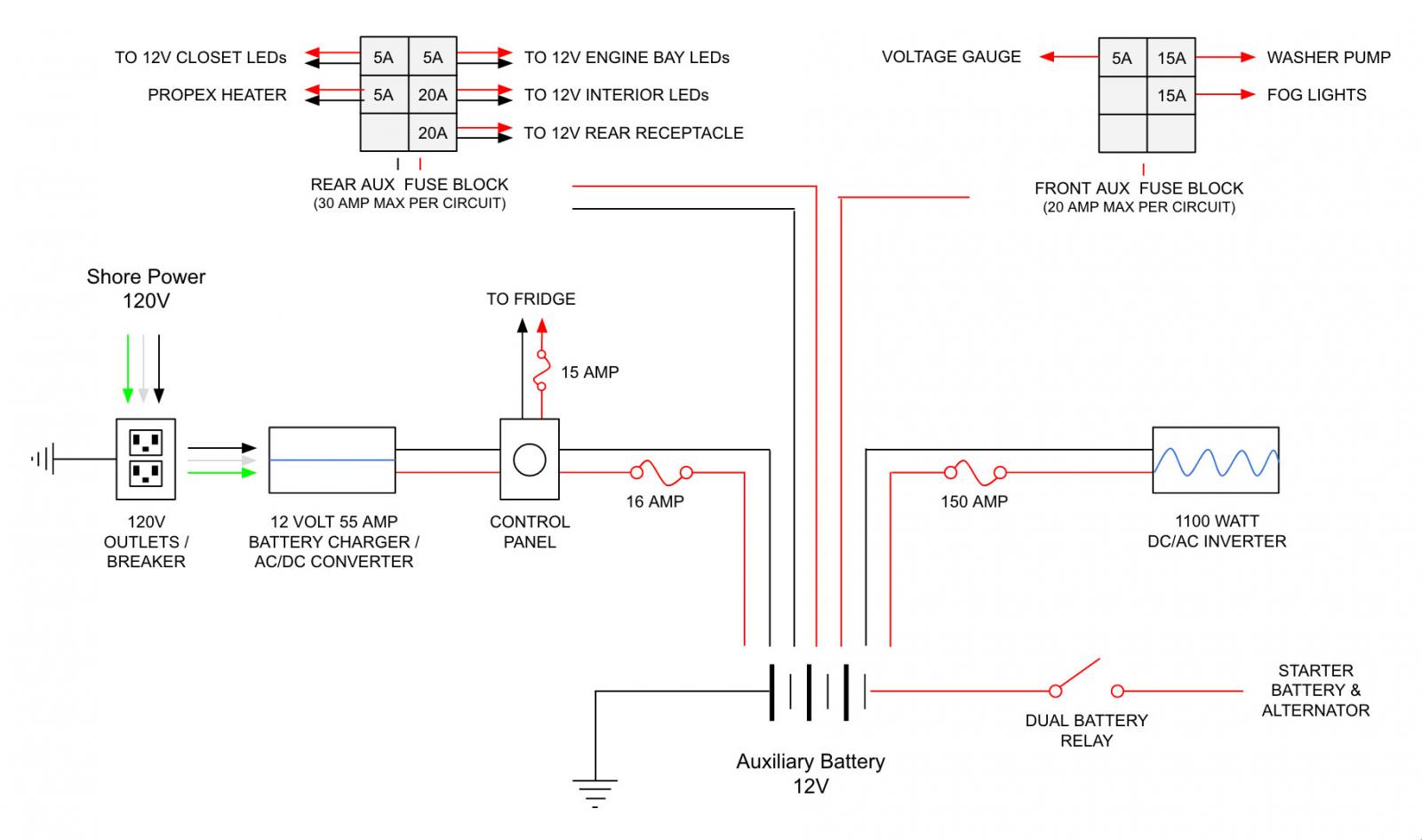

This may help. I have a Westy, but this could apply to your situation.
I use the Cytrix-ct 120amp smart battery combiner ($55 on amazon) and a 120amp 12V circuit breaker. This setup combines the batteries when either one is being "charged". Starter battery getting charge from alternator, or auxiliary battery getting charge from shore power. I also added a momentary button that will manual combine the batteries in the case of the starter battery dying, this will allow you to start off your auxiliary battery.
Cream Puff
'79 CA Stock FI Deluxe Campmobile

xfrench wrote:
Thank you. Is that little red button the temp switch? Do you have to keep your finger on it for it to combine both batteries? and is the control panel simply and on/off knob for the fridge? I appreciate the clarity of your setup.
The Cytrix-ct has an input terminal 85 or 86 I forget. When it gets triggered it combines the batteries for 30 seconds, so the momentary switch just needs to be pressed and released, then you go start the bus.
Control panel is oversimplified in my drawing, it refers to the stock control panel in the Westy. It controls the fridge, converter, auxiliary battery and shore power. The one shown in this guy's video https://www.youtube.com/watch?v=X2SlQofJY50

PostPosted: Fri Feb 12, 2016 10:17 am    Post subject: Re: Adding a second battery..how to...with photos Reply with quote
Got it. Will have to cobble together a control panel to suit my own setup. Now, off to jump down the youtube rabbit hole... Thanks again.
