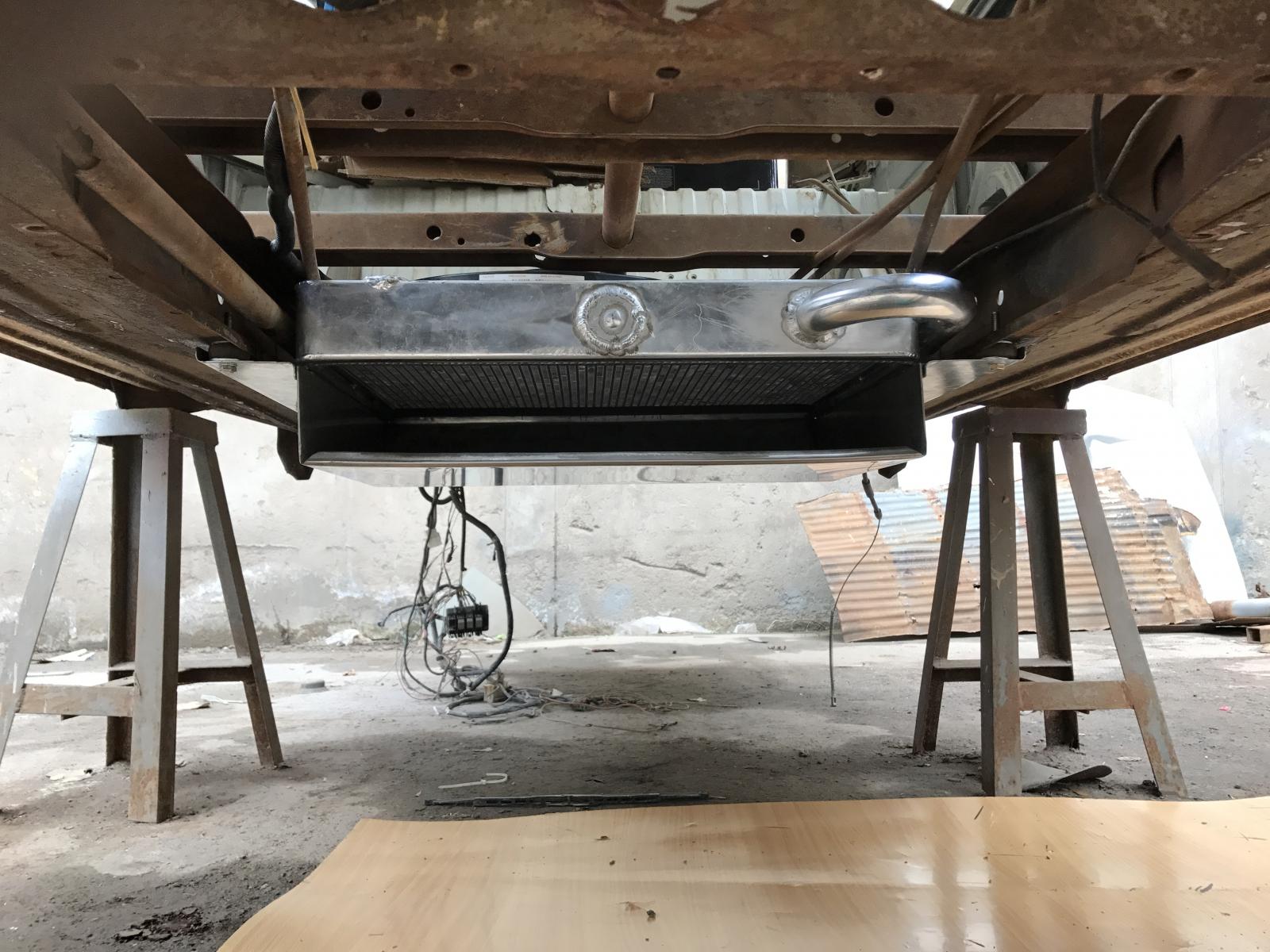

Thought I'd keep posting in this thread as it seamed the most informative. I've got my new rad installed ( 19 x 27 double pass) and I have 2 x 10" fans on the top and pulling (for now) until someone tells me differently. What I'm looking for is a way to better my set up as in try to box it in for air flow etc.
I can't add a scoop as it's pretty low and I'd just be scooping up everything.
These are pics of the front of the rad looking rear.
Pics for reference:
My '65-Subaru EJ20 Turbo conversion
