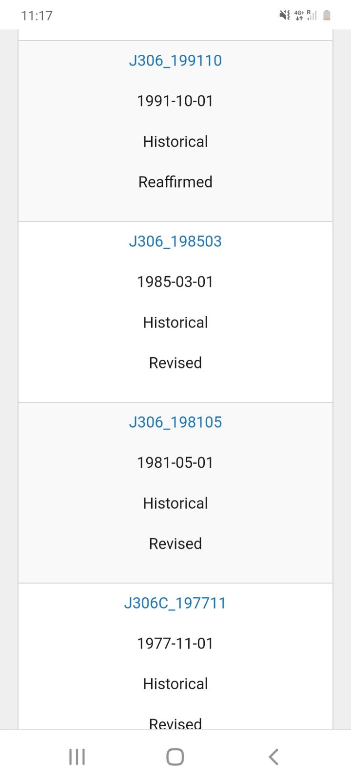

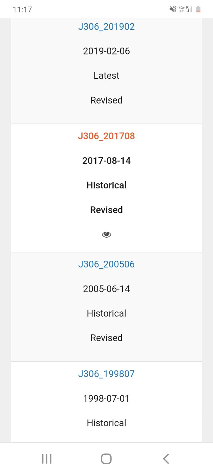

Also to be noted the SAE J306 rating for gearbox oils has been modified 7 times since 1977 and quite often the oil has been thinned out ever time. The lowest viscosity for a modern marketed as a 80W90 category is almost half (13mm2@100°C) of what the highest viscosity was when the beetle came out of the same category oil (24mm@100°C). So I look for an oil close to the maximum 24mm2@100°C for the marketed category of oil which my also be found in a modern 75W140 marketing category of oil.
