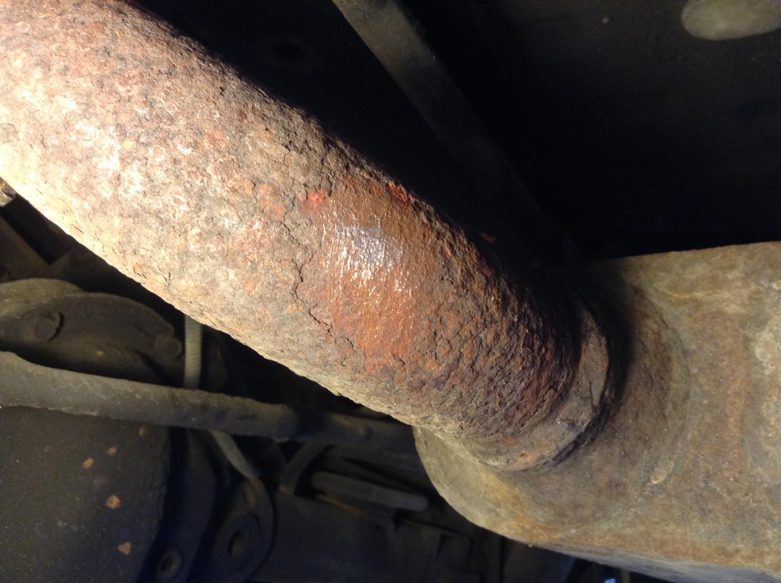

Here is the exhaust initialy...
pedrokrusher wrote:
Its sunday, not everyone has had the chance to read thesamba, so for sure other people will shim in tomorrow, monday. Patience my friends... Patience...
Well in the mean time, i decided to test this myself! I went to the grocecy store and bought peanut oil, and transfered the oil in a used peanut butter plastic jar for ease of use with a brush...
I cannot test this on one of my vanagons since they are in storage for winter, i decided to use it on my one off oversees special edition volkswagen rubicon edition... (Shhhhh..... Please dont say anything to the moderators or they will eliminate the pics since its actually my 2009 jeep wrangler rubicon)

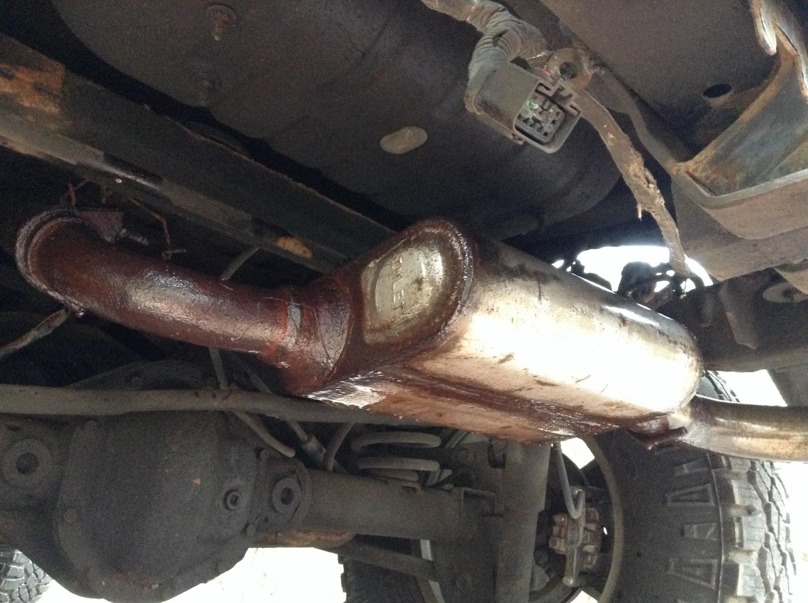

At this point i applied the peanut oil on half of the muffler to show the difference between the dry area and the applied peanut oil. Here you can see a very used, at the end of its usefull life old aftermarket cheesy exhaust muffler. I had to flake off the layers of rust before application... Shocked wow thank you previous owner... The rest of the original exhaust system is actually very good.
All exhaust system had a generous application of peanut oil... The junction on the left of the pic is what separates the original exhaust system from the aftermarket muffler.
Went for a half hour drive and the first 15 minutes the smell was overwelming when you stopped. I stopped and checked, the oil was burned off close to the engine, and the metal looked darker. The muffler was still with a wet appearence, but less. Obviously it is not as hot at the end of the exhaust system. It got too dark for pictures. Tomorrow i will post pics... What i can say now is that its much less wet to the touch, and less smelly too. It needs a couple more drives...
Thats it for now!
(Edit: please mods, keep the pics! We don't have much going on so far... I promise i will find a VW to coat it...)

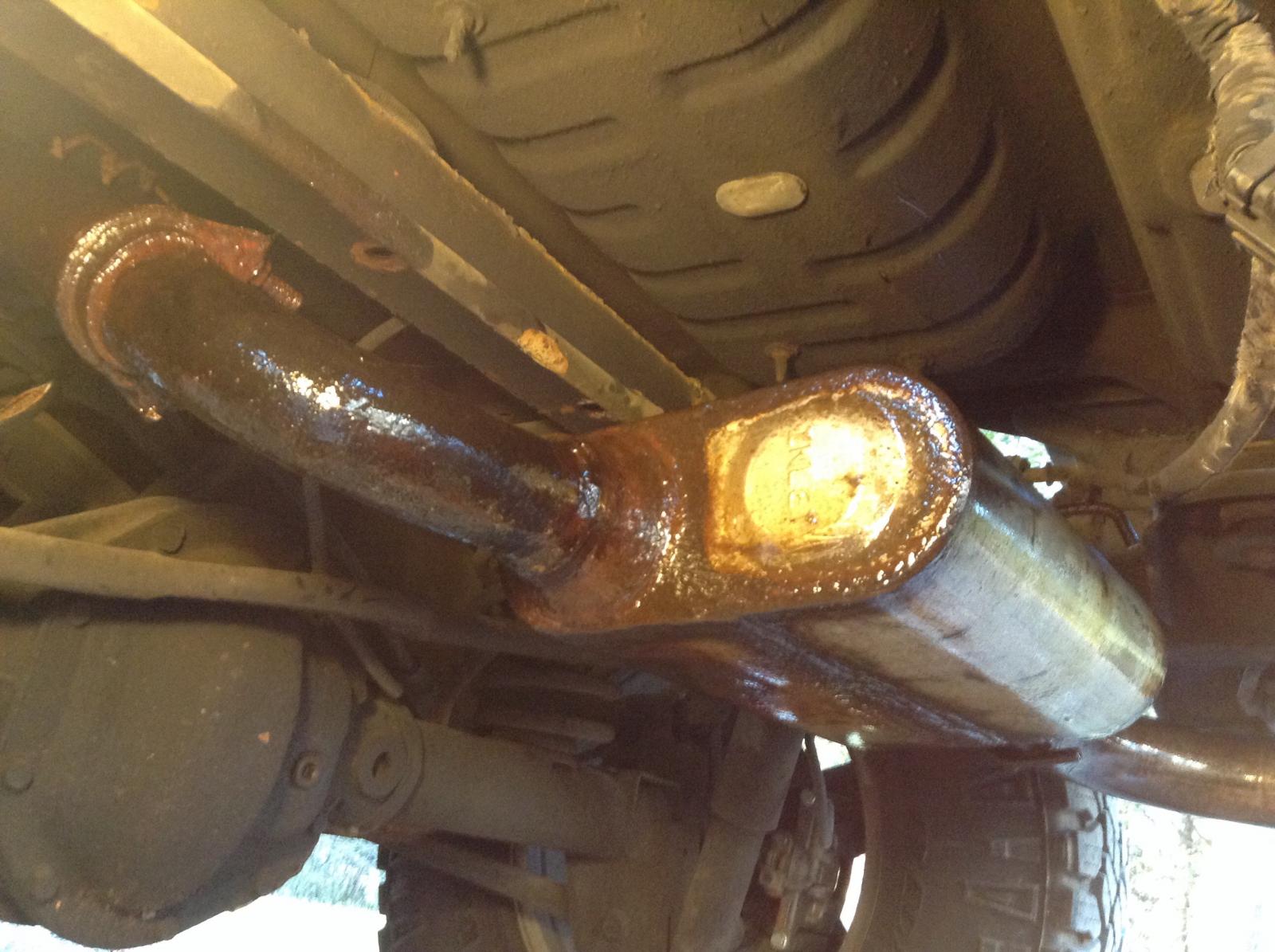

Here it is after the third coat...
pedrokrusher wrote:
So i drove once yesterday, then this morning going to work, then driving back home. This how it looks like for the second coating of peanut oil.
Now applying the 3rd coat.
And after a half hour drive.

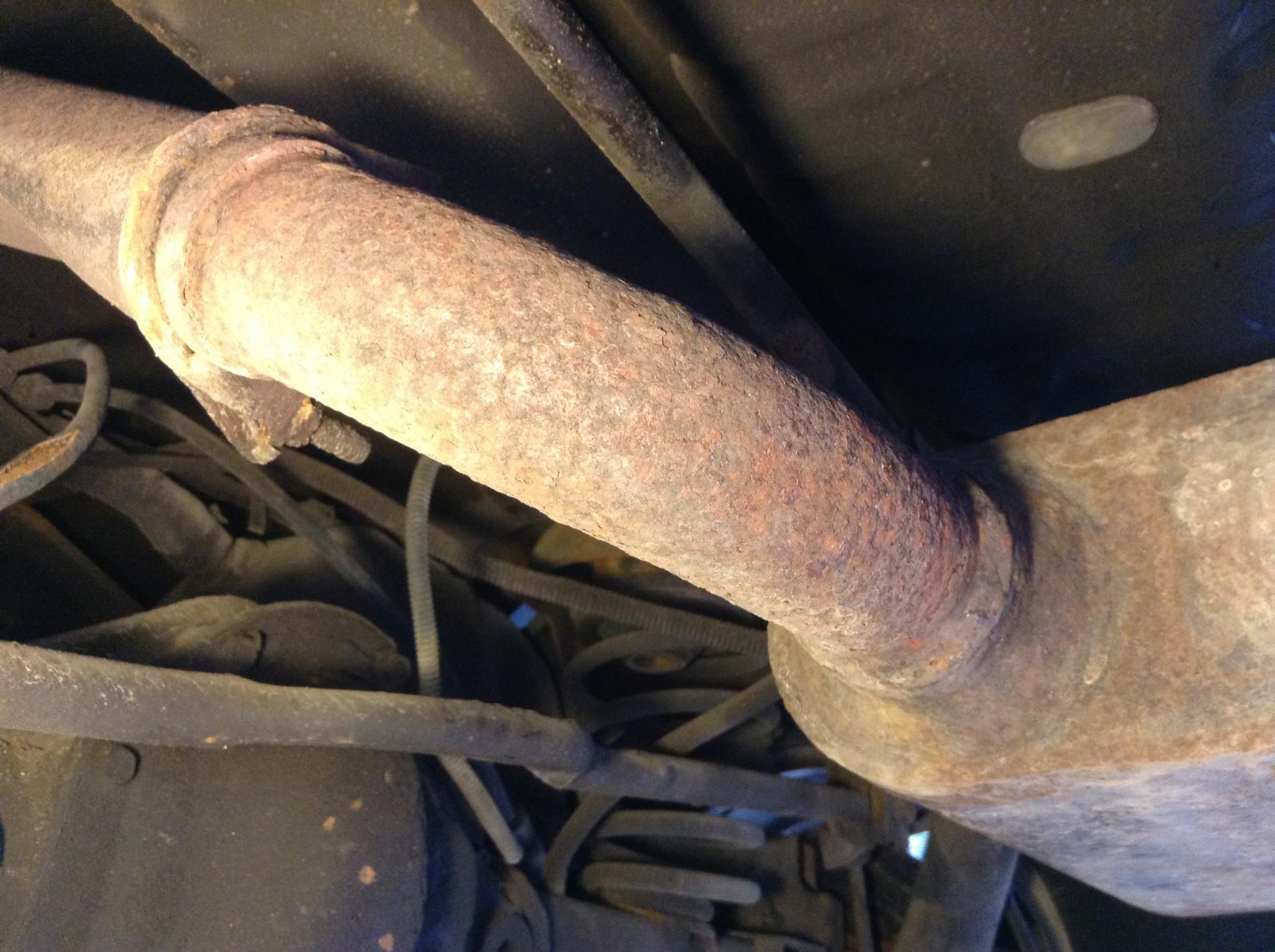

Here it is now after all winter on salt roads.
I scrapped it with a wire brush.
It seemed it helped me go tru another winter salted roads with this pretty old rusty exhaust. Not much more...
Some small flakes are coming out of the bent tube, loosing some more metal.
The exhaust itself is not too bad.
The other original pipes seems better than the aftermarket exhaust.
An exhaust shop had told me, before the oil treament, that it would not go tru a winter salted road. I guess it did!
It is what it is! Experiment done!
What do you guys think?
Whats the news with everyone elses experiment?
