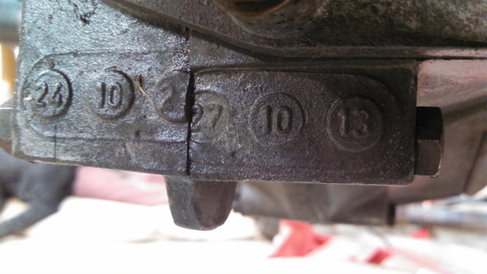

PostPosted: Mon Mar 26, 2018 11:37 pm    Post subject: Re: Splitcase Gearbox help... Reply with quote
Hi.
I wounder about that Gearbox, is it a Splitbeatle or a Barndoor?
The former Owner build it out from a late Barndoor..
i couldn`t find any a Number like 2A....
Any Idea about that??

PostPosted: Tue Mar 27, 2018 12:52 pm    Post subject: Re: Splitcase Gearbox help... Reply with quote
Does it have reduction gear boxes on the axles, Christian ?
if the tri rib '29#' shift cover with the low shift rod input is original to the gear case it means that it is a 1953 to 1955 synchromesh ( except first gear) genuine Barndoor unit.
also this front (nose) cover will not fit on an early (non synchro) split bug without heavy modifications. so chances are good that the whole transmission is late BD. oil filler plug says so as well.
the date code 7 6 25 makes it a June 7th of 2nd workshift 1955. which of course is not a Barndoor anymore. but its still an early Wolfsburg ( post BD) date, and these 1955 buses still had the old axle and transmission cradle like a BD.
so most probably this transmission is a straight fit for your 54BD, but originally came in a very early non BD 1955 Wolfsburg bus.

PostPosted: Tue Mar 27, 2018 10:28 pm    Post subject: Re: Splitcase Gearbox help... Reply with quote
Thank you!
The reduction boxes were sadly cut off.
i am confused about the 29. Number?
Anyone know if and where the Wolfsburg bus Gearboxes have the Numbers?
is there a other way that i can check whats is inside this suprise box? Laughing
-Christian

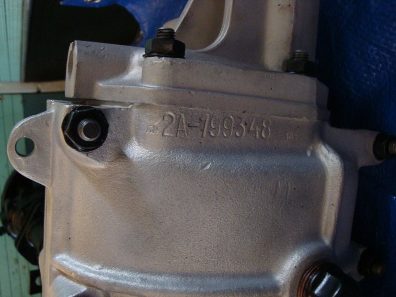

On my split box casing it has the following stamps , 111.301.101A with the VW logo. Any idea which year this gearbox is from ? Thanks
Posts: 71324
PostPosted: Tue Jan 26, 2021 6:11 pm    Post subject: Re: Splitcase Gearbox help... Reply with quote
This is the part # of the casing.
Looks for a "2A-" serial number on the side, either near the nose cone or on a raised area a little behind the nose cone but on the side.

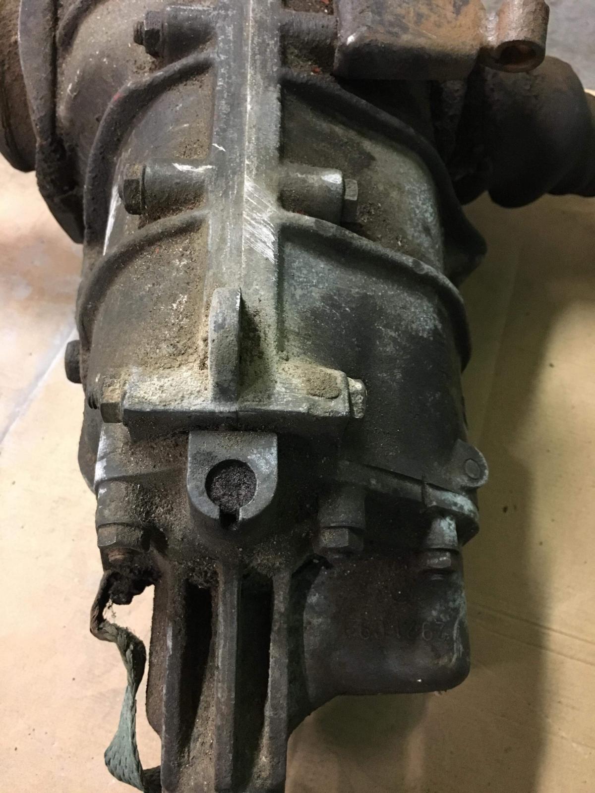

PostPosted: Thu Jan 28, 2021 4:41 am    Post subject: Re: Splitcase Gearbox help... Reply with quote
Is the 2A stamping on the nose cone or on the gearbox casing ? I have found the following stamps on the nose cone 21.09.2 , I assume this is a part number, thanks

PostPosted: Thu Jan 28, 2021 6:22 am    Post subject: Re: Splitcase Gearbox help... Reply with quote
the 21.*** is the cast part number on the nose cone.
you want to look for a stamped number on the case behind the nose cone .

Posts: 71324
PostPosted: Thu Jan 28, 2021 11:18 am    Post subject: Re: Splitcase Gearbox help... Reply with quote
On the side of the casing.
Maybe this is a better pic, also from page 1 of this thread:
Nosecone at the top of the photo above

PostPosted: Wed Mar 19, 2025 11:53 am    Post subject: Re: Splitcase Gearbox help... Reply with quote
hi i have a gears box BD (for sale )number 2A-3822207 someone could confirm me its january 1955 please?
many thanks
View user's profile Send private message MSN Messenger Facebook Gallery Classifieds Feedback
Posts: 71324
PostPosted: Wed Mar 19, 2025 4:31 pm    Post subject: Re: Splitcase Gearbox help... Reply with quote
many thanks
On the VIN charts on the site, the last transmission # for 12/1954 is:
2A-380 323
So I think your transmission is from 1/1955 if it has 1 less digit, maybe its:
2A-382 207

Posts: 71324
PostPosted: Thu Mar 20, 2025 11:36 am    Post subject: Re: Splitcase Gearbox help... Reply with quote
Ok, so it's 2A-382 207
What I stated above should be correct
