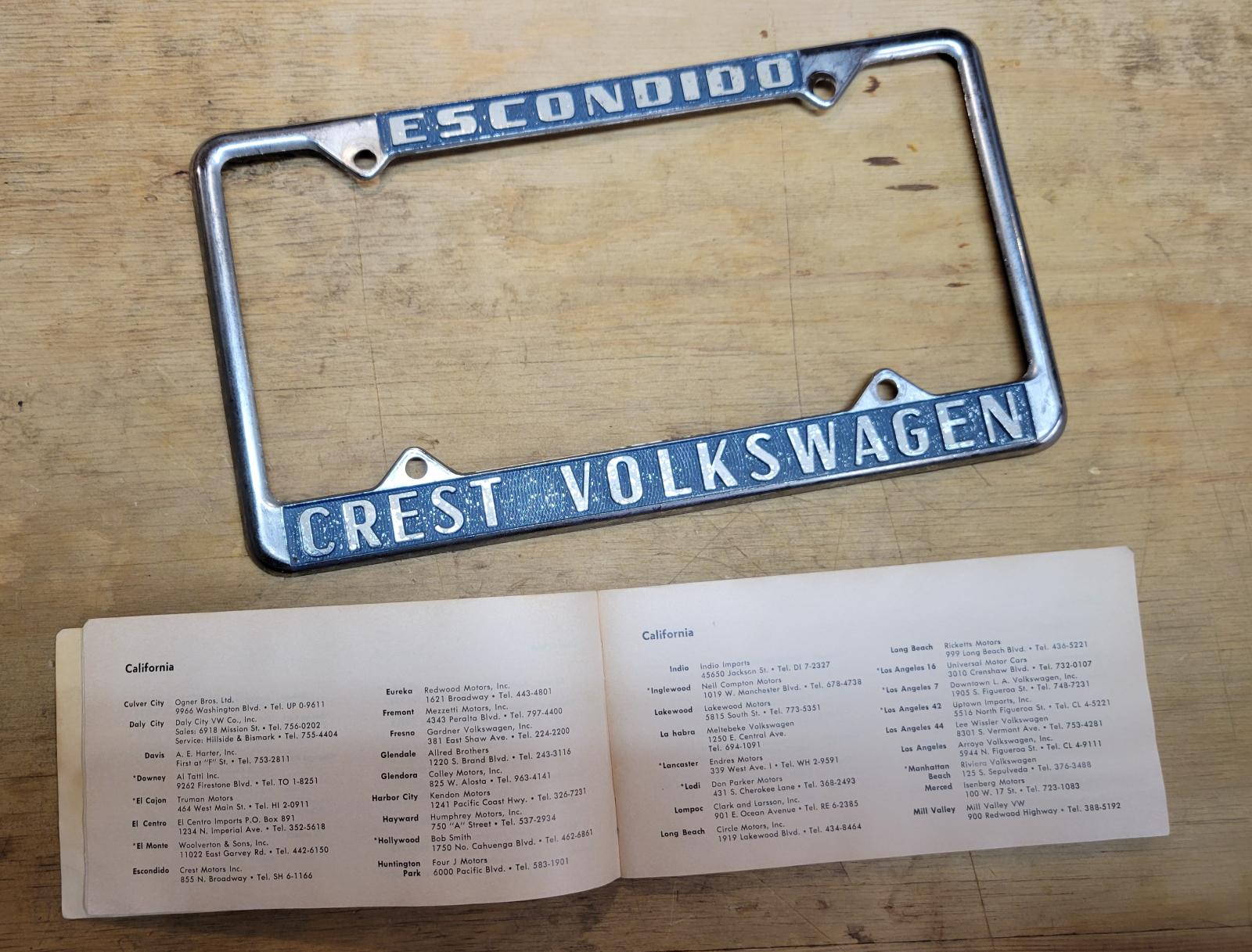

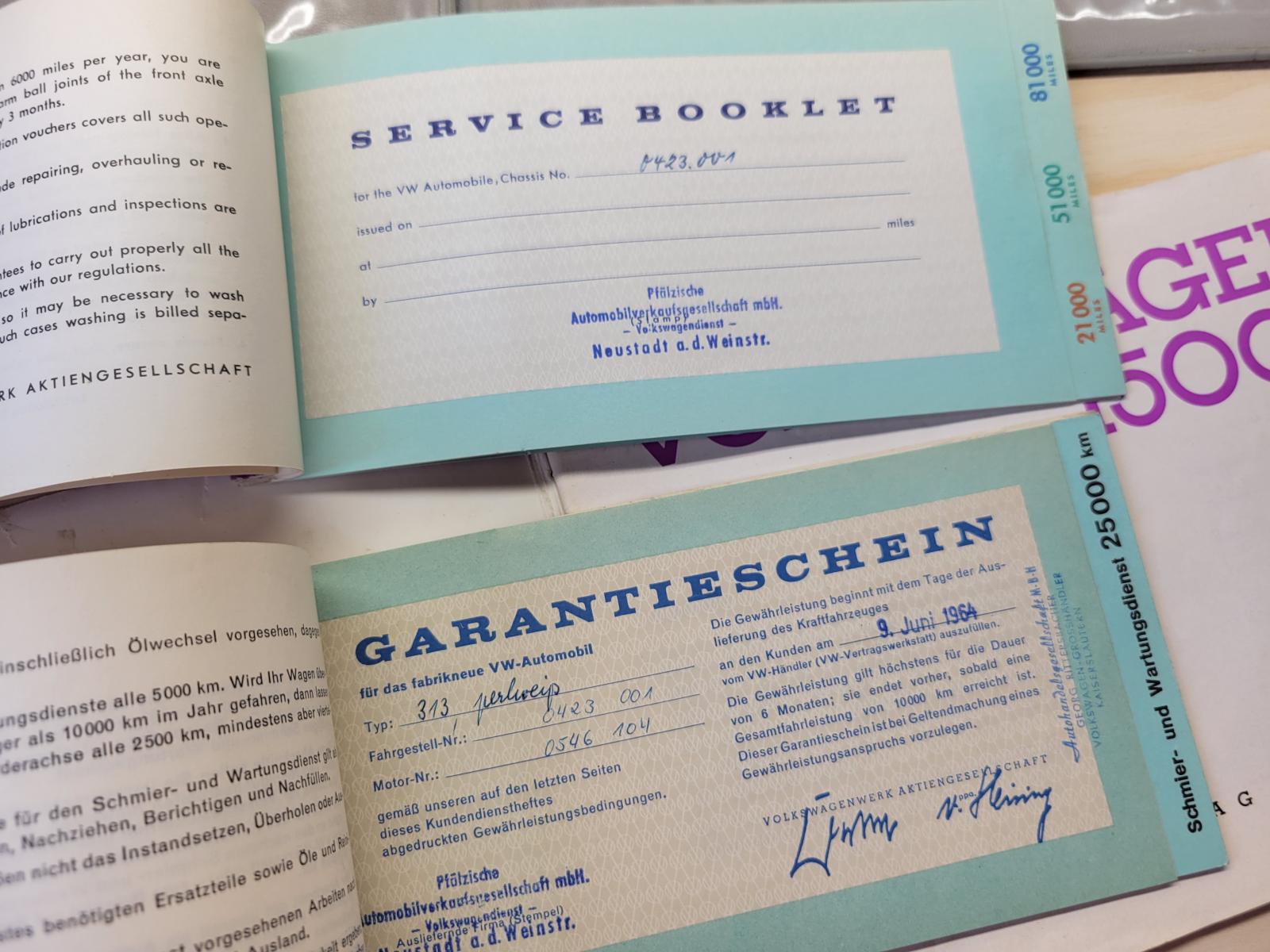

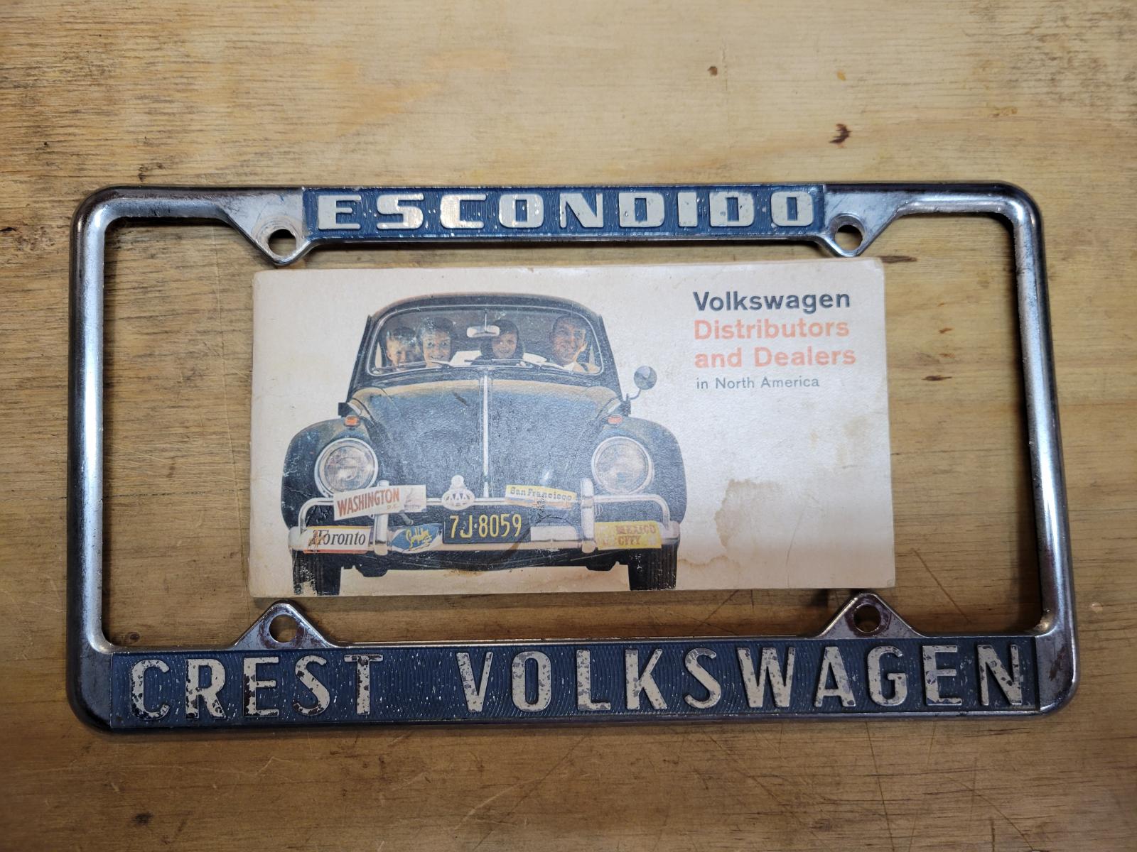

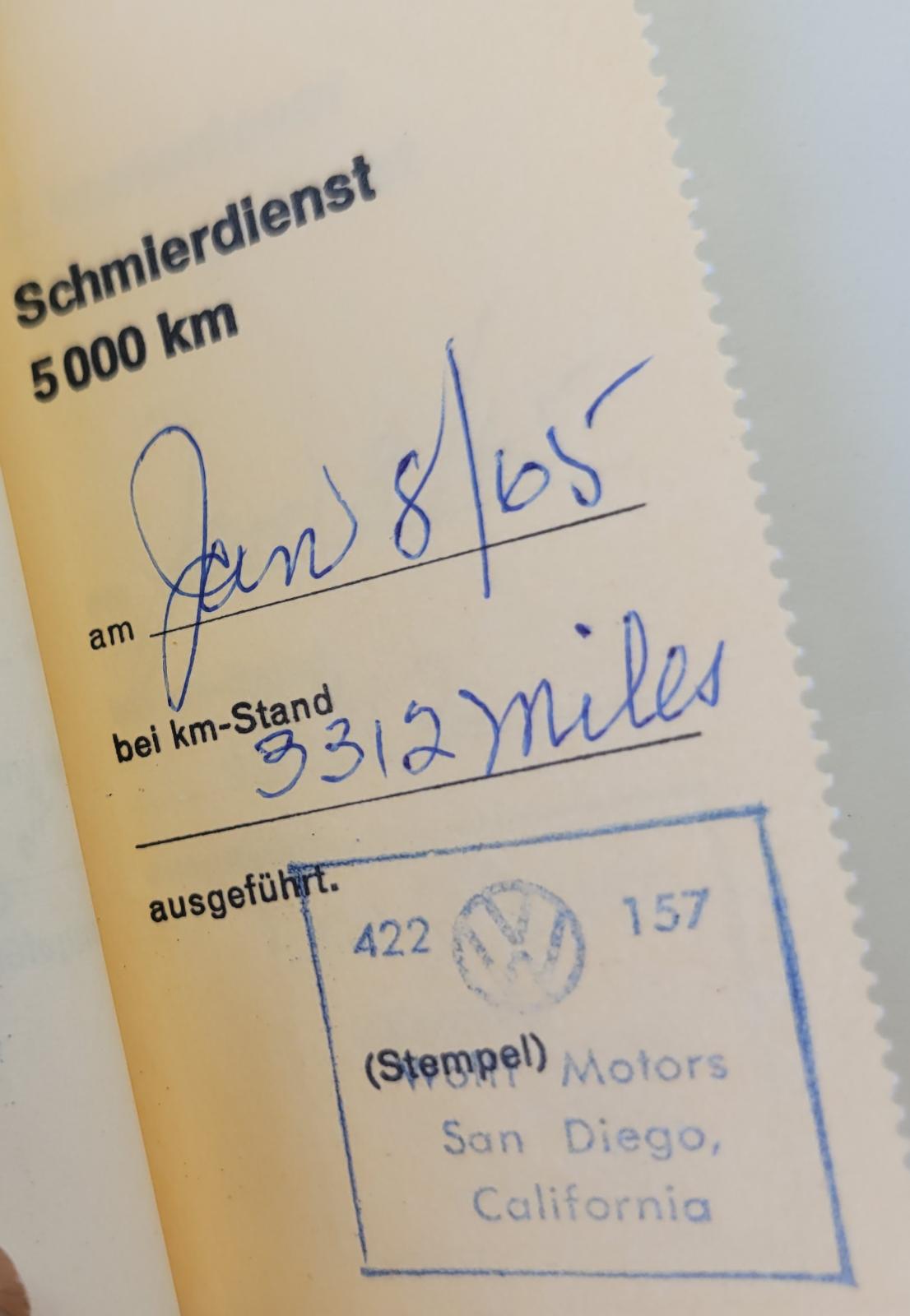

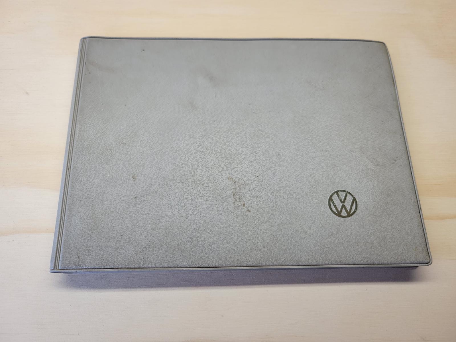

Well the old 15OO thread doesn't get used all that much these days. What with FB and lack of overall enthusiasm like the old days Wink Laughing But every once in awhile interest peaks and folks start going on about Type 3 Restoration correctness. Always nice to see restoration and preservation still moving forward for the unique little VWs.
A couple of neat to me, hopefully to you as well finds. About a week ago, I bought an old metal cabinet in El Cajon for a bench project I was wanting to do. Once I was onsite and chatting it up with Carlos, the fella with the cabinet, we discussed other items that may be for sale. Well he had a past interest in old VWs and pulled out some lit to look over. In it was an old owners manual for a 1964 notchback. It had the old manual and the two service booklets that got punched on the service intervals. A US Dealer and Service book was also in the bunch. First service trip was to the dealer in Germany where the car originated. After that was trips to Wolff Motors here in San Diego. Very interesting to see this history. Its fun to speculate if this notch was a Tourister purchase, private buy or even a service member. No way to tell with just the tickets punched. The original owners San Diego address is there and the home still stands. Very cool bread crumbs left behind for a car that most likely is long gone.
I then got to browsing the US Service site book. Id seen it before, looked over it before and thought nothing special in the past. Except this time, in this notchback service book speculating on its past, then looking up the Wolff Motors on the internet, then seeing all that cool info...
I noticed a dealer in Escondido where I live. Old Crest Motors. Laughing Then I look into that. Not as much info as Wolff, but I did see a license plate frame for sale Shocked $65 too. Done sold. Cool Now I have a cool old OG frame to go onto my 64 Ghia project.
Funny where these things pop up. But to find a owner packet vinyl book with a manual and service books to a Type 3 that had to be privately brought to the US is mind blowing. Now lets see how many of you run out to your car to check the vin Laughing

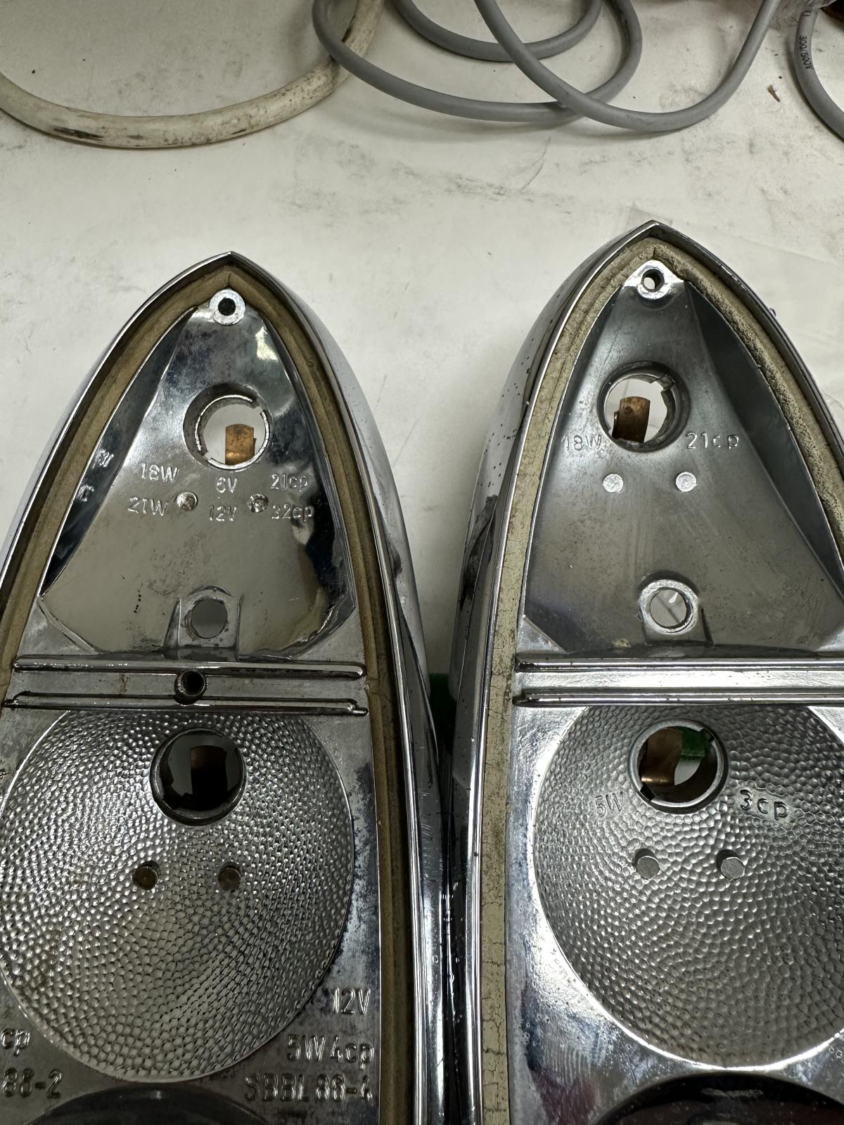

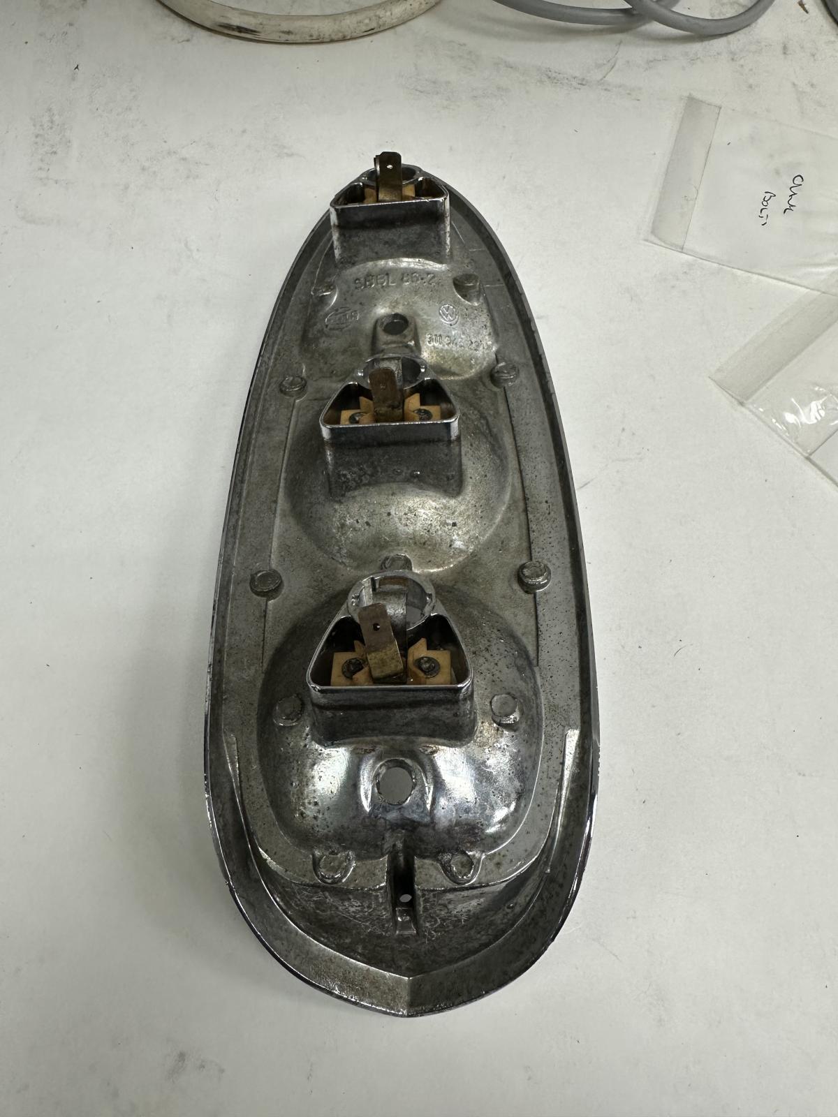

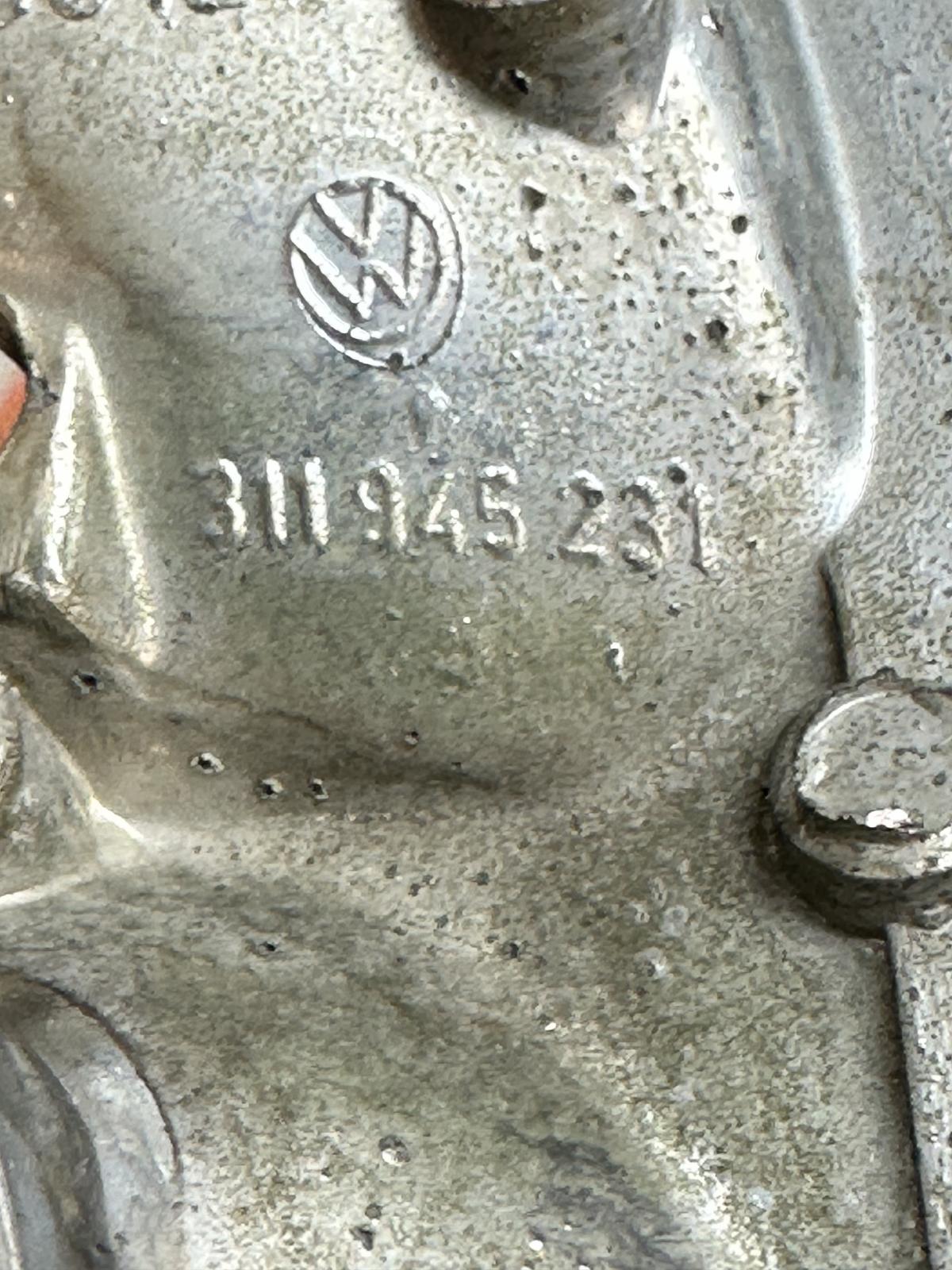

This is as irrelevant as the double holes under the Headlight ring on the early Type 3's, but i thought it was interesting.
Early Type 3 turn signal base with only a hole for the center , for a flat lens ONLY. It weighs 100 grs more than a later type 3 turn signal base with 3 holes for flat or high top rear lenses.
In comparison to later ones, it Does not have a 12v option,
