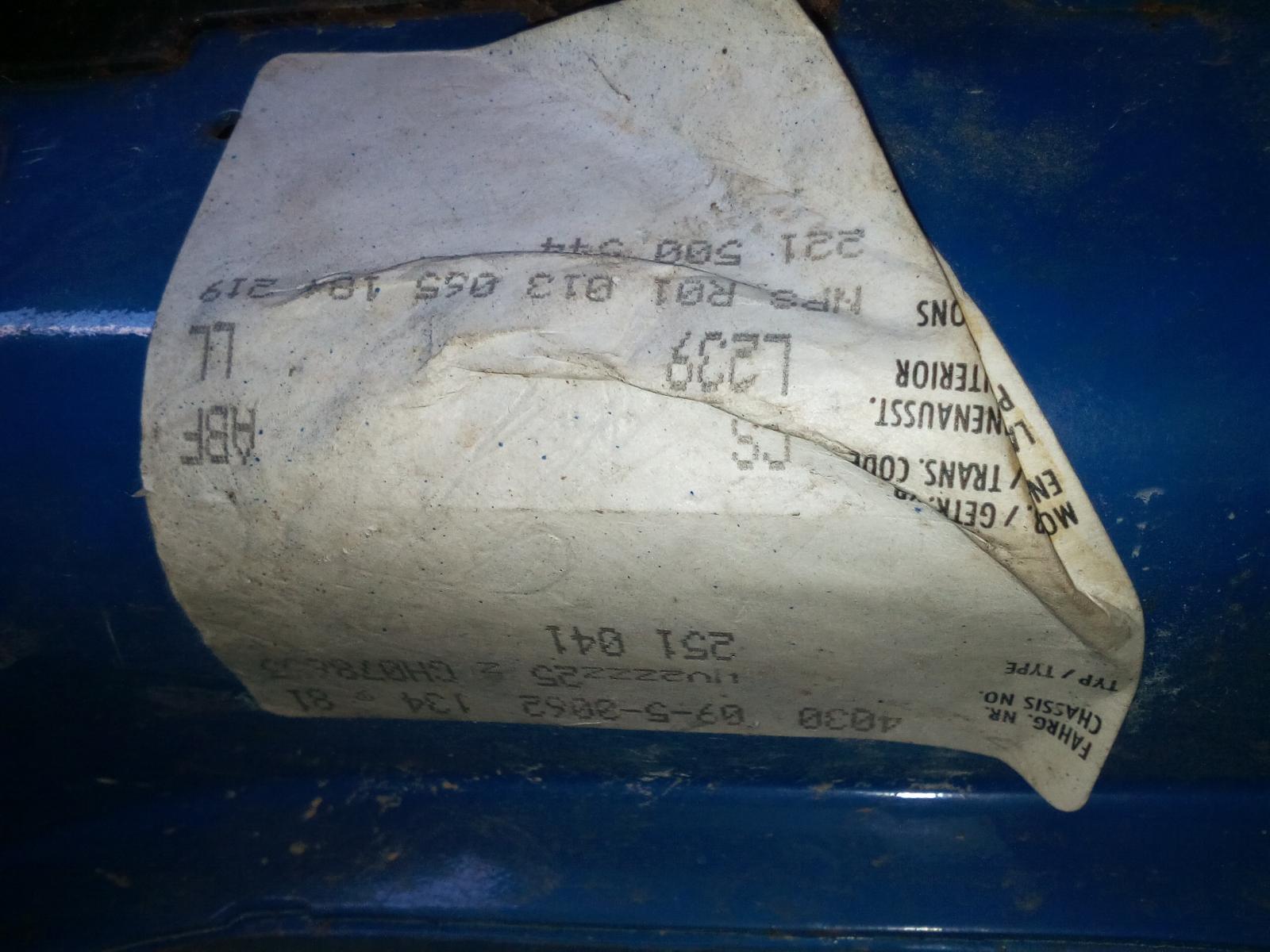

My sticker says: L239.
Can't find color- Please, help needed.
Based on a Google search, L239 is Enzianblau (Enzian Blue). Another code, which is more common, for the name Enzianblau is L51B, but no confirmation it uses the exact same paint mix as L239; the L51B code was used in the '70s.
Enzianblau must have been a special-order color (aka Sonderlackierungen) for the 1986 model year in Europe, hence not readily finding it. Just found a pile of special-order colors for '87, but Enzianblau is not one of them. Confused

PostPosted: Thu Jul 06, 2017 11:06 pm    Post subject: Re: T3 Paint Colors & Codes: The Comprehensive Guide Reply with quote
kamzcab86 wrote:
Enzianblau (L51B) Beetle for comparison:

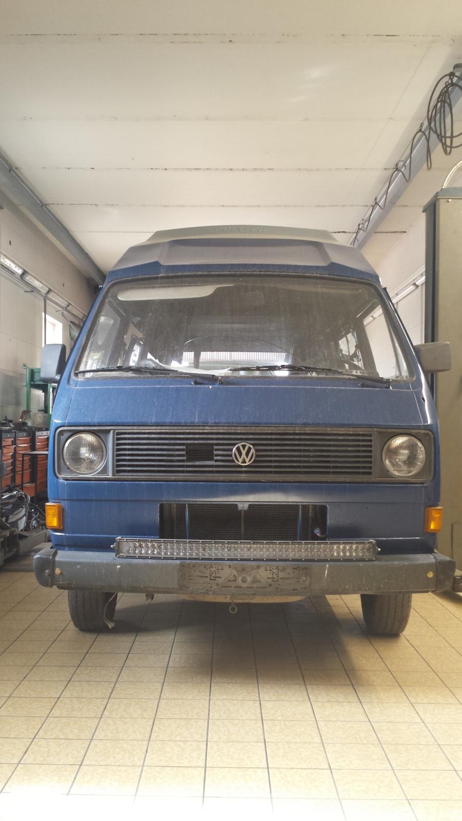

mine looks darker than Beetle

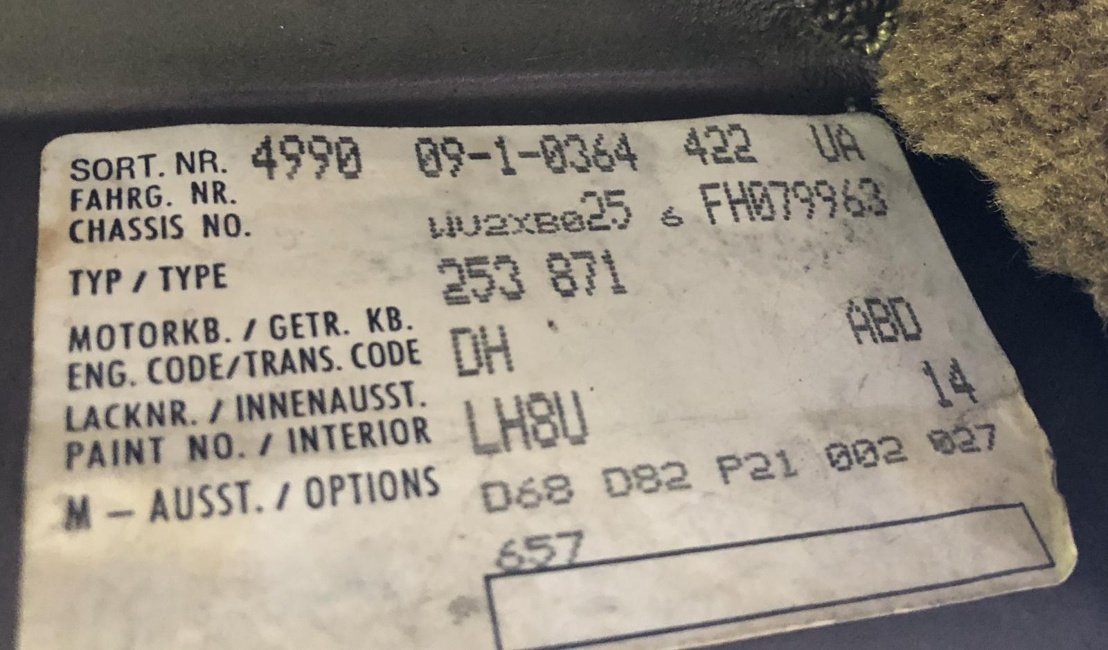

Does anyone know what the color code for my vehicle is? I assumed it was LH8U based on my sticker but when I applied the paint from one of the markers in a small spot, it was much brighter than the paint on the vehicle.
I’m wondering if maybe I’m looking at the wrong sticker or if anyone knows what color my 85 weekender conversion is?
Bronze Beige Metallic (LH8U as the sticker shows)
It's possible the paint wasn't mixed correctly, but there's also the possibility that your van's paint has faded and/or was re-painted at some point. Apply the touch-up paint to an index card and hold the card next to an original paint section that hasn't seen the sun: door jambs, under the dash, clean engine bay, etc. If the sample matches, the exterior has undergone a change, be it by Mother Nature, or a previous owner.
