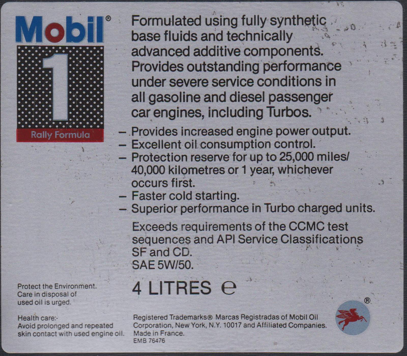

Sometime in circa 1985 or 1986, I bought a job-lot of about 20 litres, of heavily-discounted (circa £4•50 or £5•00 instead of circa £12•50 per 4-litre can - approximately 1 US gallon) Mobil 1 SAE 5W/50, API SF or SG fully-synthetic lubricating oil from the local Mobil franchised petrol filling station of Key Markets supermarket, on Canvey Island, Essex, England.
When using conventional mineral oil (SAE 30 monograde or SAE 20/50, 15/50 or 10/40 etc multigrade) in the AD-Series, twin-port, VW 1600 Type 1 Beetle style air-cooled engine, of my family's 1973 VW 1600 Type 2 Westfalia Continental motor-caravan, the oil turned from light-straw colour to virtually black with dark-grey glutinous sludge, after 3,000 miles of use, when the next oil-change was due. The oil-consumption rate was circa 1 litre per 1,000 miles and one often noticed the acrid smell of oxidised oil, when opening the engine-compartment hatch.
However, when Mobil 1, SAE 5W/50, API SF or SG fully-synthetic oil was used, it changed in colour from ultra-light straw to light-straw after 3,000 miles, with NO sludge formation whatsoever. The oil-consumption rate was reduced to circa 1 litre per 3,000 to 4,000 miles and there was no acrid smell of oxidised oil, when opening the engine-compartment hatch.
The 5W viscosity cold-starting characteristic, also made starting much easier in cold weather, but I suspect it led to oil being diverted through the oil-cooler prematurely, owing to the relatively low viscosity at low temperatures.
On cold English winter days when the ambient air temperature was close to ZERO degrees Celcius, the oil-pressure with Mobil 1, SAE 5W/50 oil at start-up from cold, was typically around 4•0 Bar, but reduced quite rapidly to 3•0 Bar after a few minutes; remaining at a stable 3•0 Bar under normal driving speeds, on urban roads, cross-country rural back roads & trunk roads and motorways. At idle, waiting at road junctions, the oil-pressure was stable at 1•0 Bar. All oil-pressure measurements were taken using my dashboard-mounted, 52 mm VDO Cockpit 0~5 Bar oil-pressure gauge.
Sometime during the 1990s, I came across the following leaflet pertaining to synthetic & semi-synthetic lubricating oils for petrol and diesel engines. What caught my eye was the test results for a VW Beetle 1302, Type 1 style air-cooled engine.
I sent a copy of this leaflet to Neil Birkitt (with whom I have sporadically corresponded since the early-1990s and who has published some of my material), then the editor or assistant editor, of the British magazine VW Motoring, who subsequently paid a visit to Miller's Oils and published a short review article in the magazine, of which I have a copy somewhere.
Miller's Oils Leaflet with VW Beetle 1302 test results
https://www.thesamba.com/vw/archives/lit/millers_oils.php
