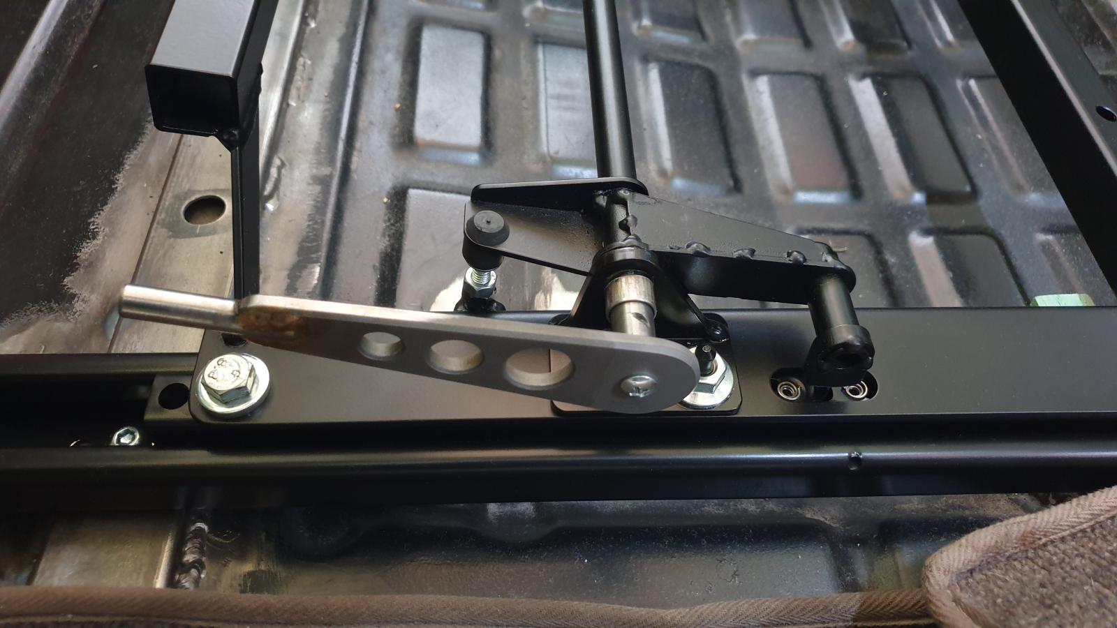

All the hardware that came off my Ghia when taking off the body are included in these parts, yes. Plus a few extra washer plates from a 70 bug as spares and some brackets and parts I made for the build.
The extra chrome brakets are my new seat adjusters, not chromed in below pic:

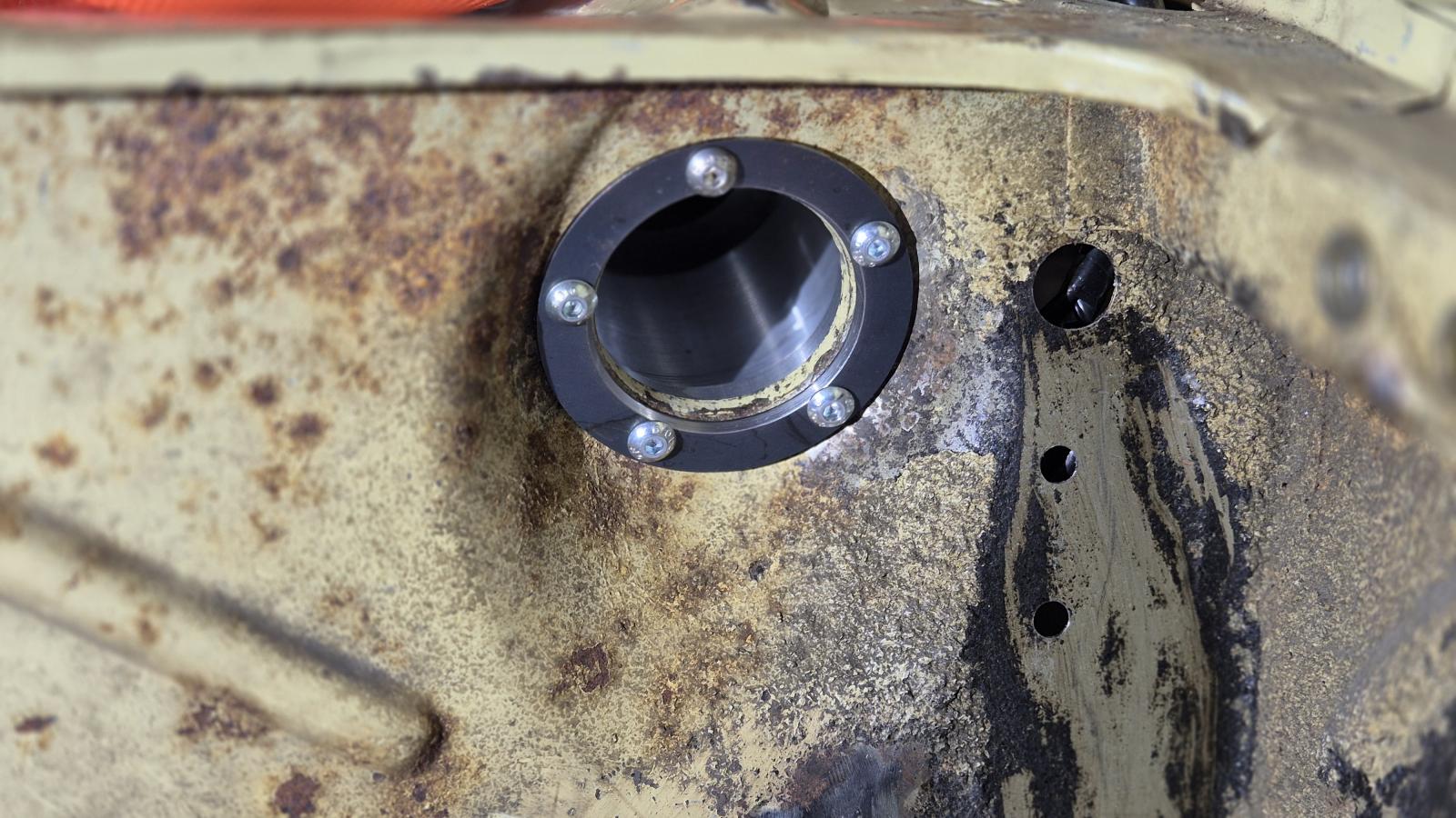

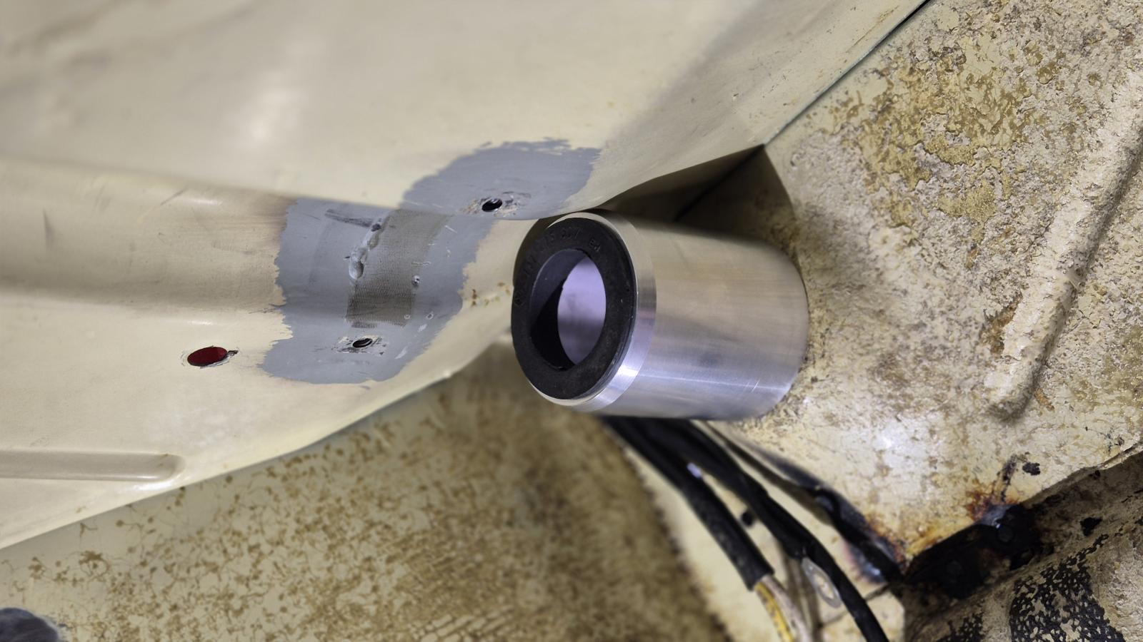

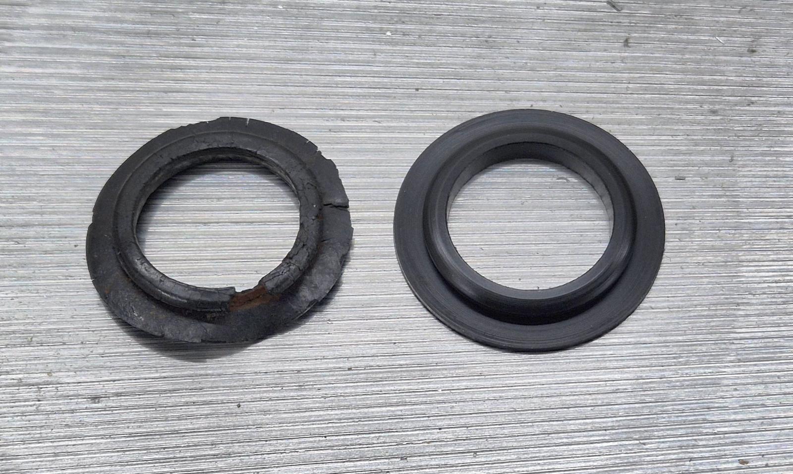

I made an aluminum adapter tube and a support ring from steel to close out my steering column to the body. This became necessary as the first joint sits half way inside and the steering column tube is to narrow to house it.
This solution closes out the wet and should give the column additional support.

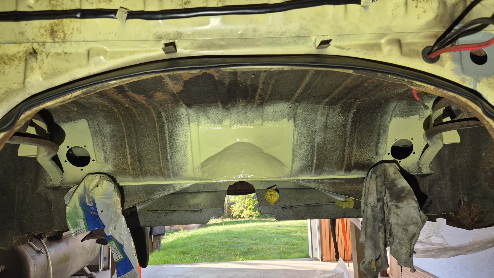

Finally some warmer weather today, so I could primer all black sheet metal spots on the body.

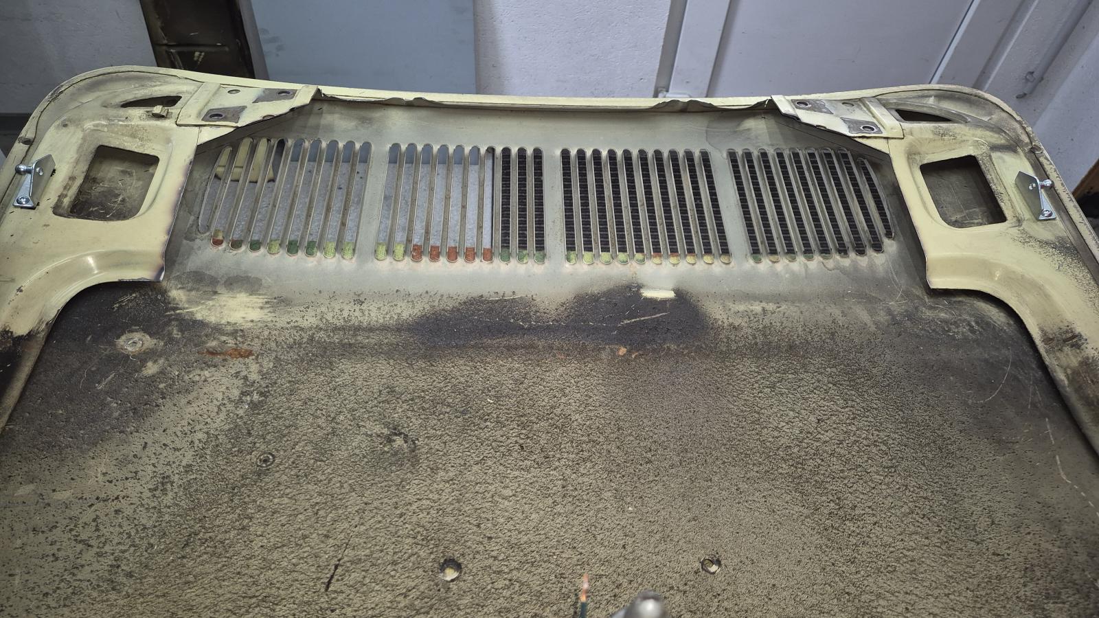

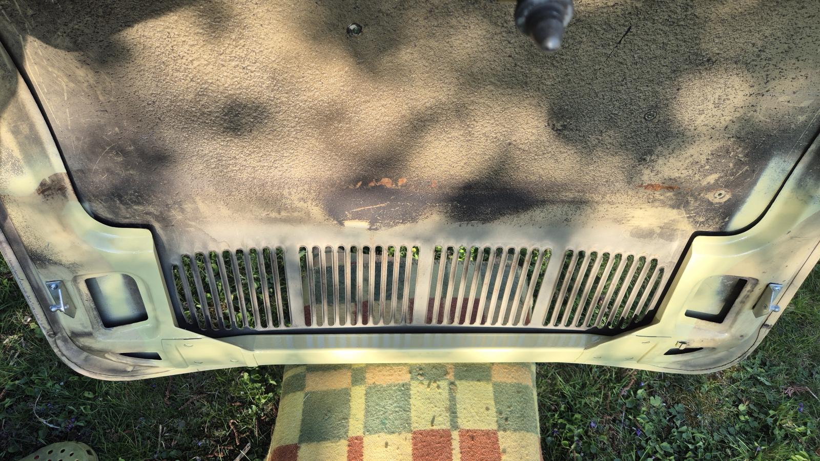

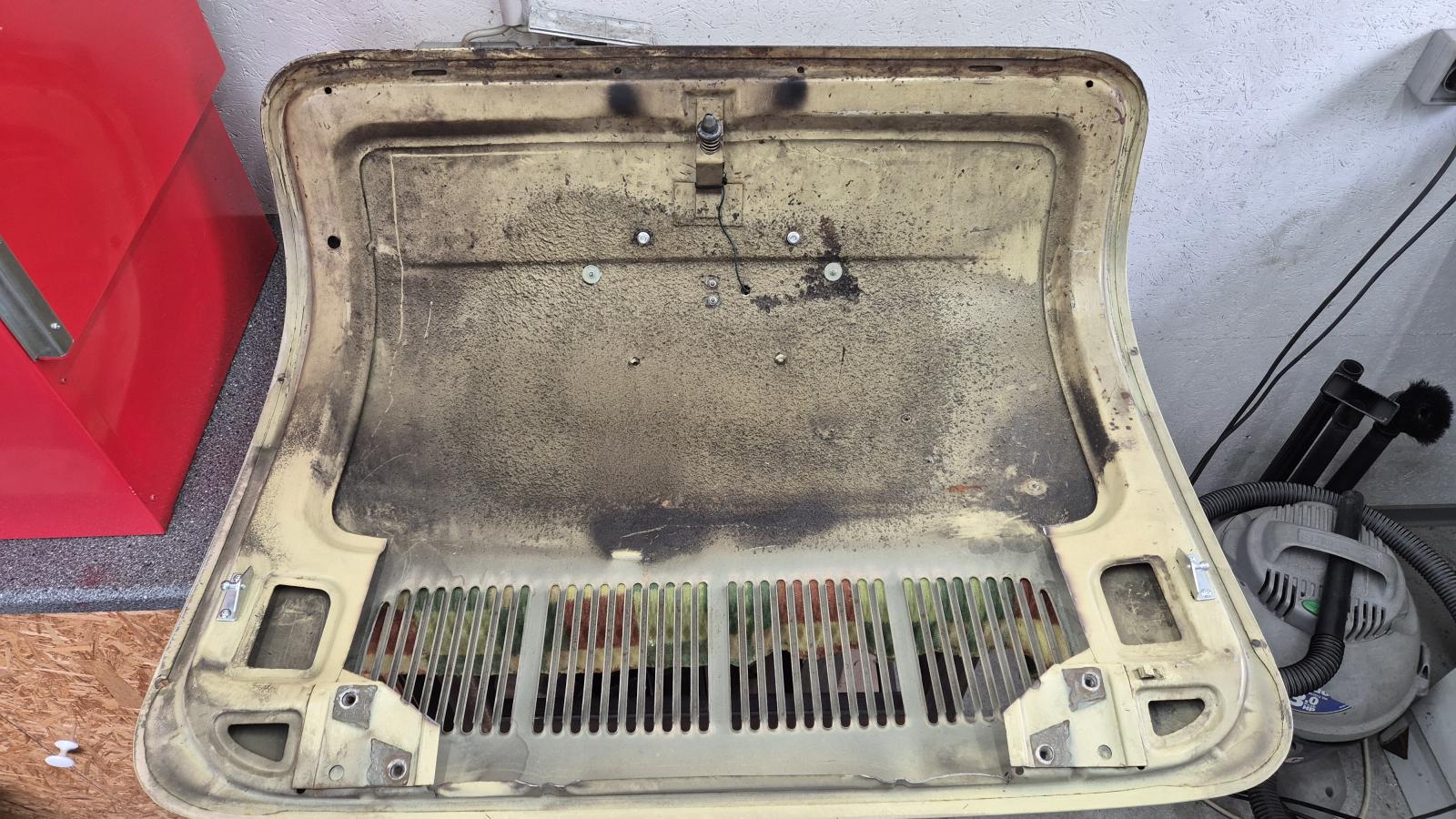

With my plans for a large engine I prefer to have more free airflow into the engine compartment. First I thought about using a later engine lid. I even bought one but found out, that the these later lids had some changes done to the A-surface, so I decided to modify the original lid.
Before:
After:

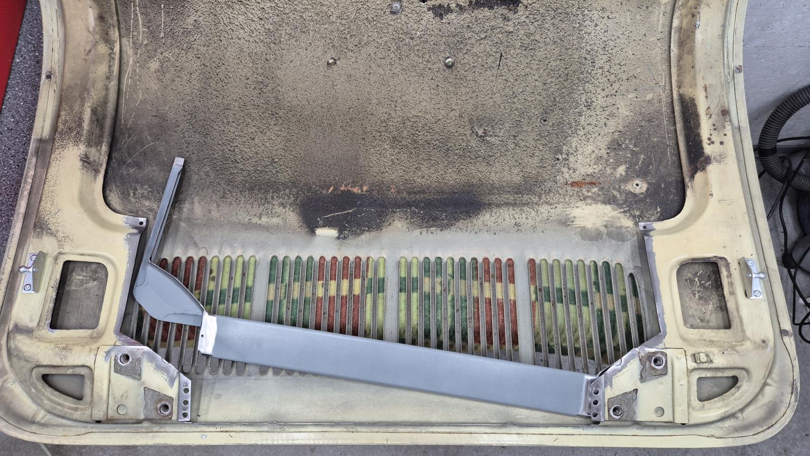

I just ordered this custom profile to weld it in between the deck lid hinge-attachment-points:
The other edges will also be reinforced with sheet metal ribs. I used the laser again to get plane surfaces on the the compound angled cuts:
Can't wait to get the profile to continue the fabbing.

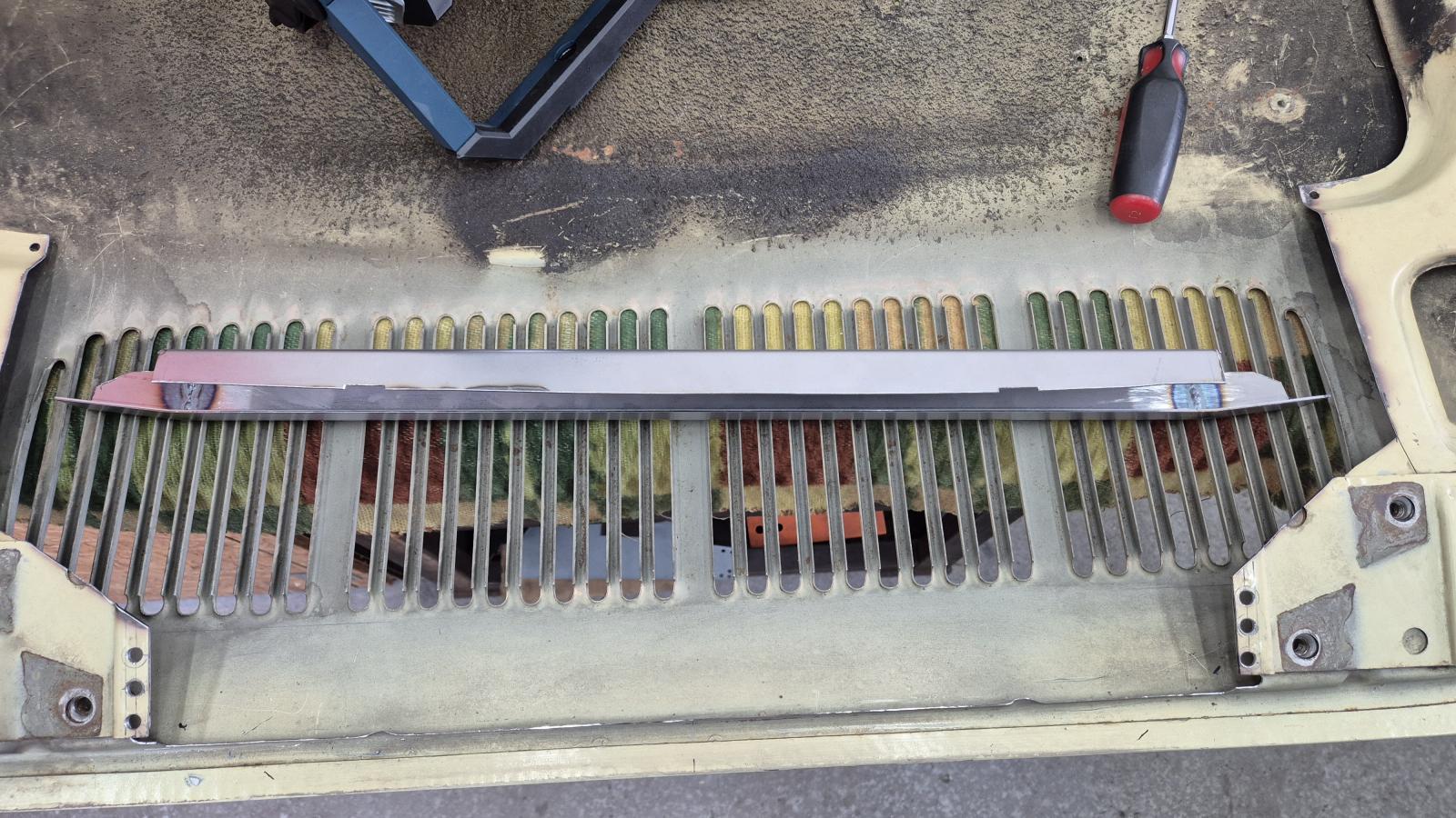

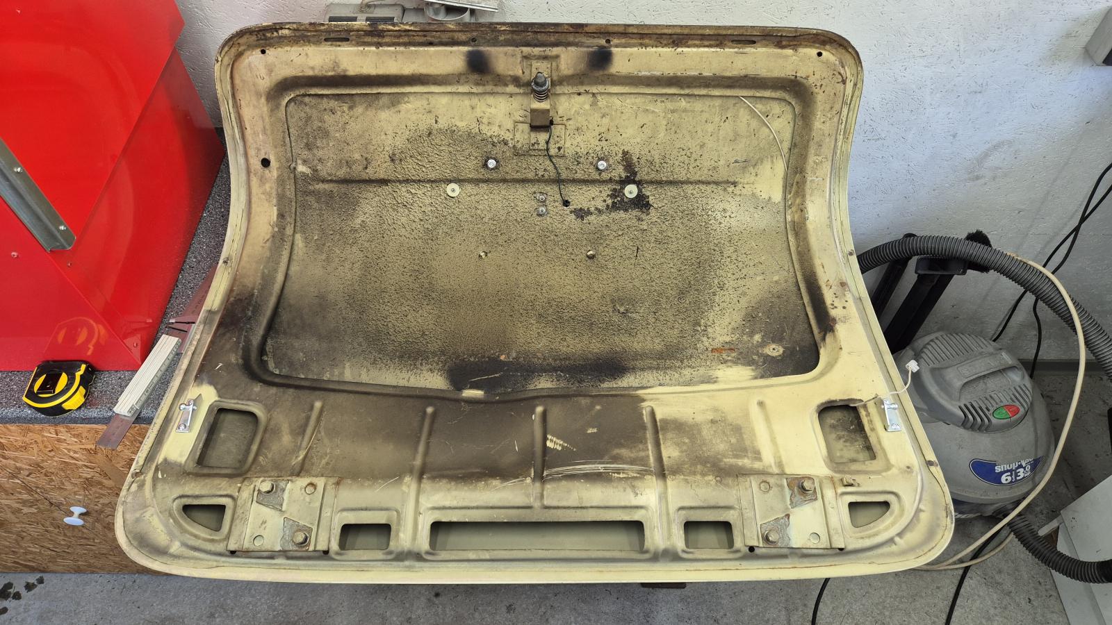

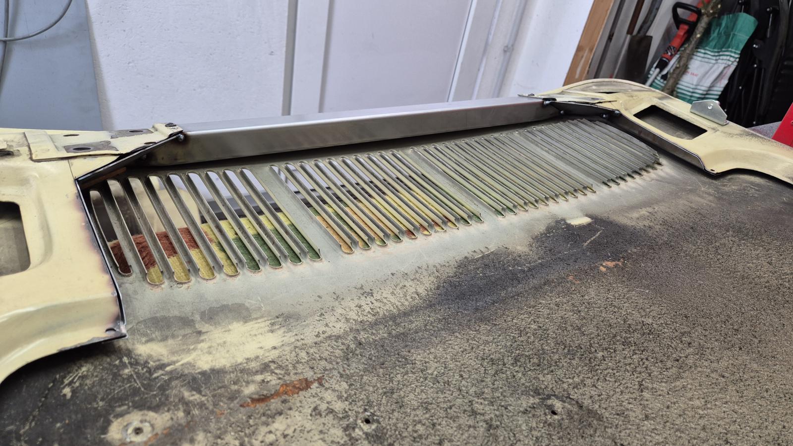

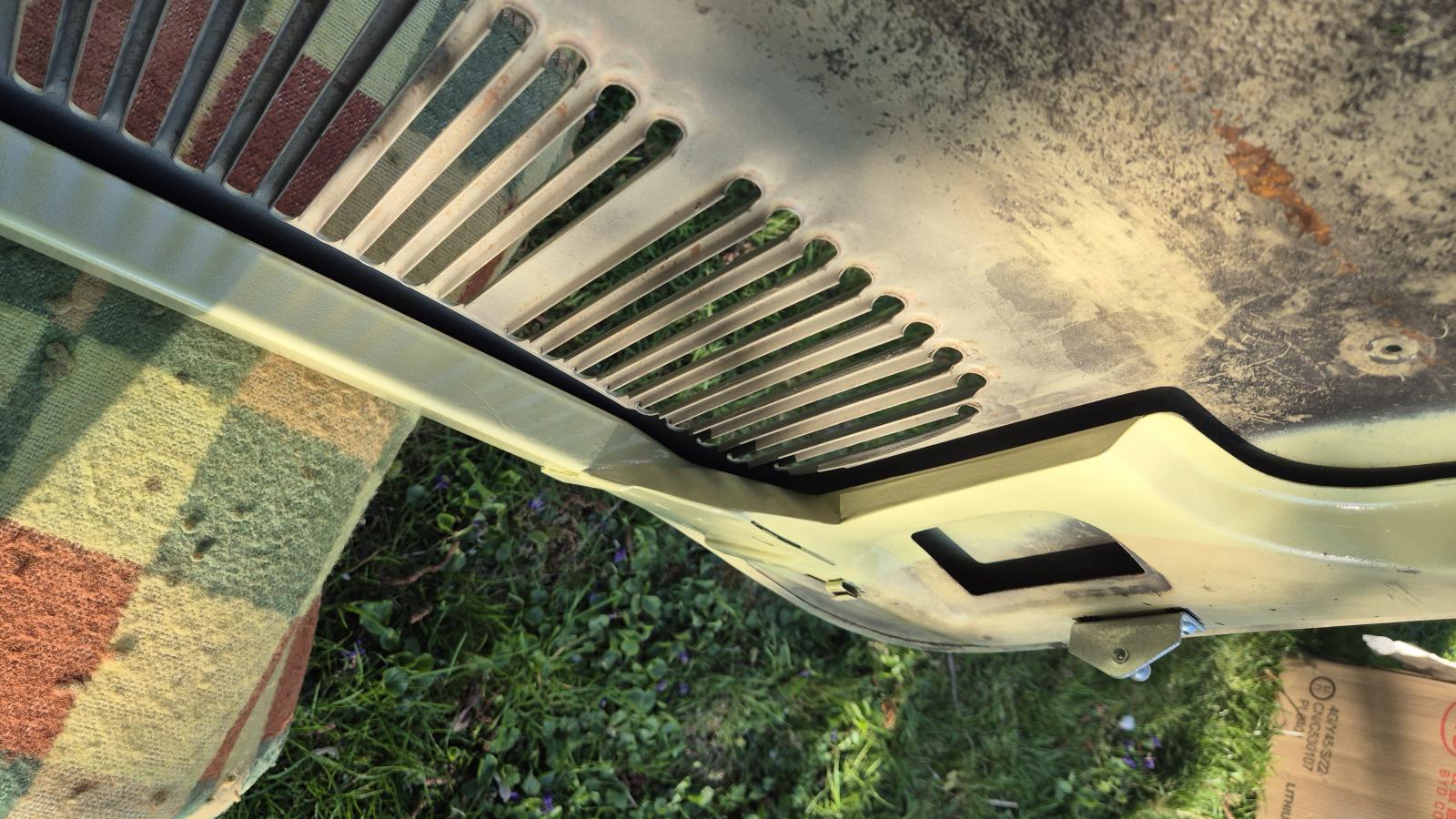

The deck lid got pretty flimsy when I removed the rain tray. I used a custom bent sheet metal profile in 1.5mm to create a new "backbone" for the lid. The ends needed to be raised a litle:
Next I made some more parts to fit along. Thanks Wrenn for your inspiration using sheet metal screws:
I welded the bits together on the outside to clean the welds and paint the backside. The complete piece barly fit into the lid:
First a couple spot welds:
Comleted:
Cleaning up the welds is next
BTW, for especially for Ian... this is 300g lighter than stock Laughing

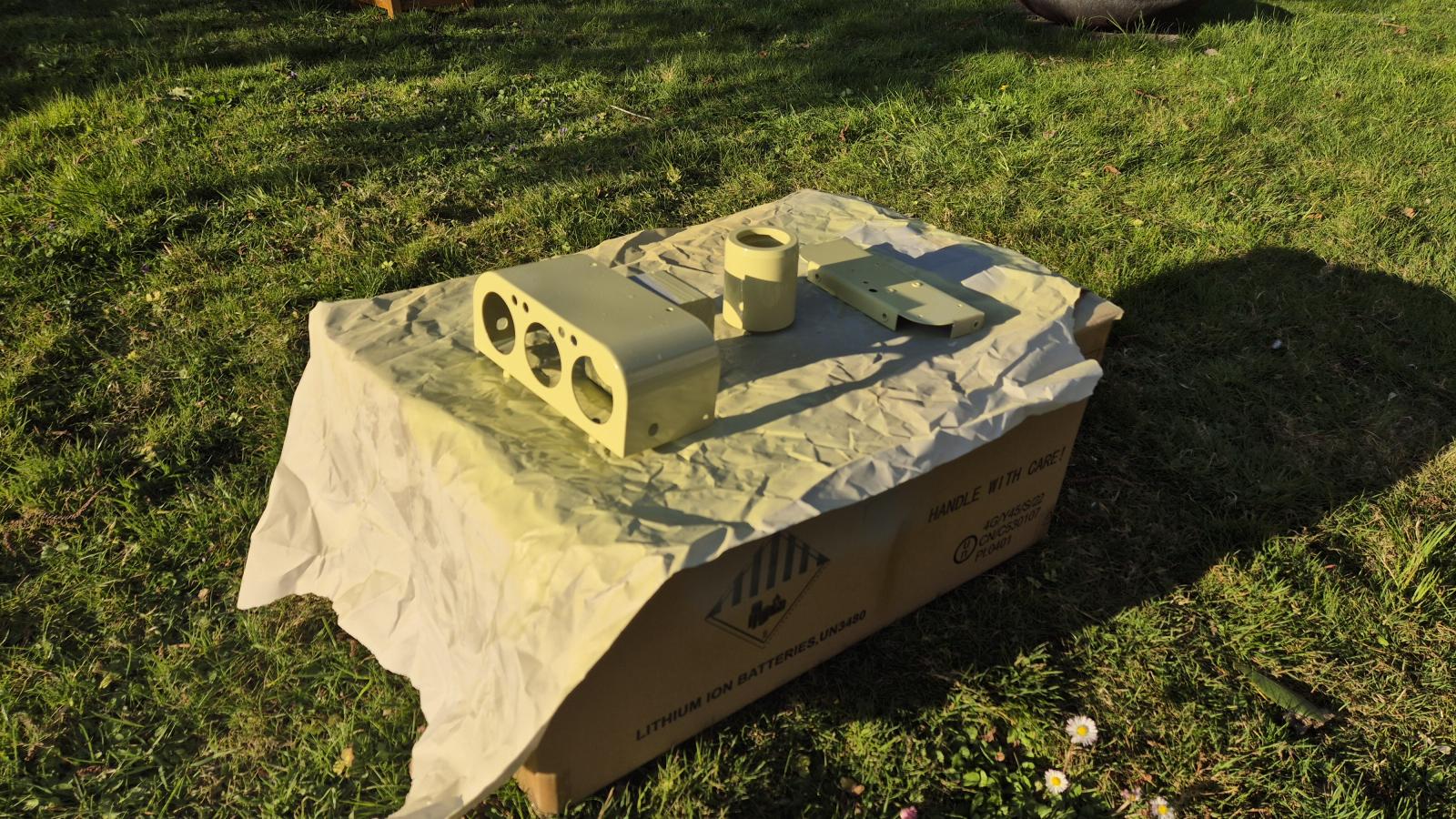

Finally summer is here. Warm enough to crack a 2K rattle can and spray some paint over the modified areas.
I will assemble the car without restoring the body first, for tryout of all my technical modifications. Once everything works out, I will redo the body, top and interior in a second step.
